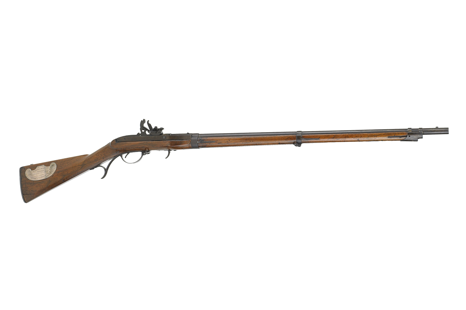

Black Powder Precision Rifle Gunsmith?
EDELWEISS
In a world where armies fought with smoothbore flintlock muskets, expecting hits past 50 yards was folly. Rifles made hits at 100yards common place, 200yards easy, and with an exceptional shooter 300yards possible.
Maybe its because Ive read the Sharpe's novels about a dozen times; but Im jonesing for a (repro) Baker rifle. All the repros are smoothbore. Im sure its because of manufacturing cost; but damn when youre making one of the most important firearms in history it might be nice to really make it.
Otherwise the current repros don't seem horrible. I think they are European made because the touch hole is not drilled (making them NOT firearms) so they can be sold anywhere. Hence I guess the reason for a smoothbore. Ive seen reports of guys using them after drilling the touch hole with good results (good as a smoothbore).
Im tempted to buy one to have a rifled barrel installed; but I don't have a clue who can or would take on that job.
Next on my list is a swamped barrel Jager flintlock in at least 58 caliber; but Id prefer over 60 cal. There are a few sorta Jagers. Pedersoli makes a rifle that's more the love child of Kentucky and a Jager after a night of cheap alcohol in a hotel with hourly rates and charges extra for clean sheets. I wouldn't choose it if there was an option for a real Jager; but since theres nothing short of a full custom build as an option, Ive up'd the Pedersoli Jager to kinda hot in a slutty sorta way.
