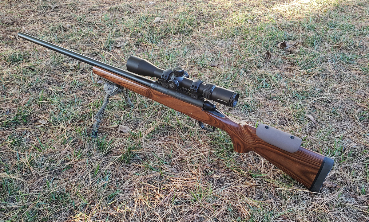

    I started down this rabbit hole initially just wanting to bed my Model 783 Varmint and add a Kydex cheek piece, which isn’t a hard DIY project all in all. However, I thought why not have some fun with it and just like that, my bubba gunsmithing adventure began. My goal was to have an end product that was functional, looked decent, and improved the rifle overall. I’m going to update this as I go along and if I screw up bad enough, well I guess I’ll do a review on the new Boyd’s stock I get.
    To fit within this bubba gunsmithing theme I decided that all the materials were going to come from resources that a bubba might have, mainly a hardware store and Walmart. Luckily, I have a pretty good local Ace hardware and I was able to get 99% of everything I needed there. The only thing I got from Walmart was the neutral shoe polish to use as a release agent as I had some of the other materials at home already.

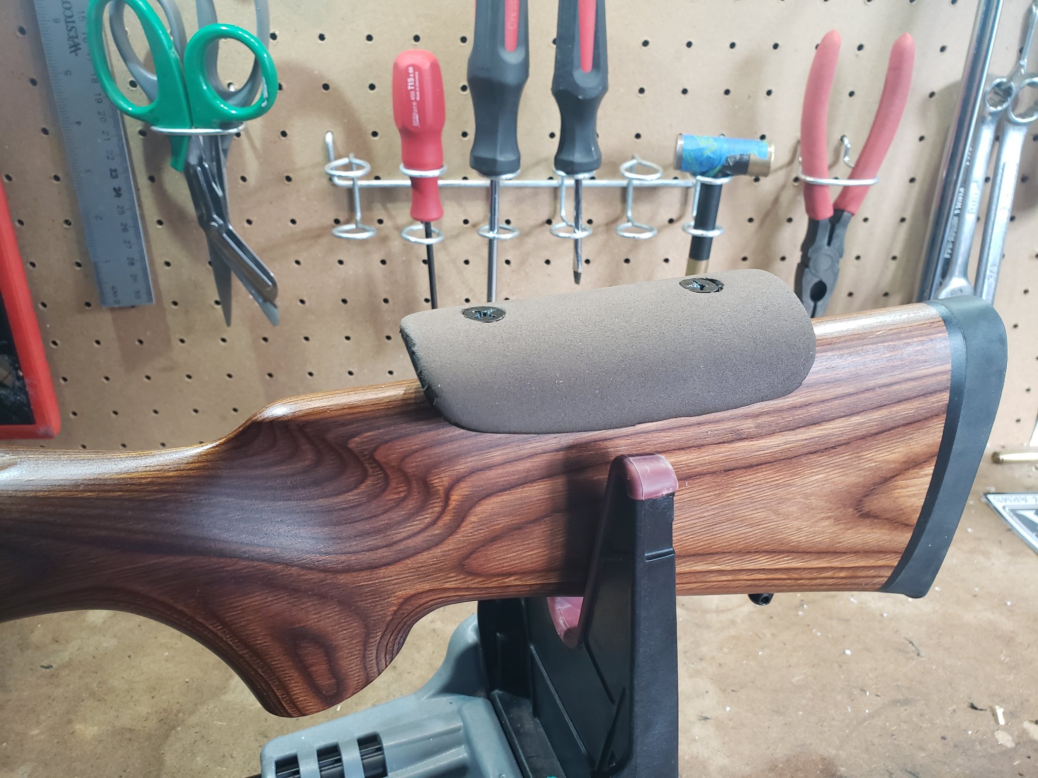

    The pictures are a little out of sequence because I've already done a bunch of locating, drilling, and fitting, I'm just backtracking to show my process.

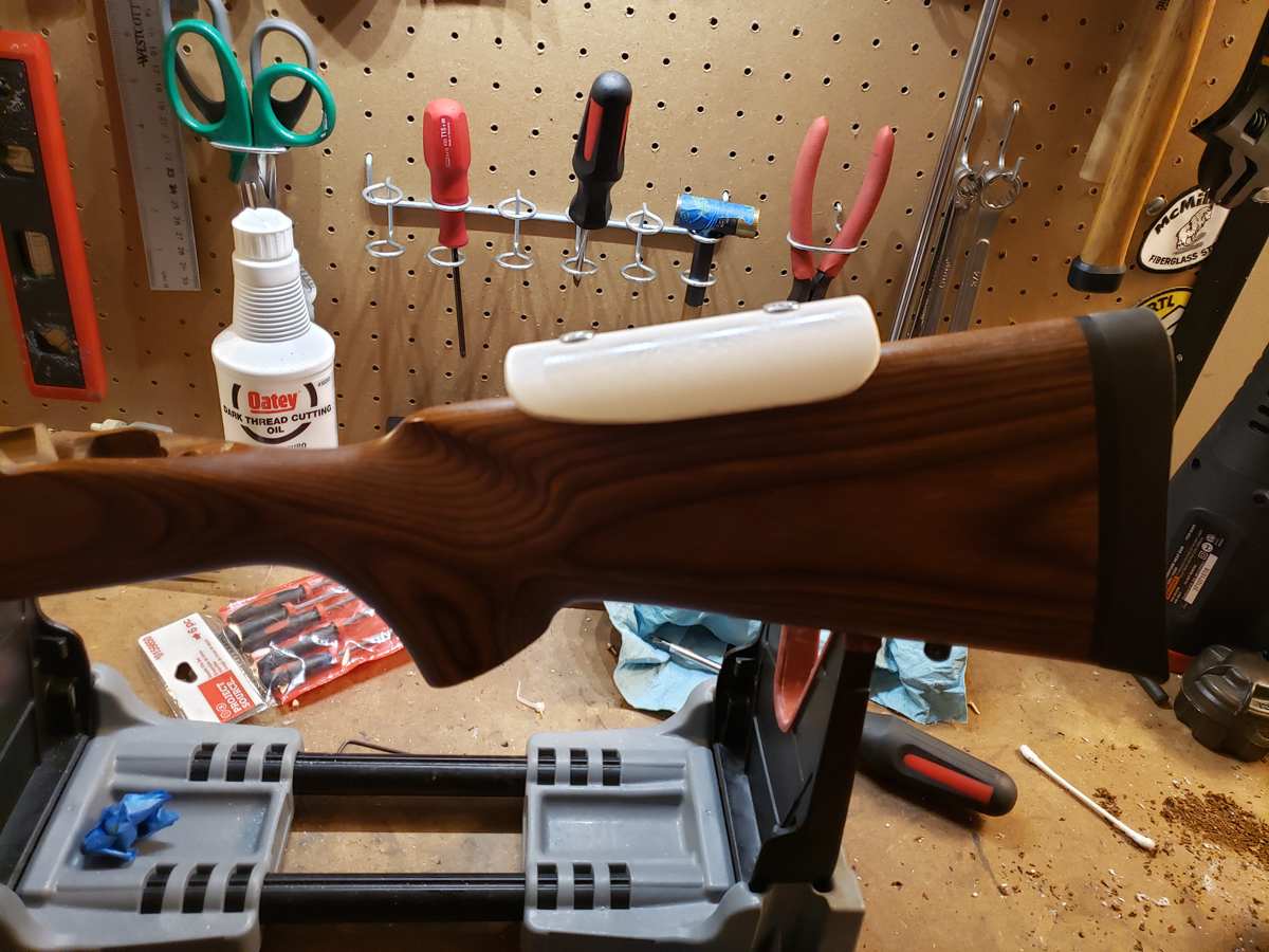

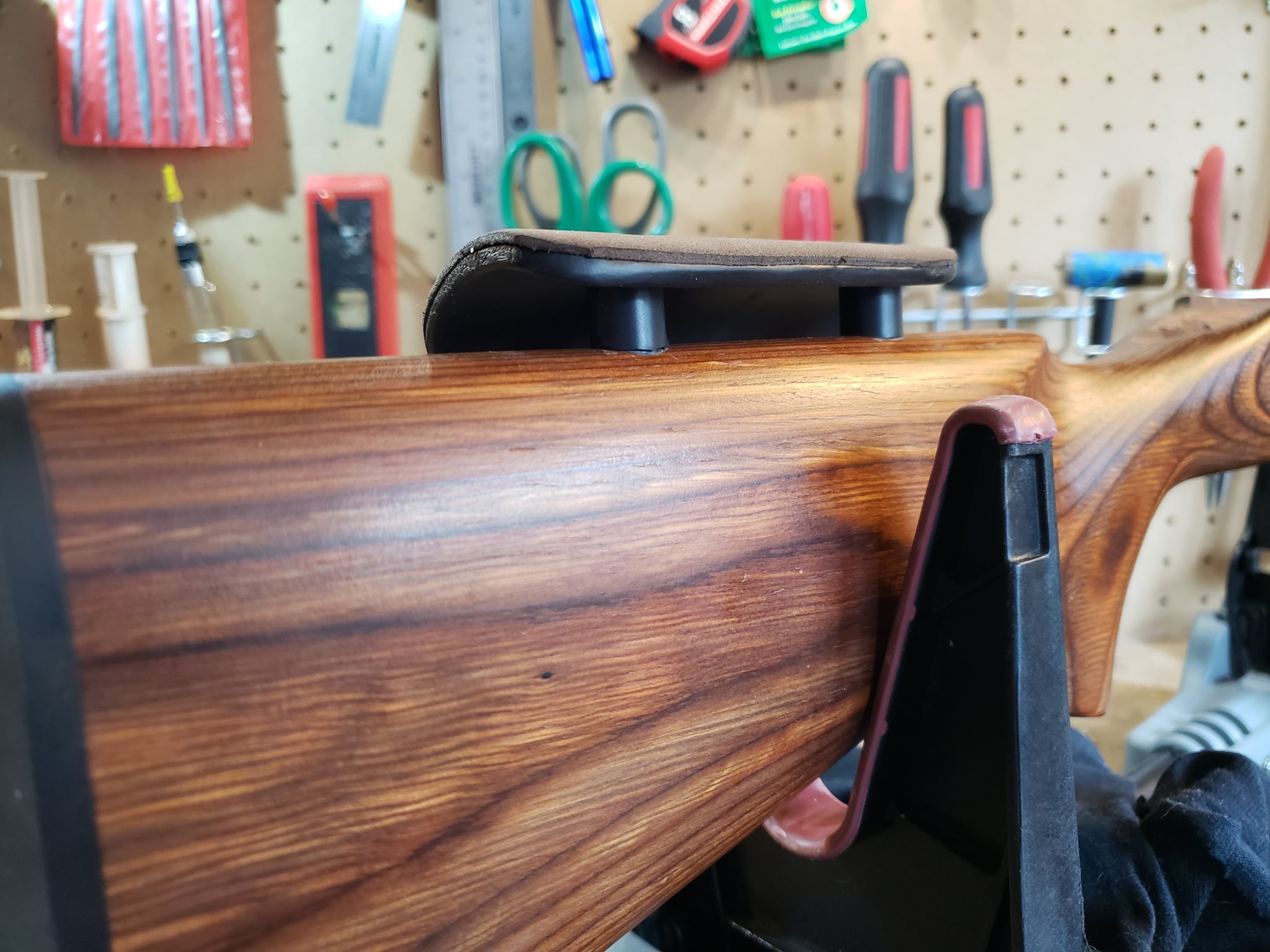

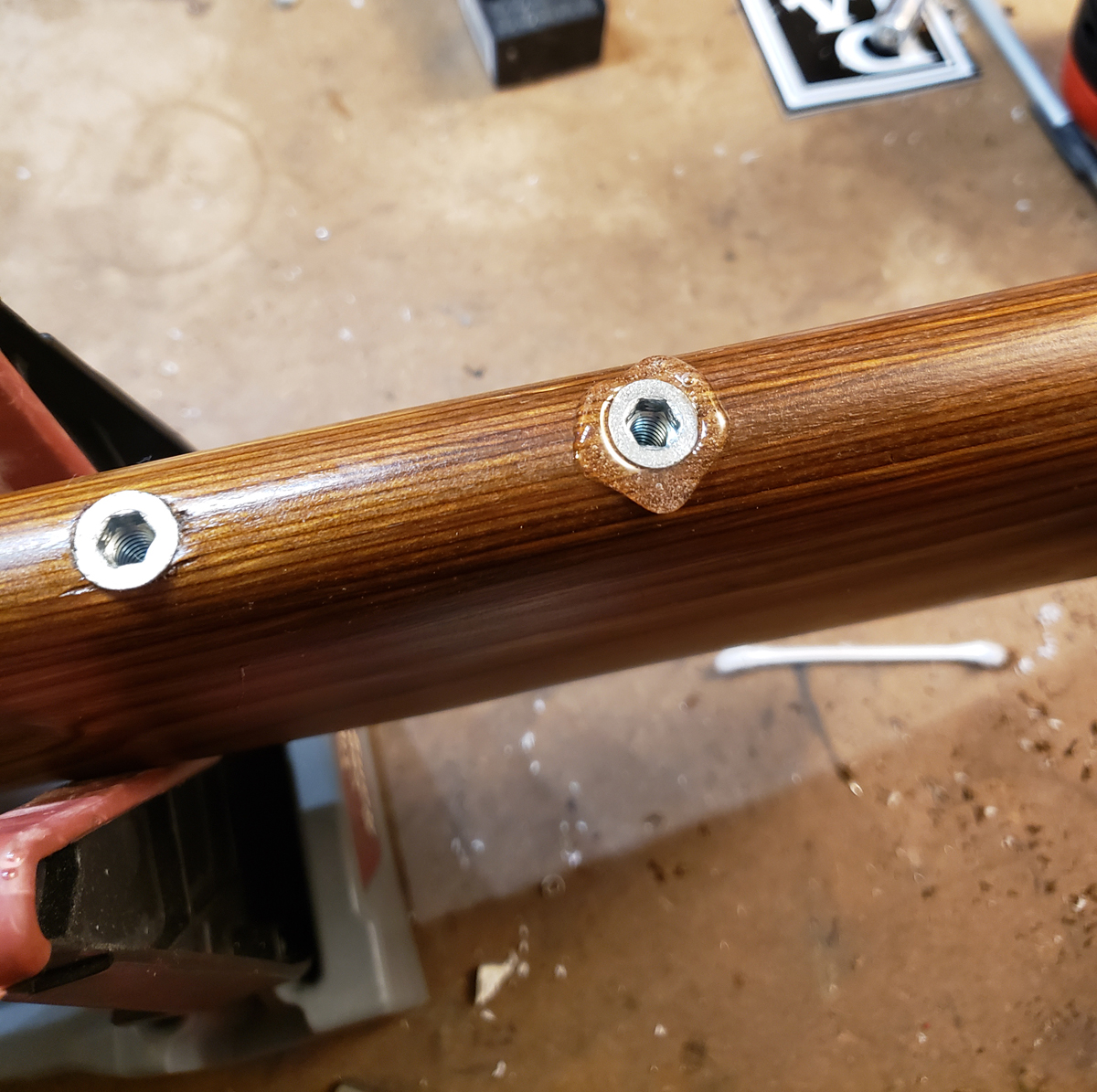

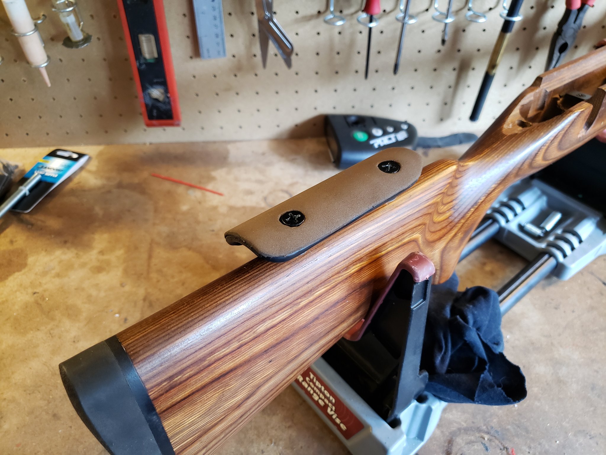

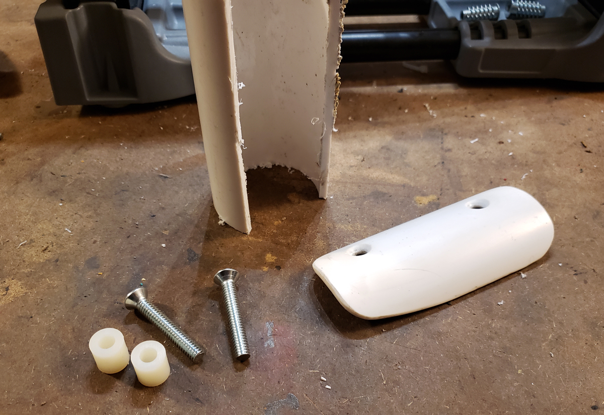

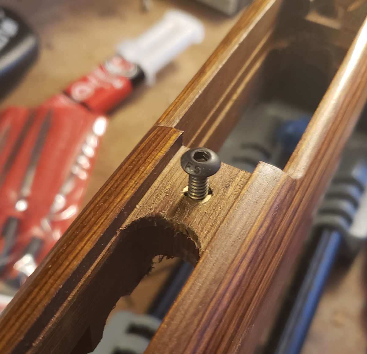

    I had started out by making the cheek piece out of the section of 2” schedule 40 PVC pipe. I think I’d actually seen someone else use 2” pipe previously, which is why I went with that diameter. To figure out where I had to cut the pipe I made a template from a piece of wire that roughly followed the curvature of the pipe.
    When I found the best point where it generally followed the curvature of the stock and could provide sufficient support I marked the wire. Cutting and shaping the section into a pipe was relatively easy, albeit messy.

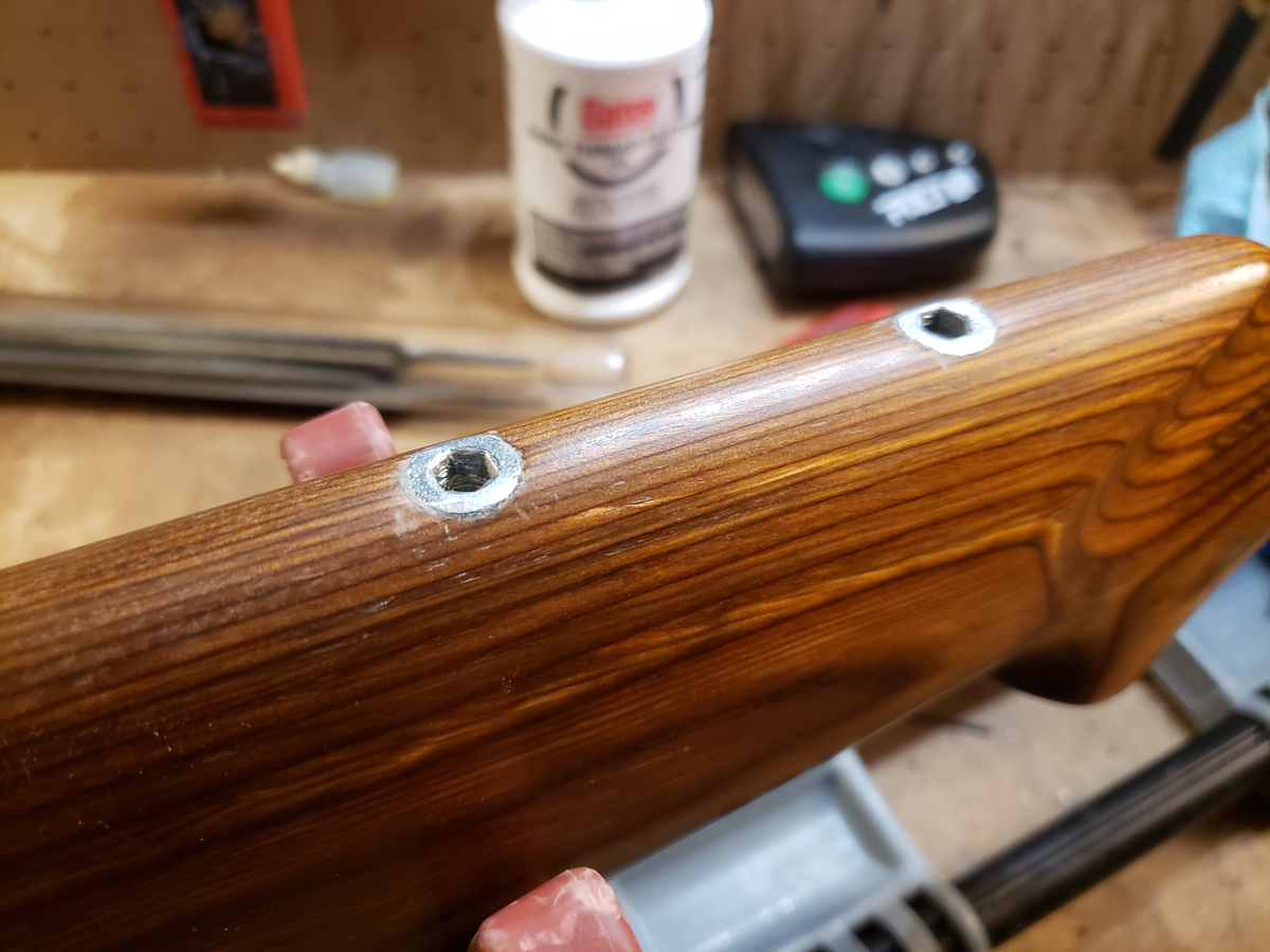

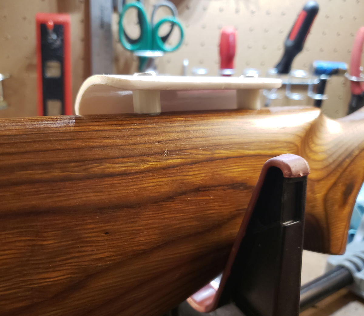

    I used the cheek piece to locate and drill the holes for the ¼-20 thread inserts. I figured ¼-20 screws would be substantial enough to support the cheek rest and the flange on the inserts would provide a bearing surface for the spacers that would set the height.
    I epoxied the inserts in with the clear epoxy and filed the edges so that they followed the contour of the stock a little better.
    The front one isn’t perfect but those sins will be hidden once the spacers and cheek rest are blacked out. Eventually the cheek rest will get painted and brown self adhesive foam will go on top, which should put the screws just below flush.

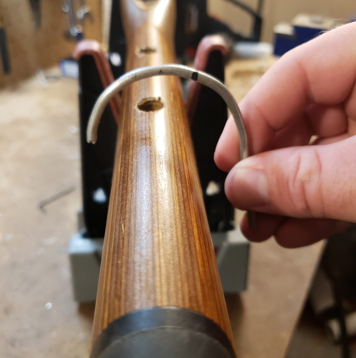

    The 783 used a wood screw to secure the trigger guard, however it was shit, it didn't have enough bite to draw the trigger guard down and before long I could see it stripping out completely. I drilled the hole out and installed a brass 10-24 thread insert in so I could use a machine screw to secure the trigger guard. The head diameter is about the same but it uses a smaller allen wrench than the action screws, that's the only real downside.

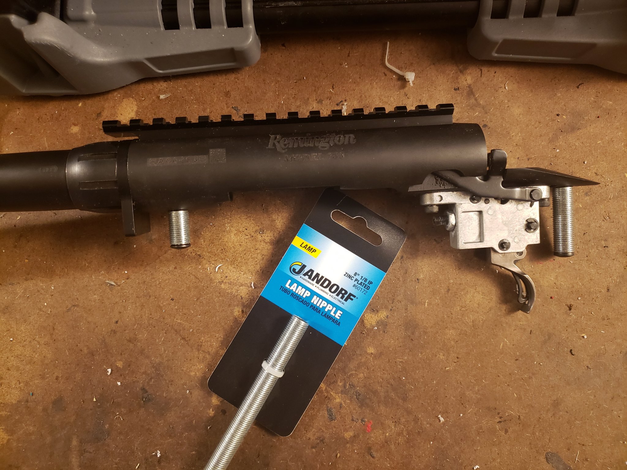

    Coming soon are the bedding pillars I made out some lamp nipple.....

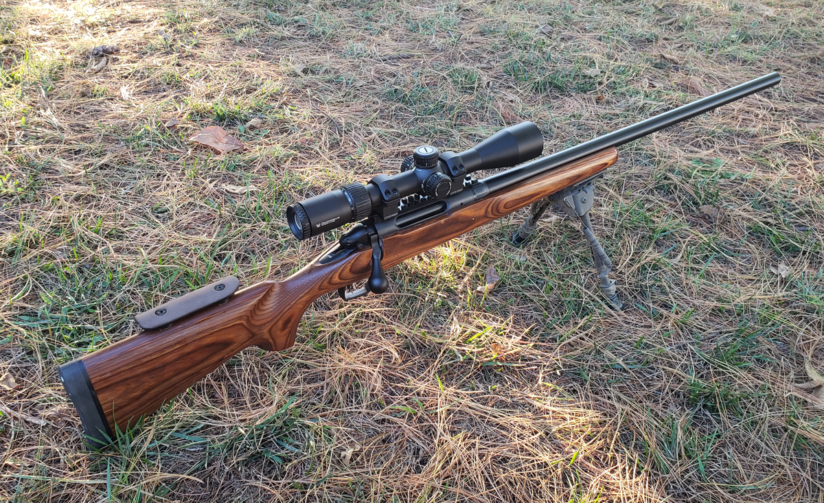

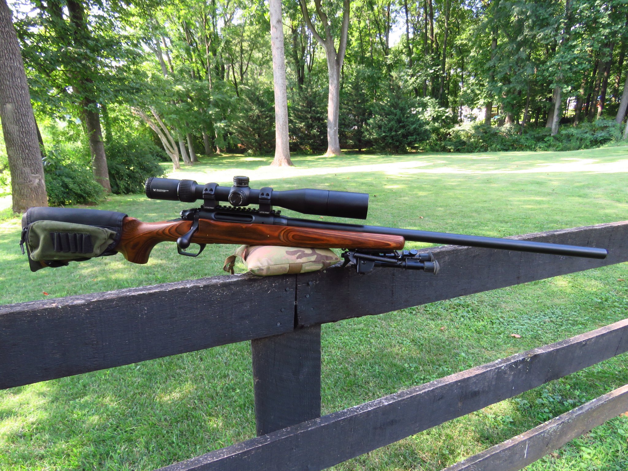

    For some added context, the first picture is the rifle back when I was reviewing it for an article and there were no modifications done to it yet beyond the cheap stock pack. I've kept my targets from that test so I'll be able to do a direct comparison with some of the same ammunition once it's all said and done. Hope Remington doesn't mind.

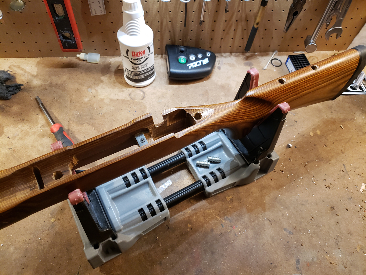

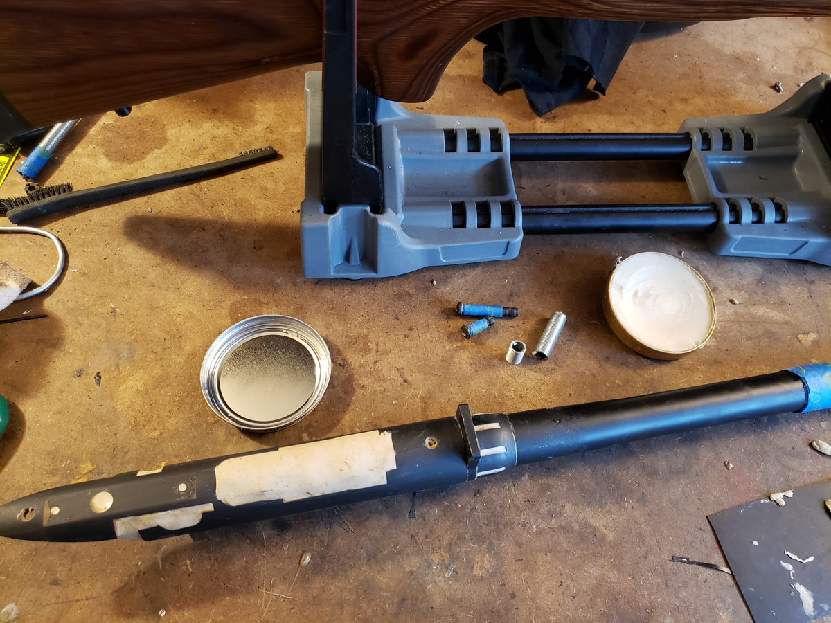

    Not much of an update today but here are the bedding pillars I made for this little project.
    I was going to make bedding pillars out of 1/2" aluminum tubing but I scratched that idea when I realized that drilling out for 1/2" tubing would take away too much wood in the rear. Remington did not leave me a lot of meat back there so I searched for a more narrow pillar. I happened to stumble across an internet posting, the birthplace of many bubba projects, talking about using lamp nipple as a bedding pillar. Luckily, the local hardware store had a selection of it and I picked up a couple 8" pieces of the stuff.
    It's just over 3/8" diameter, threaded on the outside, with enough clearance on the inside for the action screws. The screws are taped to keep them centered inside the bedding pillar. I'm hoping to epoxy the pillars in place this weekend.

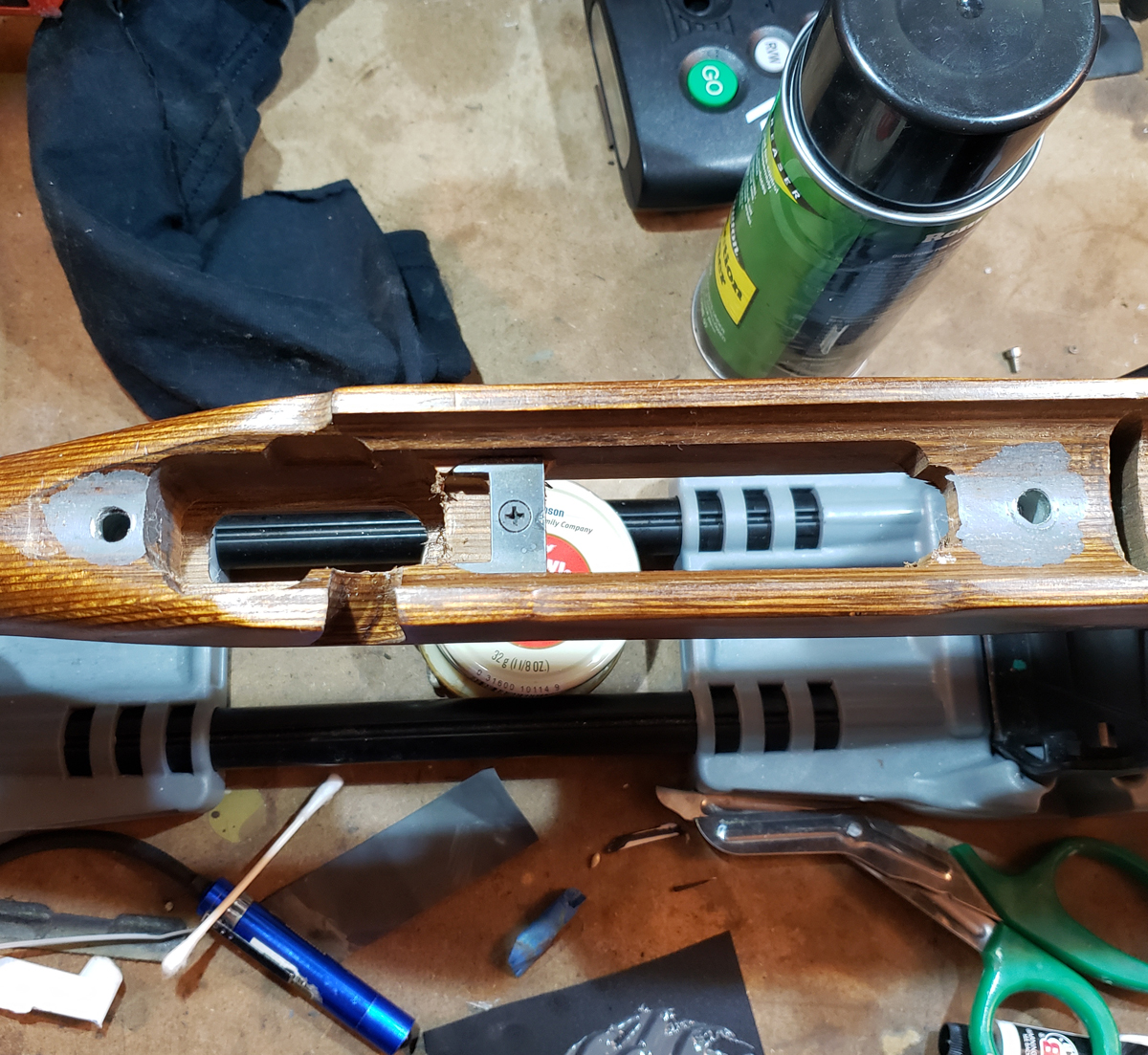

    Update:

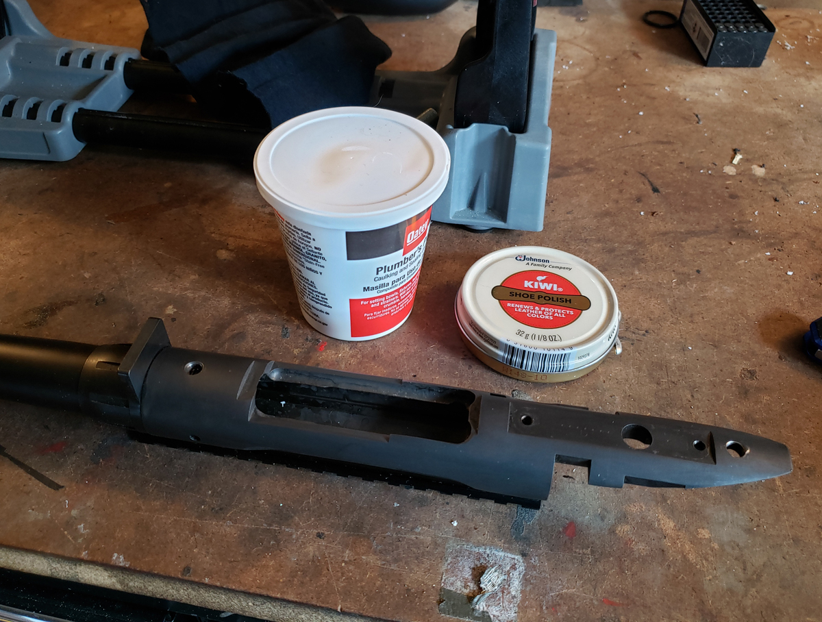

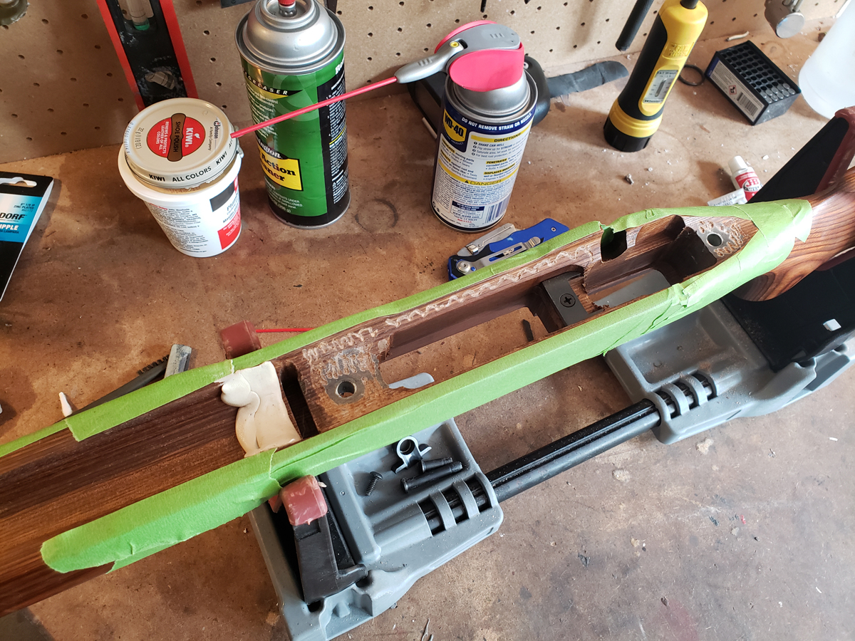

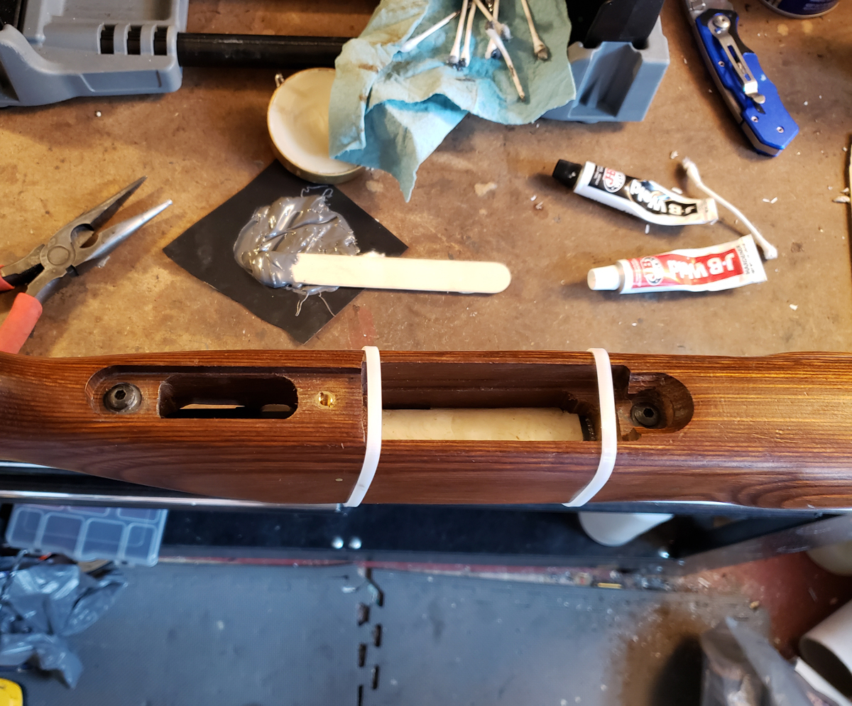

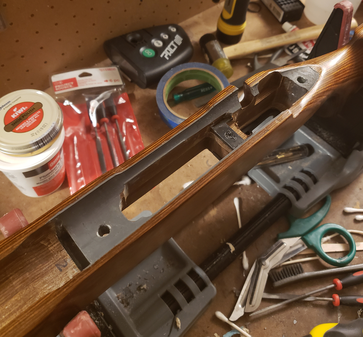

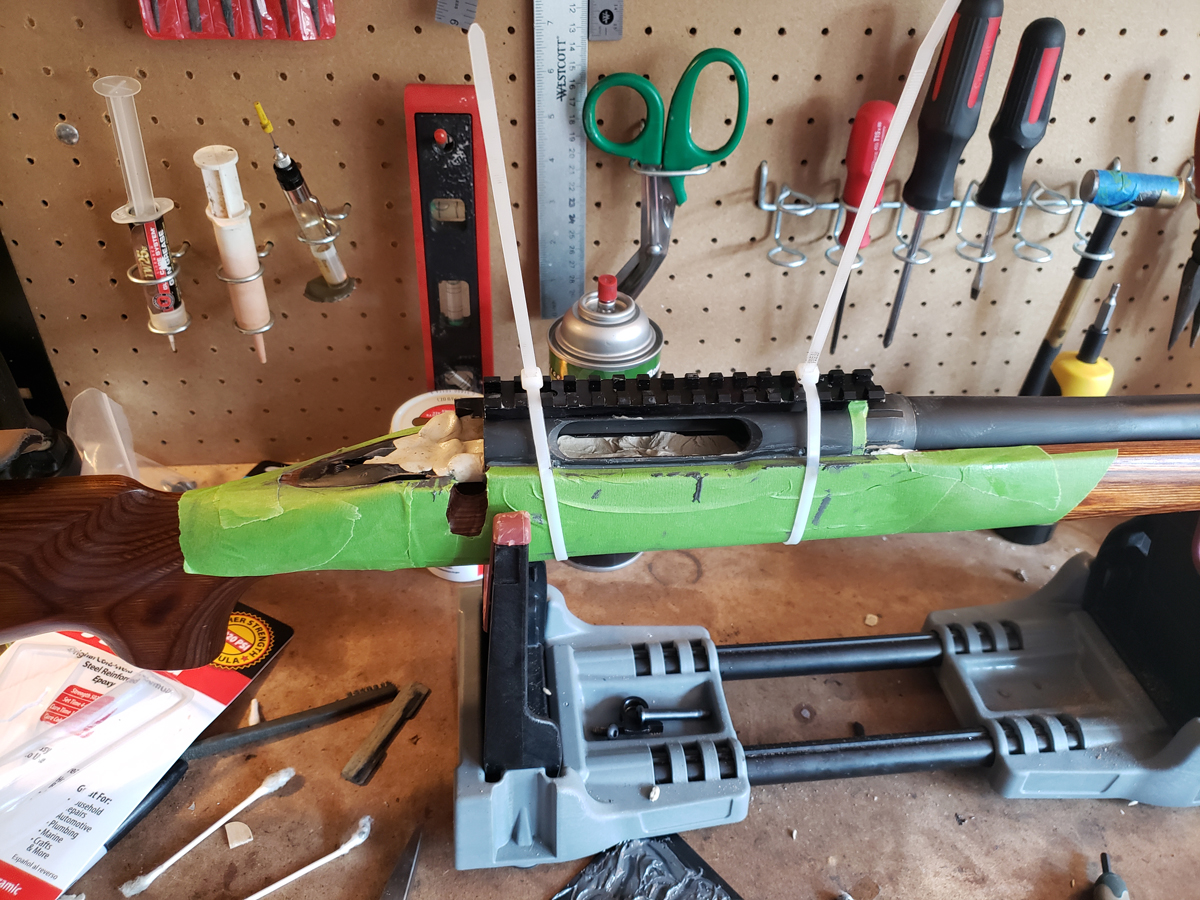

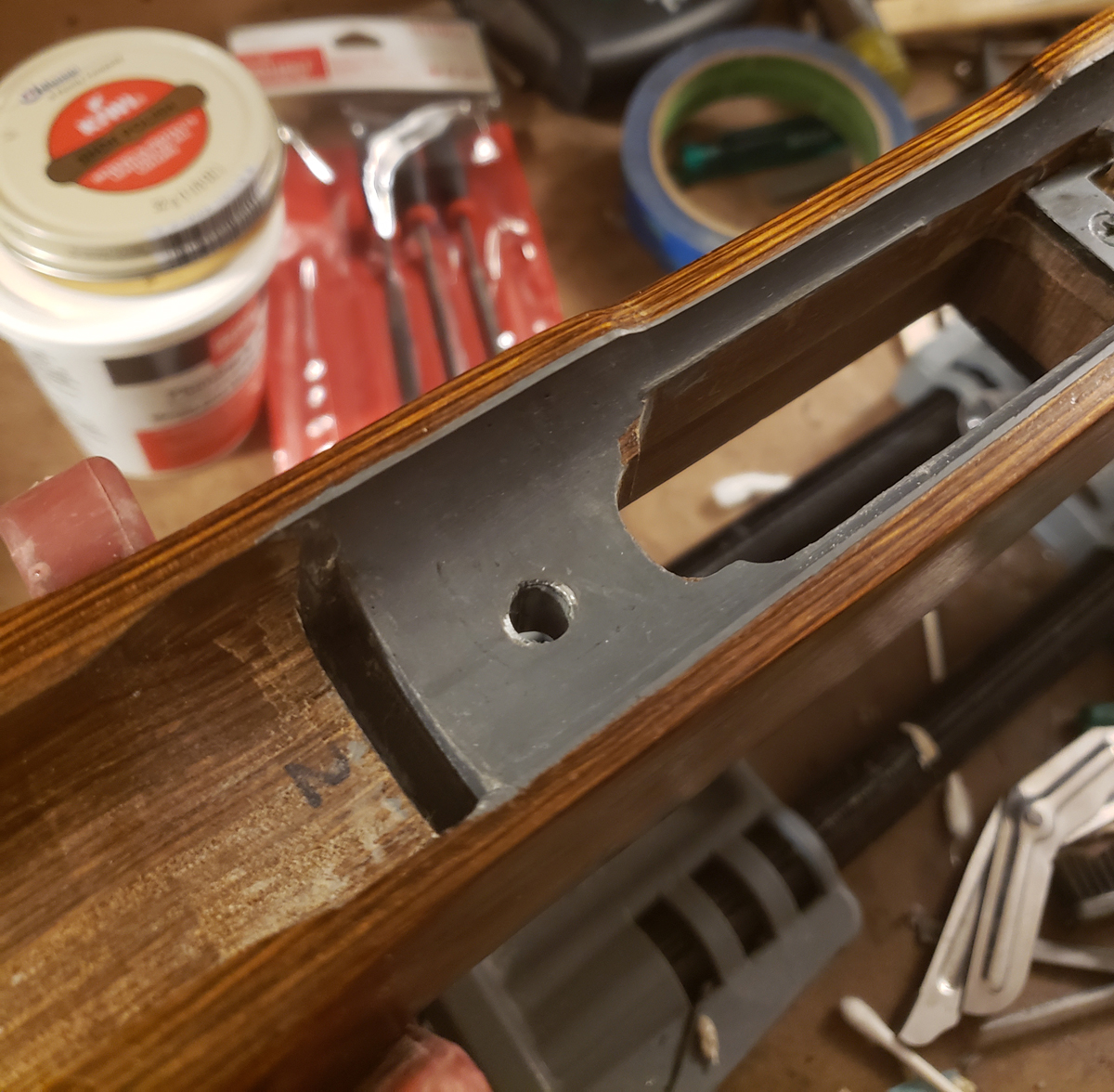

    Ok, I stripped and prepped the action earlier today with plumber's putty and neutral shoe polish, I probably didn't have to go to the full extent that I did just for this pillar bedding job but I plan to skim bed it tomorrow.
    I put wax all over the action screws, tape, and the inside of the pillars while I was at it too. I wrapped tape around the barrel to keep it centered up in the barrel channel and I figured it was just about right when I dropped it back into the stock and it didn't rock or move.
    I mixed up about 1/2 oz of JB Weld, more than enough for what I'd need but I'd rather have more than enough than skimp on the epoxy. The excess would also give me a gauge for how the epoxy is curing too.
    I lined the holes in the stock with epoxy and then slathered the outside of the pillars and pushed them in the holes. I used a q-tip to remove any excess that was in the way of the action screws and inserted the screws, tightening them down to snug. Two 14" zip ties kept pressure on the action.
    I'm going to go up and pop it out of the action in about an hour to see how she looks, I'll report back in a bit.

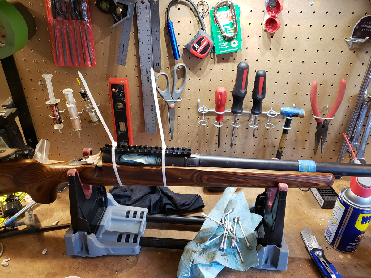

    Update:

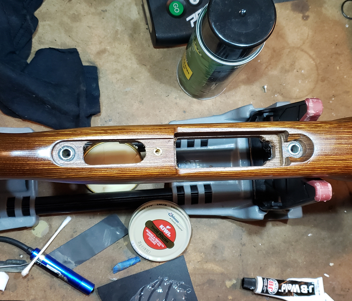

    Alright fellers, it's done. Yesterday, I prepped the area with a Dremel so the epoxy would have a surface to adhere to and mixed up about 3/4 oz of JB Weld. Hindsight being 20/20 I should've mixed the whole tube.
    It's been about, jeez, 10 years or so since I've bedded a rifle myself and damn did I forget how messy it could get, now I remember why I bought chassis. I dropped the action in at about lunchtime and around 7 pm or so last night I figured it was good enough to pop out and have a look. Enter butterfly jitters when it hesitated to come out but I calmed down, clamped the barrel in a vise, held the forend, and hit the butt with my other hand. She popped loose and I was able to take a gander at the destruction.
    It actually wasn't that bad, there were a couple of issues that you'll see but I don't think they're going to be detrimental. The first one was in the recoil lug pocket area where it appears I got the plumber's putty dam too close to the pocket and it flowed into the pocket at the same time as the epoxy. Basically the front and sides are kinda ugly but they don't touch the lug so it should be ok.
    The other area of issue was the pad for the tang, not sure if I didn't have enough release agent or what but it's kinda ugly back there.
    I'm going to see how it shoots before I decide to clean those two areas up. My workbench is a mess and it's dark outside so finished product pics will have to wait until tomorrow afternoon when I get home. All in all, I think it looks good considering what I used to get it done, that being said the proof is in the puddin' so I'll have to see how it shoots before I finally say I'm satisfied.
    Reassembled the rifle this afternoon to get some pics, it was nice being able to torque the screws down to a reasonable amount. When I got the rifle for T&E someone had tightened the rear screw too much and crushed the stock. What this meant was that if the rear action screw was too loose, the tang could float up and down, too tight and the action screw obstructed the bolt. I got by using a washer to keep the stock from crushing too much and going real light on the torque, like 15 in/lbs or so on the rear. Now I have the rear torqued to 30 in/lbs and the top of the action screw is flush with the screw hole, nearly perfect. So far I've accomplished my goals though, I have a cheek riser that has a cleaner form factor than the strap on stock pack I had used and it's now pillar bedded so it has a better interface with the stock.

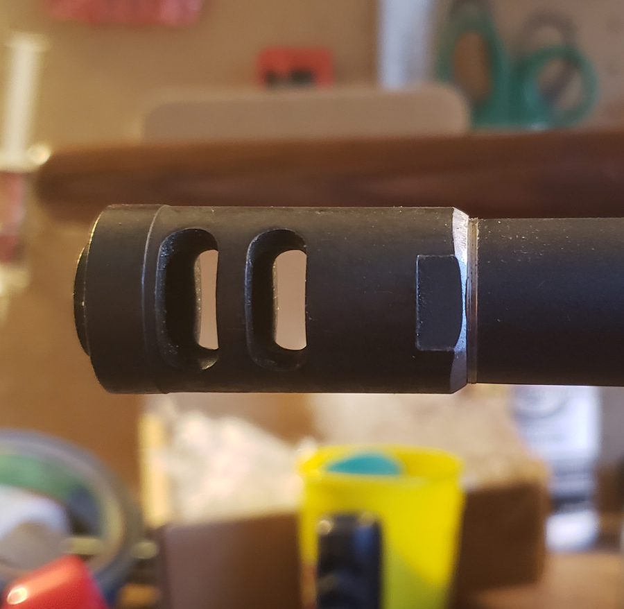

    My next project involves my Bergara HMR and I've sort of started it already. I had a cheap muzzle brake on there with a crush washer that just looked awful. I bought a new muzzle brake recently that came with some small diameter shims that I didn't end up using but worked great on the Bergara's barrel. I thought it'd look better though if the back of the brake was beveled to meet the shims so I broke out the files.
    The end goal for the HMR is a grey barreled action and a camo job on the stock that emulates Kuiu Verde. I might bed it too, I dunno.

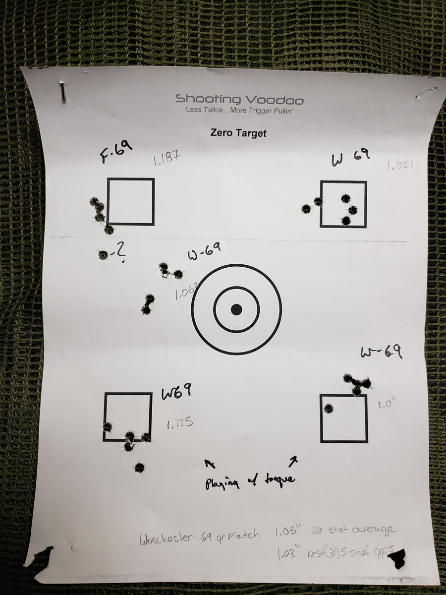

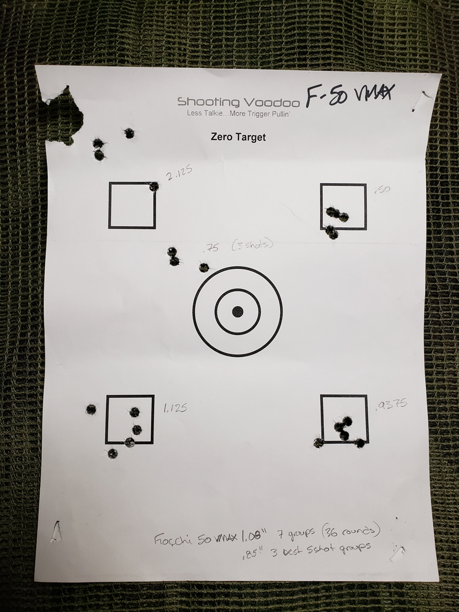

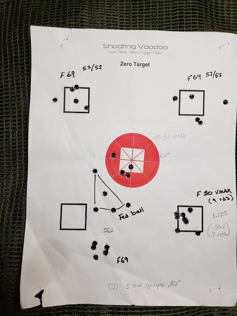

    It was a break even kind of day at the range and while I saw some improvements I also saw some accuracy loss.
    When I reviewed the rifle I shot six or seven different types of ammunition, this time I bought two of the same types that I used before and some Fiocchi 69gr match, mostly because it was cheap. The two types that I used again are Fiocchi 50 gr Polymer Tip and Winchester 69gr Match, obviously not the best ammunition available but sufficient.
    So, during the review with an unbedded/unmodified Remington 783 Varmint the rifle shot (3) 5-shot groups of Fiocchi 50 gr Polymer Tip at a .89" average at 100 yards. Three 5-shot groups of Winchester Match came in at a .81" average. On this range trip the Fiocchi polymer tip ammunition came in at a .85" average for the best three 5-shot groups at 100 yards and Winchester match ended up at 1.03" for the best three groups. That's really not the way I was expecting things to go honestly but that's the way the cookie crumbled. You may also notice that not all of the groups of 50 gr polymer tip are 5-shot groups. During group shooting four rounds wouldn't fire, I saved 10 for shooting at 200 and 300 yards and still had one more that that wouldn't go off.
    During the range trip I tried playing with the torque settings while shooting the Winchester ammo, upping it from 45/30 to 57/57 inch pounds on the front and rear action screws respectively. This didn't seem to generate at significant change for the Winchester match but was downright horrendous with the Fiocchi 69 gr match.
    Two of the five shot groups of Fiocchi came in at 1 3/8" and 2 1/8". After I returned the torque settings to 45/30, the groups tightened up to .562" and 1.187", although it should've been tighter, I broke shot #2 low, shots 1, 3-5 were clustered in a .75" group.
