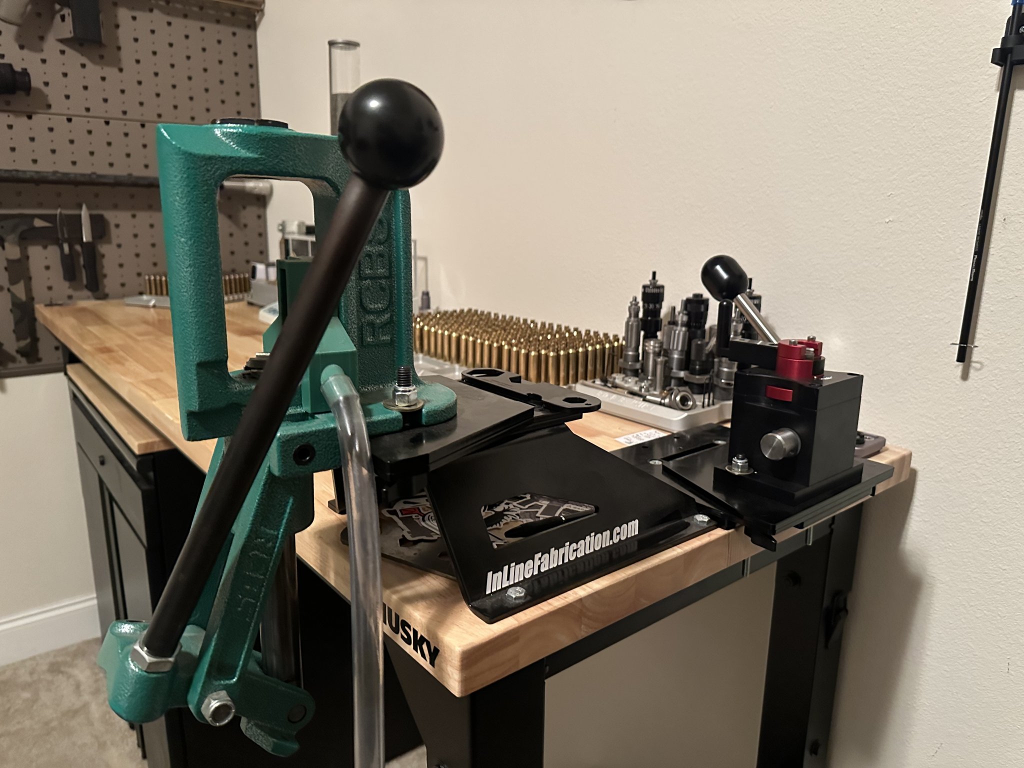

HD has two or three options under $400
I did HD butcher block on top of Lowe’s in stock cabinets. I was concerned the cabinets couldn’t support the presses and motions long term so I made 2x4 frames ( covered with matching dishwasher panels ) that do most of the supporting for the tops. I also made another frame under the bottom of the cabinets that supports the weight on the bottom shelf for projectiles and stuff.

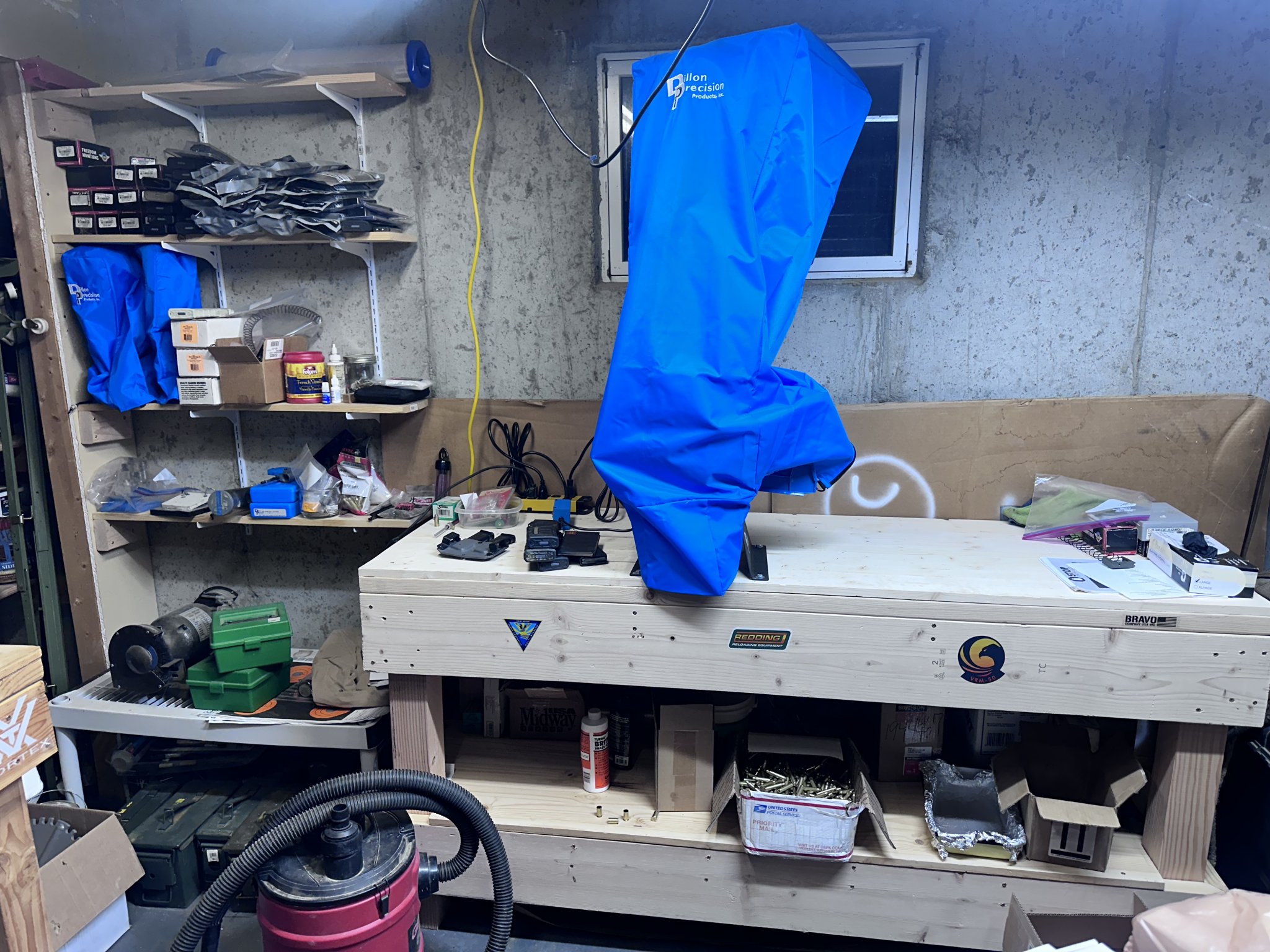

I have something like 1.5” pine that had a slight deflection when pressing. I stuck (glue and screw) a 1/2” or 3/8” sheet of oak under the presse area and no deflection whatsoever. I do need to anchor the entire table better, though.

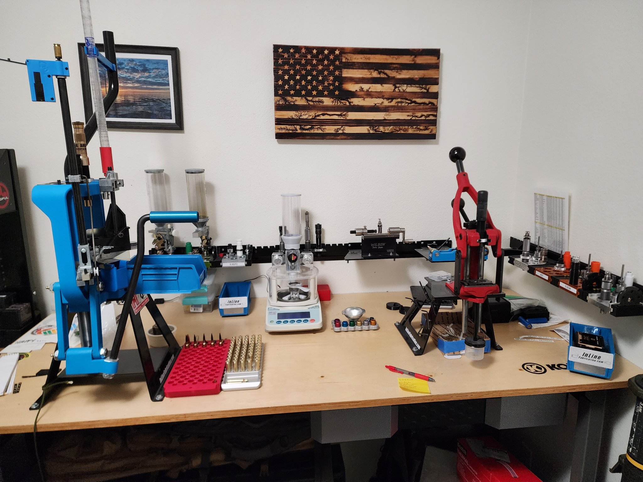

Although my presses are on stands and not benches, I do have some work surfaces. I have a large steel desk that I found on the roadside. I'm not normally a scrounger, but this is a nice steel desk made in the 70's. It's at least 200 pounds empty. At one point, I put it in front of the house with a sign "free" on it, but nobody who wanted it could move it, so I brought it in and adopted it despite not really having the space for it (it's huge).
The reason I want to share this with you is because of the unique surface I put on it. The desk itself has a steel top with a woodgrain melamine surface (not particleboard, but melamine laminated to the steel).
Rubber Stall Mats
On the floor, I put those thick rubber pads for inside a horse's stall. That's where I got the idea to put one over the desk surface. It works great. It very damping of any vibrations. Nothing slides on it or even rolls. It's firm enough that I can stand brass on it (though I would normally use a case block). Whether I drop something on the desk or the floor, the rubber prevents damage more than a hard surface -- think about dropping calipers for example or a die.
The rubber stall mats have been pretty durable and I've had them for almost 5 years now. They might not be resistant to all chemicals, so I would be cautious about cleaning solvent spills or over-spray. To clean the stall mats, I use a shop-vac and an air-compressor blow-gun.

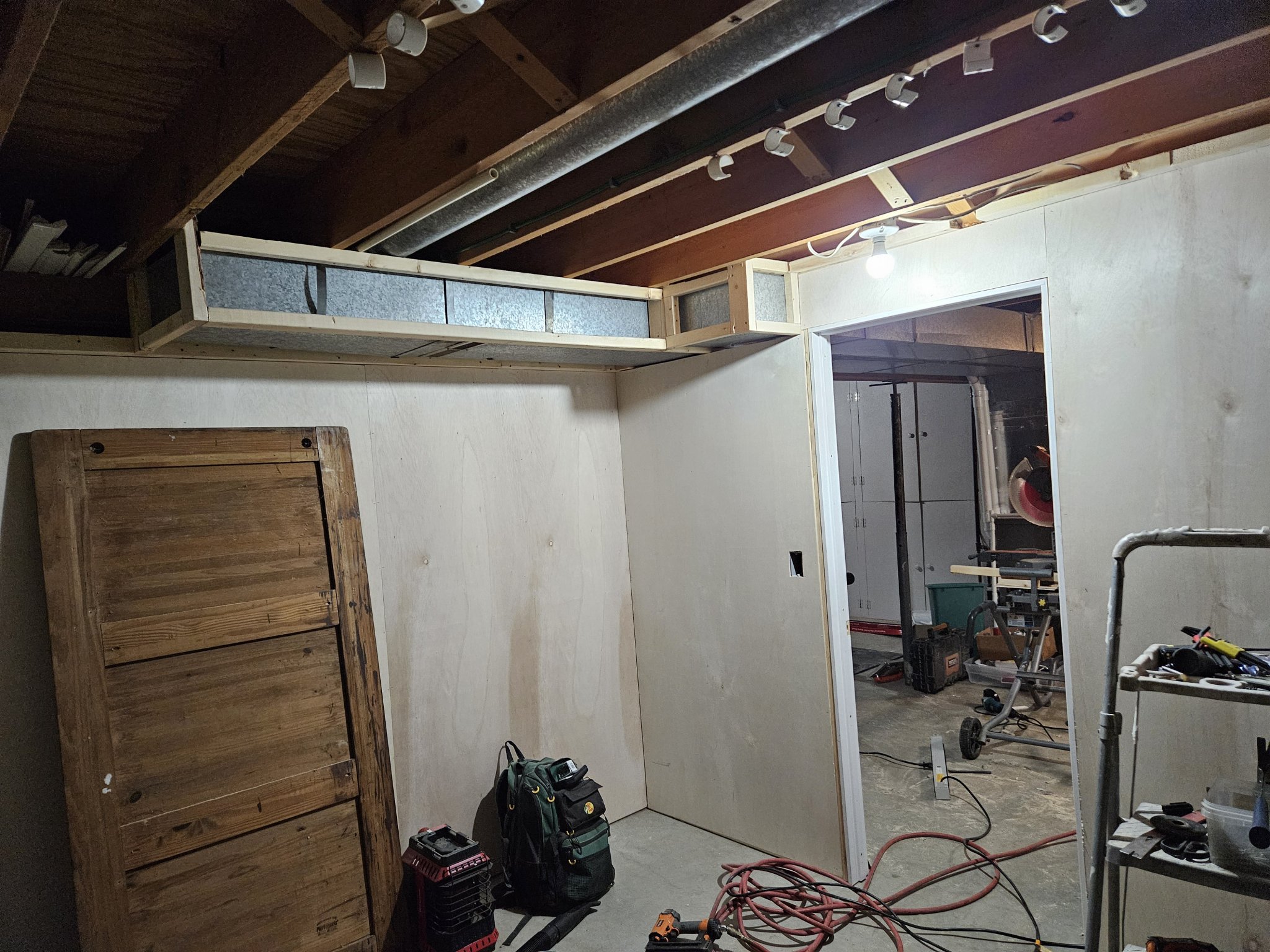

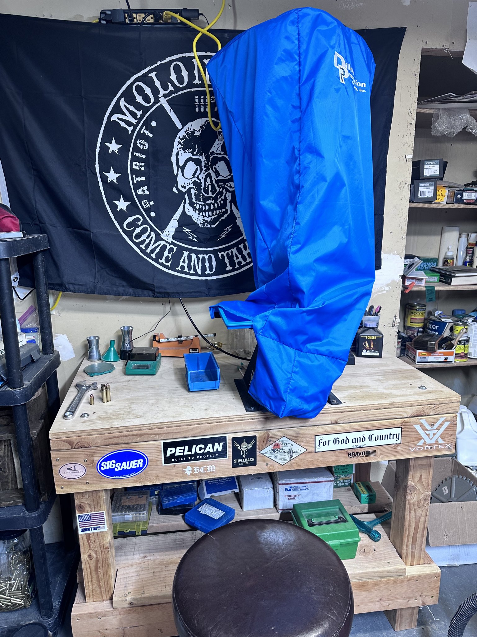

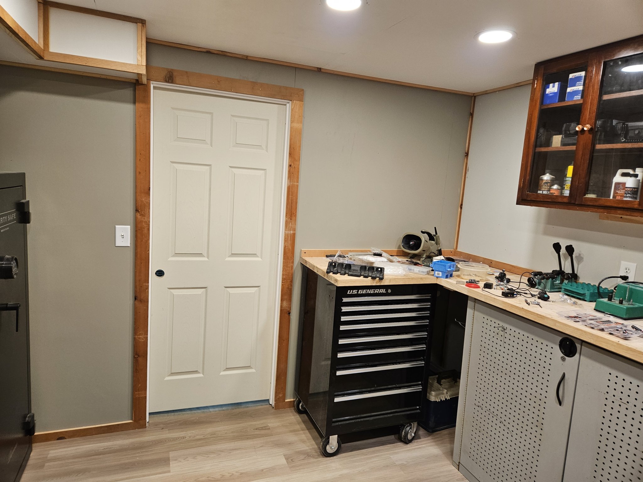

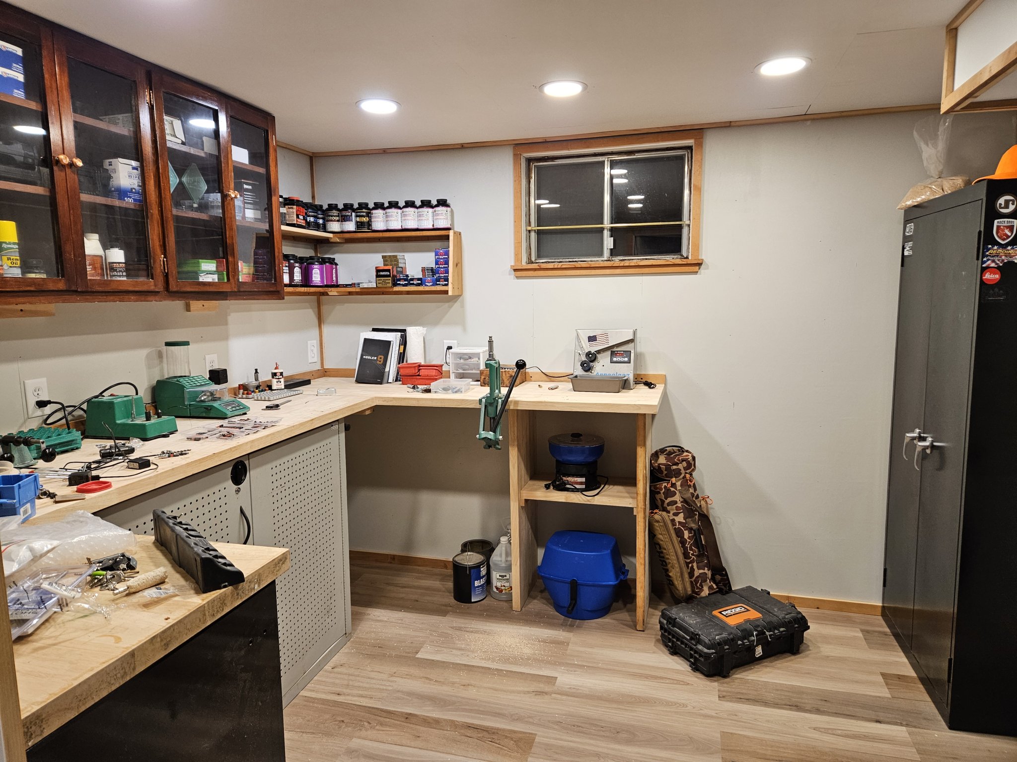

Currently building another reloading room in the unfinished part of the basement. The wife got an at home job and I gave her my current room in the finished part of the house. What your some successes and fails with lighting? I have exposed joists and running a new 20amp circuit just for this room. Ought to be able to accomodate about any lighting I need.
It wont be unfinished anymore. Im finishing a corner about 12x12 its the dead end of the HVAC so ill jerry it up and drop a return on the floor and a vent in the ceiling. Im not against LED strip lights, easy to install and plenty bright, just wondered about more finished options. Thought about 2 runs of leds in the joists with diffisers.
I would recommend LED lighting. Many are adjustable regarding the color and you might find a sunlight type natural color to be to your liking. At any rate, adjustable gives you options, and uses very little electricity. Home Depot has lots of options at reasonable prices. Amazon would be more cost effective. Just know what you are looking for.
LED seems to be the best and least issues with a scale. I wouldn't put any light too close to the scale though. I've not had any issues I know of using led lights. With open joists, you could do can lights or do led garage type lights, like the 2'x4' florescent lights we used to use but they are LED.
Will you ever put a ceiling in it? If so, might want to consider that but otherwise any led light set up should work well.
If you will be putting a sheet rock ceiling then you could go ahead snd put the can lights in and then just sheet rock whenever you decide to do it. Of it's a drop ceiling then the can housing hangs on the ceiling tile so you'd need the grid in first.

There will be a ceiling either tonight or tomorrow, depending on the lights i decide on. Definately will be going LED trying to decide between strips or cans now.
Thanks for the observation, the HVAC vent will be away from the scale so draft wont be an issue, have been dealing with temp swings in the current room too as its just 15' away. My best solution so far is to turn the recirculation fan on when im loading, it helps keep the temp more consistant.
I think the air movement is way bigger issue than temp fluctuations but ideally you'd like to eliminate both of course.
Cans are a lot nicer imo. Also, you can get dimmable led cans wither with a housing or you can use "can-less" which don't have a housing. This gives you the ability to just run the wire and know where it is, then cut the can holes where you want them to be vs having to put the housing in the right location before sheet rock.
That may not matter to you and if not, I'd use a "new constitution can" which is a housing and a led trim. Whe ever they do go out you just replaced the trim. However, if it's beneficial to choose the exact can location after sheet rock, go can-less. We really only use canless when there's a joist in the way of where we need it, or if it's a special ceiling (like T&G) or some other reason we would want to space the can trim perfectly so it looks perfect.
Just plan your can placement so you have lights over the bench and spaced out from the wall enough to accommodate cabinets on the wall, so a light doesn't end up half over a cabinet , and you will be good. Of course if you aren't being inspected, just run a "uh oh wire" between two joist where you want it and back to your switch box, and if you don't need it don't tie it in. If you do need it, you've got it and can put can less in after sheet rock without issue.
The only thing to watch out for is that often the canless cans baffle or trim won't match the led trim for a new construction can, but you certainly can get them that do match, just have to pay attention to it.
Also just fyi- often the can less hole size that you need to cut out is not the same exact hole size as you may think so make sure you have the right hole saw before you cut it out or you will be putting "goof rings" on all your cans

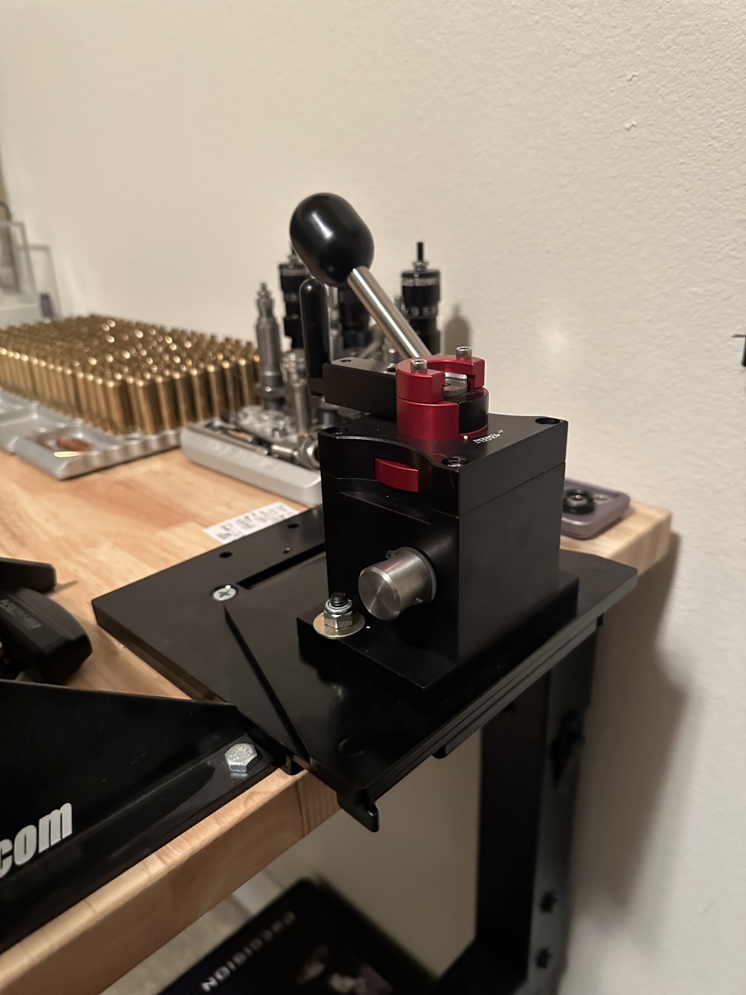

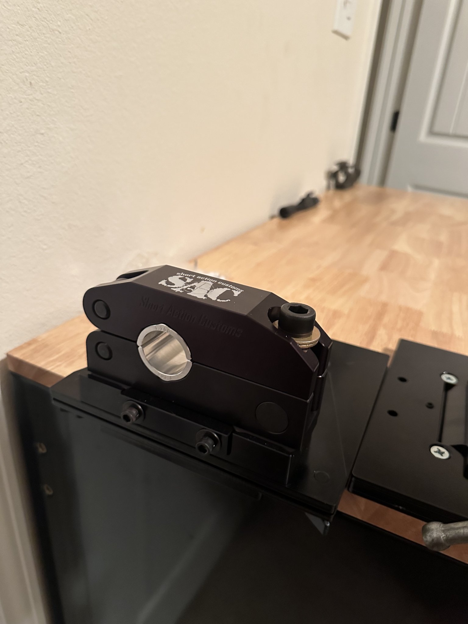

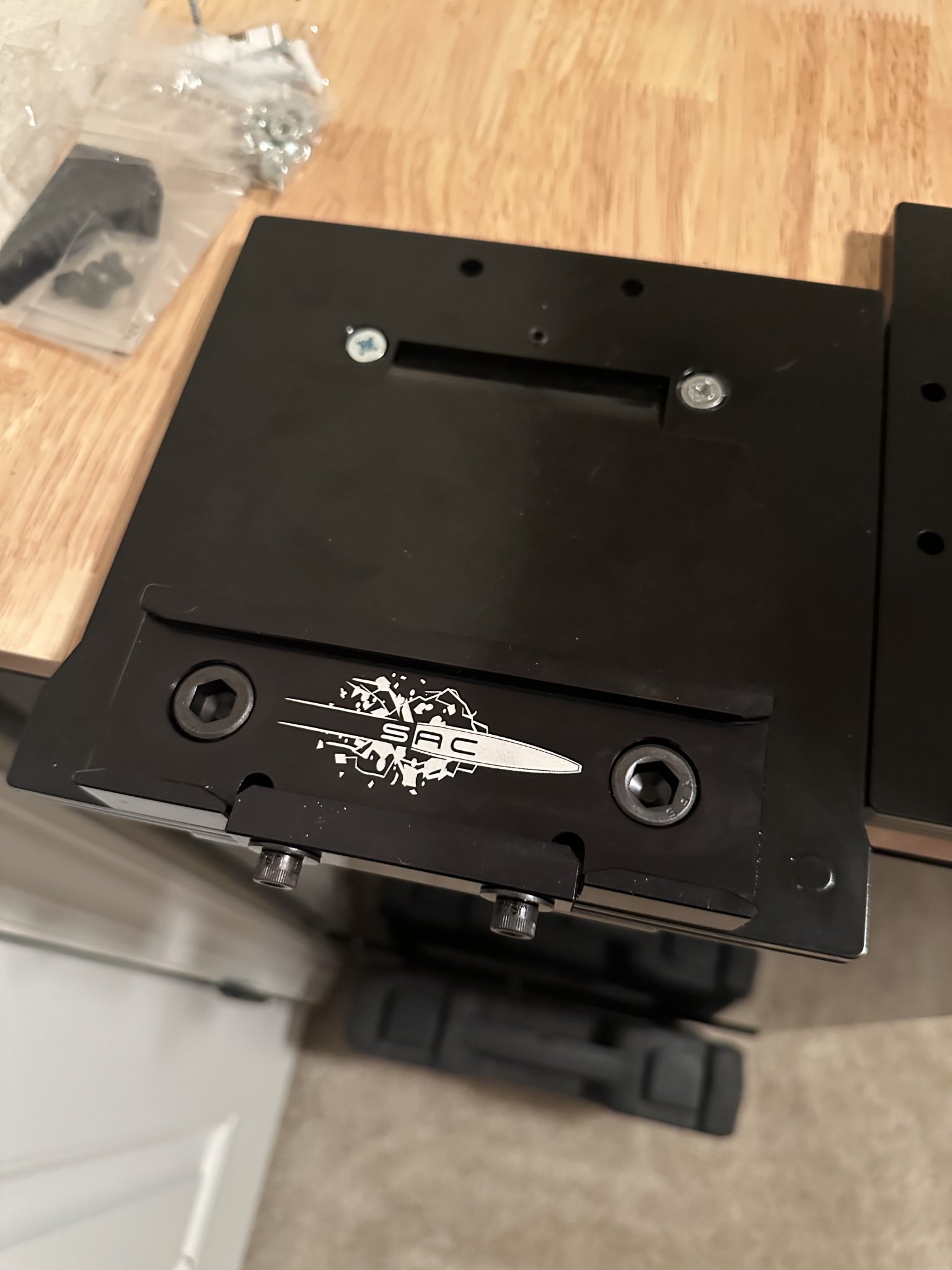

These quick ultra mounts from inline fab are awesome and he has most stuff already designed the plates. I can easily move any of my tools anywhere depending on what I’m doing

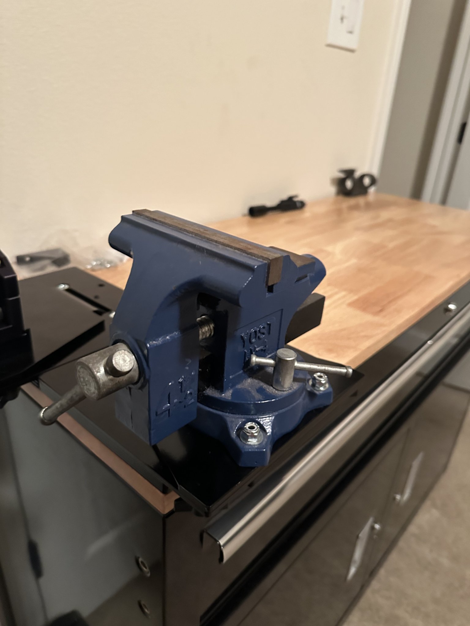

Waiting on one more for my zero currently.

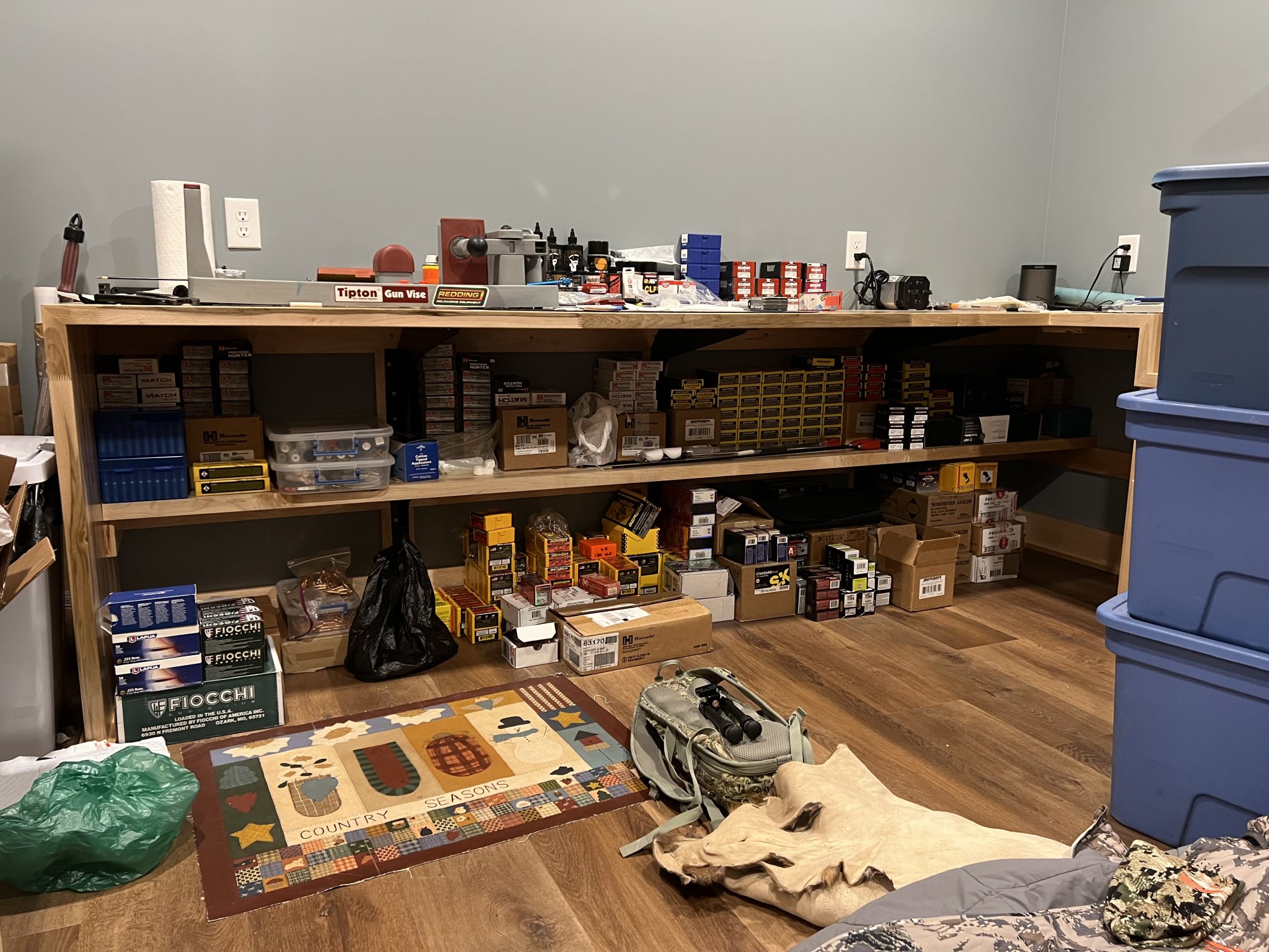

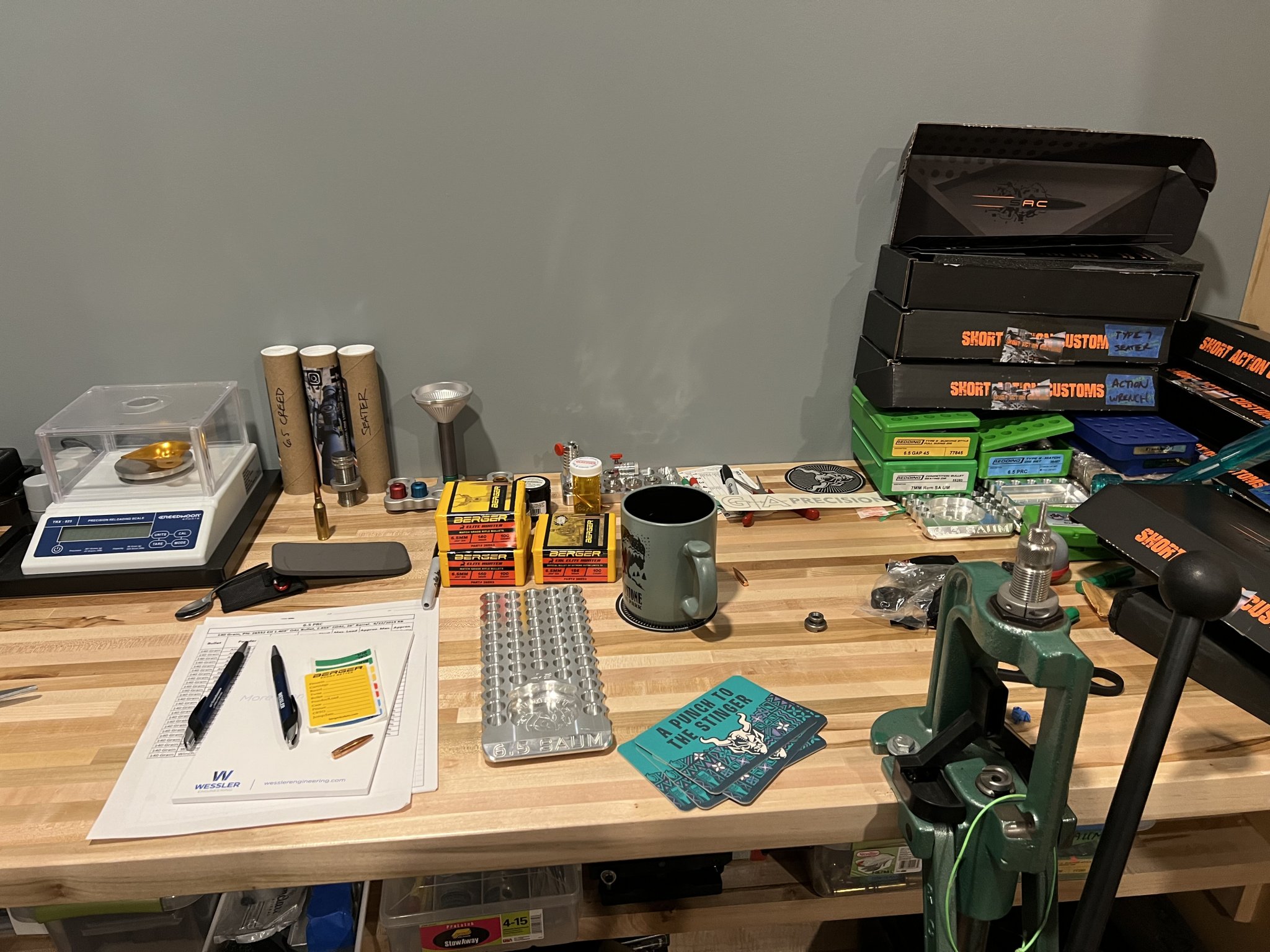

I am sort of embarrassed to show mine after how neat everyone else's is, but I know where things are, and it is organized for how my brain works. I just put in the second bench with 650. Finally have one setup for large and small primers, lot easier to reload and not be changing between them. I wish I didn't have to have all my electrical running off of one outlet through two surge protectors, but I don't know what else to do. Need better lighting, and to change the placement of them.
This bench is the third I built, and is really stable, just wish it was longer.
Fourth and last bench I built. Canabalized wood from my second bench for some of it. And it has the new (to me) second of my 650s. Just got done trimming a couple thousand pieces of 556 on it. Love the Dillon rt1500!
I get to claim the small excuse of a basement at the new house, so things will be rearranged. Inline fab has been a life saver for pretty much everything I could ask for up to this point. However, I started 3d printing my own toolhead holders because 20 bucks each stacks up quickly.

My work top is double 3/4" plywood with 4 x 4 posts and 2 x 6 framing.
First layer of plywood was screwed down. Then a coating of wood glue.
Second layer (work top) was installed and stapled on the underside with 1 1/4" staples. No fasteners exposed on the top surface. Works very well.
