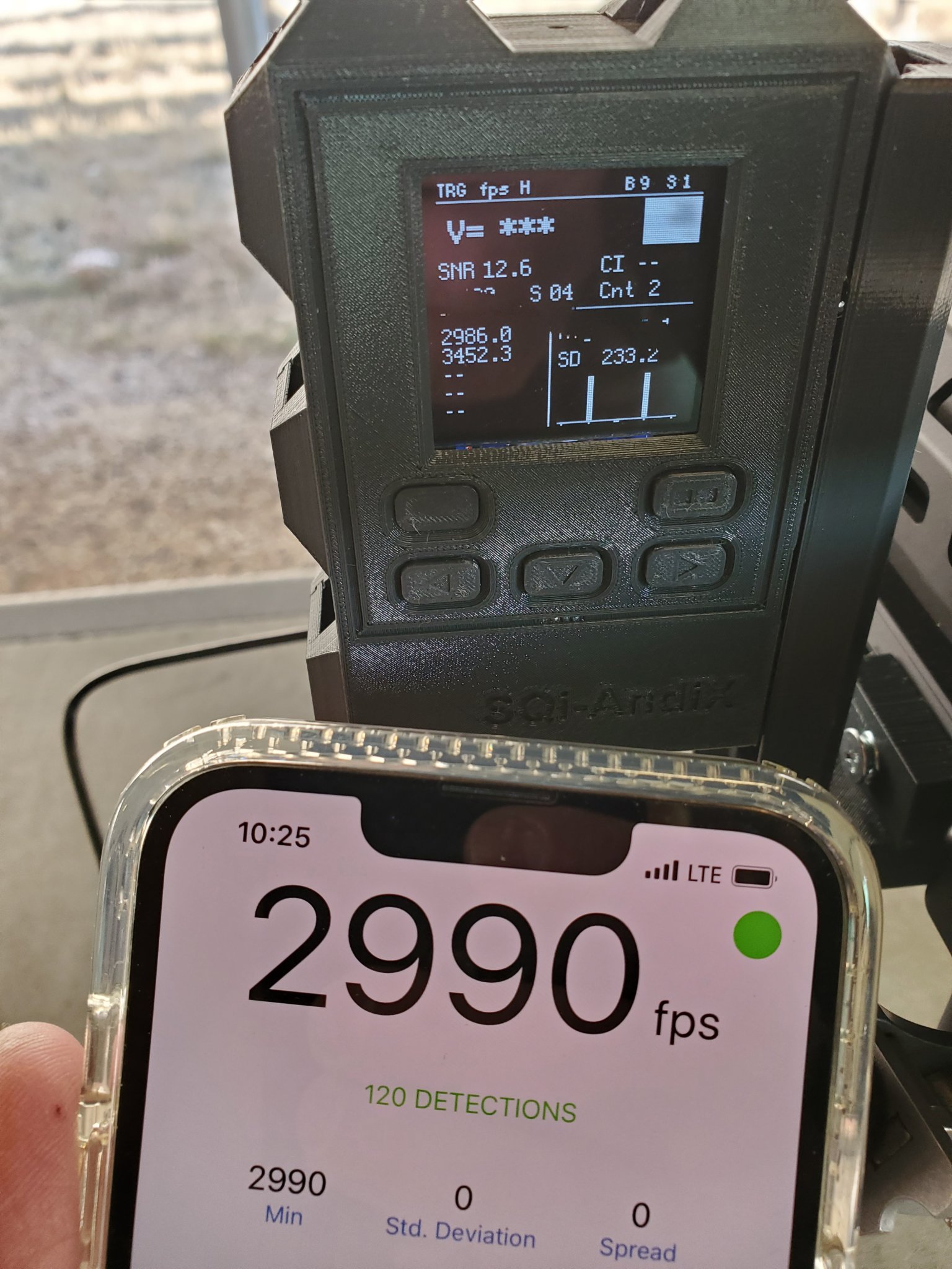

So I took my bs4 out again and before I did I tried what tenerio was talking about. I rebooted my tablet in safe mode cleared the cache on bs app deleted then reinstalled got out of safe mode then went to the range and I tried it in airplane mode but with Bluetooth on and it worked excellent. I had 0 issues and it was on and connected the entire 3 hours. Hopefully the next trip will work out the same lol

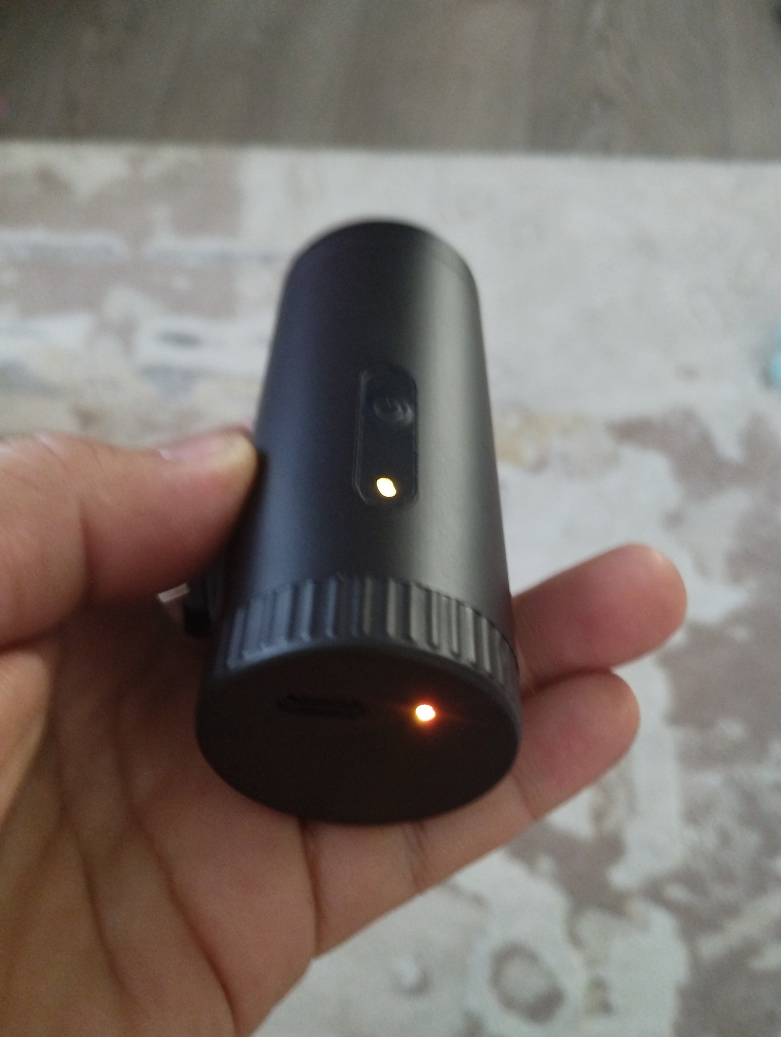

Well.....I was finally bitten by the BS4 bad luck. Yesterday at the range I turned it on and the green light came on immediately. It would not connect to the device and would not turn off. 24 hours later the green light is still on and the BS4 cannot be turned off or used. Anyone have any suggestions? Anyone know if there is a hard turn off procedure or some way to reset the BS4? It worked as advertised for 4 months and then went off the rails yesterday.
Leave till battery dies and when you recharge it and turn it on again it will probably work like nothing happened again, happened to me once ,i couldnt turn it off.
Reactions: parshal

When mine got stuck on the light it took 24 hours for it to die. That's interesting yours is taking so long. Once it cleared I've been good to go.

Ran the BS4 today after the great reset and everything ran well again. I also have an Andi-Scan and ran them together for the first time to compare results on the same shots. AS was a few fps slower than BS4 but very consistent results with each other. 2990 compared to 2986 on the shot shown in the pic.
