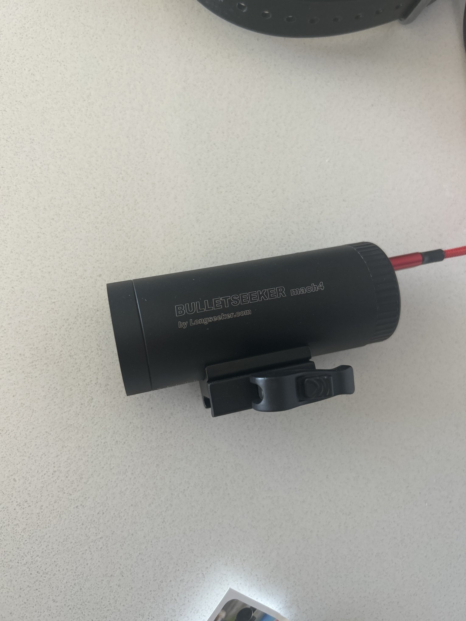

No, the green light is on, and it WILL turn back off. Just no flashing blue light when it detects a shot, and it won't detect anything in front of it. It connects to the app just fine. Everything works fine on it, except doing what it's supposed to fucking do...Detect velocities... It's like the radar unit inside it isn't operating. It picked up 3 movements of my hand in the first shot string, and then nothing...I've asked the manufacturer numerous times how to reset them and never received a response. The only thing I have been able to do is let it sit until the battery dies, which takes 4 to 5 days, and then recharge it. I heard the new units don't freeze up, but apparently they do if yours did. I don't think there is a way to hard reset them. IDK. Sad to hear the new units are bad too. If the green light is on and won't turn off, you're screwed until the battery dies.
So what mine is experiencing is a common issue? When your’s did the green light of death, did the unit freeze and stop reading velocities and stop flashing the blue light, too?It was for me. I use it nearly daily. I did have the green light of death where I had to wait until the battery died but it's been good to go since.
Mines a new unit. Got it 2 months ago.so whats the verdict? Is this thing a worthy replacement to labradar, at twice the price, to boot?
That's what I'm working on right now...Hopefully it will be drained soon. Should be getting close by now.Mine went green and never responded. I can't remember if the app was able to connect or not. I'd let the battery drain it, charge and try again.

Just tried it on an old iPhone 7 I had laying around from years ago, that was running a REALLY old version of iOS. Still didn't work. I'm going to update it to the newest available for it, I think it's iOS 15.7.something. And see if it works?I've had readings of 750 or so but that's usually when my phone is out in front of it or some other electrical device.
Have you tried to connect to it with a different phone or tablet? It seems really weird to have the same problem with two different units.
Phone is never in front of it. I'm killing the battery again, to see if fixes it, and to see if it does the weird ghost readings again.I haven’t tried it inside. I just use it on the gun. Just make sure your phone is not on front of it.
Yes. I tried both configurations. As it was also on an AI where the rail is set back, I also had differing mounts that placed the unit on the rail, and also at two differing positions forward in case the 20degree cone was being affected by the barrel.Did you try using the funnel adapter on the TS? Mine would not pick up my 300 PRC with a brake without the adapter.
Had almost identical experience with ST and ended up returning mine.Sorry to post with the link to my other posts, but I tried the ST and sent it back. My shooting buddy has a ST and it seemed to work well for him with his 6.5CM. It didn't work well with my 300PRC, but I bought one anyways thinking I could tweak the positioning to cut through the PRC's plasma cloud. While it would pick up shots from my 6BR, it would not pick up shots from the 6BR suppressed or shots from my 300PRC (unsuppressed). I tried multiple mounting positions with no luck. For $1,100, it just just flat out work. I returned it Midway while my return window was still open.
