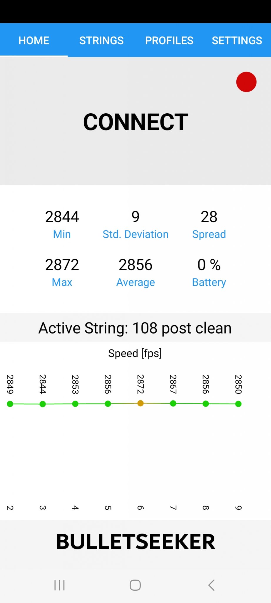

Does anyone know what the colors of each shot indicate?

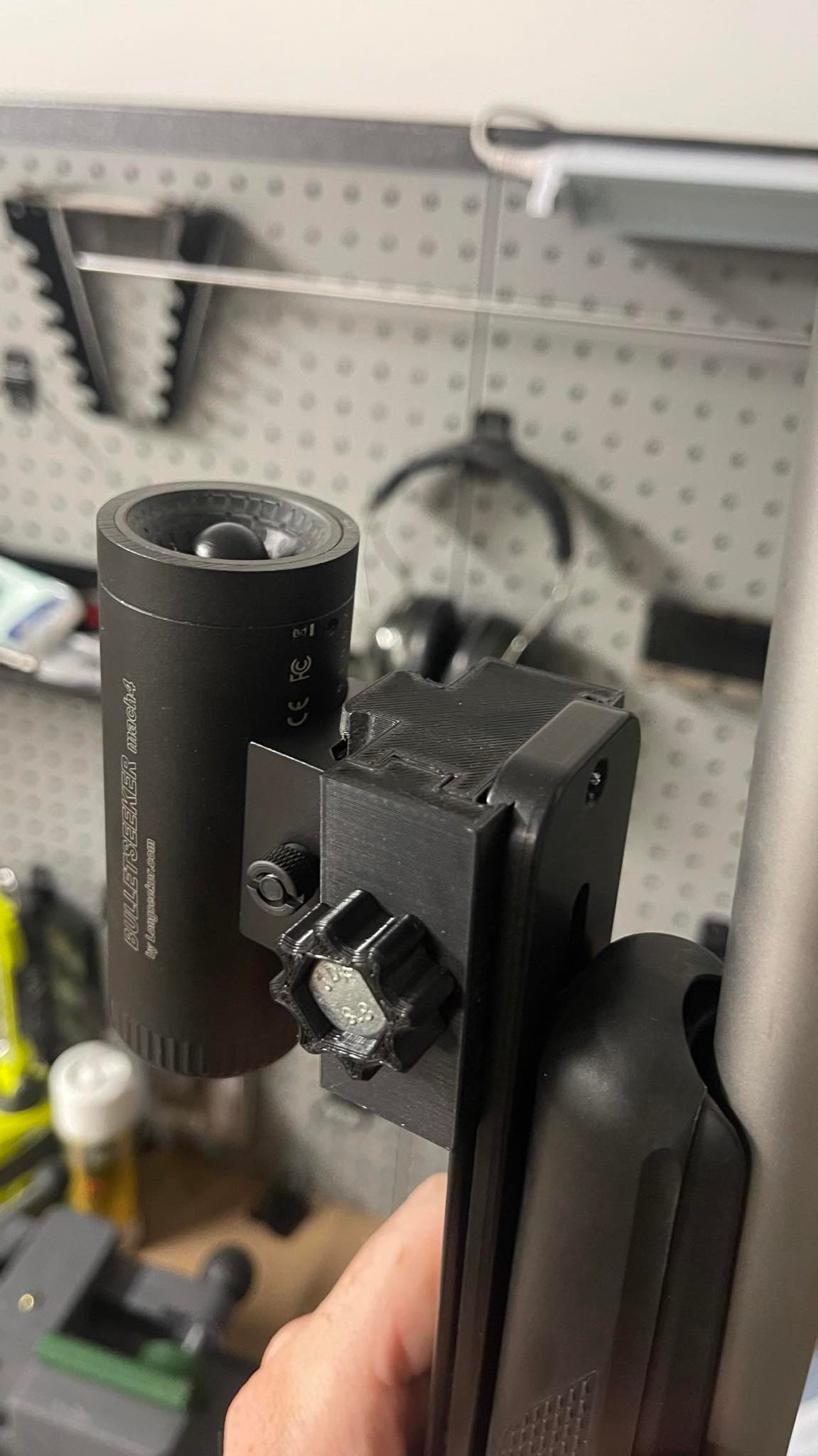

I just read a thread on the accurateshooter forum that someone solved the speedtrackers missed readings issue with a 3D printed picantiny rail at an angle. It seems that he wnated to cross the barrel line with the speedtrackers line. He reported that this solved his issue with the .22 LR readings and is planing to to the same thing on his 6,5.
I'm going to do the exact same thing with mine in the near future :)
Also the case with my 3d printed mount its alignment is maybe a couple of degrees off and mounted on one side fails to read most of the time , mounted on the other i reads all the time ,

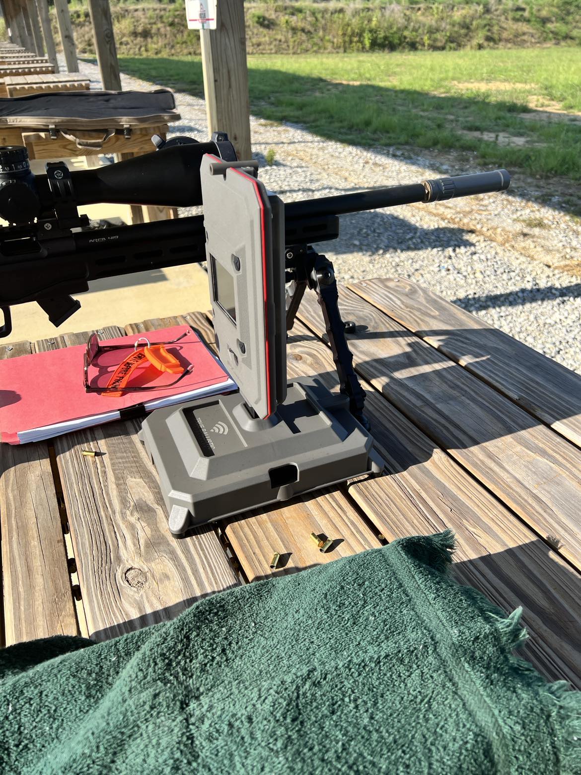

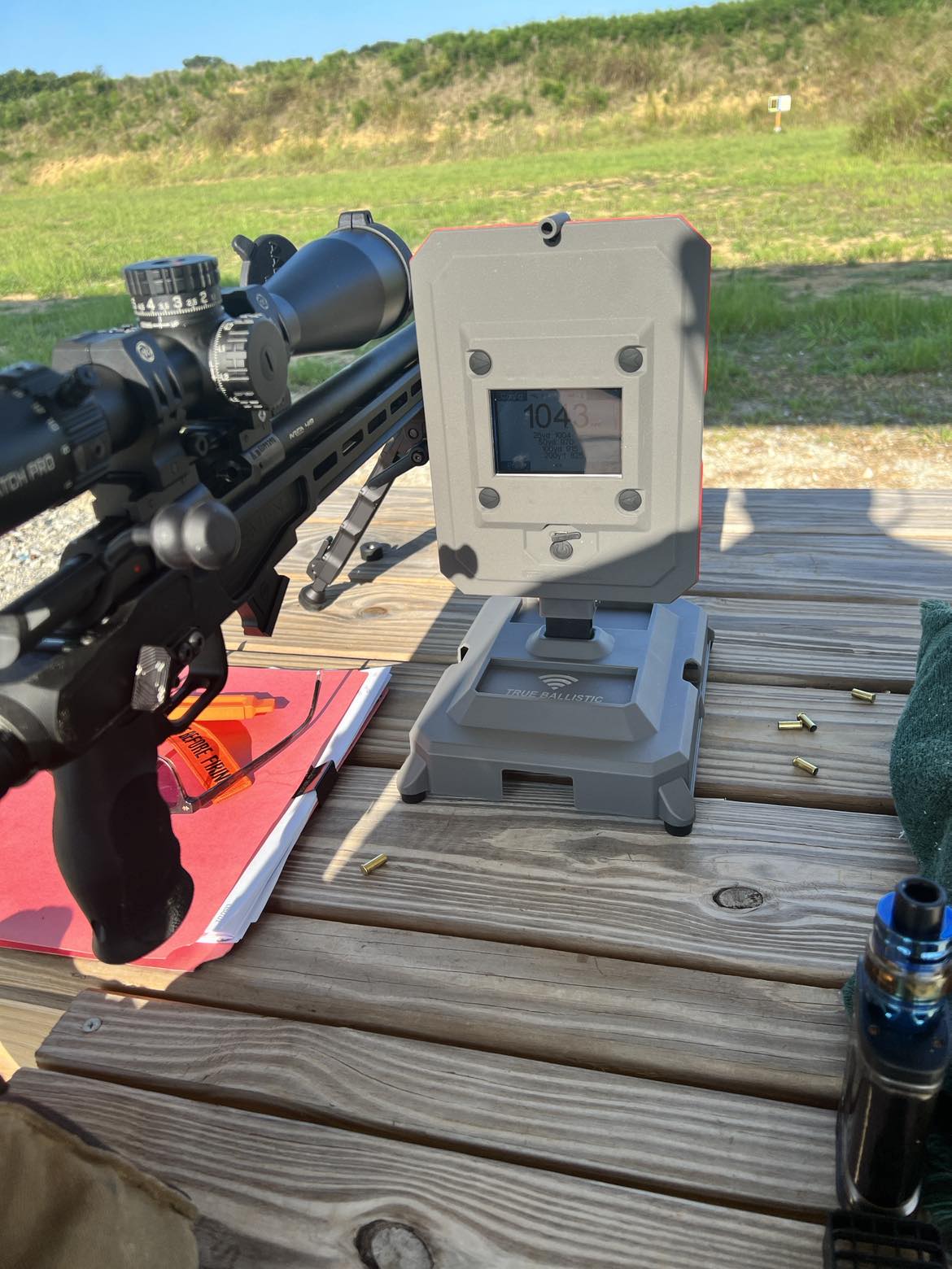

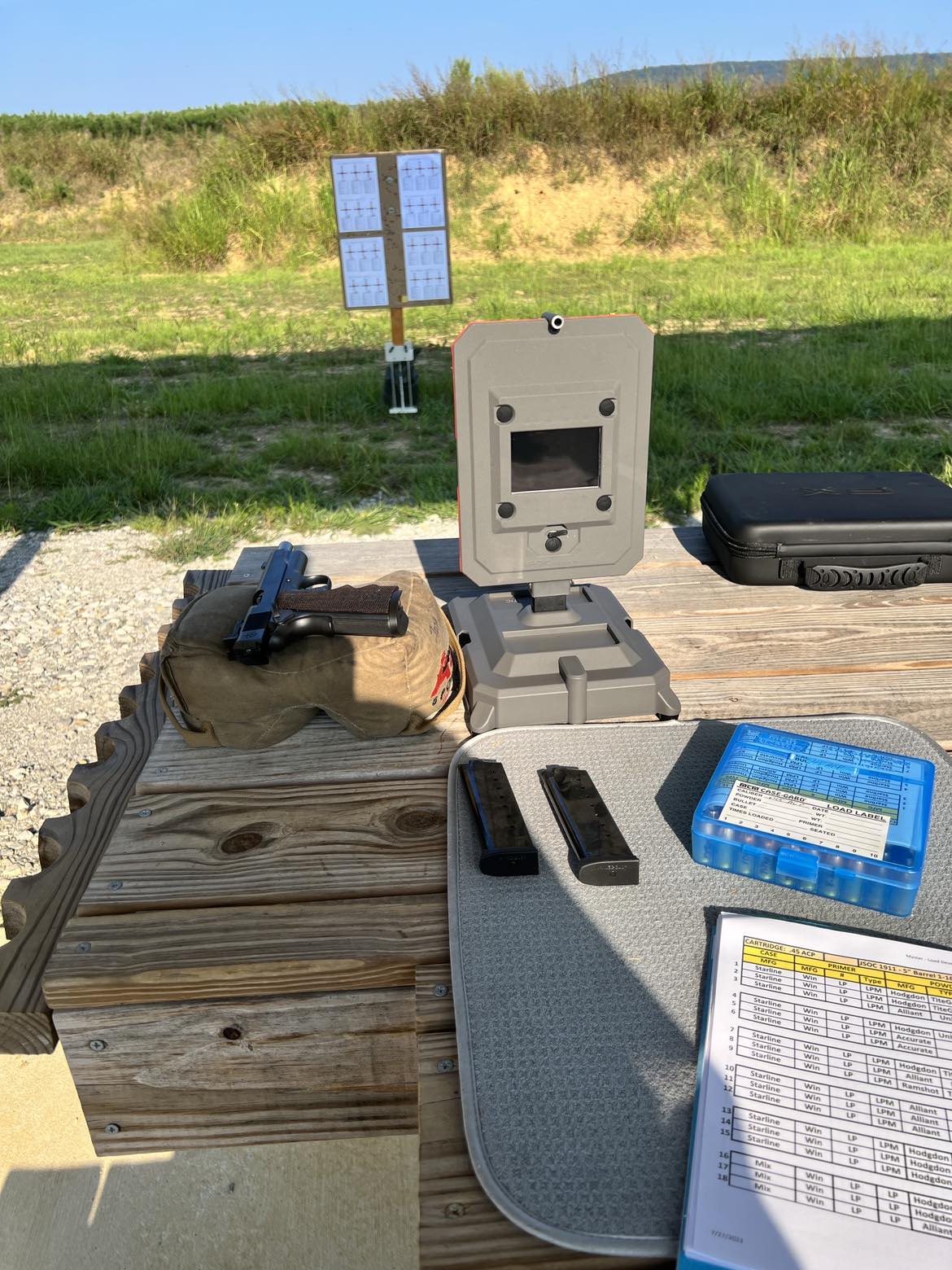

I've had the FX True Ballistics radar unit now since June 2023. I want to say it is the easiest to use, have not had any miss readings and the battery use is great (4 hours of using it and 75% power still remaining). I can go two full days without worrying about the battery. The only complain i might have is that their app was as good as the Bulletseeker one. You don't have to use the APP. However, to keep the data, you use the APP..45 ACP testing.jpg
I've have used it on my center fire rifles (308, 6mm ARC & .223), Rim Fire and Hand guns (22lr, 9mm and .45ACP).
Reactions: FredHammer and FuhQ
I've had the FX True Ballistics radar unit now since June 2023. I want to say it is the easiest to use, have not had any miss readings and the battery use is great (4 hours of using it and 75% power still remaining). I can go two full days without worrying about the battery. The only complain i might have is that their app was as good as the Bulletseeker one. You don't have to use the APP. However, to keep the data, you use the APP.View attachment 8206783
Do you ever shoot suppressed over it?
