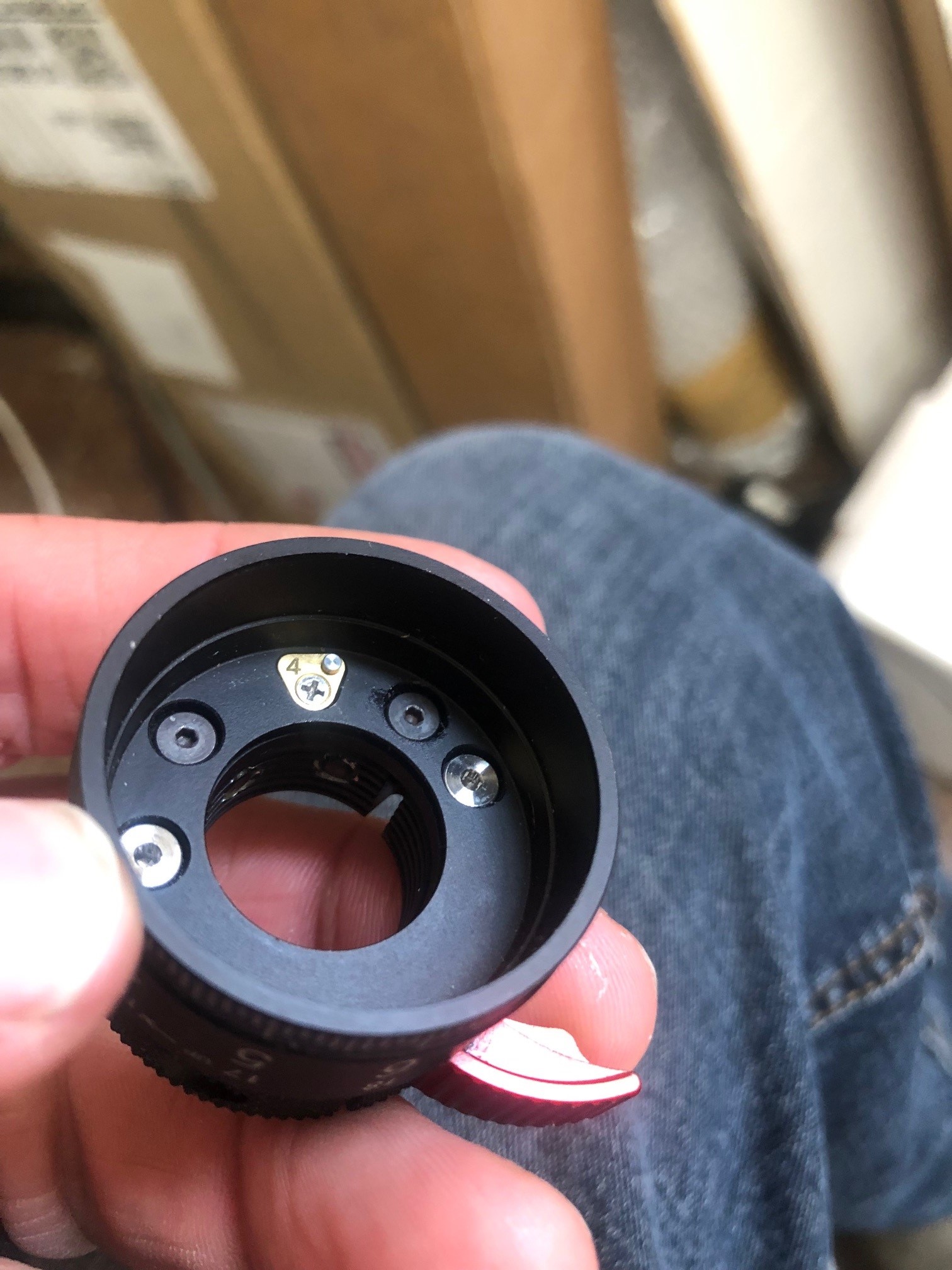

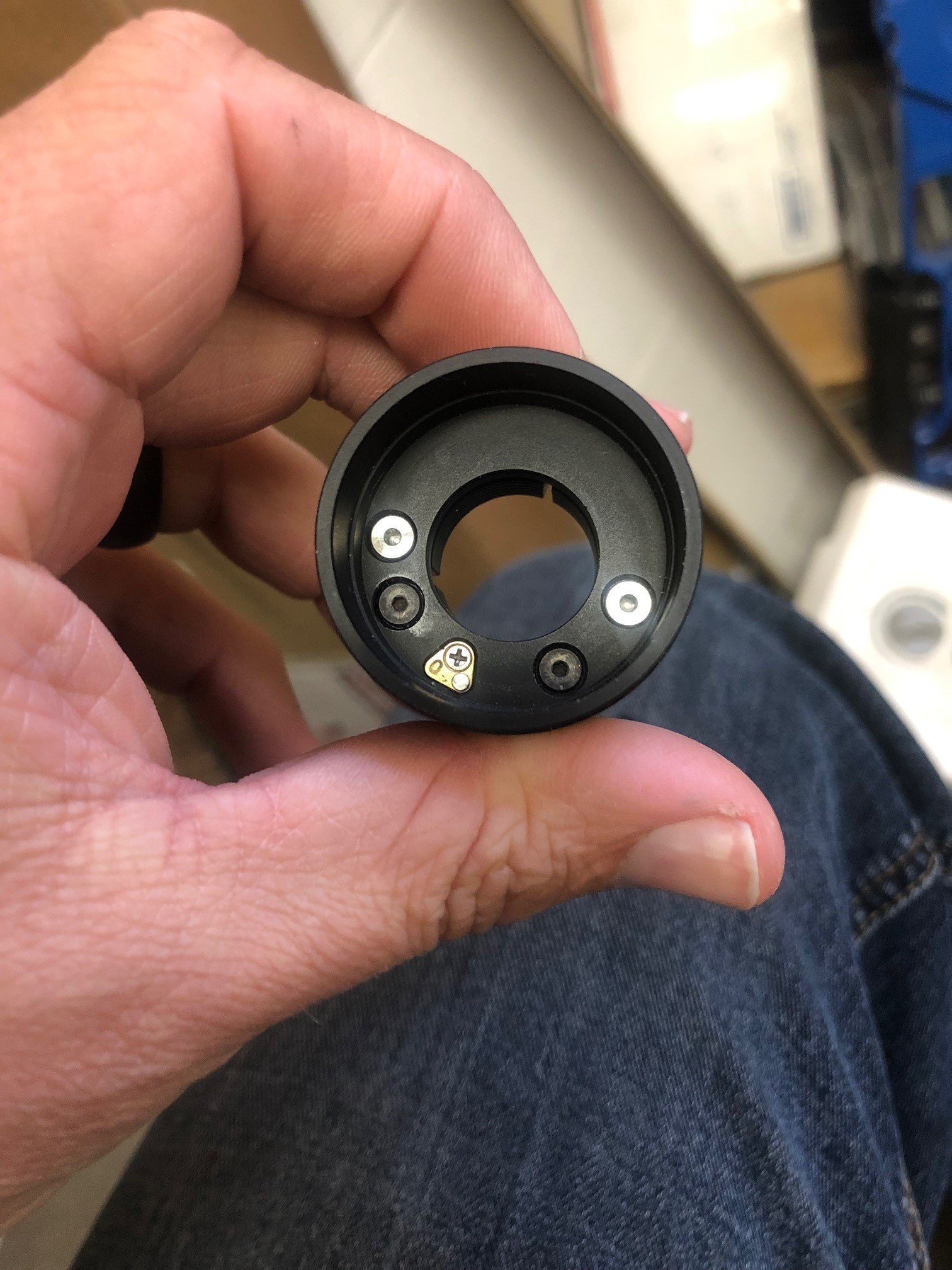

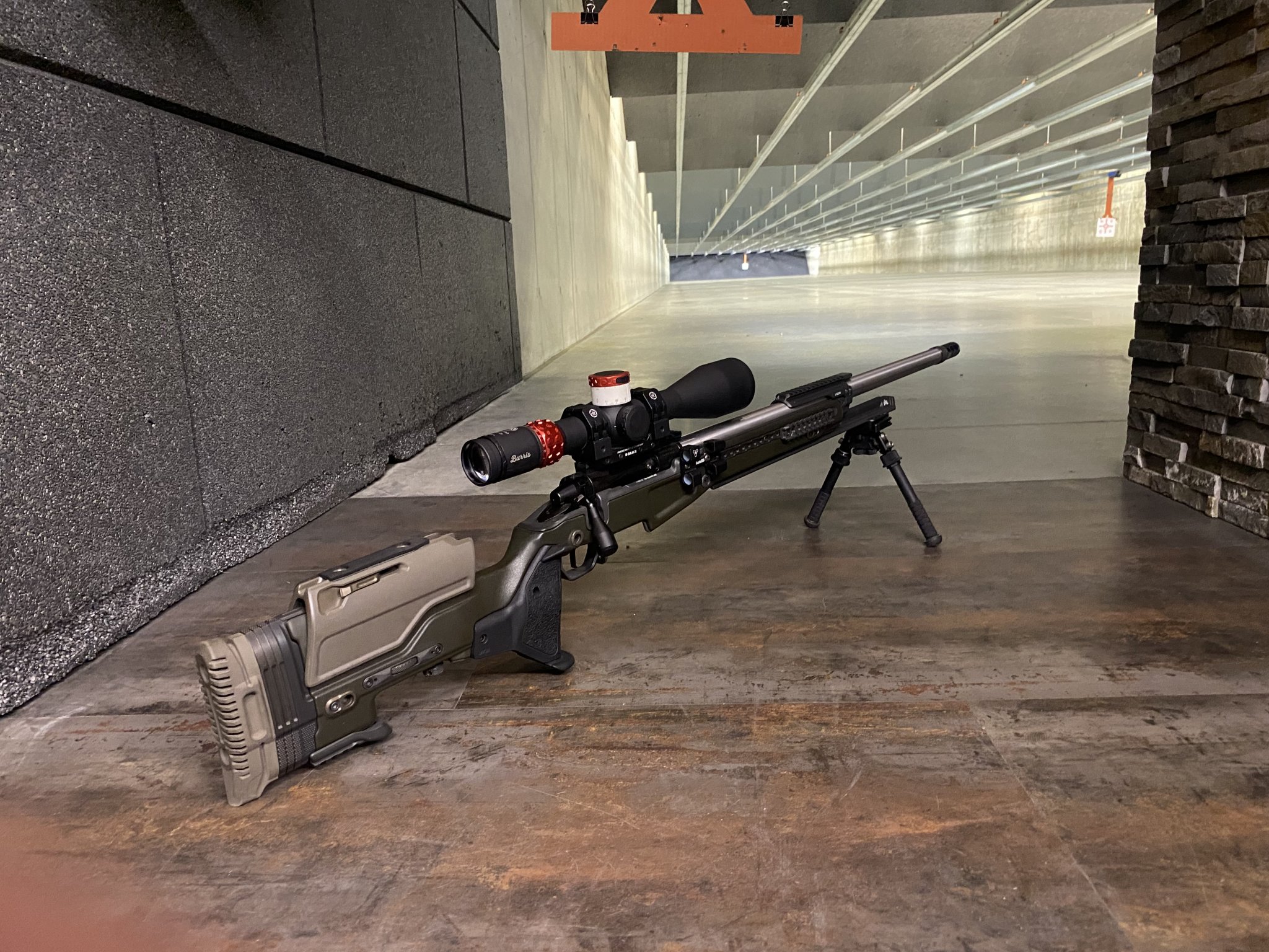

under the turret is a brass triangle.
Factory setting stops the turret at 0
Flip it over gives a -0.4
take it out and it can go down till turret hits. All scopes will be different here. Will not effect function.
added the 4
even switching barrels, which I do alot with all these divisions and weight classes popping up, having that .4 under has been plenty. if its more than .4, its super easy to loose quick detach turret and go up to 2 mils and tighten quickly without allens. I agree tho it sure is nice having the ability to dial below zero.
added the 4
added the 4

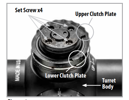

The ATACR is more complicated. The ZS in my ATACRs is set differently.
There is a clutch plate when you remove the turret that sets the ZS. See photo from the manual.
It allows you to set it below zero to practically whatever you want.

The ATACR is more complicated by a little. The ZS in my ATACRs is set differently.
It allows you to set it to practically whatever you want.
Not debating about the amount you need. When I switch from 308 to 338 LM, I believe I need a little more than 0.4

ok so I played some more with the brass triangle.
on my 6.5x47 with 20 moa base and 100 yard zero
I have 21.3 mils of up to dial. that was cool to see. (IIRC I had very similar to that on my rimfire with a 50 yd zero)
pulling the triangle out, and pushing the turret all the way down gets me -.7 on my scope. I imagine it will be close with most rifles.
heres the catch I cant believe I didnt think of before, and what the tooless quick detach turret allows: if you loosen the throw lever and lift up the turret even a tiny bit, and re-tighten the throw lever, I instantly had 3 mils under I could dial.
So essentially it is a super easy super fast way to have as much under zero as you desire that you could use in a match situation or leave on all the time.
GL!
DT
