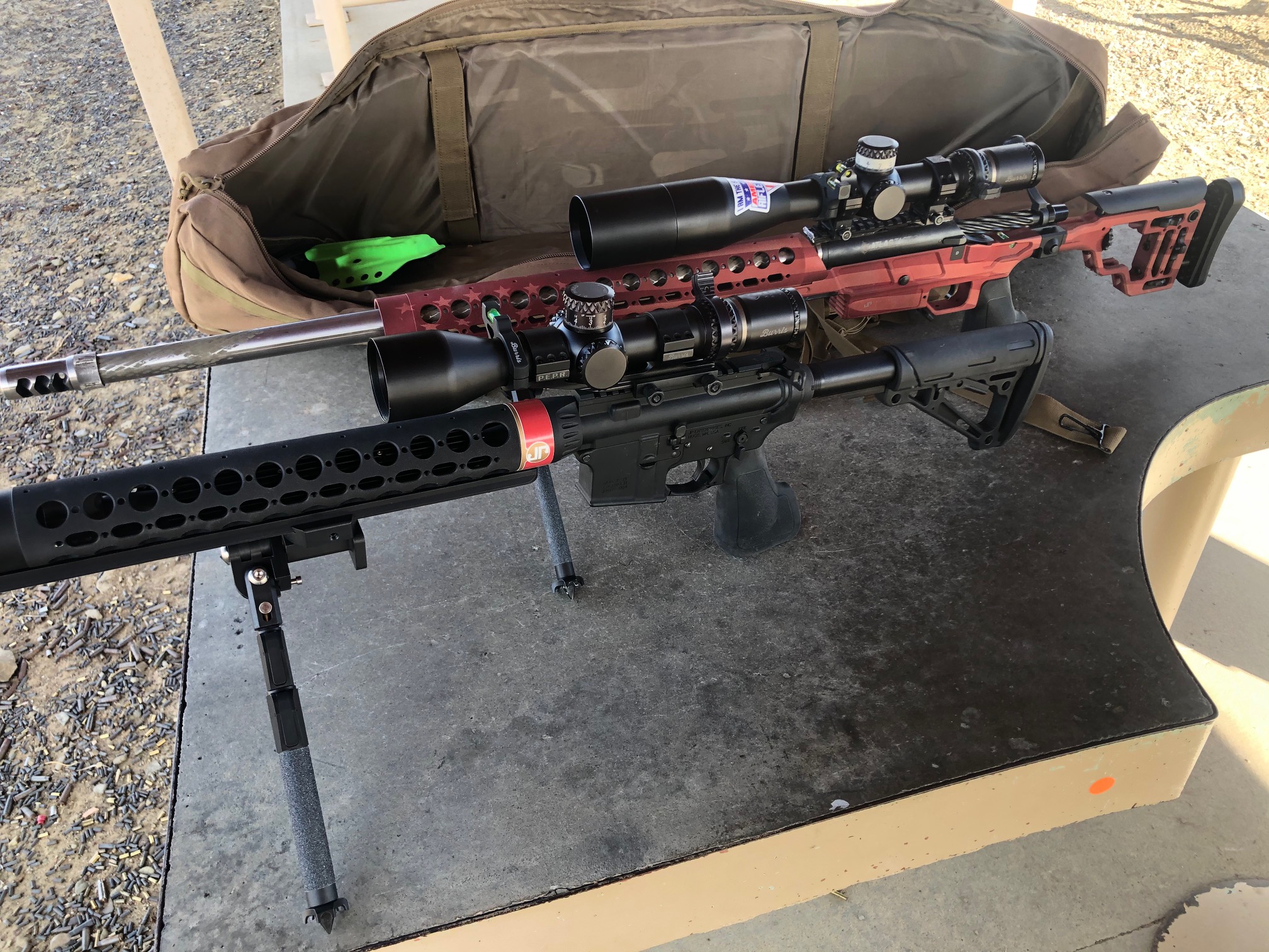

Got to compare to the 32x NX8 this morning and another Razor. NF did a good job with this scope, as expected. I can see the issues pointed out by @wjm308 , but the glass looks great in this scope. FOV comparison on 24x, the NF was at 8 mils per side, the Burris was at 8.6 mils. This is the closest I have seen a scope come to matching the FOV of the XTR3.
I got a lot of feedback from some shooters here. The owner of the NF was very impressed with the Burris after bouncing back and forth between his and mine. I'm curious to see some of the results other people see, but my sample of one continues to compare very well.
Reactions: jetsurgeon
:LOL:Just curious Ja, in the 4th image, were you shooting at the guys in the 3rd image, I hope they were running fast. Seriously though, I keep getting tempted by the Area 419 custom CZ 455 rifle or do I want to build a Vudoo 22. Also, with regard to the NX8 4-32x50 vs. XTR III 5.5-30x56, did you notice that the XTR III was a bit brighter at higher magnification, or did the NX8 hold its own?
Haha, kinda looks that way..
Those old fat guys start moving pretty fast when you start shooting at them.. ;)
I was able to see the issues you discussed in your evaluation of the NX8. The edge of the glass has this curving, fish bowl effect at closer yardages. It's still kinda there at greater distances. But far less noticeable. Noticeably more shallow DOV, which brought the very finicky parallax into play. Especially in the .22 game where you're on the parallax knob for every target array. But the glass looks really good. It's a definite strength of the scope.
Up to 20x it was pretty close to a dead heat, at 30x the XTR3 had brighter glass. Not to say the NX8 doesn't still look good, it does. It still resolves well. But the XTR3 was definitely pulling in more light.

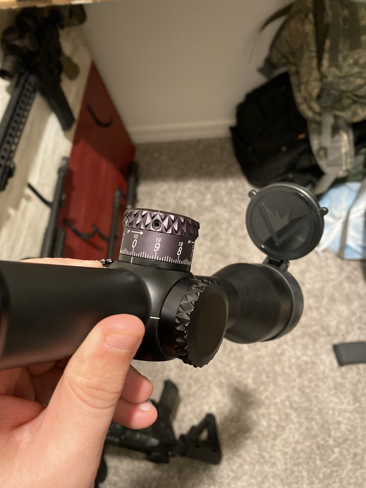

I have not played with the one i recieved last week but it came with an extra windage knob (see pic). You have the option to leave the cap on or use the lager knob.
True. I forgot my friend told me it comes with the additional turret. He had his windage capped because he's like me in that he'll dial elevation and hold wind
