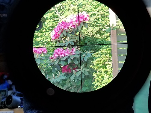

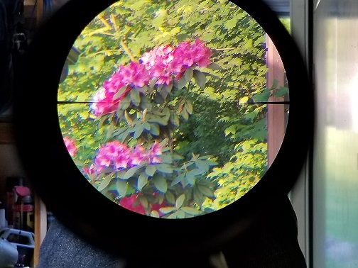

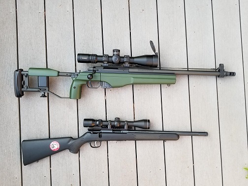

Hi guys, got myself a burris xtr2 4-20 scr, mounted on a sako tr22. i took it out for the 3rd time today since ownership, and each time I have not been able to get a clear picture or focus no matter which dial settings I adjust (I followed the diopter sticky from the hide as well). Its been nothing but frustration and a struggle with each shooting session. I went out there with my brother today and the picture quality is so poor that I decided to not even waste my reload tests. I looked through my bros Cronus on his AI AT and its a night and day difference. To help illustrate my point, i took photos of the XTRii vs a 3-9 Tasco for comparisions sake and the Tasco outshines it at the almost the same mag (9x vs 10x). Has anyone else had this issue? Ive read that Burris doesnt have the best glass on the forums but this is just extreme.
If you have the diopter adjusted properly as you say then the only other thing it could be is the parallax adjustment. I realize that this would be obvious but you never mentioned it's adjustment. Otherwise, looks like it's time to give Burris a call for a return to the shop.
ive looked thru 3 of these...a buddy has the 8-40x (or whatever the high power one is), another has the 5-25, and i (briefly) owned the 2-10x...the 40x and 25x, while not the greatest glass in the world, they were very usable, would have had no issues running them...the 2-10x i had was similar to yours, no matter the parallax or diopter setting i could never get a crisp image...at 100 yds on paper there was a ton of CA and it was kind of fuzzy always...at distance on steel, no real definition to the image, hard to make out details...i sold it for a BIG discount, and i think the guy was going to check it out himself and then send it in, if need be...i never followed up with him to see how it played out
Even if the diopter is not set correctly you should still be able to get a "clear" picture. And by clear I mean as clear as the glass will allow. The diopter is to focus the reticle to your eye with the sight picture. If you think something is wrong send it to Burris. Its gonna be hard to diagnose your glass through a picture. Even the really cheap scopes have some decent glass in them anymore.
Diopter was set according to the hide instructions, parallax was set at the range at 100 yards and at 50 yards in the photo which is the distance it was taken at. Previous range outings I blamed the poor clarity on mirage, but yesterday with no shots fired and in the shade I couldn't even pull the trigger the image was unbearable. My bro looked through my scope played with the adjustments and gave up as well. I have a few other scopes, pst, hslr, Midas and never had this issue.
B"L"urris glass, not all that uncommon and this subject comes up more than is comfortable, coming from the "I might have considered buying one if it weren't for these particular posts". Admittedly as long as a scope tracks I'll pick nicer glass vs other aspects.
They have great turrets though.
The glass on my 5-25 is better than both of those images. No offense but I'm guessing there is some operator error in there. If not, I'd send it back for a new one.
Are you sure those bushes bushes aren't closer than the minimum parallax setting?

thanks for contributing to the discussion suboptimal. Any guesses as to why I don't have these vision problems with my tasco, vortex, bushnell, athlon and Nikon scopes?
Two other people could not get a decent picture with my scope. I certainly hope 20/20 vision is good enough to look through a xtr2.
I hope I don't get the standard line that everything is fine with my scope, I sent a Nikon in for repair for failing to hold zero on a .223. They didn't even bother to mention if they found anything wrong with it. Let's just say it hasn't found its way back on a rifle.
