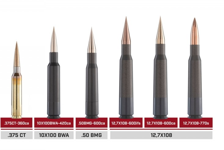

    So some of you may or may not know that Blackwater Ammunition has a new ELR cartridge, projectile and powder combination they have been working on.
    It is the 10x100 (with 420gr projectile) shown in photo below for comparison to their 375CT, 50BMG and 12.7x108

    Those are some pointy bullets. I'm a little confused though—their .50 BMG bullets have much lower BCs than I'd expect, lower than the Hornady AMAX. Are these G1s? Is someone exaggerating?
    Hi,
    An unnoticeable feature of that cartridge case via picture is the weight.
    It is 35% lighter than standard 50BMG cartridge case, yet functions with no problem at over 70k pressures.
    In regards to BMG BC numbers....I have not gotten into that project for myself yet so I cannot say one way or another but I suspect they are published on the very conservative side :)

    Personally I could care less about the 10 X100 cartridge there is a reason why you don't hear much about it I would guess because it's a failure. We have already surpassed the performance level of the 10 x 100 with the 408 Colossus in a smaller package. What I do find it interesting though is going back and reading comments from " Theis " it's amazing how full of s*** this guy actually was and that anyone could ever believe anything that came out of his mouth. I say good riddance to bad rubbish
    10 x 100 was primarily moving forward from BWA with materials.
    we had the rights for first use and development aid
    at the time BWA was working on bimetal cases and a alike
    it was going to be a higher pressure cartridge so it fit the hoplite design criteria
    BWA needed hoplite as much as hoplite needed BWA, because no other "portable" action would safely handle the pressure
    BWA was also working on different mono/solid designs as the original infinity tip was good but not great for transonic transition
    if we actually moved forward it would have been a serious cartridge with bimetal cases and increased chamber pressure combined
    currently im not sure where BWA is with the project
    So what kind of pressure are we talking about??? 70-80000 psi or less?
    Target was approx 90k
    In our opinion and some of the design/requirements from other parties involved, we believed 85+ was the limit of comfort when used in a contested environment.
    Although it was spoken about as a ELR cartridge the beginnings were more “agency” focused.
    There comes a limit of blast, recoil, and weight. Think of it as a triangle with a dot in the center. The more you move to one side etc.
