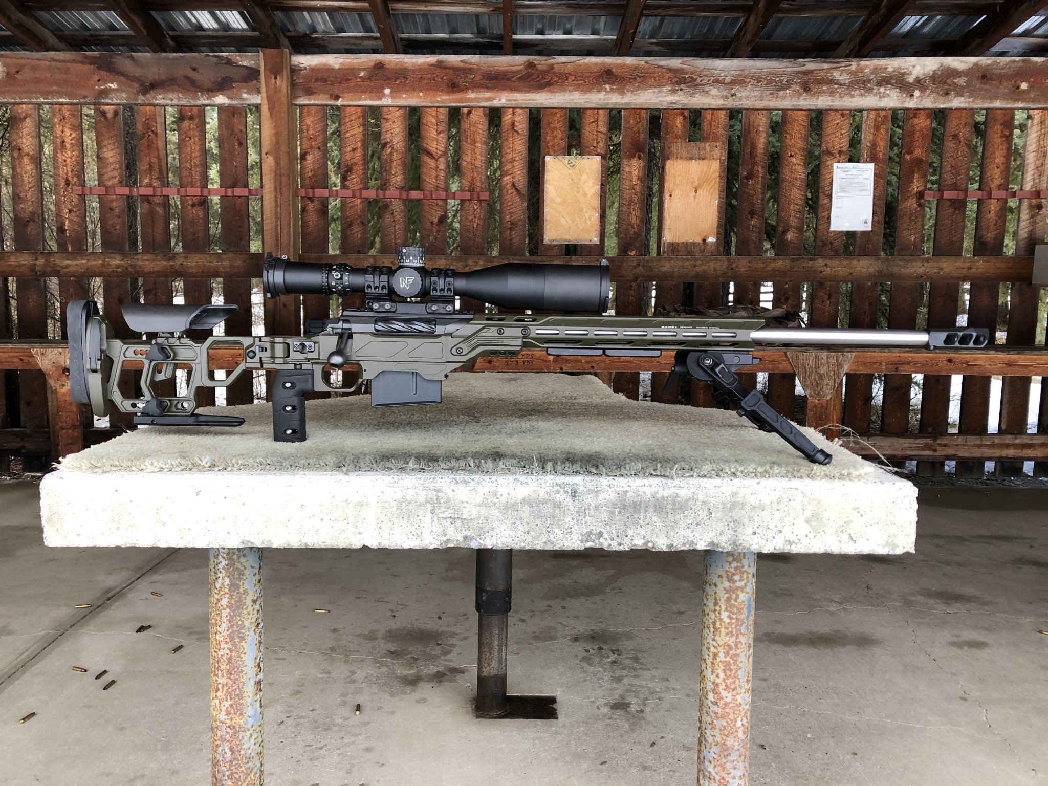

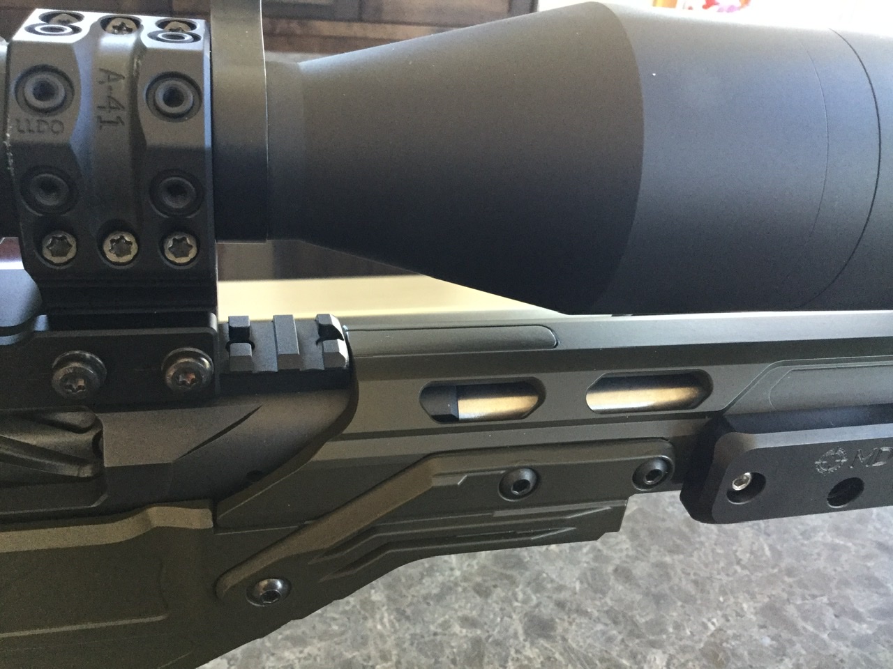

I’m just doing a build with a Deadline LA in 300PRC in a Cadex Remington 700 LA Lite Competition Chassis. I had to shorten the top rail slightly to clear the forend and have the mag release shortened by 0.075” due to the larger bolt diameter.
Wow that thing looks great. I did pick up a deadline with the mag boltface for 6.5PRC. I thought I was just going to go with MDT until I saw/read your post, now I got things to think about. How do you like it?
I have an MDT ESS and LSS XL on some factory rifles. They make a really good product. For the Deadline I wanted to to step it up a notch. The fit and finish on the Cadex is top notch. You won’t be disappointed with either option for the chassis. As for the Deadline, I orderd the barreled action. Just starting to break it in but I’m loving the action.

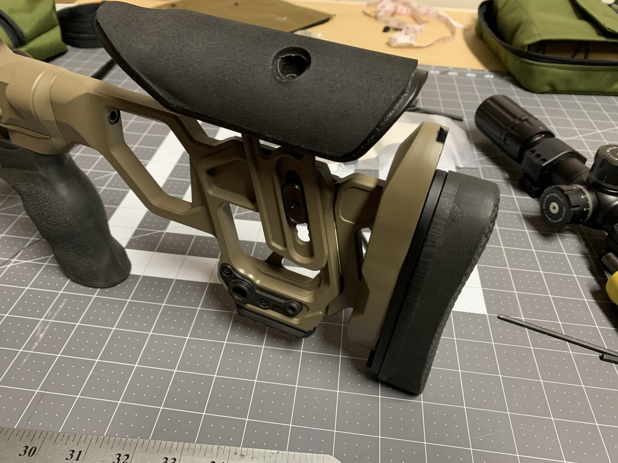

Scored a field comp for the tikka...For the life of me I can’t figure out how to take the butt pad off to add a spacer. What am I missing?!
Shove an allen head into the rubber (there are holes in it which you have to kinda find) forgot the size of allen, but try a 5/32 or the next size up. It's probably metric. I just took my entire chassis apart this weekend for cerakote and it took me a few minutes.

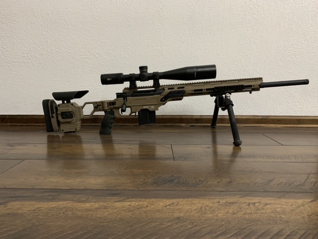

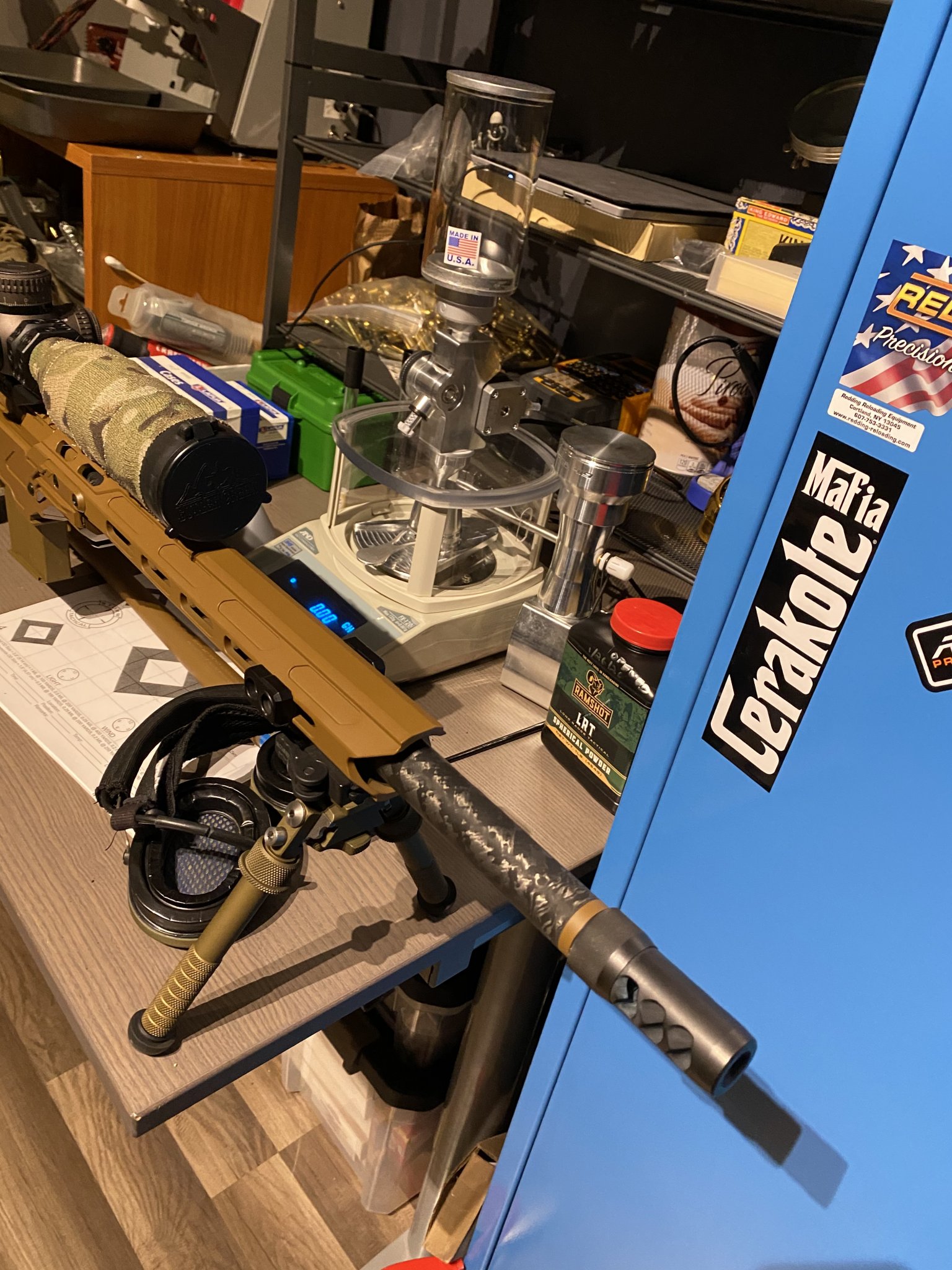

I posted in this thread when my Cadex chassis was FDE. I spent all weekend re-barreling my Tikka T3x with a Proof carbon, so I decided to give her a makeover. Not sure I like the color yet, since it was much lighter in the bottle, but maybe it'll grow on me. Man there are a lot of pins and parts in the folding mechanism to take apart. Had to "salad bowl" the entire thing but I managed. No spare screws or pins left so I think she's good.

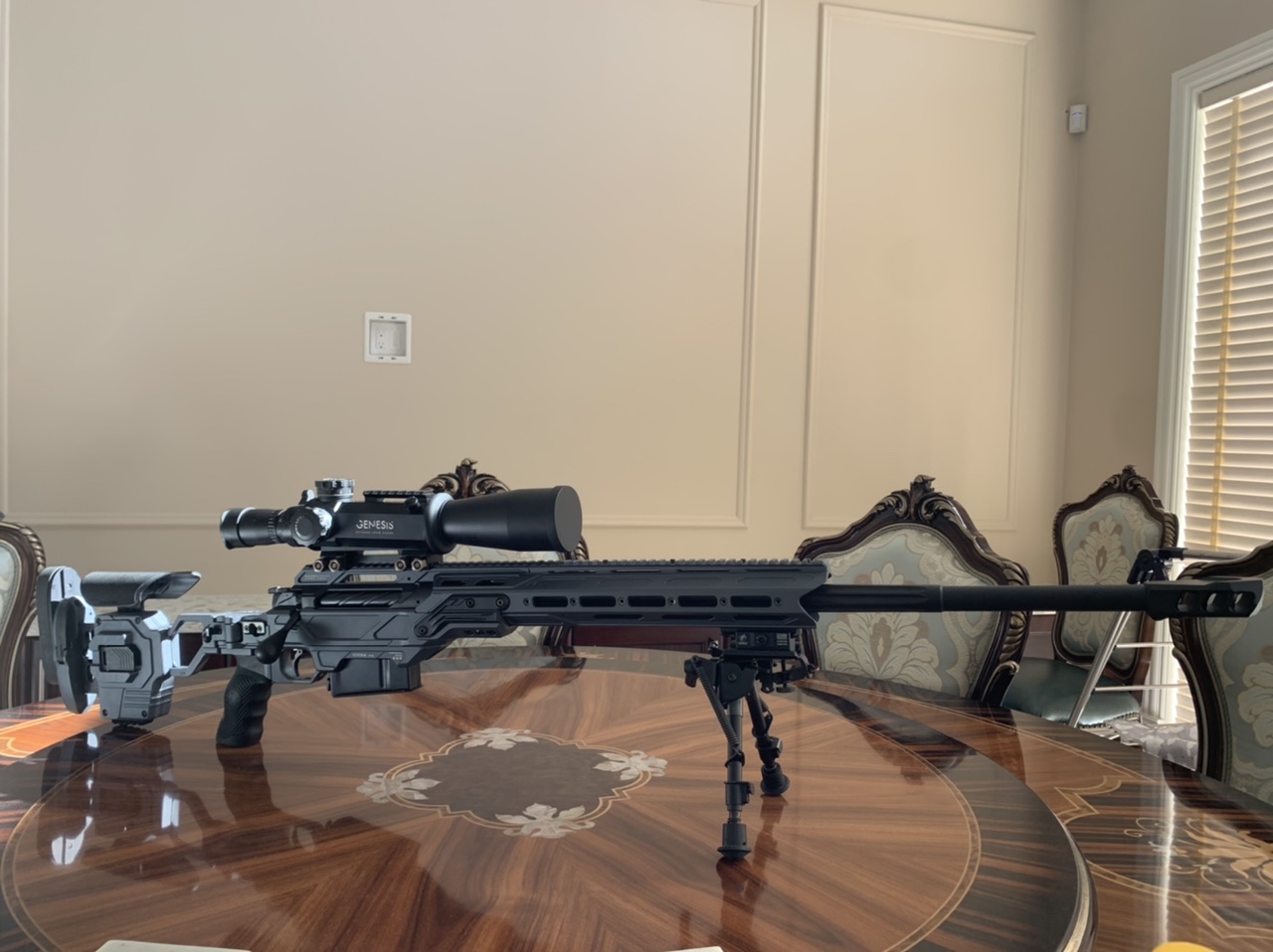

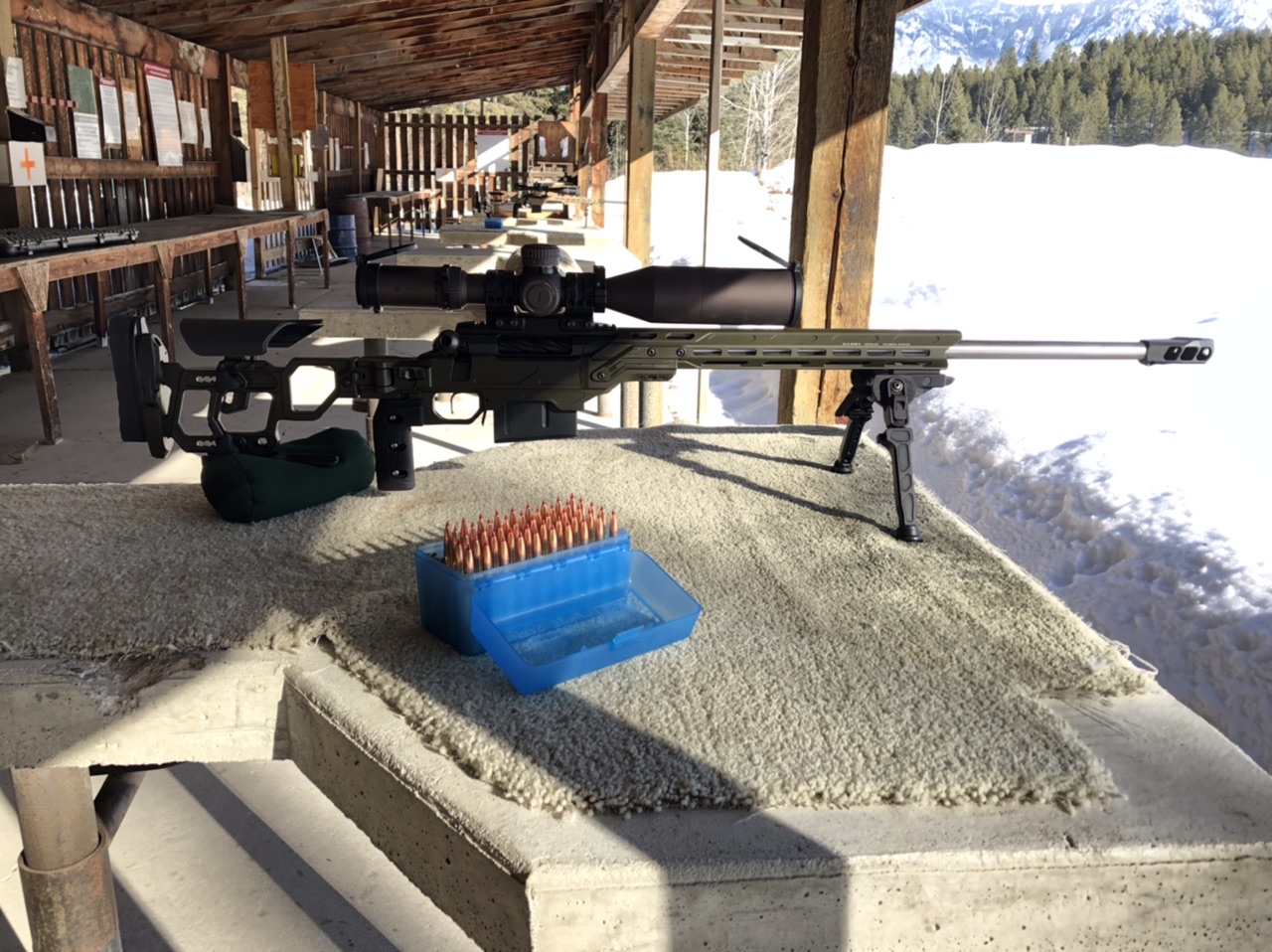

Finally finished my build. Cadex Lite Competition Chassis, Ulitmatum Deadline Action, International Barrels 26” 300 PRC 1:8, NF ATACR 5-25 x 56 Scope, Spuhr Mount, Triggertech Diamond Trigger, Cadex Falcon Bipod, Cadex MX1 Brake, MDT Vertical Grip, GRS Bag Rider. MDT 300WM 3.850 CIP Mag. MDT M-LOK Weighs.View attachment 7239317
Where did you get that bag-rider? And will that MPA grip fit out of the box? Rifle is sick dude.
I like it! Kinda looks like AI's dark earth. Well done ?

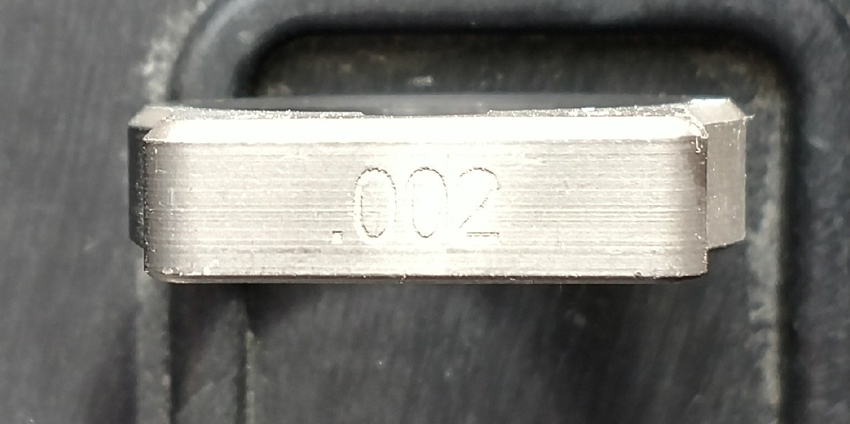

Just make sure he sends the barreled action to whoever does the new barrel. Cadex's recoil lug seconds as a "headspacer". They have different numbers on them based on when the original factory Smith does the head spacing.

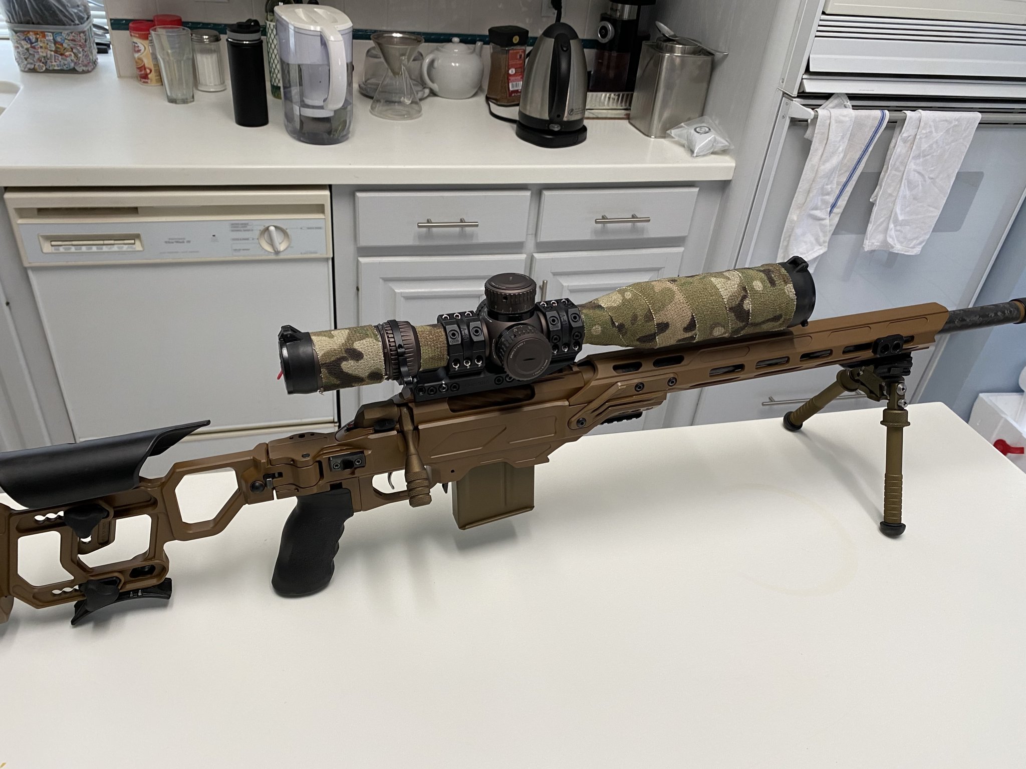

Strike Nuke Evo, ARC Nuke (I have lots of Nuke in this rifle!), PVA 18" 308 barrel (I also have a 260 Rem barrel and am considering a 300 WSM), Huber 2 stage trigger, Steiner TX5i 5-25x56, Seekins rings, and an Omega 300 with Keymo adapter (which leaks a little onto the barrel unfortunately).

That looks sweet. Who did the barreled action for you?

It’s a barrel nut prefit from solid accuracy. I’m way too impatient to wait more than 2 weeks for a barrel lol. It’s stupid accurate. This paper was standing off from the backer so the hole looks bigger than it is. Zoom in and look at the hole in the backer. I measured it around 0.2.
I would love to have a full Cadex rifle but I’m not sure I can justify paying double when this one shoots as good or better. Plus I waited all of 10 days for this barrel to be made and shipped ??‍♂️

The barreled action is from Ulitmatum Precision. It is their Deadline Action. They use International Barrels and this one is a 26” 300 PRC 1:8 twist.
