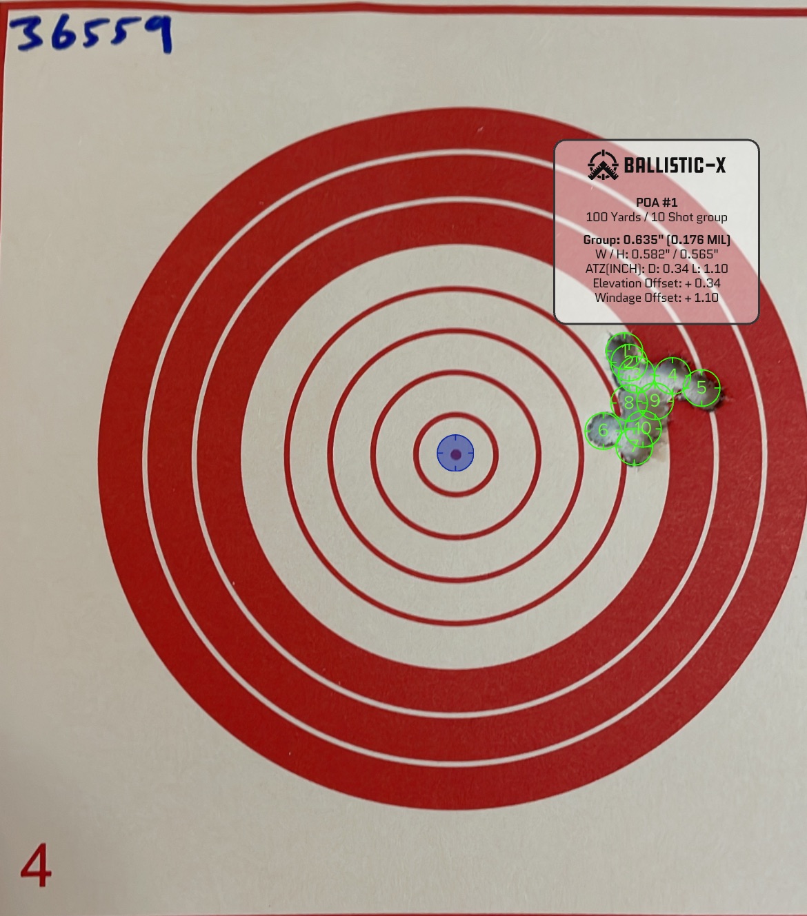

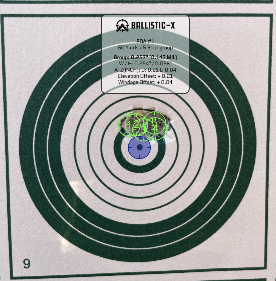

Is a lot tested group like this as good as it gets or would throwing on a tuner tighten it up even more? Been debating testing a Harrels on this, but not sure if it’s worth the time and money or just to continue to extensively lot test until I get these results.
5 shot group at 50 yards grouping .257 and 10 shot group at 100 yards grouping .635
CZ 457 with 21 inch lilja in MDT ACC Premier Gen 2.
Primarily shoot NRL/PRS. Wasn’t sure if the tuner would primarily address tightening up more of those “pretty good” lots but be marginal (if at all) on improving lots like this.
  • Ballistic-X-Export-2024-10-03 11:45:22.776535.jpeg

Not sure you would see much improvement on the top and maybe a bit on the bottom, combined not sure it would do much. Tuners generally work to reduce the vertical stringing, not so much to reduce the horizontal spread. Question do you plan to shoot at beyond 100yrds? If not I am not sure LR is the right choice. It and its brother SLR come into their own at 100 and beyond. At 50 or 100 I would try centerX.

The accuracy shown is good enough for PRS/NRL. If you want to tighten them up some more then I would say yes to a tuner. Have you tried accuracy out at 200 or 300 yet? Is your barrel a straight or a tapered barrel??
I have a 20in 1.2” straight on my rimx and decided to throw a tuner on and the groups shrunk some. But then again a a short straight barrel isn’t going to have the same effect of a tuner as a thinner barrel or tapered.

Thanks for the feedback. And Yes I shoot NRL & PRS matches, so out to 300 isn’t out of the ordinary on a monthly basis.

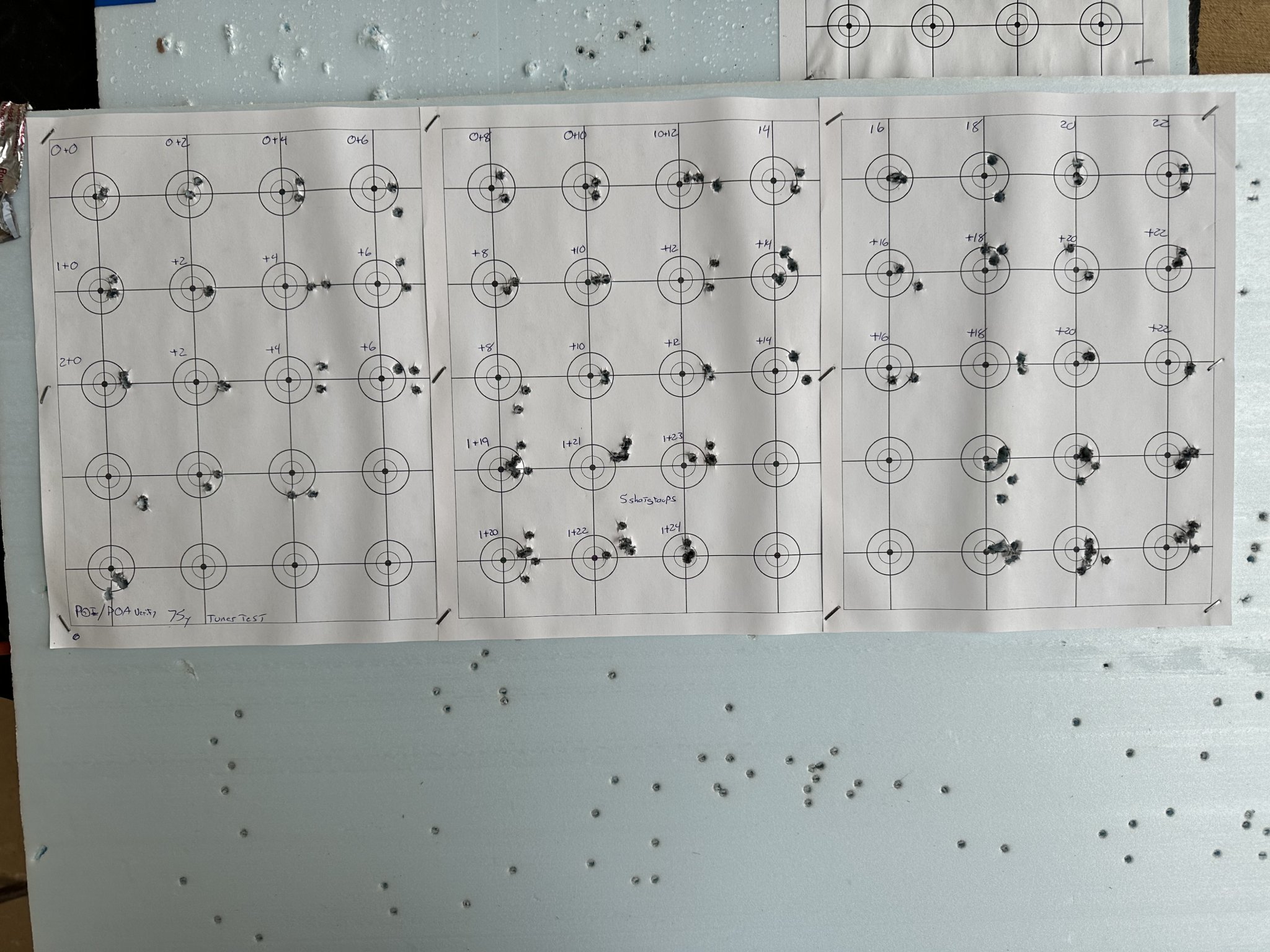

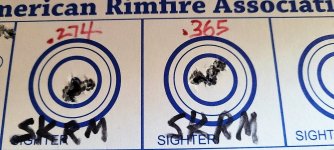

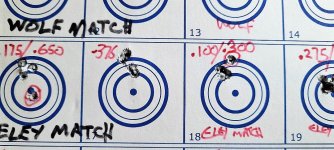

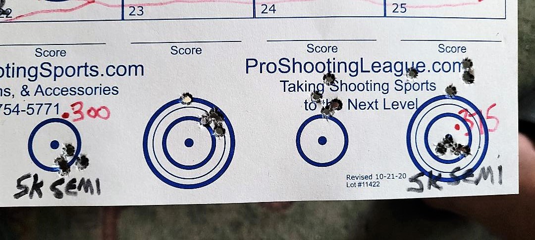

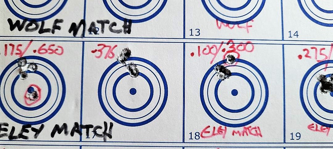

Here is a picture of my tuner test target and how I run it. All of these shots are a 1.2" barrel at 25" long and a Gen1 EC Tuner. This is SK Standard+. Just a case I had at the house to see what the rifle would do with it for club matches.
How can you tell which setting is best using 3 shot groups? I get that a bad group won’t get any better but a good group has a likelihood of “lying” to you. 3 shot groups have around a +/- 60% change is size from group to group.
I have been doing this for 4 years this way. You will typically have 3-4 groups that stand out of the tested settings @ test distance. (50, 75 or 100) At this time w/ 4 rifles and helping countless other shooters at my club I have probably tested 25-30 lots of ammo in that time frame. If it is Lapua tested ammo I still do the same test to see what I can squeak out of it. 99% of the time you can still get a better group than tested once the rifle is tuned.
Once you have the tuner numbers to see what appeared to shoot the best. Roll to that number and shoot paper at 50y, 75y, 100y and 200y. Shoot multiple 5 round groups or 10 round groups. the tuner test at this point will not lie to you on what groups the best. Once you have done this for plenty of lots of ammo you know what groups to select and how to shorten your test on wasting ammo.
