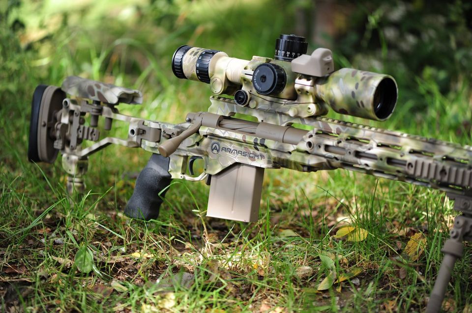

    Terry, hopefully I can get Branden down to visit again and shoot a match with us in Leesville.
    I took this picture (sorry my picture isn't very good) of a rifle and optic Branden aka @Short-bus painted about 10 years ago. I always wondered what happened to that rifle?
