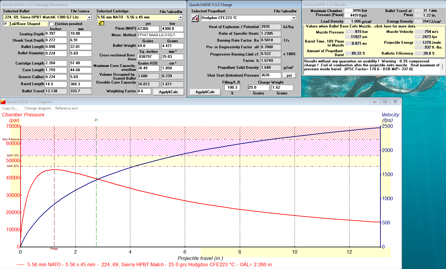

I'm running CFE 223 out of a 14.5" P&W bbl getting 2450 fps velocities...barely. Using 69 SMKs and 25.0 gr CFE 223. I should be north of 2,800 fps per relaoding manuals
And I'm getting crappy groups 1.25" at 100 yd.
Anyone else? What the Hades?
2450fps looks in the ballpark according to QL. The only way this load gets to 2800fps is with a 24" bbl

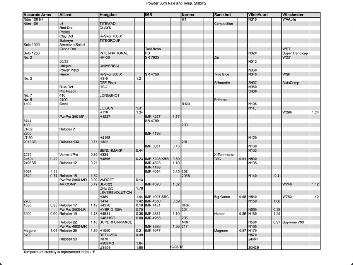

All powder will vary between lots. I got a lot of h4350 that took 2grns extra (6.5 creed) to bring velocity back. Next lot I test loaded at the old charge and it was spot on again.
Do not ignore pressure signs to get a certain velocity though.
Reactions: GetReal
Switch to a 52bthp or vmax and approx 26 grains if you want more velocity imho. I didn’t have luck with cfe and 69s either.
edit: hodgdon data, win brass, notice the seating depth as well:

Per Hodgdon's load data, it's on a 24" barrel... Why would you think 14.5" would catch that? Not being a dick, just asking.
I did NOT think it would "catch that." NEVER said that. (Where U getting that from?) And not suprised at the decrease. Surprised at the *AMOUNT* of decrease. Some 350 fps apparently, by my calcs.. (as I have repeatedly explained.) I've gotten those 69 SMK's going almost 2800 fps outta a 16" bbl. 1.5" causes a 350 FPS loss? Per Hogdon, From a 24" bbl, 69 smk's sposed to be going over 3,000 fps. (I mentioned that early in the thread too.) Not to mention I've often found Hodgdons velocity data to be FAR from real world. Its hardly gospel truth.
Yes, 2,450 from 14.5" surprised me. And the fella that ran the QL gave me really helpful info. Not being a dick, just explaining the reason for my inquiry.
And I appreciate your response here, that attempts to understand what I'm asking. Instead of calling me a "whiny little faggot bitch" or some other 7th grade insult. :)

Not suprised at the decrease. Surprised at the *AMOUNT* of decrease. Some 350 fps apparently, by my calcs.. (as I have repeatedly explained.) I've gotten those 69 SMK's going almost 2800 fps outta a 16" bbl. 1.5" causes a 350 FPS loss? Per Hogdon, From a 24" bbl, 69 smk's sposed to be going over 3,000 fps. (I mentioned that early in the thread too.) Not to mention I've often found Hodgdons velocity data to be FAR from real world. Its hardly gospel truth.

Thanx for your velocity outtta your 13.7. From your info and the QL data above, that settles it for me. UNLESS somebody has some REALLY clever, obtuse and creative insult I've not heard before

1. CFE is somewhat temp stable but not perfect. Approximately 1.70 fps change per degree change (see attached). So wherever you end up on velocity, remember to account for that as temps swing up and down. In my AO, that would be 200 fps from summer to dead of winter. Not sure where you’re located but I’d guess northeast based on your temperament;)
2. Last weekend I got 2650 fps with TAC and 77 SMKs out of a 13.9” barrel. But the book says I should be at 2902 ;)
Oh and not sure why it matters what I do for work. Ironically I work in real estate and help people defer and eliminate capital gains tax through tax efficient investments.

1. CFE is somewhat temp stable but not perfect. Approximately 1.70 fps change per degree change (see attached). So wherever you end up on velocity, remember to account for that as temps swing up and down. In my AO, that would be 200 fps from summer to dead of winter. <snipped>

Finally something relevant, helpful (well...AFTER snipping out all the oral feces.) As the old saying goes...."7th time is the charm." No need to reply. I'll call it good you finally actually posted something on topic. And say "Thank you. Really. Thank you very much."
