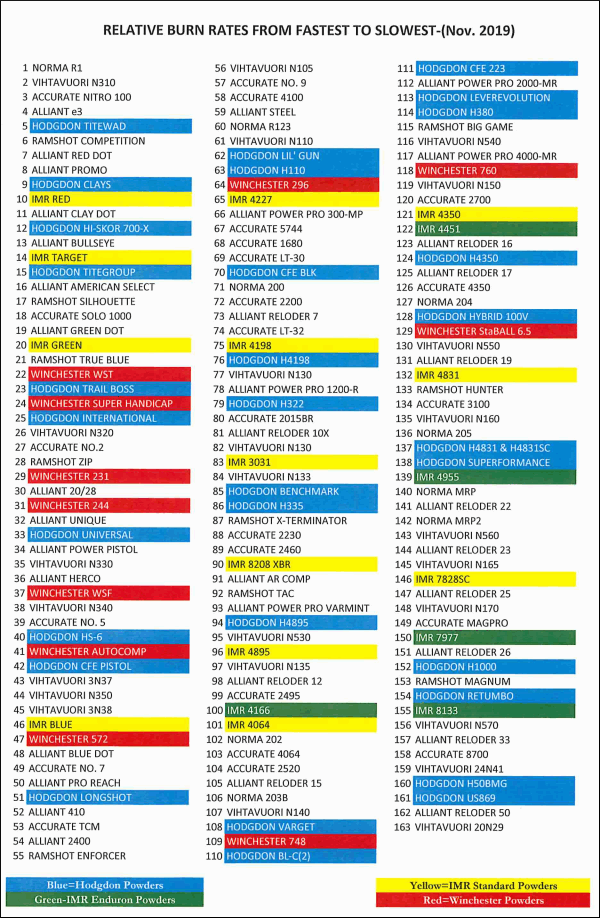

I'm running CFE 223 out of a 14.5" P&W bbl getting 2450 fps velocities...barely. Using 69 SMKs and 25.0 gr CFE 223. I should be north of 2,800 fps per relaoding manuals
And I'm getting crappy groups 1.25" at 100 yd.
Anyone else? What the Hades?
The good news is you're getting higher V then you should be, the bad news is you will not get the V you want with CFE 223 it's the wrong powder for that configuration, this coming from QL as well as my own experience. if you changed to a 77gr you would be spot on.

I have understood the really short barrels 12-11" and shorter can be fed with N130 or N133 to get the bigger bullets flying, i guess something in the N135 area could be used for 14.5" since it can work in longer barrels too. So somewhere around N133-N135.
Good candidates:
AR Comp (you have this)
Benchmark (natoreloading.com's favorite)
Pro Varmint (if I remember correctly this was used by JRB to get beyond 2800 in 18" without marks.)
Or the N530. It could work out very well too?

This is not a "you suck because you're dumb and new" post, and is meant to be educational, but - a couple of y'all don't really seem to have a good handle on the relevance of burn rate attributes and barrel length, and are offering bad advice as a result.
If you are looking to reduce flash in a short barrel, then switching to something like 8208 instead of CFE223 is a good choice. But if you're looking for more velocity, it's completely wrong. As long as we're not talking about VERY short barrels, in general terms the powder that gives the best velocity in a longer barrel will also give the best velocity in a short barrel. CFE223 is one of those, along with TAC and Lever. All three of these need to be pushed hard & hot to perform at their best though, which means something more than standard 223 Remington load data.
If you're using a shorter barrel, do not switch to a faster powder in an attempt to chase higher velocity. That is the wrong answer.

I am looking for more velocity. This is a P&W 14.5" so not super short. No signs of pressure, so I could increase my load. I was just looking for 1" at 100 yards, as this will be a 300 yd and under gun. Since I can't get that (1.25" is about best I can consistently get) *AND* velocity is low, another powder may be in order.
Accuracy and 300 yd range.
I have a load with cfe223 that might interest you. It was sub moa in a 16 inch midway barrel and now sub 1/2 in a 20 inch ballistic advantage barrel.
It however is not heavy for caliber.
My point is for shorter ranges a flat base bullet is a choice to consider and a secant ogive is not necessarily your friend at mag lenght.
A tangent bullet is less finicky.
It is a shame my load will go trans at about 450 yds .
Speer 52g / 27.5g cfe223 / cci 400 and carefully prepped range brass with -.002 mandrell for neck tension. Coal 2.21 .
