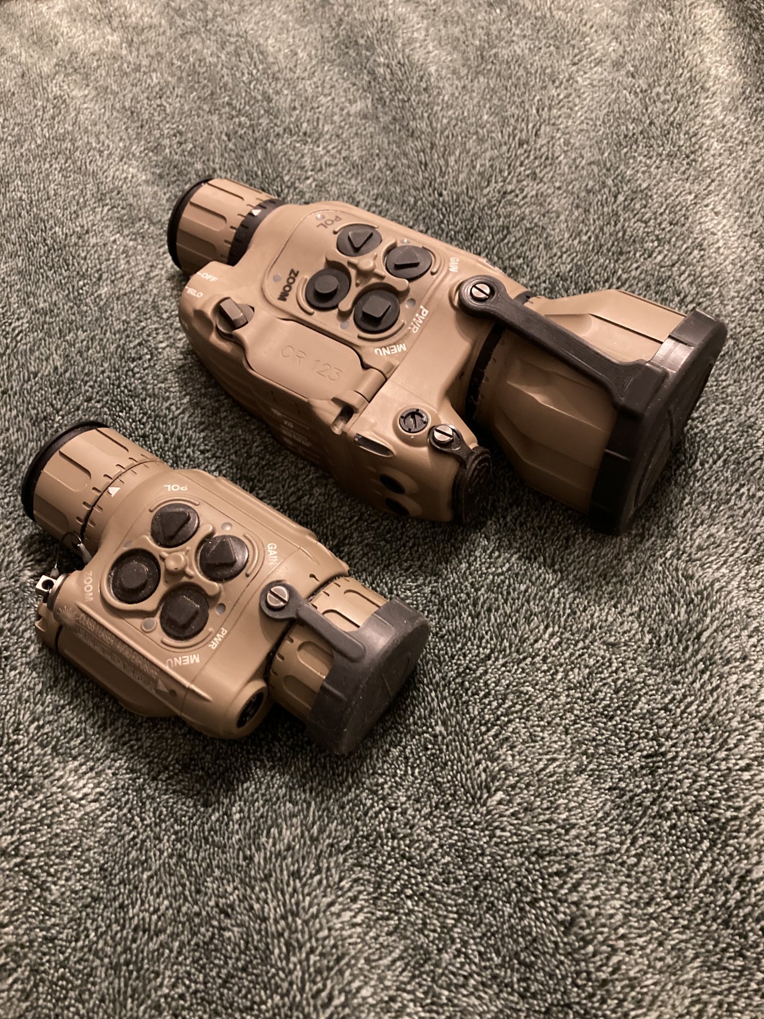

Voodoo S&M ( :D ) are the best we can (relatively easily) buy.
Have tested the S ... its solid out to 400yds (as far as we tested it)
White splooch of a target at 400yds
S of course can be swapped back and forth between head mount and weapons mount. Probably the only REAL head mountable thermal that also actually works as a clipon.
Both the S and M do have adjustable diopters on the rear. That's necessary for the S, but not clear what they were thinking with the M.
Since the S is both an HMT and a clipon, it needs the adjustable diopter. There are witness marks on the diopter ring and the housing and if you line those up you are set to factory collimation for shooting - BUT - to use this at night - we need to add some raised material on top of those marks (fancy tape). It would've been nice if the factory put some raised material on the unit for us.
The M also has adjustable diopter and its not obvious why ppl would clamor to try to use a real long distance thermal clipon as a monocular since the demagnified screen on back is so tiny. But this is the case !
These are essentially the "skeet gen 2" and the "utc gen 2" ... produced by some of the same ppl involved in making the original BAE Oasys line. Top notch stuff !
I don't think the issue with the Tig is lack of focus, though the symptom is "fuzzy image". Unfortunately I think its "something wong with the image software". Inside 300yds and under 4x magnification on the day scope the Tig is fine. But at those distances and magnifications, I'd rather just use a dedicated TWS. I want thermal clipons for longer distances - so I can use my day scope reticle to hold.
For over 500yds, you definitely want the M. There's also an "ML" available with a build in range finder. These are "built to order" so pay now and wait 60-90d lead time period. But they are obtainable. We have some in the pipeline now.

Voodoo-M, if you want best-of-breed.
New xELR v2 will likely be the best widely available clipon with some form of .MIL heritage.
Voodoo will play nice with TracIR/iBEAM tech with an AB Raptar, MRF or MARS.
Theon will not.
May or may not be an issue for you.

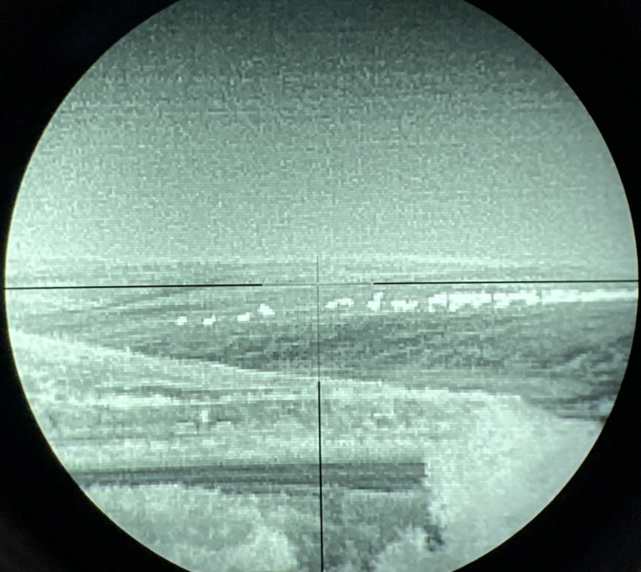

Voodoo-S. Elk herd @ 1430 yards. Day scope at 4X.
As usual, PID was accomplished with a combination of animal location, movement, herd behavior, sounds (bugling is pretty obvious).
The M would definitely be better for this kind of distance but I’ve been impressed with the S. As usual, it looked better in person.
