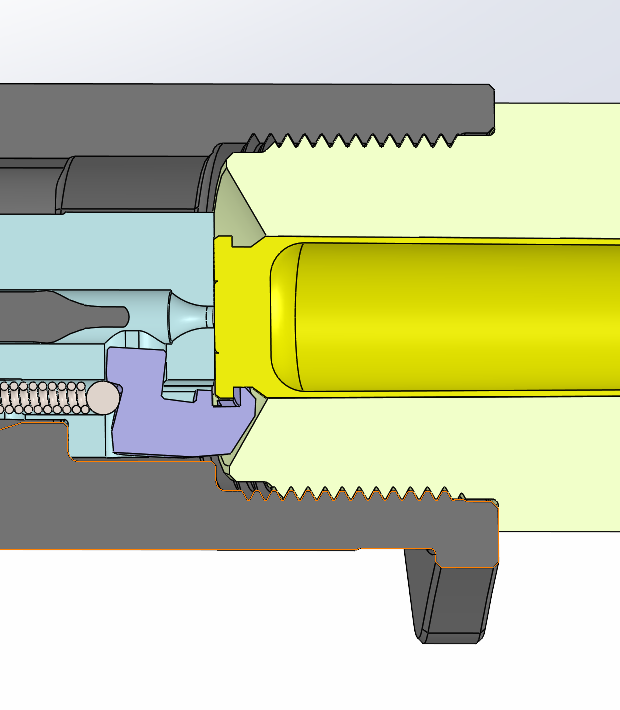

This action was bought just to be a .223ai. Now should I wait for a prefit or get my local home grown barrel guy to do the chambering and conical breach? Wonder if it’s gonna be as simple as just putting a crown per so in the chamber side of the barrel?
No, that's not how the coned breech works.
It's explained in the first few pages of this thread, but I'll toss in an image that might help explain it.
This first image is unmolested and shows how the cartridge sits in a coned breech barrel. Note that the rim and extractor groove are the only unsupported part of the brass.
With a flat breech, the tapered portion is not part of the barrel, but the cartridge still gets the same support.
Sorry for the lousy image, but I'm doing this on my phone and the new photo manipulation socks.

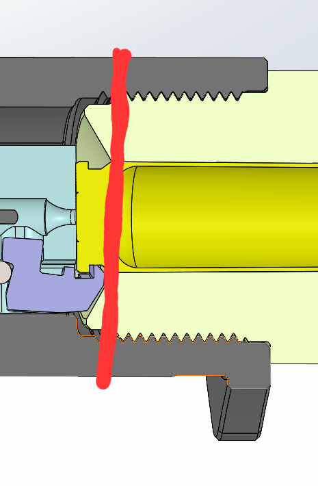

Everything to the left of the red line isn't part of a flat breech.
If I'm understanding this correctly the cone is shaped to mate up loosely with the extractor angle however the need for the cone really has nothing to do with extraction or the extractor but is solely to allow the cartridge and bullet to feed into the chamber. Everything works fine with a flat faced barrel as long as the tip of the bullet starts into the chamber.

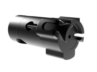

So was there agrement on which bolt style would be more reliable? Fluted or not? Referencing teds question earlier in this thread asking about our preference, going to order and cant decide. Cool factor is great but reliability is king...
This video covers the bolt and how the flutes work into the design.

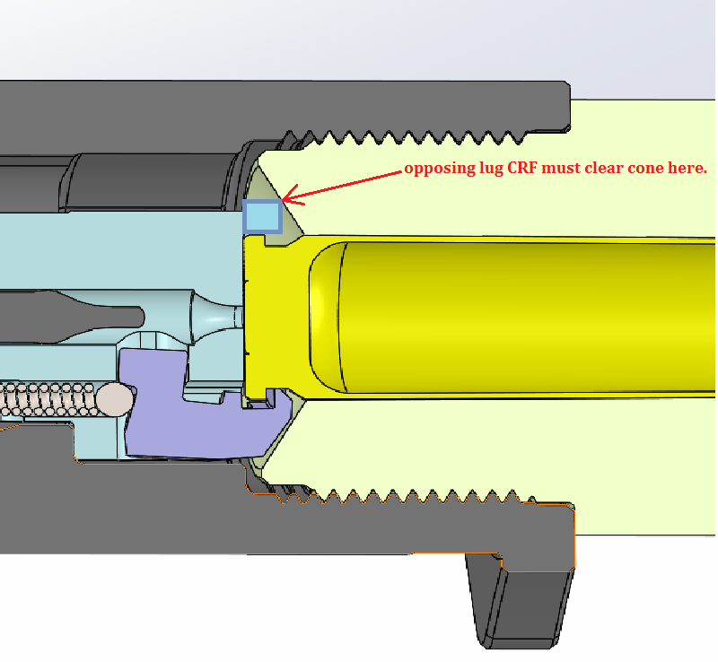

If I were doing one of the first 223's on the CDG, I'd want to put the action in the barrel smiths hands for fitting the cone breach.
The cone has to clear the extractor & protrusion on the opposing lug since these are control round feed. Both the extractor and opposing lug protrusion are wider on the small case heads. So in essence the .378 case (most in need of the cone) will be the trickiest to ensure the cone clears.

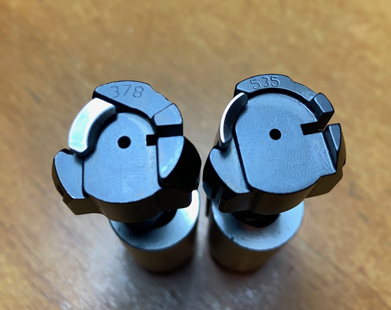

Pics are worth more than my shitty explanation. The opposing lug case support sticks out .110 on the Archimedes bolts below, don't know what it is on the CDG? Maybe the CDG has the opposing lug tapered??? The ARC website just has 1 rendering for all bolt sizes (looks like .473) so I cant tell.
Not to scale, but drew in opposing lug case support.
