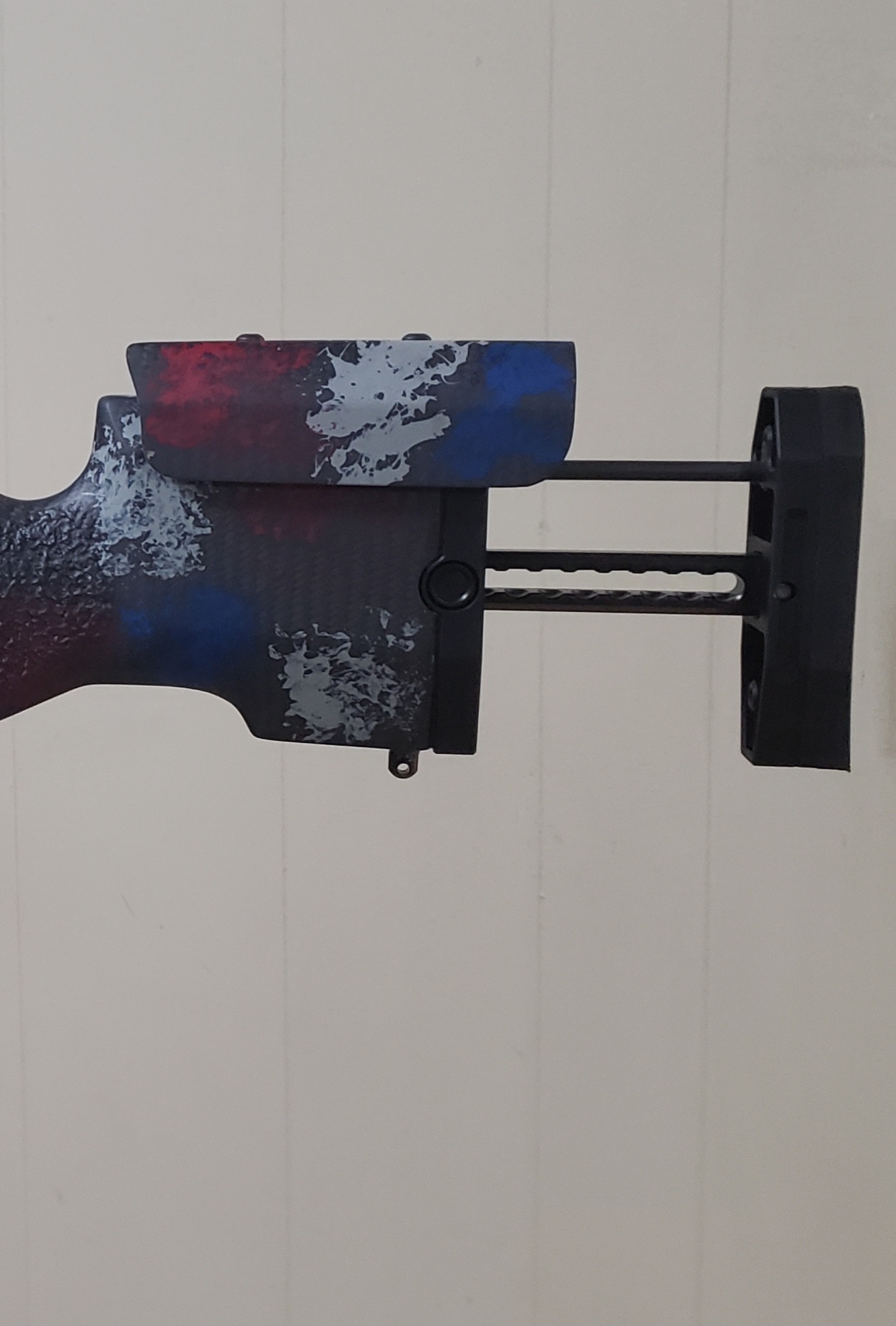

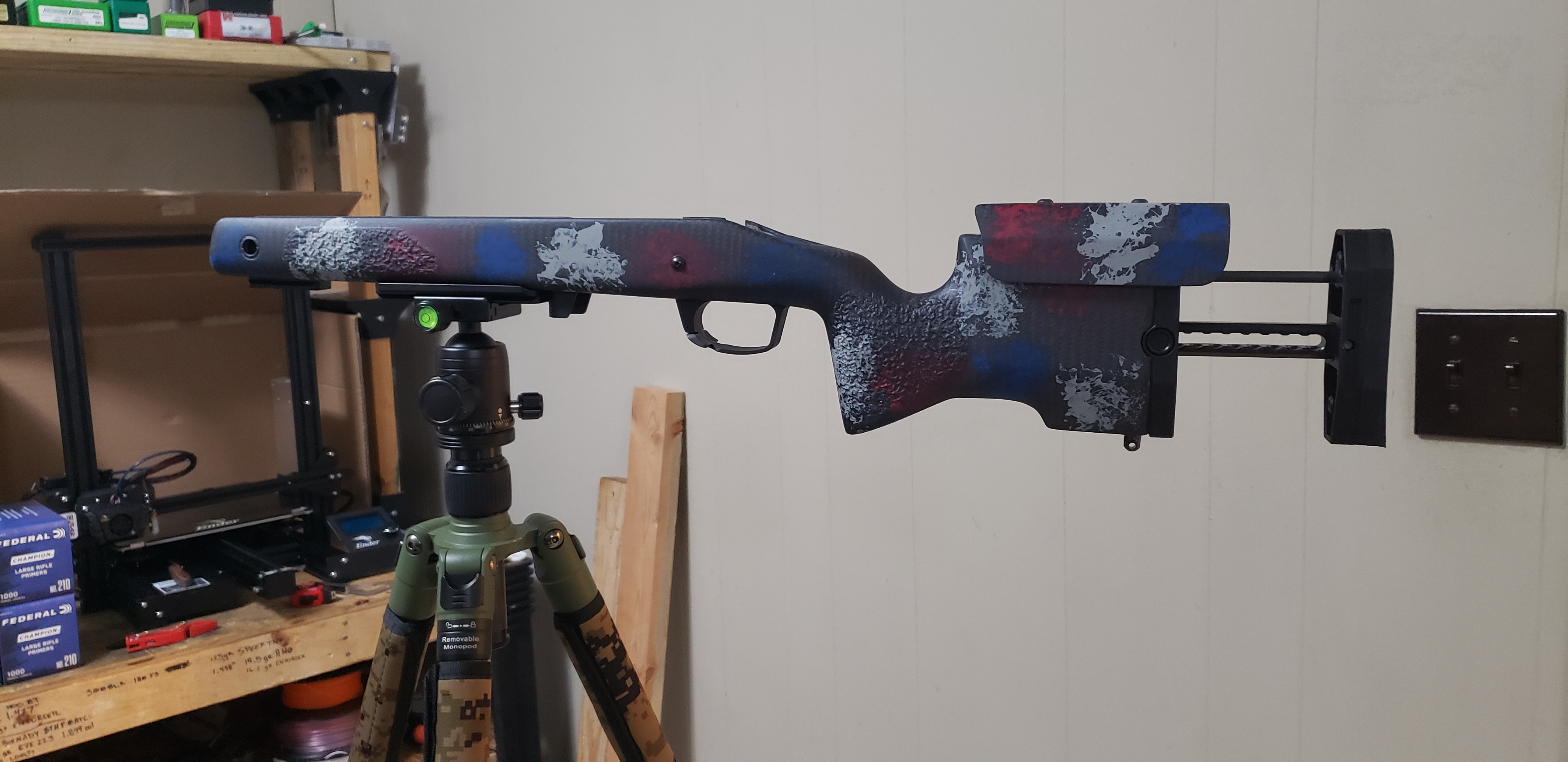

The Manners compact stock does have an optional cheek riser (see photo) but it's just a formed piece of carbon. It's held on with 10-32 screws and probably won't take a huge side load going with extra high rings. I have some more spacers on the way and can test that theory when they show up. But like kiba said that might put the recoil pad to low on my shoulder and most definitely on my kids shoulder. I don't have a 34mm scope with a 56mm objective so i might have to use the one i have with a 50mm objective and do some math. Usually i would use a geissele mount but this project would benefit from rings.
With the spacers installed that style of cheek rest is pretty stout even with only 2x screws holding it on.
What I don't like about that "add on" style of cheek rest is that it sticks off the side of the buttstock a bit and thus pushes your head and eye further away from the centerline of the stock and optic and pretty much forces you to lean your head over to get into the scope. You can partially alleviate that by setting the cheek rest lower and using more of a lower cheek/jaw weld since the natural taper of your jaw will let your head remain vertical while getting your eye closer to the center of the scope. Again, this is all very dependent on the end user and face shape as well as the width and shape of the cheek rest.
Knowing you have that cheek rest that gives you a few more options and I'd be more inclined to try 1.25ish rings first, but since the rifle sounds like it will do double duty between adults and children you'll probably have to find a happy compromise; possibly choose rings that you don't need the cheek rest for, but then you can bolt the cheek rest on when the kids use it.

I suck at 3d software but i could try different cheek pieces if the carbon piece pushes me too far left.

A lot depends on your face shape and how it fits the shape of the cheek rest. For me, I've found that unless the cheekrest is really narrow or can be adjusted to the side I have to run it low and have more of a jaw weld to keep a vertical head position to prevent "leaning over" into the scope.
I tend towards running them lower for more of a jaw weld rather than translating them to one side for cheek bone support because a cheekrest pushed way over to the right for comfy right hand use and cheek bone support makes it impossible for me to get into the scope and get a shot off left handed if the position requires shooting from my left side, whereas the lower centered jaw weld position works both left and right side.

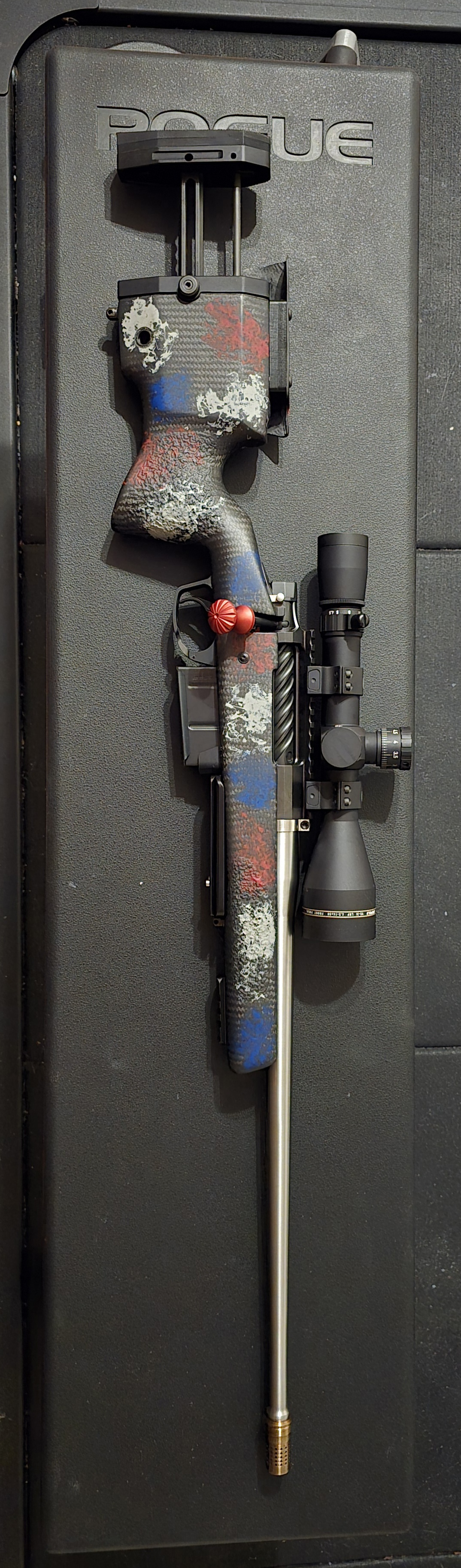

Holy chit, i didn't realize it's been this long since I asked. I found a set of medium 30mm rings in my stash that barely allow a 50mm to clear and thats only because of the barrel profile. Looks like I'm going to need a minimum of extra high for 34mm ring with 56mm objective with an m24 profile.
Got everything to finish my build and slapped an extra scope I had laying around on it.
ARC CDG w/ WTO switchlug
6.5 PRC
Bartlein 8.5-7.5 LH gain twist
Geissele super 700
Manner compact stock w/ MCS DBM barricade mini chassis
Norma Golden targets suck at ~1.5" while the Hornady match were ~.75" with room to improve once I get used to it.
