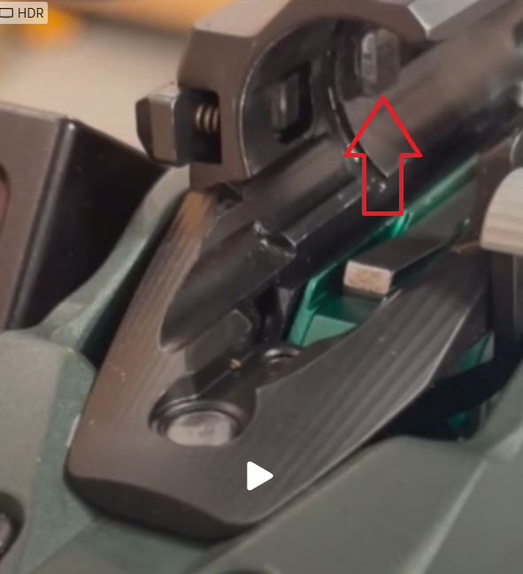

Can you cock the action and then lift the bolt handle up and down… and video the rear of the bolt assembly to show us whether or not the white piece of metal moves forward or backward at all while you’re cocking it?
If it moves, even the slightest amount, the bolt could be binding on the trigger mechanism.
Does it bind with the action out of the MPA chassis? If so, remove bolt stop and check again.
That’s actually a good point one of the things also to check is whether or not the front action or rear action bolts are sticking through the action.
I have found that on the chassis I use (vision chassis), you absolutely need to make sure to use one of the provided washers.
Yep, none of mine do that…
I’ll try to get video of that tmrw, but it feels like the contact is within the receiver.
Let’s say it is binding on the trigger mechanism, what’s the play?
If the trigger is improperly adjusted, then it’s either putting too much pressure on the bolt or it’s rubbing on the bolt.
Some triggers have replaceable sears that allow you to swap them out for thickness…

Here’s some new views if it tells you guys anything. If you go to the first video, the chatter is happening when only the cylinder is passing over the trigger assembly. This one is a Bix and Andy

mine did the same thing. What it looked like to me was the bolt diameter left too much play so when you cycled the bolt it was angled up against those sharper edges causing it too almost bind up. I ended up using lapping compound which helped out tremendously but did take off the black nitride. In hindsight I should of sent an email to ARC.
Definitely pull the trigger out and see if you still get that problem.
Reactions: climbing1
Okay, pulled it out of the chassis, pulled the trigger assy out, ran the bolt, chatter/bind still there. It’s not 100% every cycle, of course, but unless you have perfect muscle memory to be perfectly parallel over the length of the cycle, you’ll still get it.
Readjusted sear engagement to as perfect as I can.
Def not trigger
Reactions: AllenOne1
Def not trigger
With action out of the chassis (you can leave the trigger in), remove the bolt stop and spring . Test again.
Test is to rule out the possibility of the bolt stop applying lateral pressure to your bolt body.
Alternate instruction - simply hold bolt release button and move bolt back and forth to see if it binds.

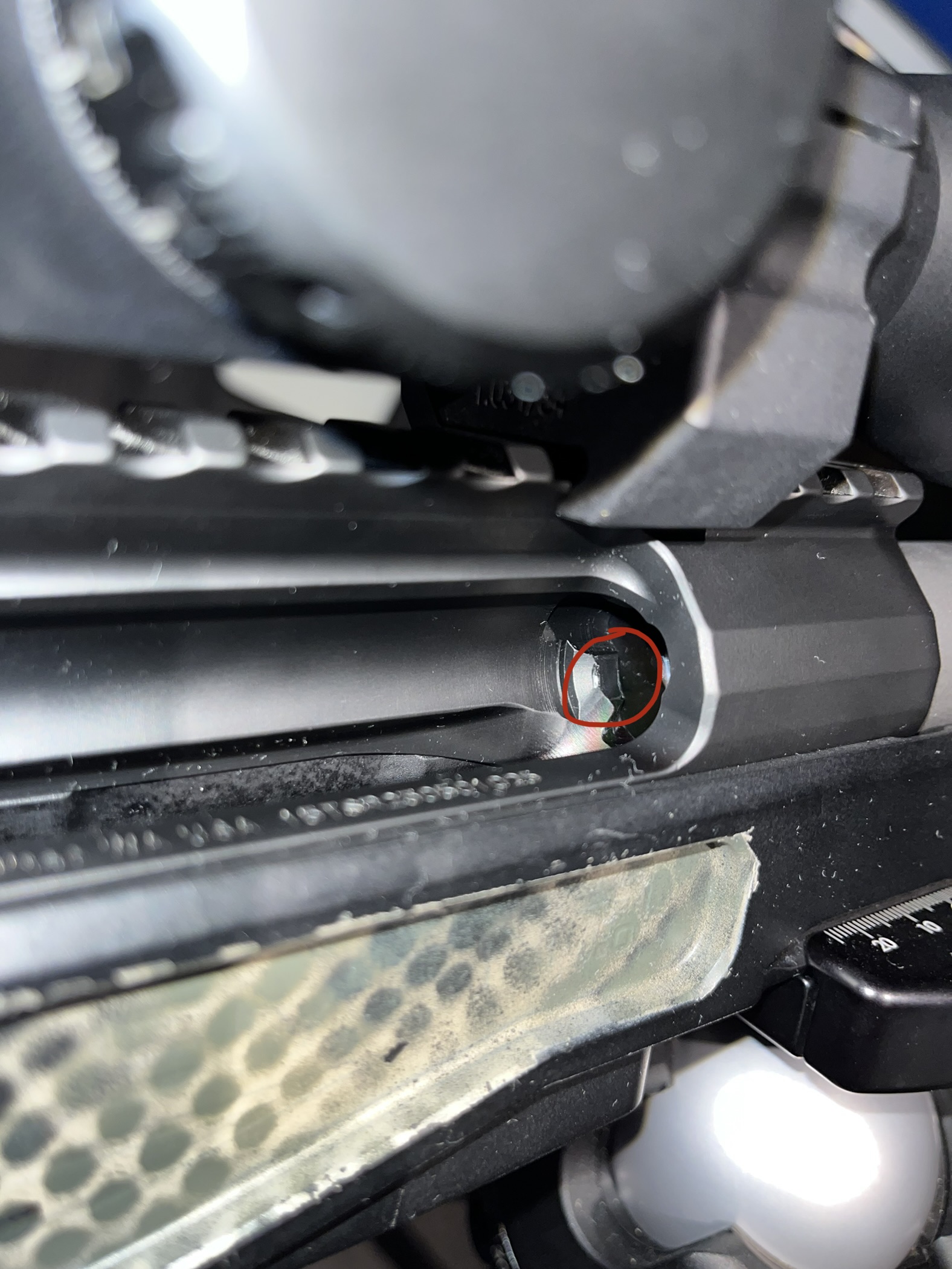

Has anyone else’s action developed this marking? Looks like where the bolt face interacts with the lugs as it guides it into the correct location. In conversation with ARC this may be something that occurs just due to there being no guide rails for the bolt body. Just curious if anyone else’s action exhibits this or just mine due to how I handle the bolt or something like that.
Of Note: I am in talked with ARC. They are very responsive have stated it’s not a deftly concern or anything of the sorts.
Curious if you changed calibers or what vintage you bolt, bolt head, and barrel are. There was a print correction with regards to the cone dimensions early on. And also, the cone dimensions change according to the caliber if there is a bolt head change.
Per my understanding and experience from having an early release and then buying a different bolt head and changing course at the last minute.
Reactions: Estes640
Are you talking about cone dimensions for the barrel? The impact to the front face of the lug is ahead of any interaction the barrel would have with the bolt.
I’m the second owner. I believe the original owner had a creedmoor in it. I have a 6.5 prc on it
The lugs are part of the bolt head, which is a separate piece of the bolt assembly. At some point, pages in, this was discussed. There were people finding that their bolt head (the nose) was interacting with the barrel cone. There were some changes in the initial barrel cone dimensions on the print. And changing bolt heads can also create an issue.
In my case a 0.595 bolt head caused marking on the cone of a 7PRC barrel and I had to get the proper 0.540 bolt head to make it fit correctly.
That trigger 100% has replaceable seers… I have one of those and it’s installed in a CDG and I believe I have the low height seer.
Reactions: lash
Trigger does look like it’s adjusted properly… there is a slight bit of movement, but it’s pretty good.
Everything feels good with the exception of bolt lift after dry firing it. It’s a bit sticky. Would replacing that seer resolve that?
Back to the original cycling issue, I’m 100% sure it’s unrelated to the trigger as I pulled everything apart.
