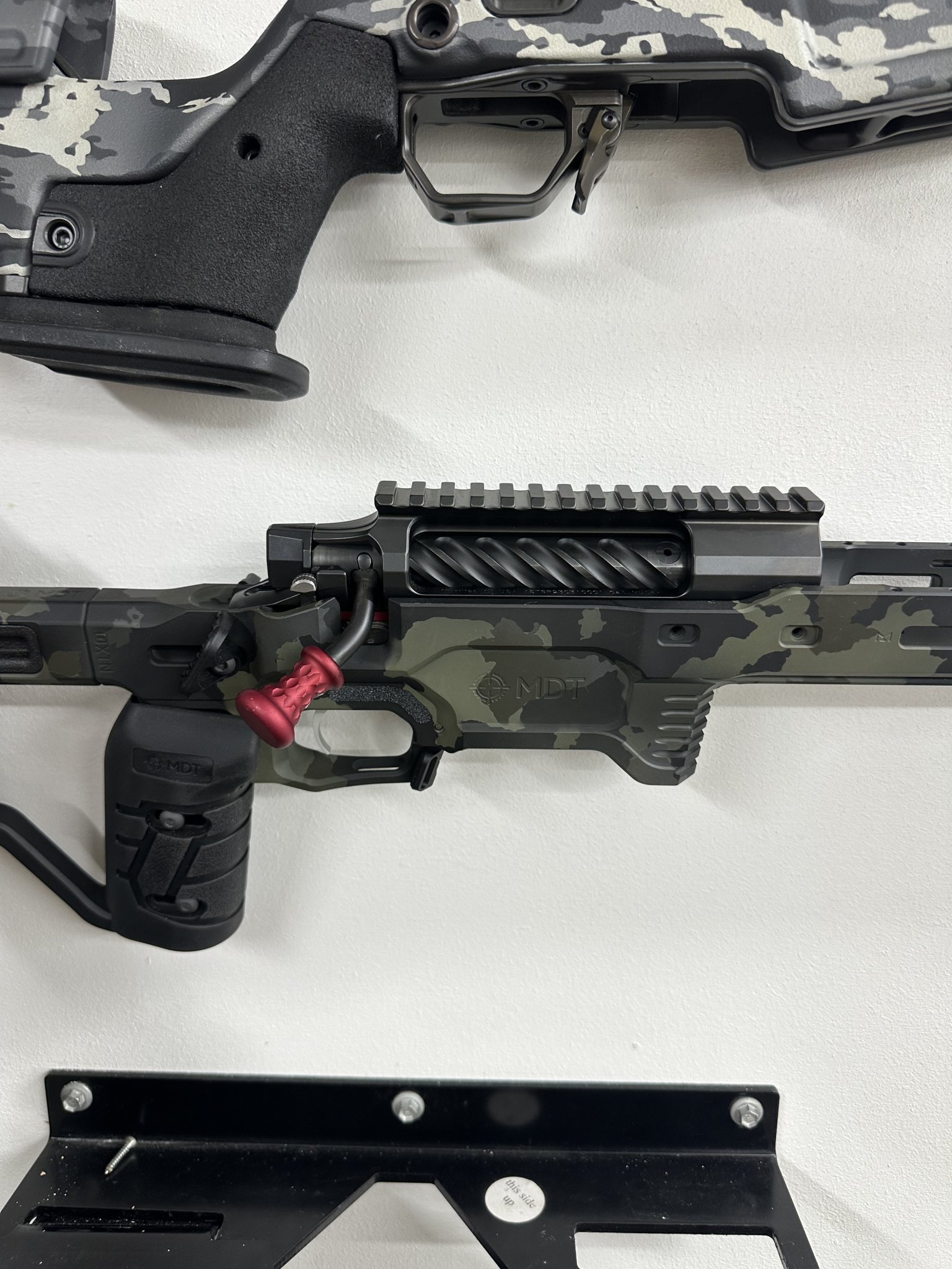

Digging the swept handle.

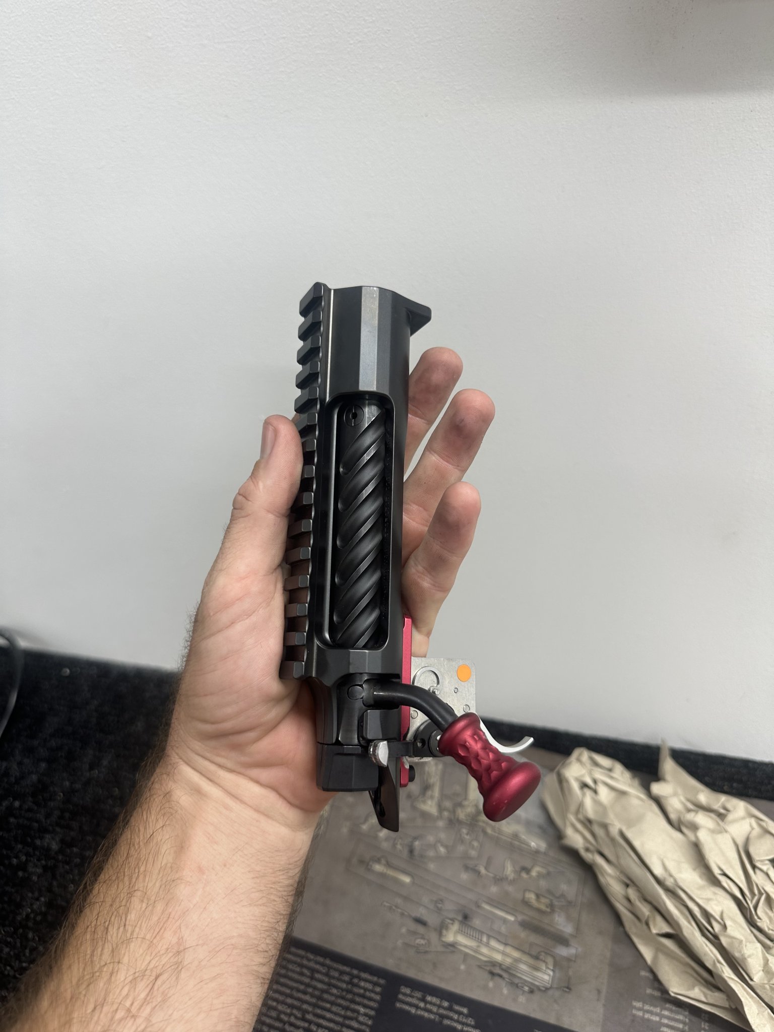

I have 4 of these, including 1 w an un-fluted bolt. If you want the the smoothest, most vibration free CdG cycling, that's your route. The crowd talked Ted into flutes, but he knew what worked best.
Yah... when I saw that the flutes are mainly on the top, solid on the bottom, I figured they were just for aesthetics. They do look pretty. Nice to have the option, I guess.
