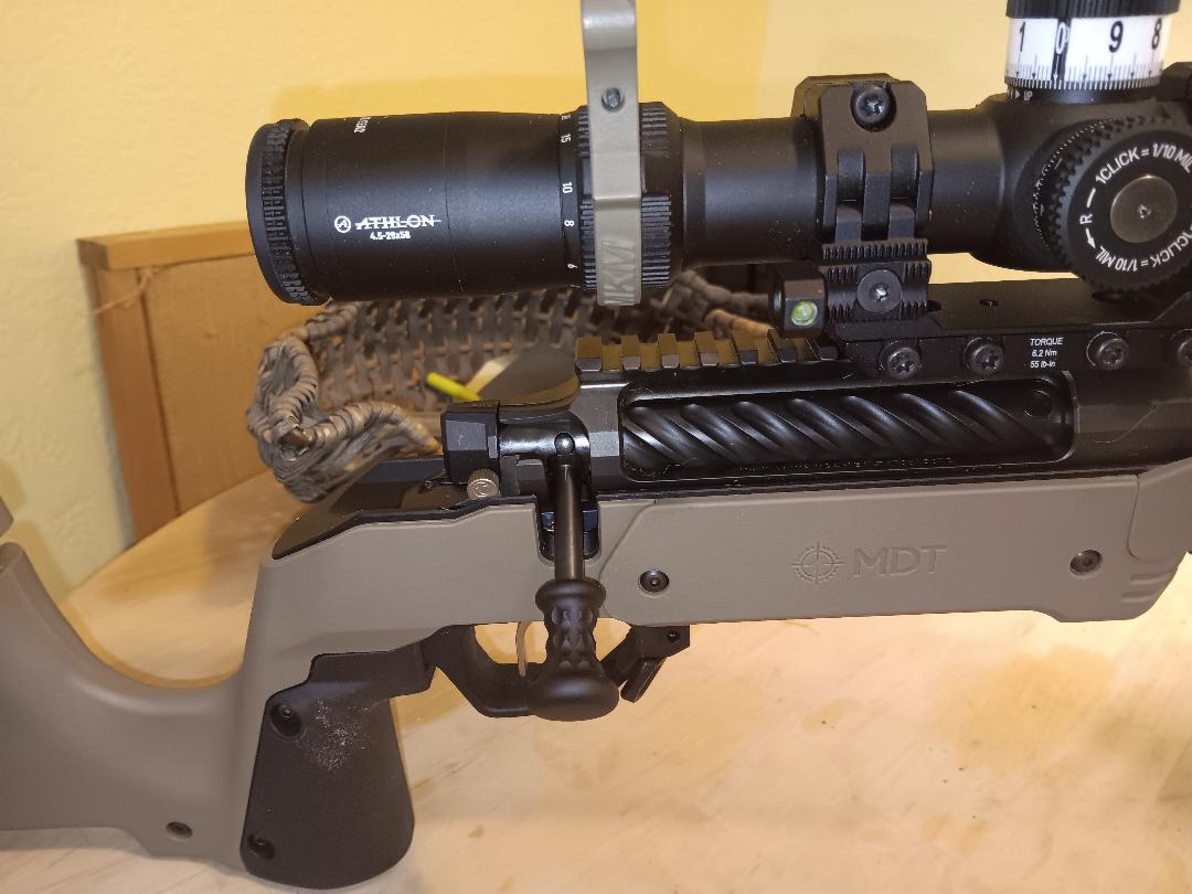

I was using my CDG fixed bolt handle again today, it's just flat amazing. feels excellent, looks pretty cool, does everything I could ask. I can't wait to put in the 70lb spring to see how much that lightens the bolt lift and enjoy tinkering. thanks for making sure spare/replacement parts are cheap/available and shipping is swift.
thanks @karagias and ARC group!

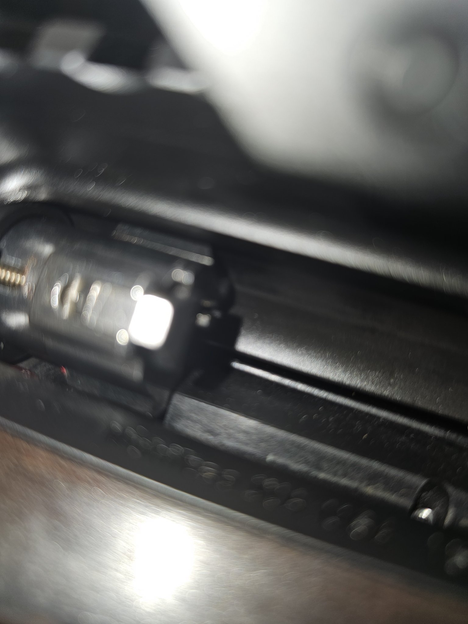

Anybody running their CDG with M5 bottom metal? Want to get some pics of where your case head presentation is vis-a-vis the bottom lug.
I’ve got mine assembled by hand outside the stock as I wait for it to arrive, but I noticed the case head presents notably lower in this MDT M5 bottom metal than it does in my ACC Elite. I don’t have any other M5 DBM on hand to compare. This isn’t magazine catch related, I checked that already.

this is a hawkins

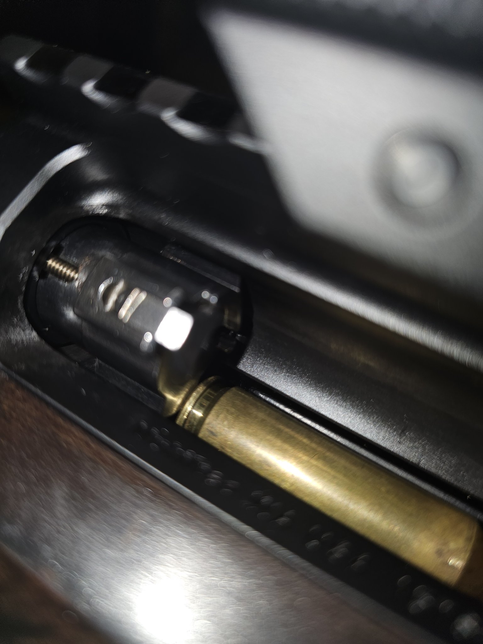

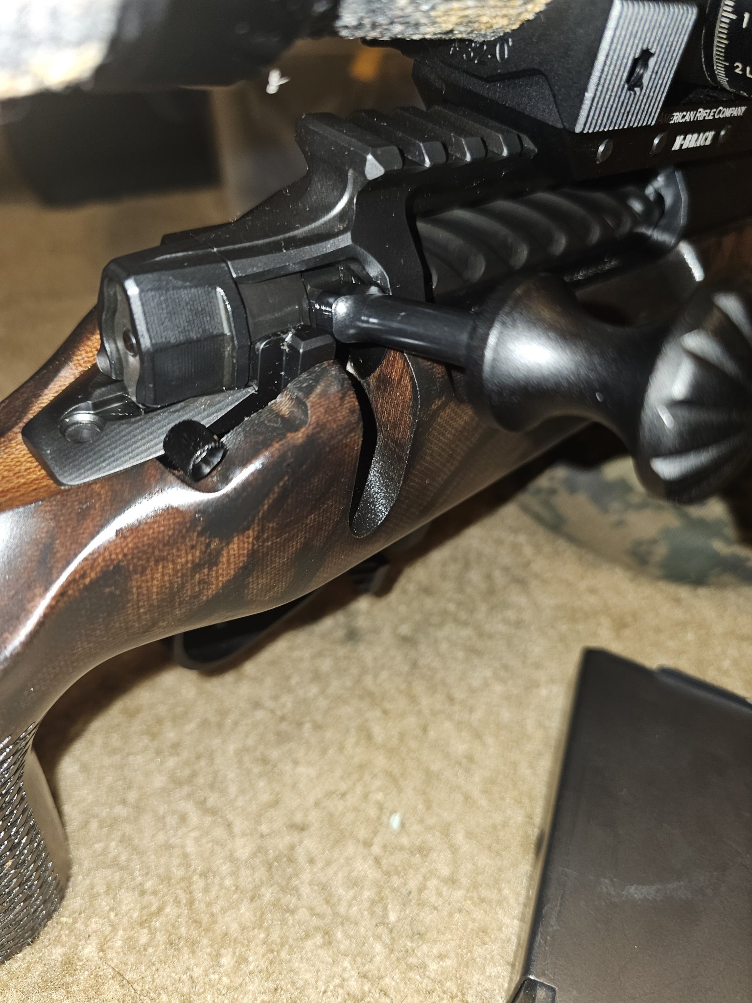

so I just installed the 70lb spring to have some fun and now the bolt won't close all the way.
do I need to time the trigger again?
pic shows as far down as the bolt will go.
going to try timing the trigger and see if that does it.
ETA upon closer inspection I even see in this picture I had the handle backwards
Make sure the cocking piece is installed in the correct direction. Also make sure you didn't install the bolt head 180 degrees off. Those are my first 2 guesses...

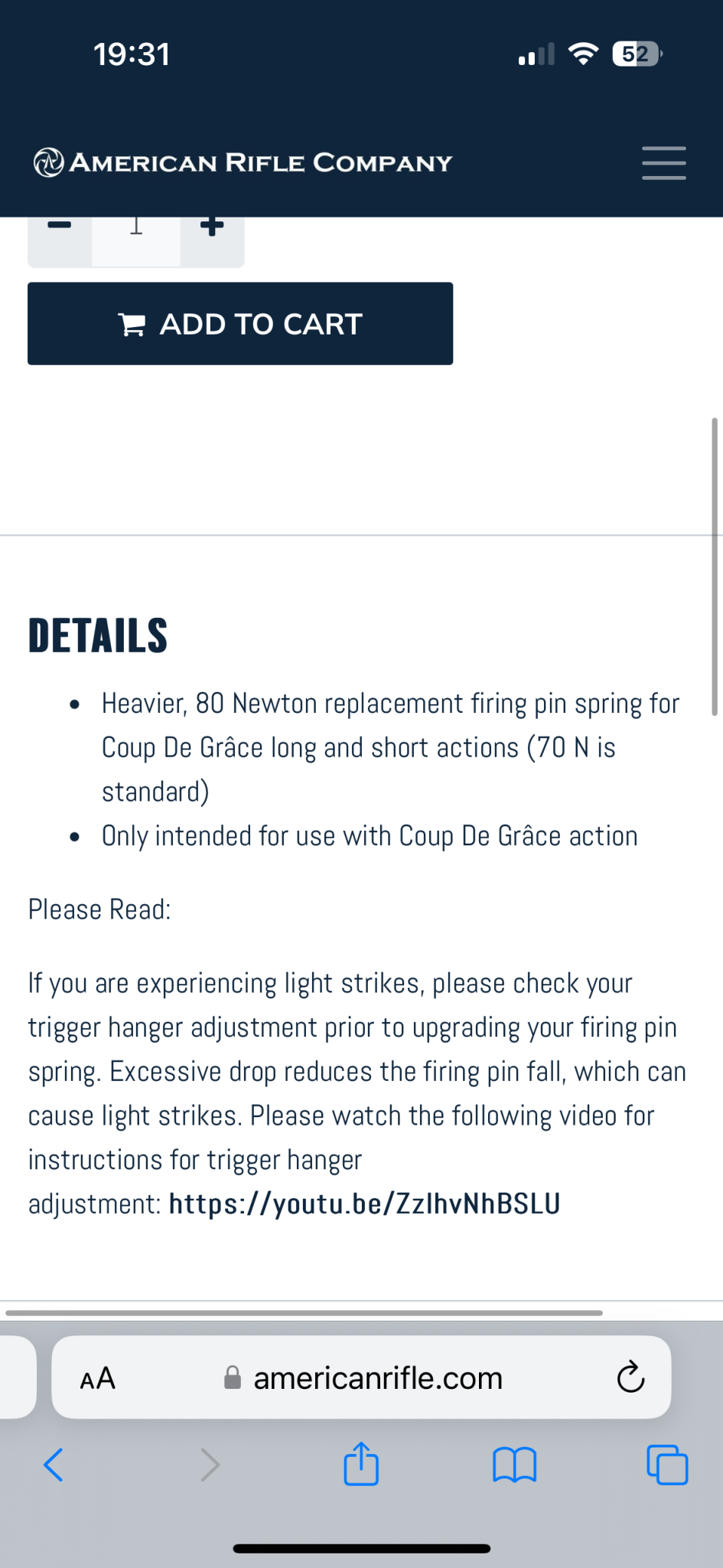

Are you guys talking about the striker springs on ARC’s website? What comes standard and what is the benefit to changing it in which direction?
80 comes standard. I bought the 70, as it will reduce the bolt lift. mainly I like to tinker and they were available on the website so why not. you could buy the 100lb spring if you want to know what an AI feels like.
this whole not going into battery thing is something I've somehow screwed up.
bolt head is correct orientation. going to check the cocking piece tomorrow, thanks for your ideas guys I appreciate that.

This is on the 80N spring page, so I’m not sure?
Reactions: spife7980
my understanding from ARC via the phone is that 70 was standard when it was new then they went to 80 for reliability when dirty or some such reason(I forgot what he actually said)
my action is the latest iteration and shipped with an 80 spring. the 70 is about 1/8th inch shorter, give or take and definitely goes together easier.

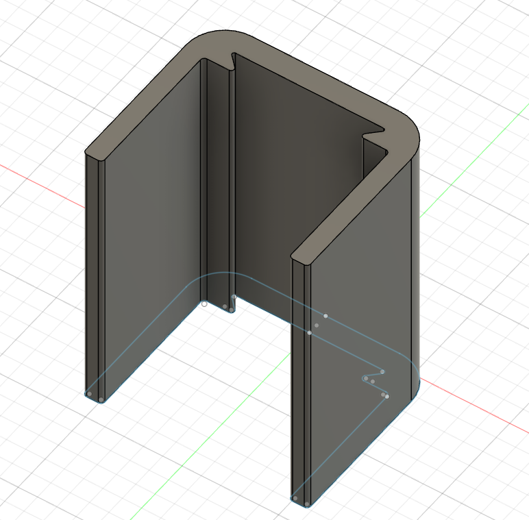

I doubt anyone will care but I'm curious to try this out on a Xylo once I get one. I actually don't have anything Arca to try it on so I'm just going off of the RRS Arca specs.
I'm planning on getting an Arca adapter for my Atlas bipod and putting it up at the front and then putting these on the rest of the rail as I just shoot at the range so I don't need to be moving the bipod all over the place on the rail.
Reactions: Absolution
Printed?
Yeah I just printed it on my Bambulab X1C.
I'm still learning Fusion as I'm not a CAD designer so it's a bit of a chore for me to design things but it's fun to experiment.
I did find a small Arca rail on Thingiverse that I printed as well and it's a perfect fit so that's nice to see.
I could still use the measurement for the height of the sides of the Xylo (excluding the Arca rail) so that I can get that correct. I started with 1.5" as a guess but an actual number would be nice.
If anyone wants the file once I get it done I'll put it up on Thingiverse.
I have 2 CDG's (1 from SAC here now and 1 from ARC direct that I'm waiting on) so I'll be buying 2 Xylo's, however, I'll probably try to catch a sale to lessen the pain a bit since I still need triggers and barrels.

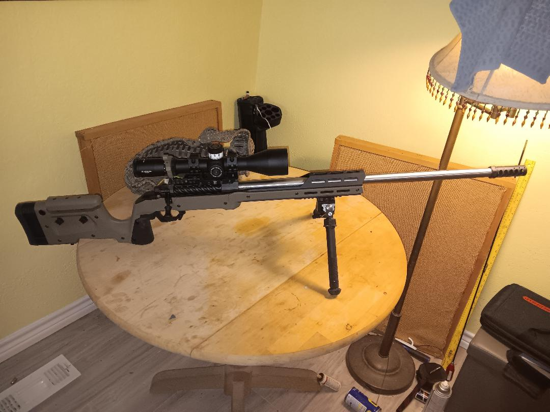

Here's my CdG in 7 PRC, 30 moa rail, with a 26" PVAS barrel, MDT stock and Fat Bastard muzzle brake. Every one who sees is jealous. If they get to shoot it they immediately go buy a Fat Bastard. Not only cuts recoil, but tunes out muzzle flip. Only downside I've found is the 7-8 week wait, but patience is a virtue, or so they tell me.
