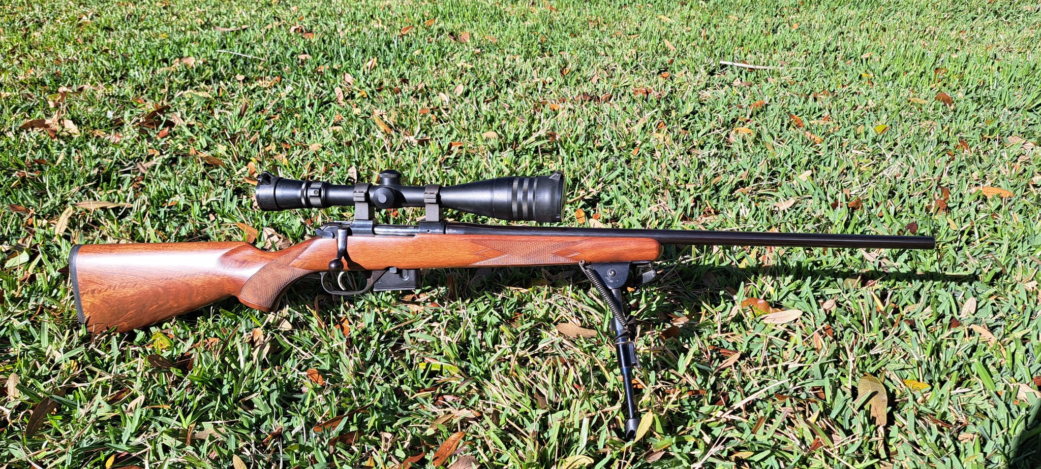

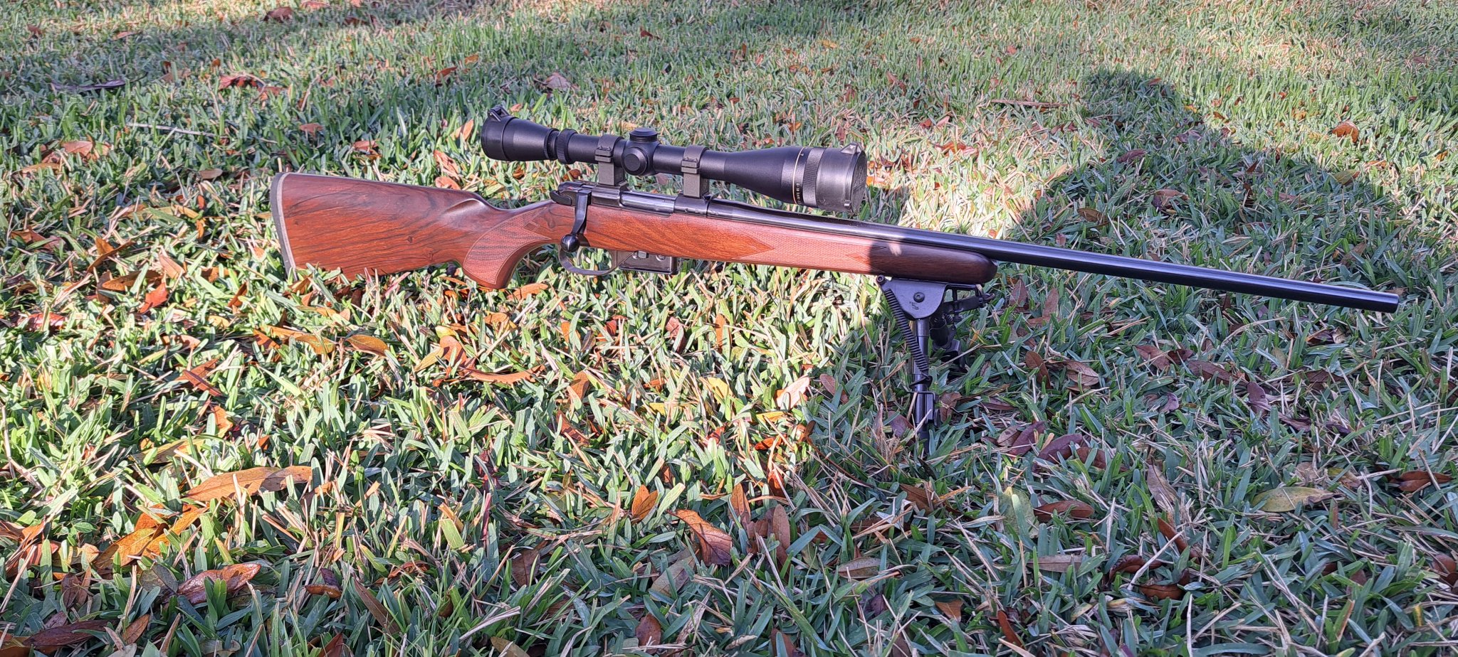

Sounds a bit like my multiple copies of CZ 527 mini-mauser actions. For that action, talented tinkerers have somewhat fixed that issue but I never had any luck. Only notice it when cycling actual rounds and not during dry fire. Usually pushing the back of the bolt helps a lot.
But you shouldn’t have to do that stuff to a CDG.
