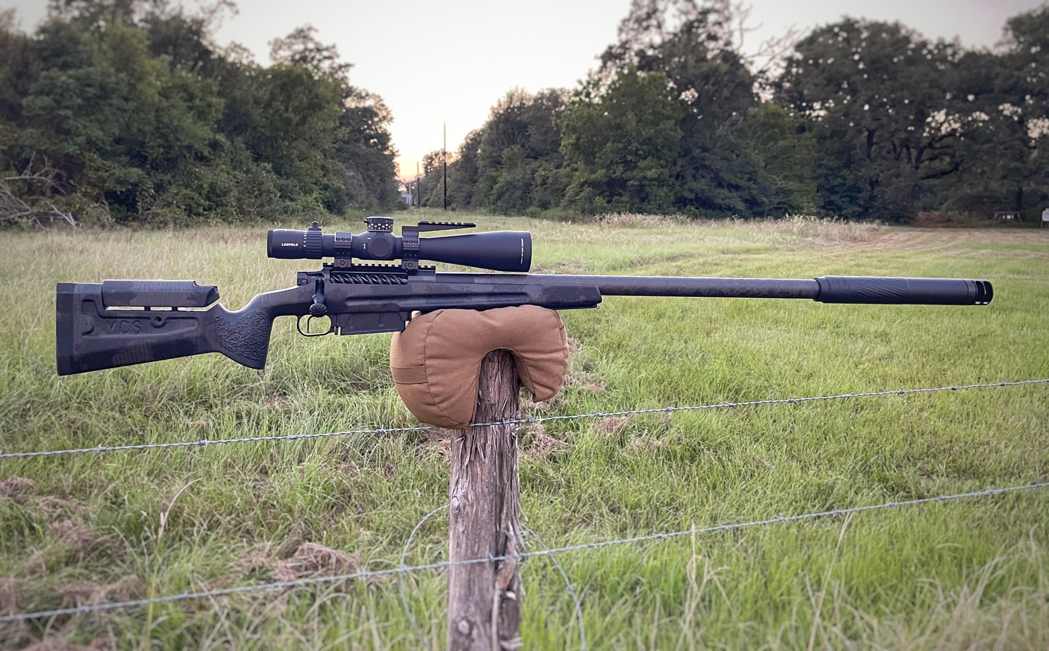

I've got this thing working. Definitely the best valued action I've ever seen and my favorite tactical short action at any price.

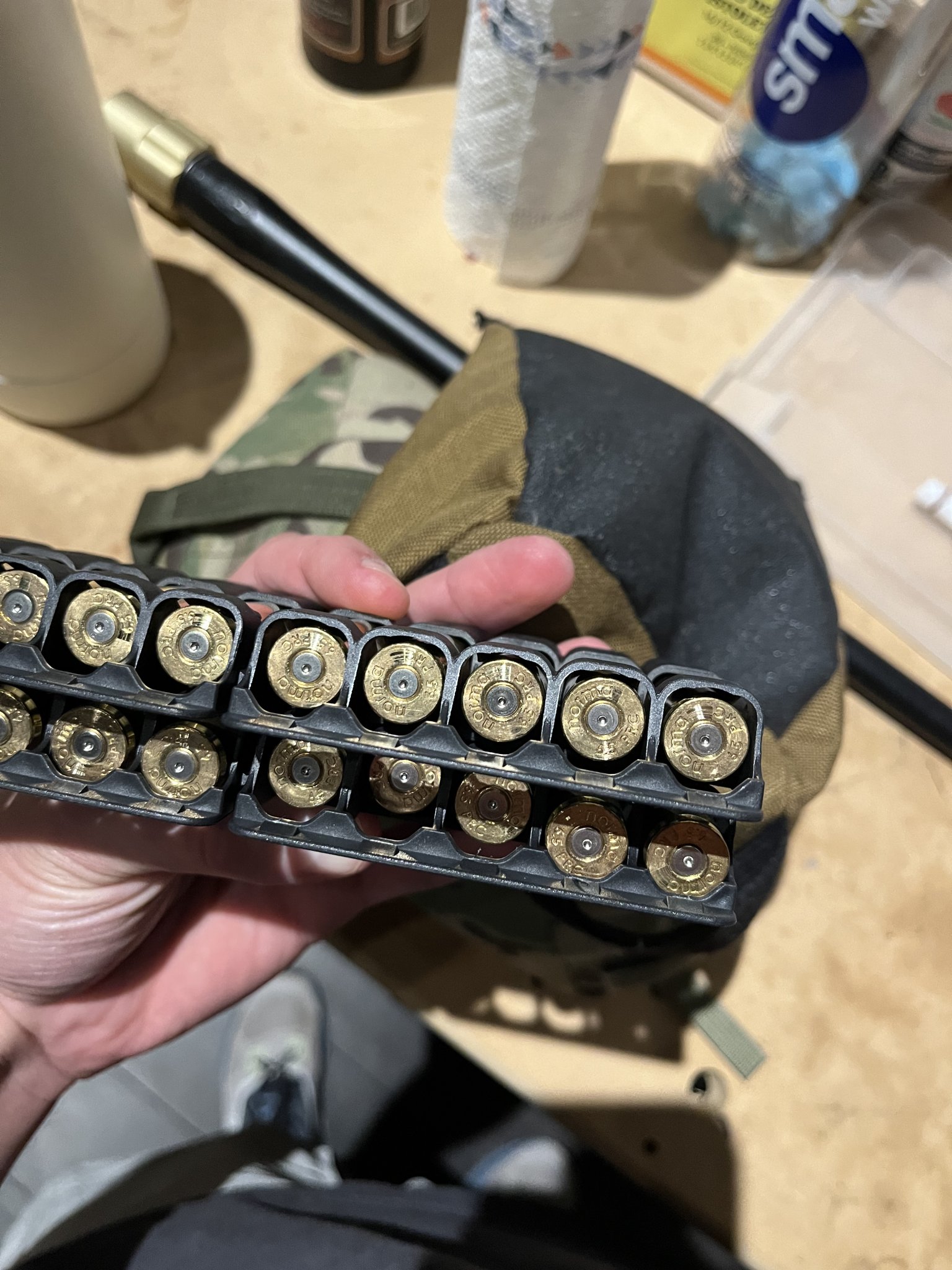

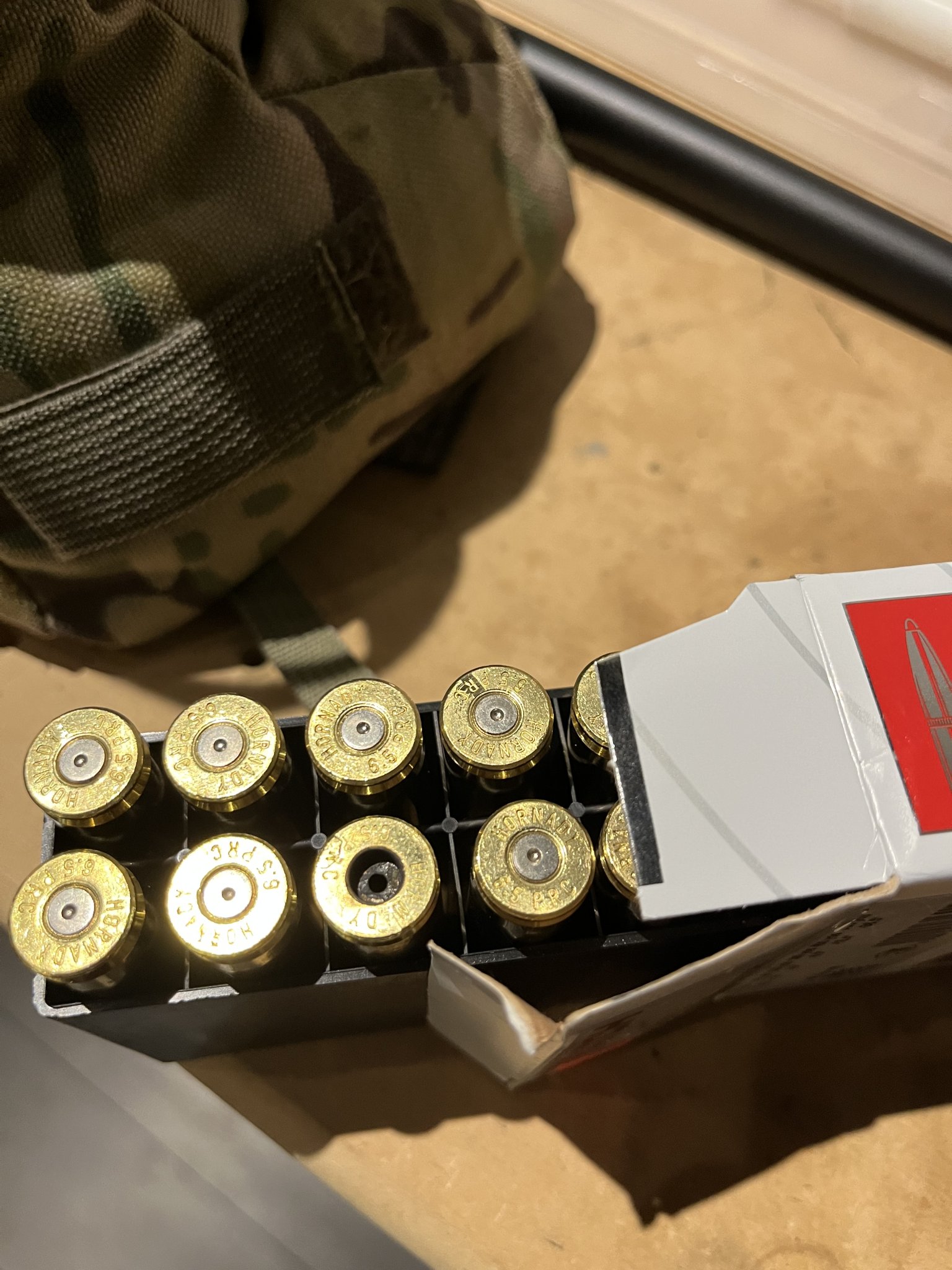

Anyone have issues with extractor makes on almost every piece of brass? I’m shooting factory 6.5 prc ammo, both hornady and Norma and seeing it on both. Barrel is clean as a whistle and bore scoped. I was single loading so not sure if that has anything to do with it. Just very confused at this point.
The popped primer was before the cleaning as I thought maybe I had a carbon ring. Borescoped, saw a minor ring forming so I scrubbed it. Borescoped after and it was squeaky clean. Shot some more hornady after the cleaning and still showed pressure. Norma was all shot after cleaning and it showed pressure as well. I think it’s something with the barrel, but curious if the extractor marks are normal for the CDG
Yep, I get marks on my brass even at book minimum load (H1000). No other pressure signs, headspace gauges check out (go and no-go) so I just don't worry about it.
maybe a burr. whip out a magnifying glass and a small razor and very gently round it off. mine had one, didn't affect anything in any notable way other than that it bothered me so I fixed it. 5 minute job to find and fix for me.
Perhaps ask the barrel manufacturer or whomever chambered it.
I had minor extraction issues when I started exceeding book pressure. Backed down one node (if you will) to another lower load, still over pressure, that works even in the roasting sun after many rounds here in Florida on a sunny day. Still getting 2920 with Berger 190s in a 30” 7PRC.
Typically, no matter what the load info is, pressure will manifest itself with signs. The chamber has very much to do with when you will see pressure. In the magnum type cartridges, this becomes evident before it might in the .308 based cartridges.

I’m shooting factory hornady and Norma. Both I’d expect to be well below max pressure.
Preferred didn’t have much other than make sure it’s clean as they were surprised it’s swiping. They did mention I could back down to 70 ft lbs, but it likely won’t do anything from the 110 it’s at
Do some reading and you’ll see that some factory Hornady 6.5 PRC was hotter than many of the later batches. Search and you’ll find references and maybe even lot numbers. There are some shooters that really loved the hot 6.5 PRC stuff and are unhappy that they’ve backed the load down.
Like I said, the chambering makes a difference.
