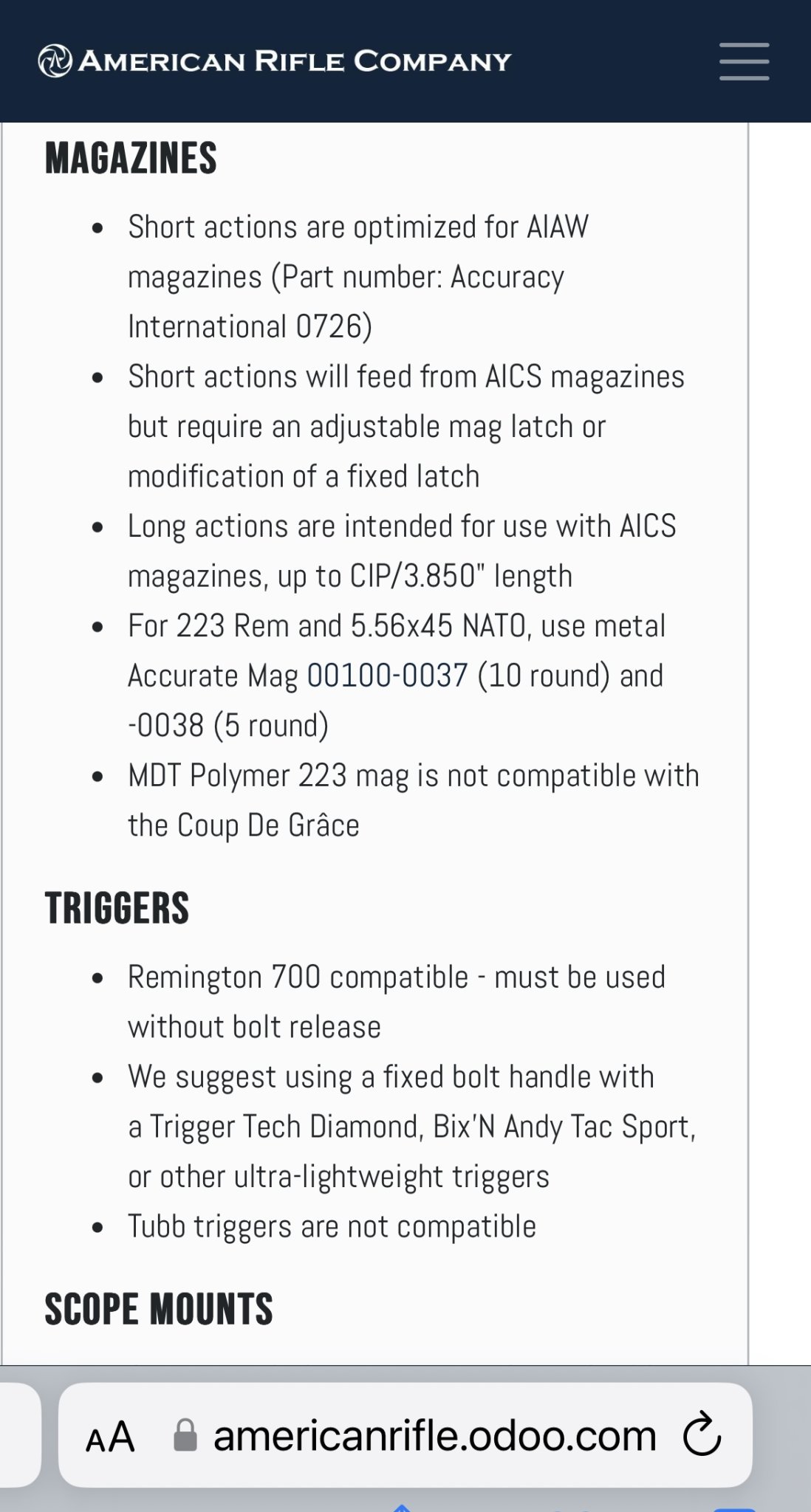

How are folks faring with the BnA triggers? I recall ARC has said the pivoting handle isn't the way to go, but I thought folks had success? Specifically two-stage of interest to me is two-stage folks.
Not sure if BnA triggers change anything but MPA's CDG based builds come with the fixed handle and they specifically say the pivoting one doesn't handle triggers below 1 pound as well.
Reactions: LR1845
from what I've read, it's a shot in the dark as to whether it'll work perfectly as described or not with the two stage or if you'll have to be gentle with the bolt close.
or you could just order a separate fixed handle to be on the safe side.

I thought it was regarding trigger tech diamond trigger specifically in a light setting
someone at arc basically explained it to me as a trigger capable of being set below 1lb was likely to be problematic regardless of what you actually had it set to, but the interwebs people seem to say the two stage get by with it sometimes.
Reactions: lash
I've put over 15k rounds on BnA tacsports set at 1# on a couple of Archimedes and about 1k through another on my CDG with the pivoting bolt handle haven't had a single issue with any of them. As far as the trigger is concerned a CDG with the pivoting bolt handle behaves the same as an Archimedes as neither has an extraction cam to take the initial impact and slow the bolt forward velocity down when closing it.
Can't comment on how they behave if set lighter, but the lighter and less sear engagement the greater the chance of an issue with the pivoting bolt handle.
Also, shouldn't matter if the bix is single stage or 2 stage as the Bix is not a true 2 stage trigger with extra sear engagement that is reduced in the first stage travel. The first stage on a 2 stage bix is simply spring tension controlling the rotation of the trigger shoe until it contacts the lower sear lever, the sear engagement of the 2 stage Bix is constant just like the single stage version.
Another way to help avoid issues with light triggers and the pivoting bolt handle is to adjust the trigger hanger to have about 0.010" of decocking on close. This way when you close the bolt the case will stop the forward motion of the bolt rather than the cocking piece slamming into the trigger sear. When set up for a bit of decocking on close the cocking piece stays on the cocking cams and will then contact the trigger sear much more gently as you're rotating the bolt closed and the cocking piece rides down the cocking cams. Setting the action up for decocking on close will give up a little bit of firing pin energy, but 0.010" less fall is negligible and should not cause light strikes or anything like that.

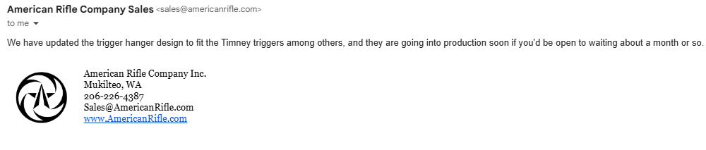

After having to grind on my hanger (for Timney 2 stage light) I wrote to them and suggested that they just extend/deepen the notch a bit so people who don't use TTs (which is the only trigger that ARC sells) don't have to go thru this.
Direct quote from their reply at the end of Jun: "Hello Stephen, revised trigger hangers are being made now to accommodate a wider range of triggers and will be available in the next couple months."

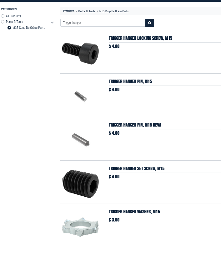

But as I said...I don't see any hangers for sale as a piece part on their site at the moment which is strange as the advantage of the hanger is quick trigger change if needed...so, kind of think they would sell them (and perhaps a call to them to order one will work..dunno)
Actually, the revised one doesn't work universally either. Still find myself having to dremel them...
Yeah...so, I think mine had the first revision of the hanger and yeah, we still had to grind.
Remember the un-anodized one you gave me...and they were OG revision and were made to take the pointy pins (did I give those back to you...I don't have them anymore...maybe trash canned them as they weren't applicable any longer).
Then the next rev was the one I have (and probably you too) that took the blunt pins but the notch still needed to be ground out to accommodate pretty much anything other than TT.
So, their comms to me at the end of Jun seems to indicate that there will be another revision to the hanger to extend/deepen the notch and perhaps that's what is shipping with new actions.
