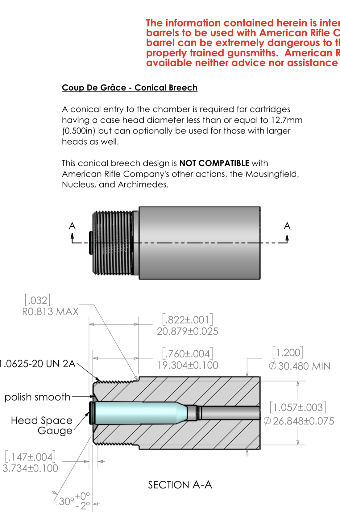

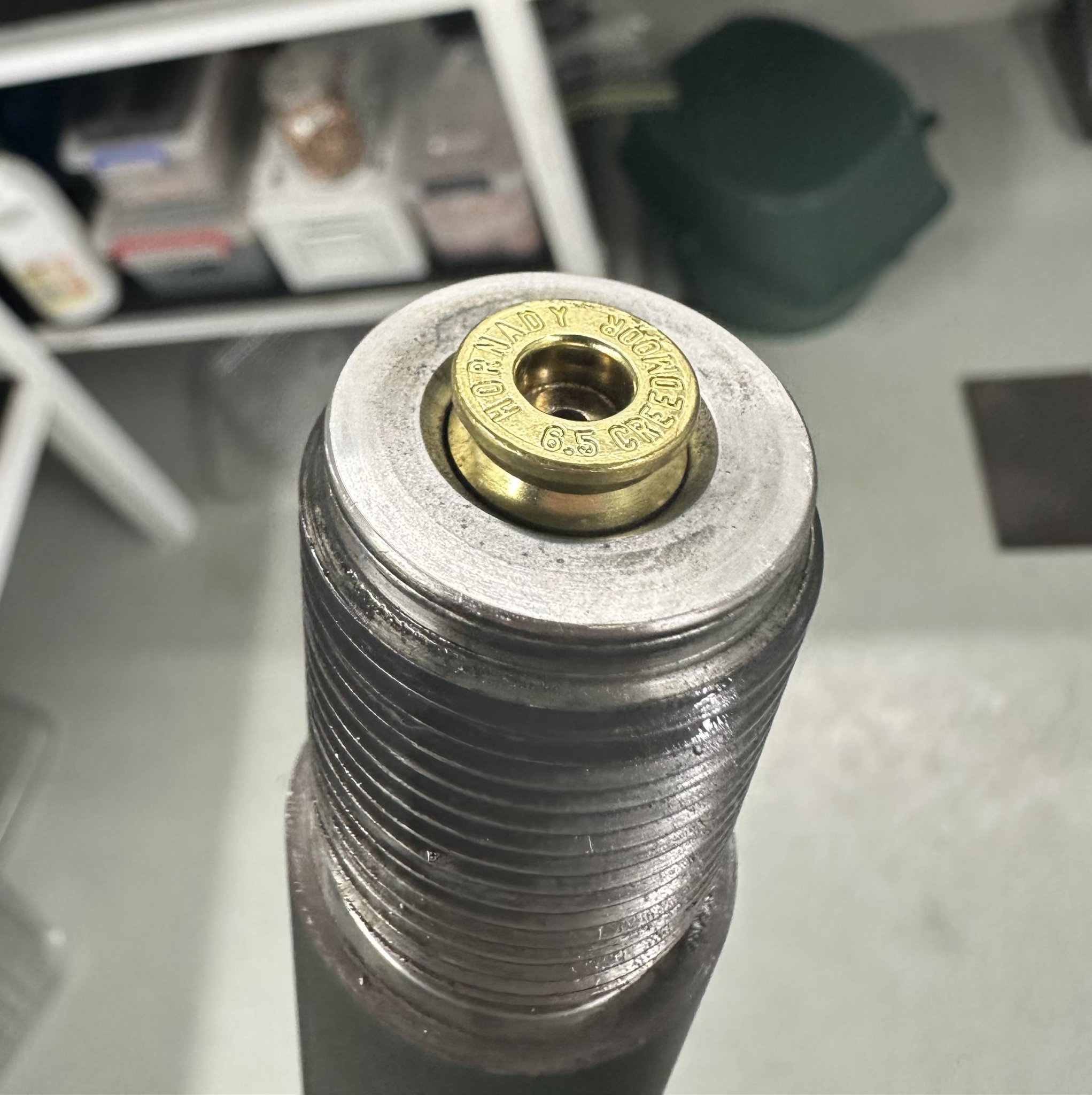

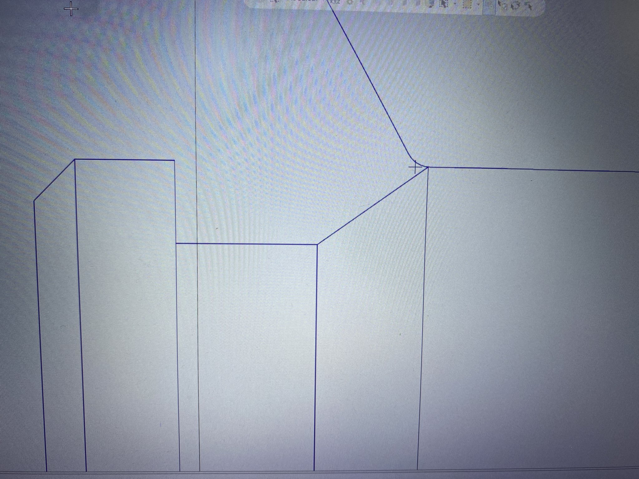

If those dimensions are correct, and the cone doesn’t pass the extractor groove, then mathematically the cone is out of spec. So while you’re technically correct, that the cone passing the groove doesn’t mean it’s in spec, it’s clear that there is more tolerance on the side of being deeper rather than shallower, until you run into unsupported cases. That’s a decent amount deeper.
I’ll just leave this here:
So, the intersection of the coned breech and the chamber is proud of a saami spec .473 case head extractor groove by .005”.
As long as that means the extractor isn’t touching the cone, which I’m sure it does, all good. Using a case as a gauge in my previously prescribed manner is not correct, for a .473” case head, but will work for a .223 based cartridge.
Thanks for doing the math and the illustration sketch.

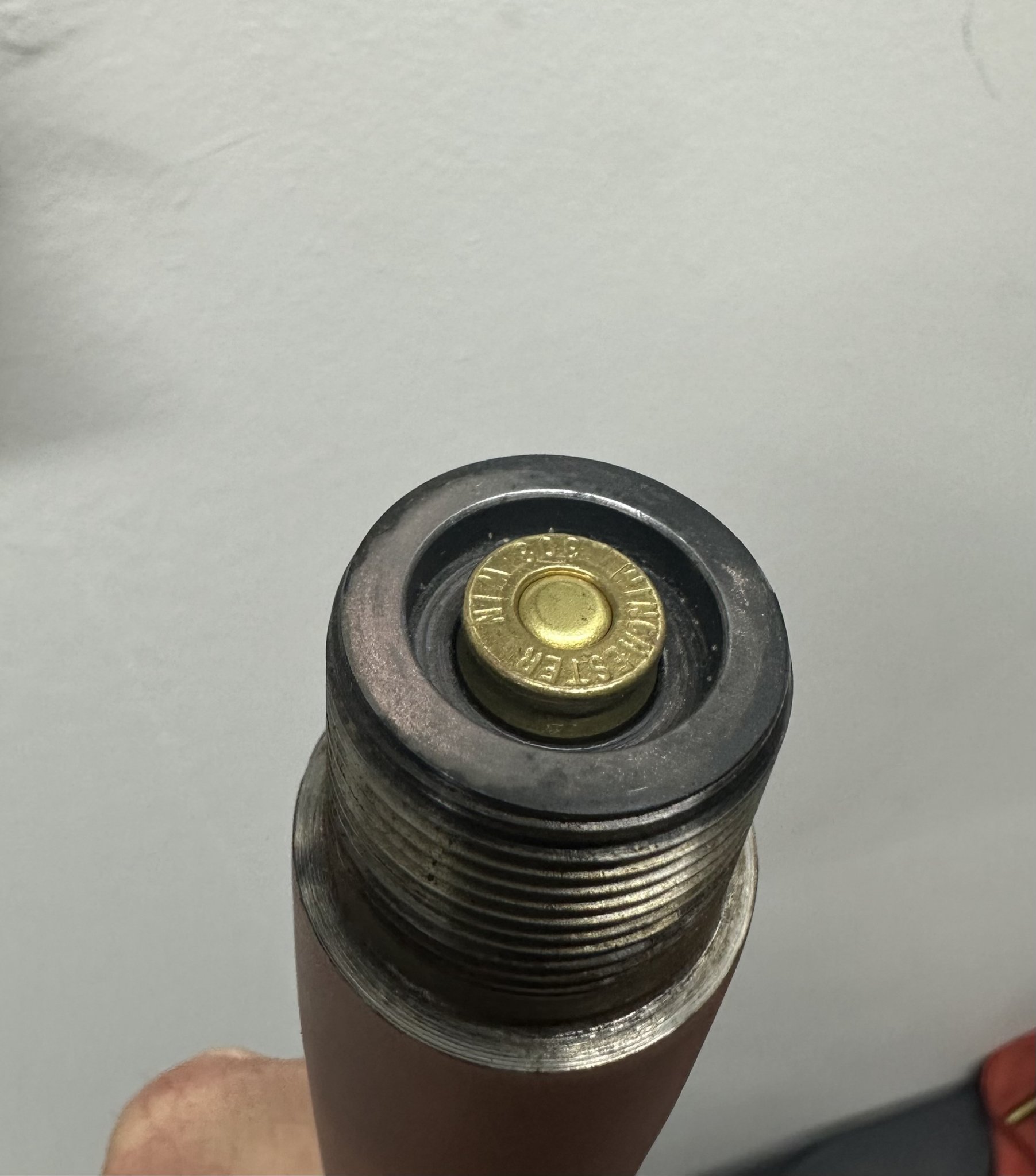

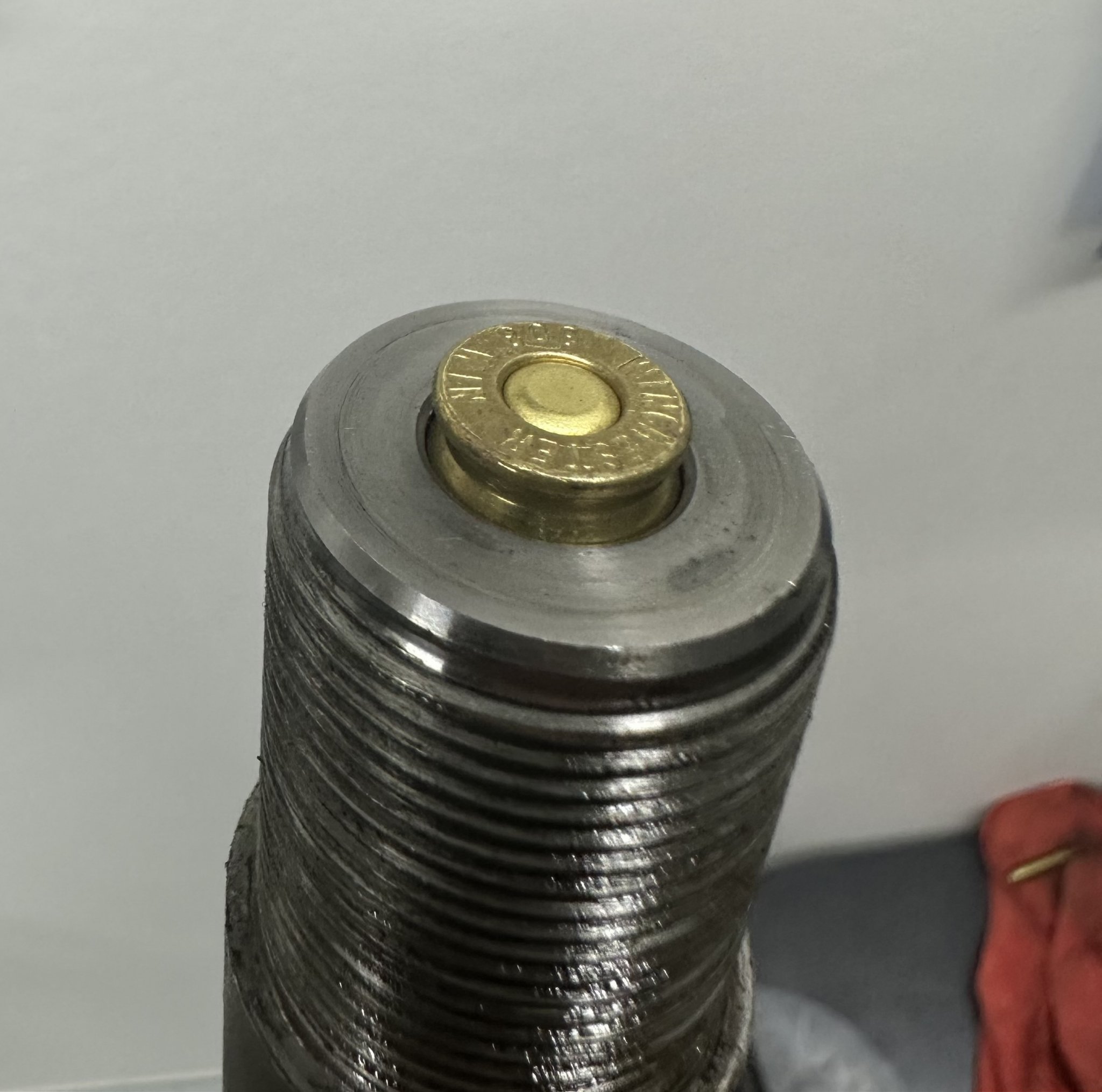

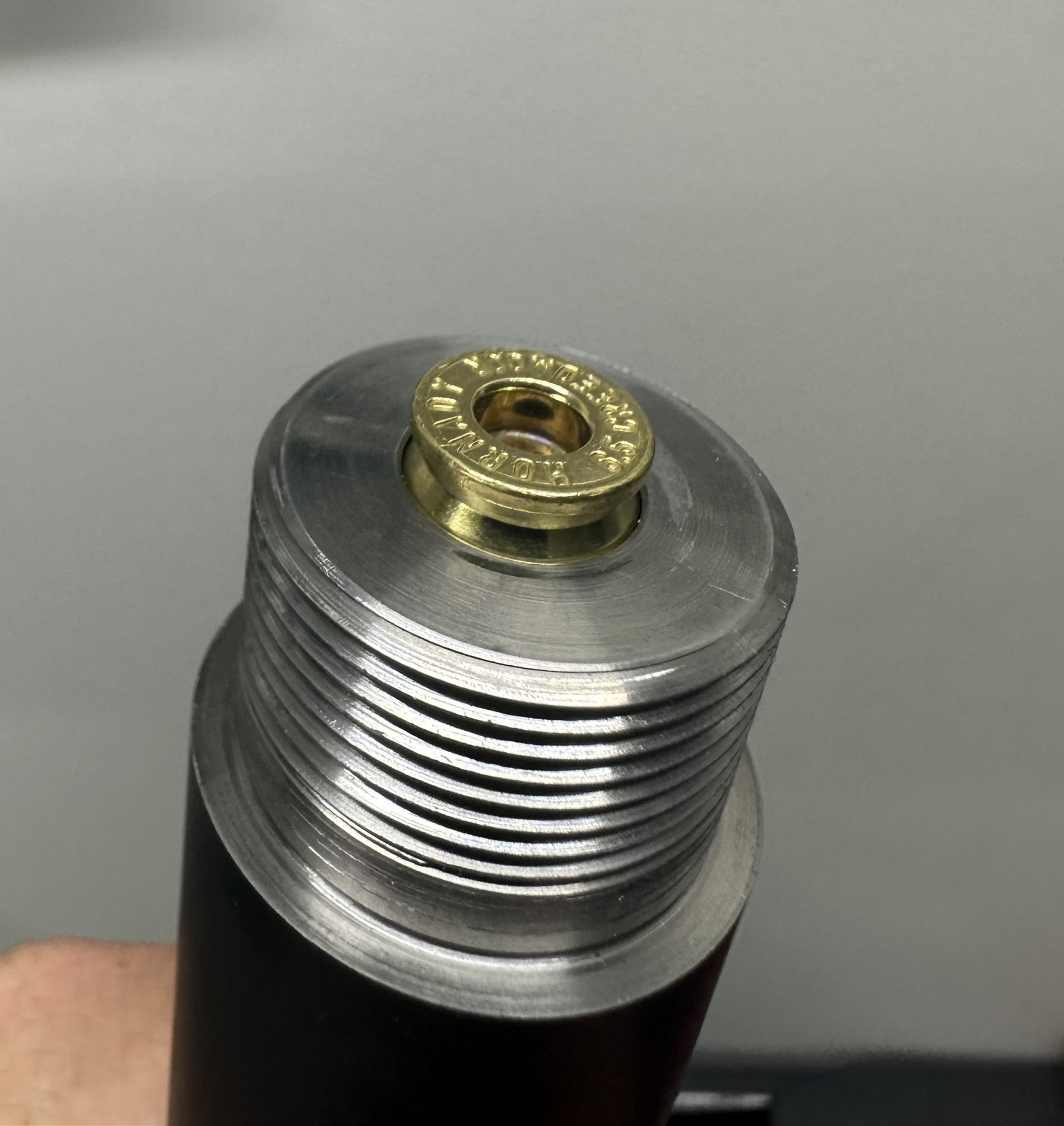

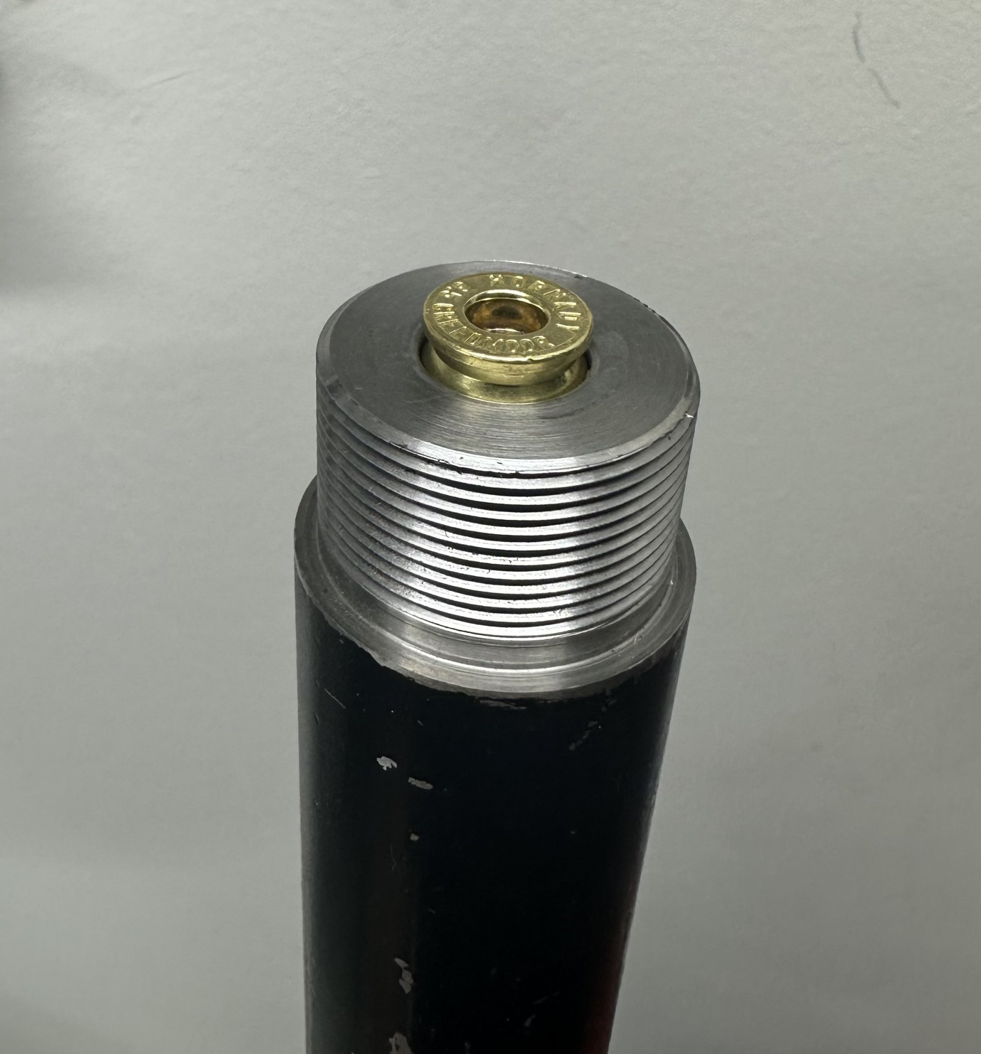

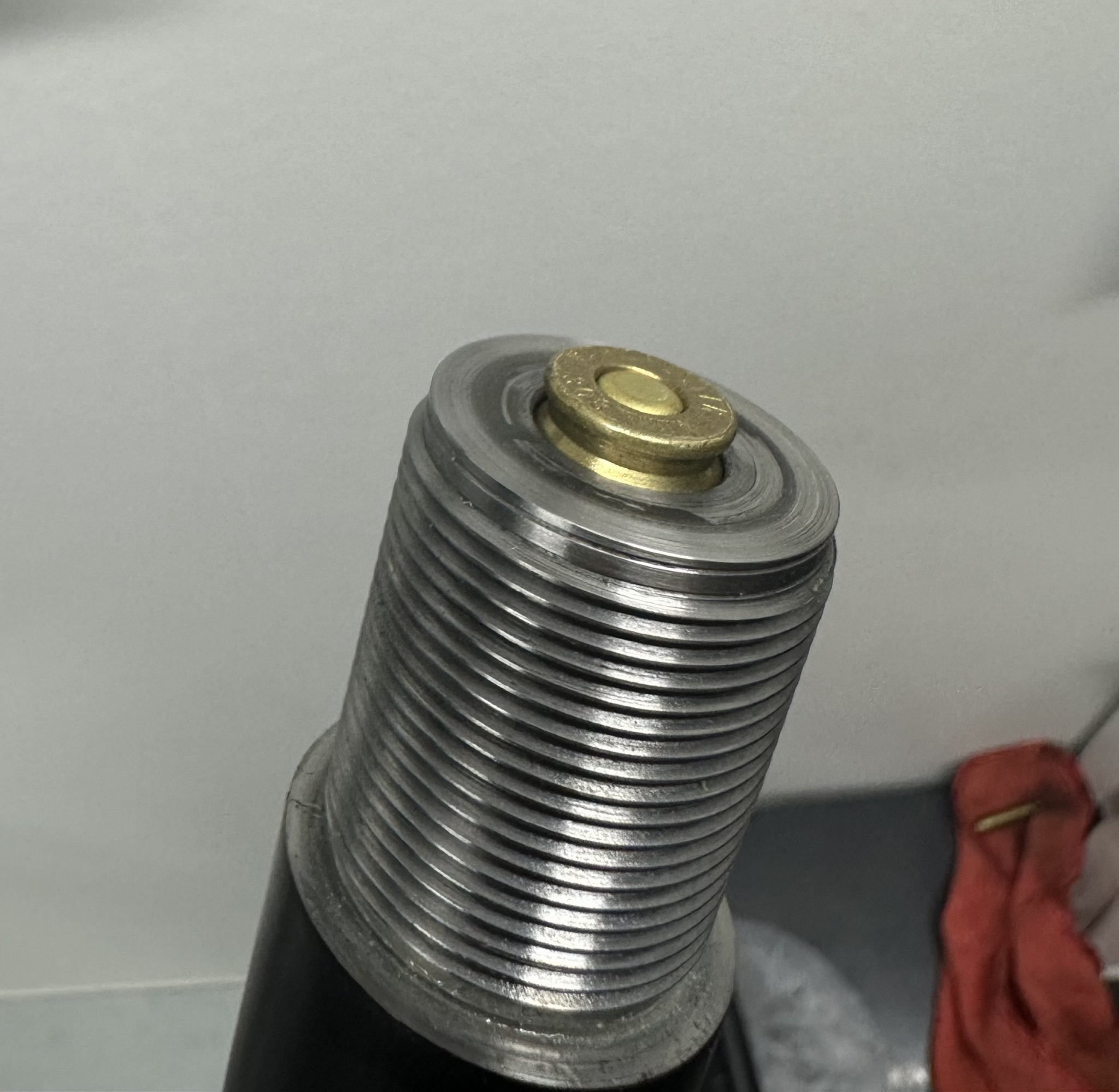

So according to Bohem this is meaningless or am I good to go? This is virgin Starline ignore the crud I'm a slob.View attachment 8155119

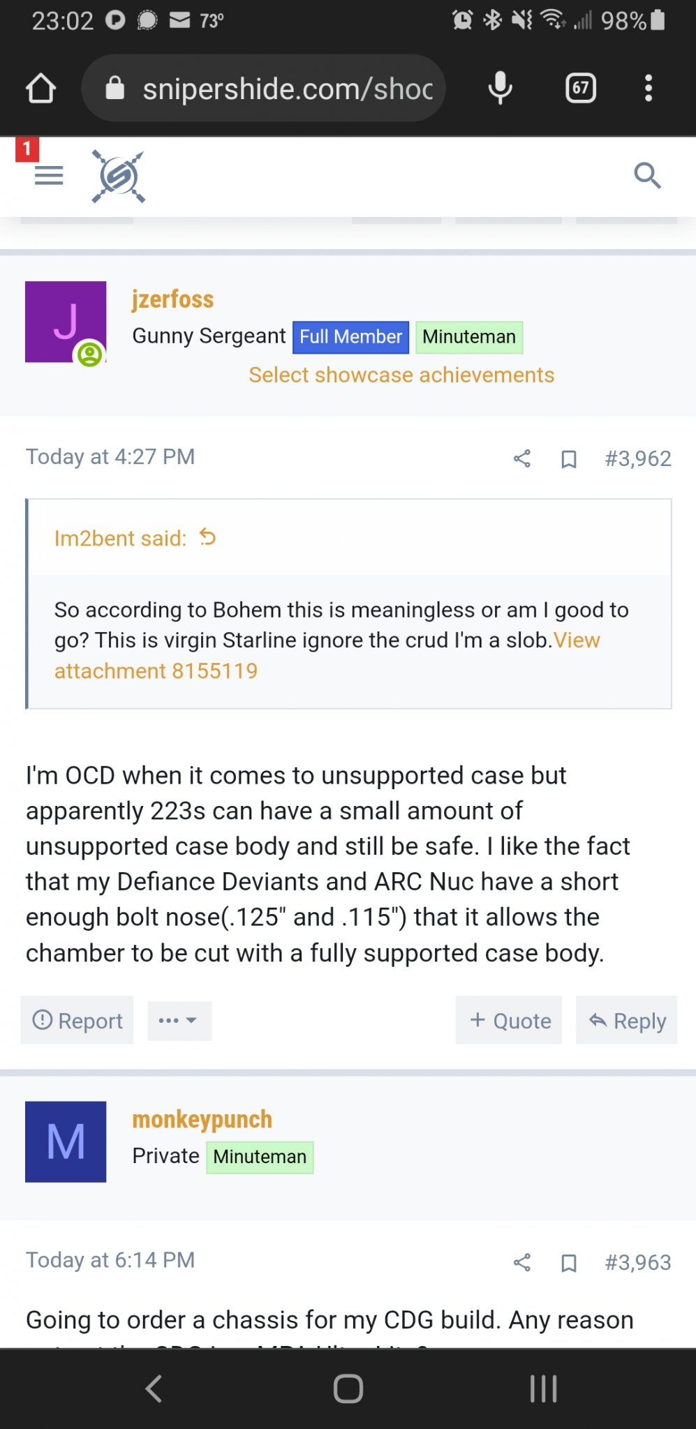

I'm OCD when it comes to unsupported case but apparently 223s can have a small amount of unsupported case body and still be safe. I like the fact that my Defiance Deviants and ARC Nuc have a short enough bolt nose(.125" and .115") that it allows the chamber to be cut with a fully supported case body.

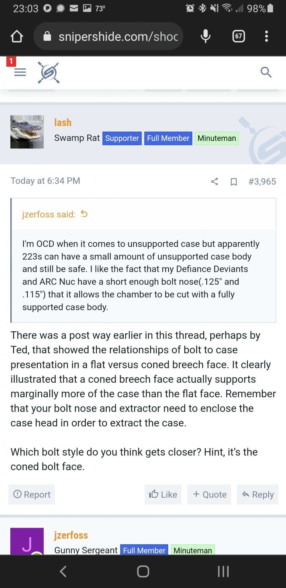

There was a post way earlier in this thread, perhaps by Ted, that showed the relationships of bolt to case presentation in a flat versus coned breech face. It clearly illustrated that a coned breech face actually supports marginally more of the case than the flat face. Remember that your bolt nose and extractor need to enclose the case head in order to extract the case.
Which bolt style do you think gets closer? Hint, it’s the coned bolt face.

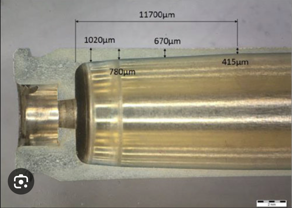

I was specifically referencing the picture. Maybe it's possible to have a completely supported 223 case with the CDG but it's not in that picture. Idc, which one "gets closer" as long as it completely supports the case which my Deviants and Nuc both do.

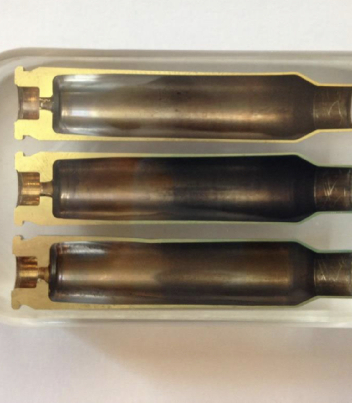

That 223 is fully supported. If you cross sectioned a case you’d be able to tell.
No it's not.... I'm fully aware that brass is thicker with most cases at that point but not all manufacturers have the same case head depth(or thickness depending on how you look at it). Federal 223 brass had issues with thin/short case heads years ago that was apparently well know. Like I said it's a general consensus that a small amount (no agreed upon measurement) of unsupported case body is safe with 223. On the other hand plenty of BRs and creedmoors have had case head seperations with that amount of unsupported case body.

That is a 100% fully supported case.
