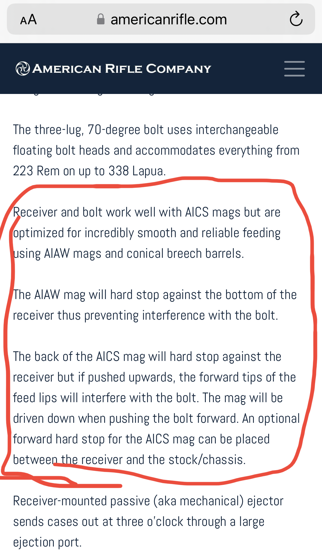

I don’t see why it wouldn’t work. It was not said that AICS mags would not work without mods. Here’s what it said:
"An optional forward hard stop...." is what I was referencing. This is a modification of some sort.
I wonder how a hawkins or similar bottom metal would work, given a "hard stop" would be necessary to keep the bolt from hitting the mag.
Wonder if we’ll have to get a different mag catch or some thing for the Xylo to be compatible.
The new MDT ACC with the adjustable mag well would probably be also a good fit.
