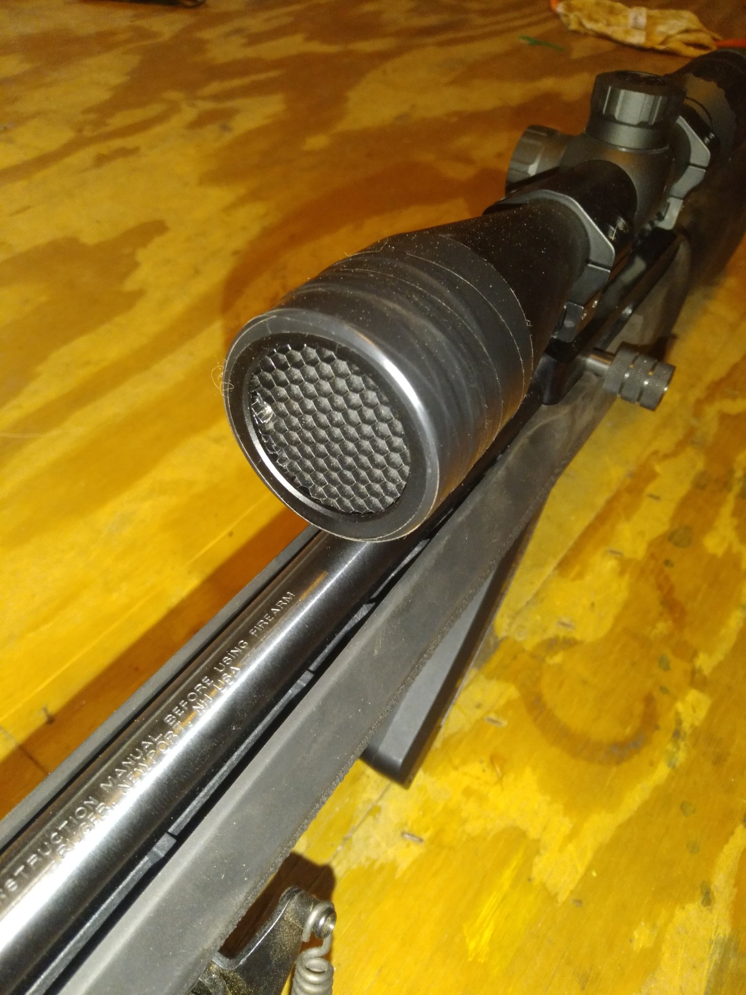

Electric tape makes parts that dont wanna go together, go together anyways lol.
