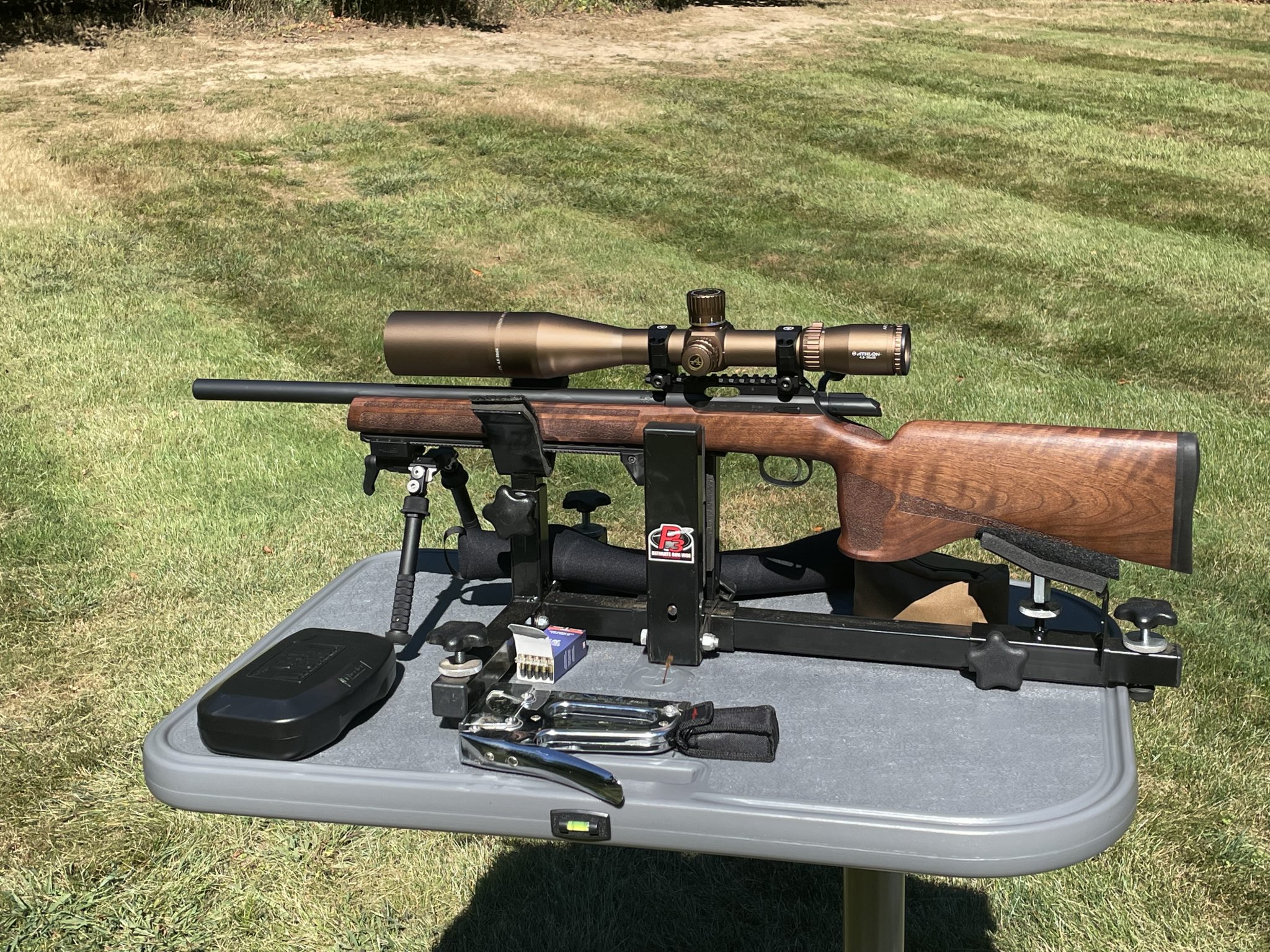

CZ 457
CZ457 18.5” Lilja 22LR ELITE Barrel in a Rigid Alloy PRF Chassis, XLR butt stock and Timney Trigger.
Arken Optics SH4 6-24X50 Gen2 FFP MIL VPR illuminated Reticle with zero stop.
Suppressor is an Obsidian 9. Waiting on my KGM RF22 that is still in jail.
CZ 457 PRF Chassis with 18.5 Lilja Elite barrel with obsidian 9 suppressor.jpg
Suppressor is an Obsidian 9. Waiting on my KGM RF22 that is still in jail.View attachment 7923726

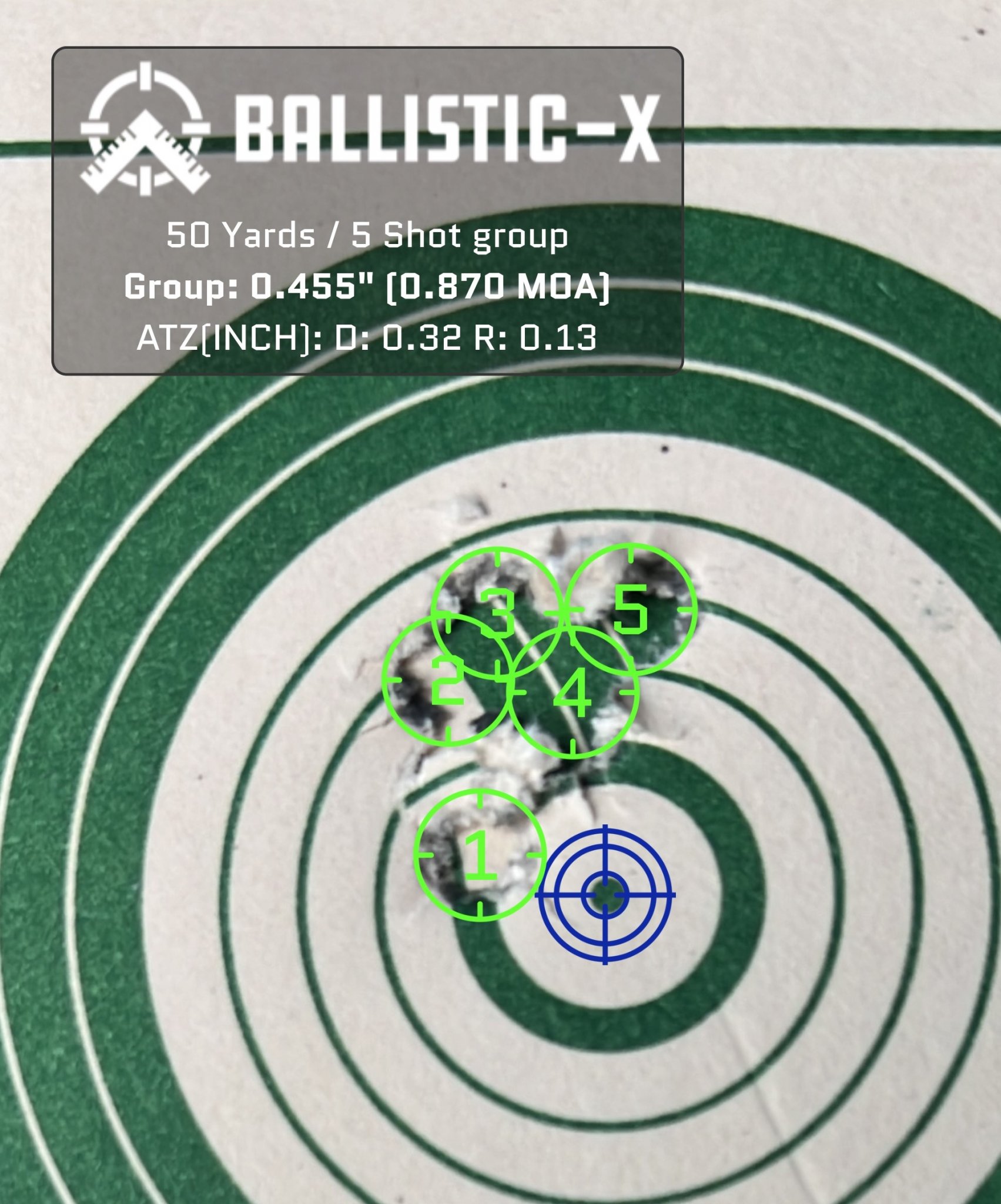

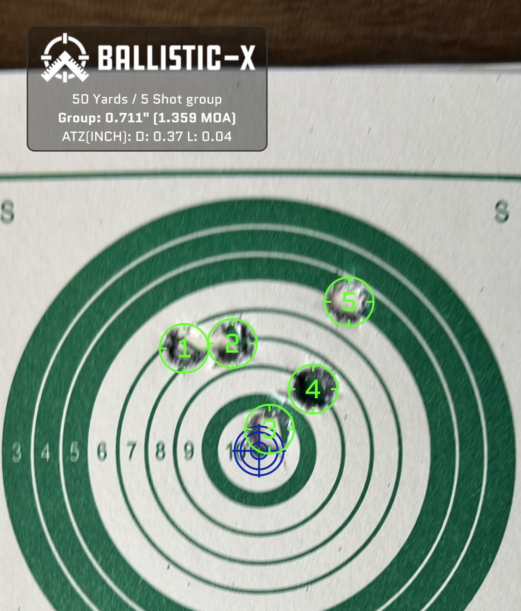

Finally was able to get out and do some shooting after about 2 months off with a broken left arm/shoulder. I was pleasantly surprised with this group at 50 yards with SK Long Range Match at 98° F. This is a 5 shot group (and yes just showing my best grouping for the day, but the other groups where acceptable). For the heck of it, I decided to try out the 24"x24" steel at 550 yards off the bench due to arm. I was able to get 8 out of 10 hits on steel. My dope was 30.5 mils and 1 mil to the right. All in all, a great day for shooting, but arm still needs more healing unfortunately.

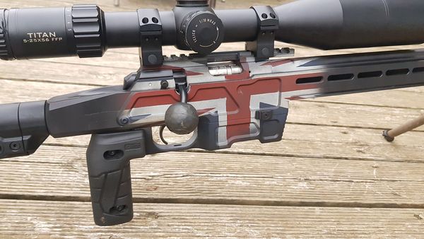

I'm very happy with the Rigid Chassis. Love how they did the magazine release. It's integrated into the Trigger Guard (push to release).
It looks like a really great chassis for an incredible price, what length is the handguard on yours? It seems like your 18.5" barrel barely clears it, I'm wondering if the 16.5" barrel on my pro varmint will.
When i ordered the chassis, i had a choice on the length of the hand guard. I went with the longest (13.6") one. My barrel is 18.5 inches, and yes the barrel stick out enough where i can attach my suppressor (barely). BTW the suppressor is a 9mm Rugged 9. Waiting on my KGM RF22 to get out of jail. Here is a picture w/out the suppressor.

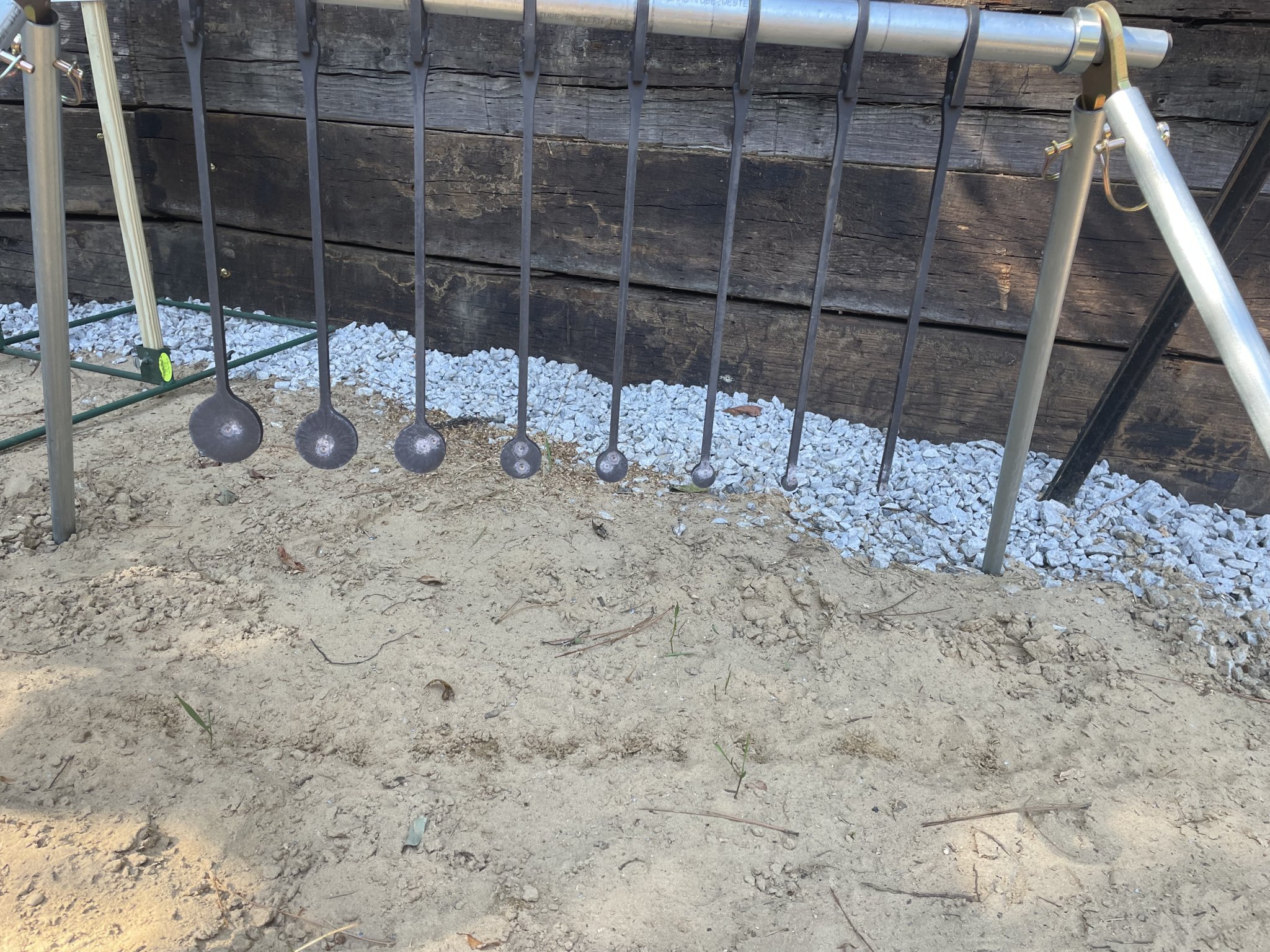

Last time I tried that distance-ish, it was the last stage of a MARS match. We were shooting off a beanbag chair like thing and I missed. Lots.
M
M
KSS had the 42 grn Force on sale for $5.15 a box if you ordered it by the case. Not bad stuff at 300yds.
