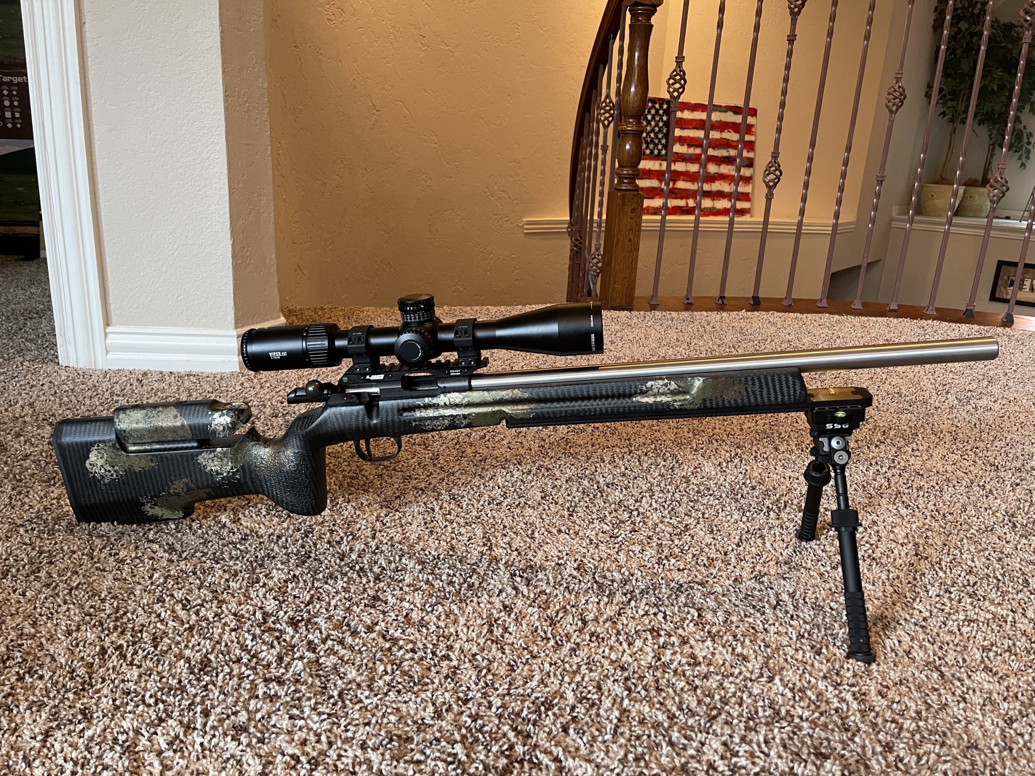

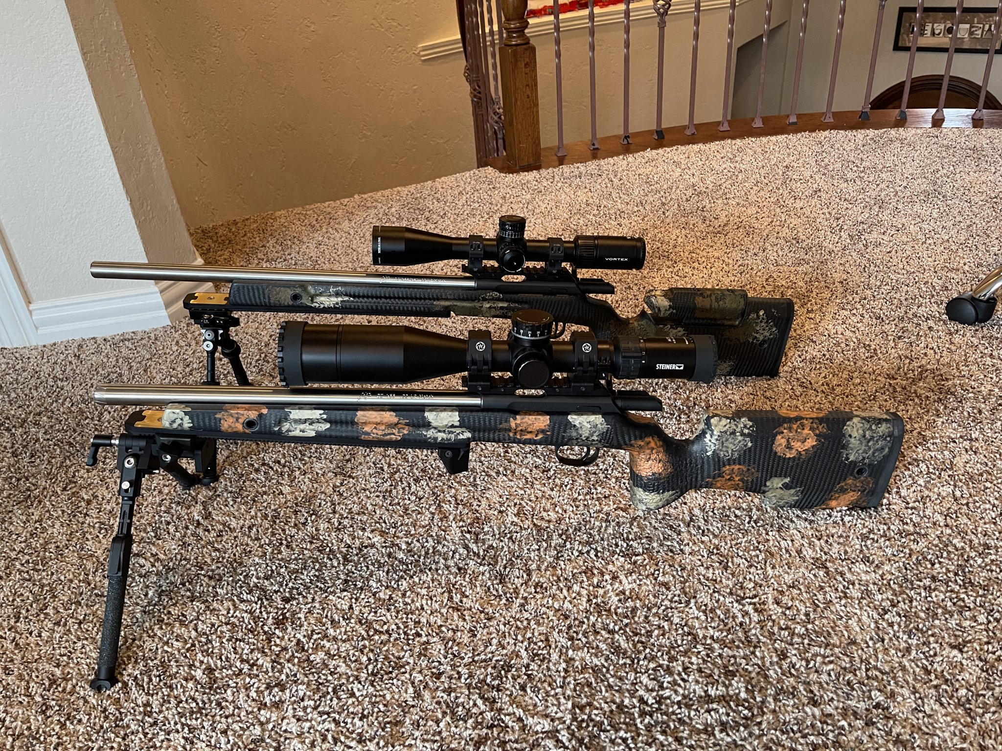

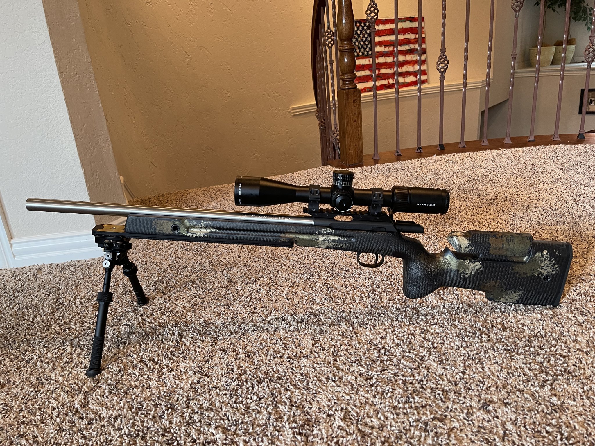

I have three CZ457s - an American, Varmint MTR, and Varmint Precision Trainer in the Manners PRS1T stock. I fell in lust with the American's appearance after seeing the initial advertisements for it in 2017, and the MTR's stock plus the match chambered barrel had a strong appeal as well. I have a one-man gunsmithing shop & ffl, and finding an American was easy, but it took a few months before I was able to find the MTR. The American didn't shoot worth a hoot, even after pulling the OEM bbl to recut a precision 11* crown (factory crown was fugly & ragged), but I kept shooting it due to the CZ fans over on RFC saying it sometimes takes 1000rds before a factory barrel comes around. The MTR OTOH, shot really well right out of the box, and adjusting the trigger for a break just over 1lb made it easier to shoot decent groups at 50yds with it.
Eventually, I decided to re-barrel the American instead of selling it off. Reasoned that I really liked the appearance of the factory sporter stock and the very smooth & reliable function of the action. I bought a Shilen ratchet in #5 contour, parted off the 1.20" shank, and turned the transition radius down to a tenon that was a nice snug fit in the action. Cut a match chamber with my EPS reamer, then milled the extractor slots, set the headspace at .043", and glued it into the action with Loctite #609. That got me away from having to cut the deep grub screw seats, and eliminated the stress on the action & bbl that grub screws create. That rifle now shoots as good as it looks (maybe better), and I'm very pleased with it. No, I don't shoot it in competition, but it's just what I was after in the 1st place - a classy looking sporter that's very accurate.
I decided to buy the VPT because of the appeal of the Manners stock - I have three V22 repeaters in PRS1T stocks, so obviously like that stock. However, the factory 24" bbl had issues, though it did shoot considerably better than the American's factory bbl had done. I put 500+rds through it at 50yds, and felt that groups had improved a fair amount since new, but when I took it out to 100 & 200yds, it fell on its face - couldn't even keep 10rds of a known good lot of SK Rifle Match on an 8" gong at 200. So another Shilen was ordered - this one a straight, no taper of .860" dia. Repeated the same process that I'd used on the American's Shilen, and wound up with another very accurate rifle.
So, in my experience, two out of three factory CZ barrels were really unsatisfactory, and had to be replaced. I don't know if CZ has improved the quality of their barrels since I bought my rifles, but have to wonder about that, with the current positive posts in this thread claiming good accuracy out of the box. I've been happy with the fact that CZ designed the 457 with a fully adjustable trigger - not many companies seem to have the courage to sell a design that allows owners to easily tune their triggers, especially in today's sue-happy society. I wouldn't have spent the time or money to re-barrel the two 457s that needed better barrels if I didn't really like the action. Granted, my experience with custom barrels that I've fitted & chambered on 22RF rifles I've built for myself (Stiller 2500XR, two CMP 40Xs converted into repeaters by Jelrod, three V22 repeaters and two V22S single shots) raised my accuracy expectations & standards to a level that very few factory repeaters in the 457's price range will ever achieve. But like I said before, I like the 457 action, and applaud CZ's efforts to bring a quality 22RF rifle to market at the price point.

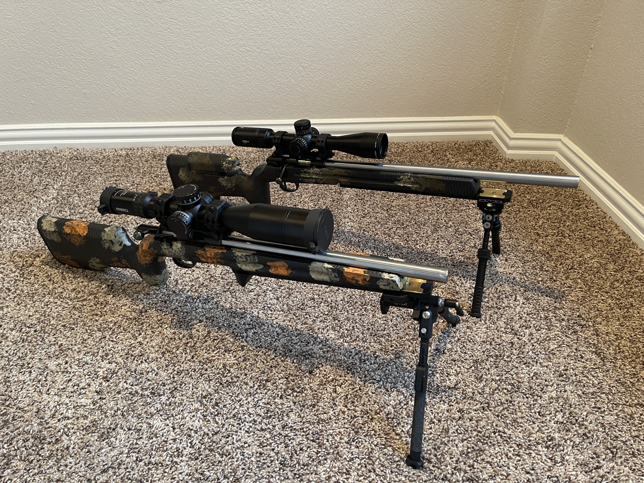

lil'skeet - Should've mentioned that I bought two 457 Americans & a Varmint in that 1st order, thinking that one of the Americans would have a nice looking stock, and I'd sell the other one. Well, the nice stocked rifle that I kept was the one that didn't shoot, and I've never shot either the 2nd American nor the Varmint, as I bought them to sell. Evidently, western Kansas isn't overrun with shooters who're interested in the CZ rimfire rifle line-up, as I've still got both of these rifles, still NIB. I took them to a couple of the gunshows that I routinely display at - didn't get any interest in either rifle. I even took them down to a friend's shop who has a good deal of traffic through his store, with a wide range of RF & CF rifles and handguns, and who is also a Class III/SOT, and who somehow manages to keep a decent supply of handloading components in stock. I figured he'd sell both of them within a couple of weeks...wrong. Evidently, there aren't a whole lot of RFC members out here in this end of the state...
Not surprised. Despite being something of a CZ fan, most non-PRS22 shooting people don't know what they are. Heck! *I* didn't before I bought one. Saw a USPSA competition guy bring his Shadow 2 into the LGS I frequent and went 'oooh purty!'

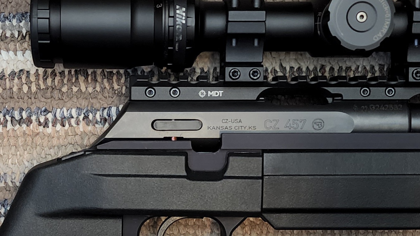

Just finished putting mine together. 22 WMR with a KRG Bravo, MDT base, and Vortex Diamondback 4-16 in Vortex pro rings.

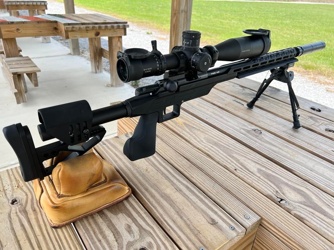

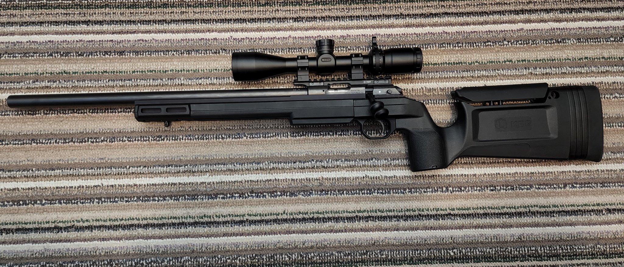

Long time lurker here,
New CZ LRP build in progress:
Drilled T-nut and M5 bolt,
Amazon 300mm Arca rail,
Accu-tac Bipod,
Toolless adjust for comb (M5x30mm (comb height) and M5x25mm (butt)- coarse thread pitch) knurled/machined thumb screw bolts
Added 2 factory spacers to extend LOP.
Action work: smooth/polish bolt, stone/polish sear/trigger surface, new trigger spring.
Picatinny rail cover for the rear monopod rail (reduces scuffing).
This rifle comes standard with 25MOA rail so added Athlon medium rings 1.16" height, and Vortex Eagle Strike 5-25x56.
For my cheek positioning the comb is just high enough for me to remove the bolt easily so no blockage there. The toolless adjust makes it easy for me to adjust comb if it is an issue. No need to lug around a T25 torx screw driver.
Future mods :
Neoprene wrap for adjustable cheek pad.
Trying out some soft bedding material to stabilize action/receiver but not be permanent,
Scope mounted bubble level,
Possible flush mounted QD cup in the stock fore-end, to match the rear QD cup with sling use (sling nuts removed for Arca rail - factory were loose, not aligned well and had wood screw threading).
Still debating the bolt knob. The feel is good but the rubber cover on it has decent grip but feels odd.
The LRP with the fluted barrel and match chamber came with a slight rear heavy balance, now with the Arca rail and bipod it balances nicely right in front of the magazine release. Good for tripod use and balance on barricades.
Shot this rifle bone stock to get a feel for it before making upgrades. Used Norma Tac @ 50 yards under .5moa groups (I believe it can do better but our self made rules says front tripod only no rear bag/support. Will try better ammo. Shot more consistent than a friends AT-One 24" non-match barrel with same ammo. Hoping these mods will make it feel better for me and make it easier to shoot it better. It shoots better than me for sure.
Bought it because a bunch of friends are starting a friendly weekly competition using hostage targets printed on 8.5x11. They all shoot CZ 457 in different configs. 2 x MTR, 1 LRP, American, AT-One, PV so I can test and compare them side by side. I now have the second LRP in the group. It was a toss between this and the AT-ONE. but the AT-One did not come with match barrel. May upgrade to chassis later or build a custom and keep this as is. If anyone wants additional images of the build please let me know. I'll do what I can.

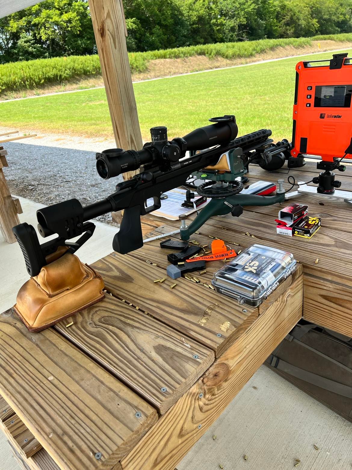

First outing today for the new 457
The 24" barrel isn't quite the handicap in a MARS match that I thought it would be. Not lots of gates or in and out of gaps in the barricades tho.
I can tell I haven't shot the rifle in a bit 'cause I wasn't building good positions today. Lots of misses because the reticle was all over the target(s)

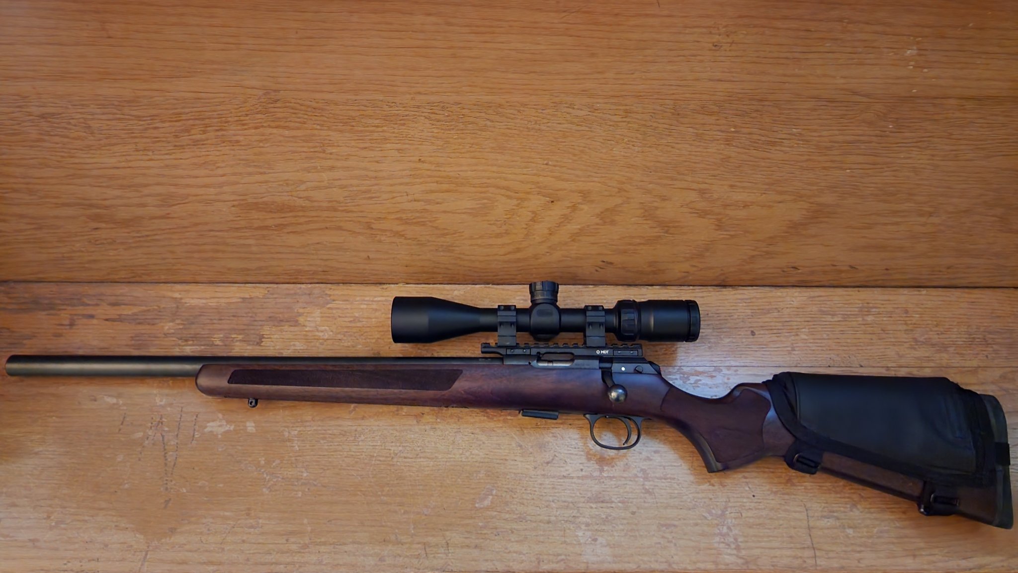

Got my at-one 457 out yesterday. I'm still looking at permanent scope options and decent ammo, but wanted to play with the new toy.
Got zero'd and shot a few groups at just under an inch at 50 yards using a cheap loaner bipod, 2-7 vx3, and 40gr super-x. I'd say there's plenty of potential there.
The stock on the AT-ONE isn't free floating the barrel everywhere so I need to take down a couple high spots. No biggie.

They sure are nice little rifles. I bought a Varmint in 22mag a few months ago and have really fallen in love with it. My sample is way more accurate than I was lead the 22mag to be. Its no 22lr but still, its pretty darn accurate. It likes Speer gold dot and cci fmj. Actually those are the only two Ive tried in it but it shot both quite well.
That was sight in day with the GoldDot load at 50yds. 6 rounds a d then that so at round #16 it was shooting fine. The bore is beautiful and I hit the wood lottery with my stock. But, and this is a big but, CZ put their famous CZ mud finish over top of some really figured wood, breaks my heart. And its so dark. Ive got to figure out a way to remedy this.

I smoothed the bolt and the ways inside the receiver, adjusted the trigger to my liking, added a new bolt knob my big mitts can get ahold of, got a few 10rnd mags and an aluminum magwell. The best thing I think I did though was buy rings from D3Precision because there was absolutely no way I was going to ruin the look of it by putting one of those monstrosity of a rails on top of it. Petes rings are as good as there is for that 11mm dovetail, bar none. A d they put the obj of my 44mm scope about .2" above the barrel and with a Vortex Defender cap about .1" is left, perfect.
The mag release is a disappointment isnt it? Im after one but theyve all been out of stock lately. Im thinking the one from DIP.
