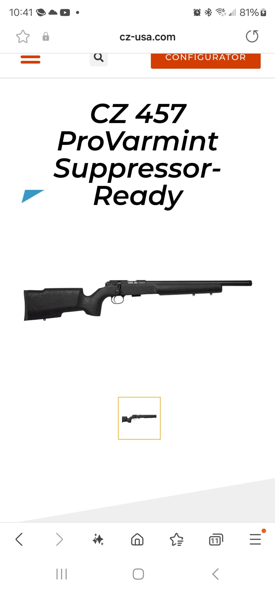

probably going to get the threaded black laminate stock one and rebarrel it for prs use.
fwiw mullerworks has cut rifled rimfire blanks for order if you email them.
think this stock will be suitable for prs to learn if I add an arca rail and a small cheek riser if needed?
not positive it'll balance but I think it'll be there, maybe I'll drill some big holes if needed.

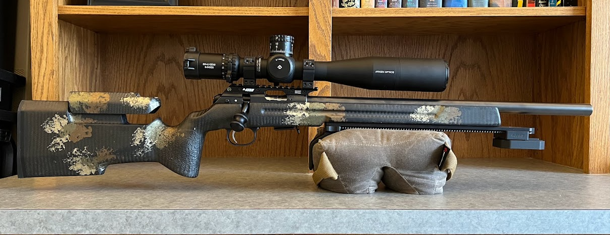

+1 on the 1.180 straight. That'll match the diameter of your action and offer the most weight for balance. We have a 24 inch 1.180 on order from L3i, but according to my calculations it should be the right amount of weight to balance it the rifle nicely. My brother's CZ (factory VMTR 20.5 inch barrel) needs an extra 1.5 lbs out front to balance currently. Because barrels have the weight distributed evenly it should be enough out front. My calculations say the new barrel will be ~3.5 lbs of total increased weight. He also has the Area 419 weighted rail on there currently.
Current setup. The ADM PRC Gravity block and clamp weigh ~1.25 lbs. It just manages to balance as it is and weighs 13 lbs without the weight on there.
