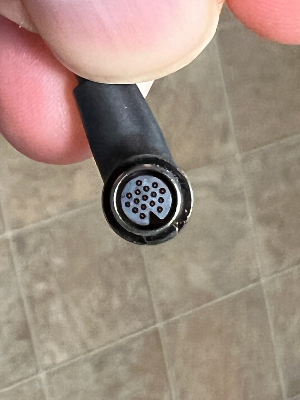

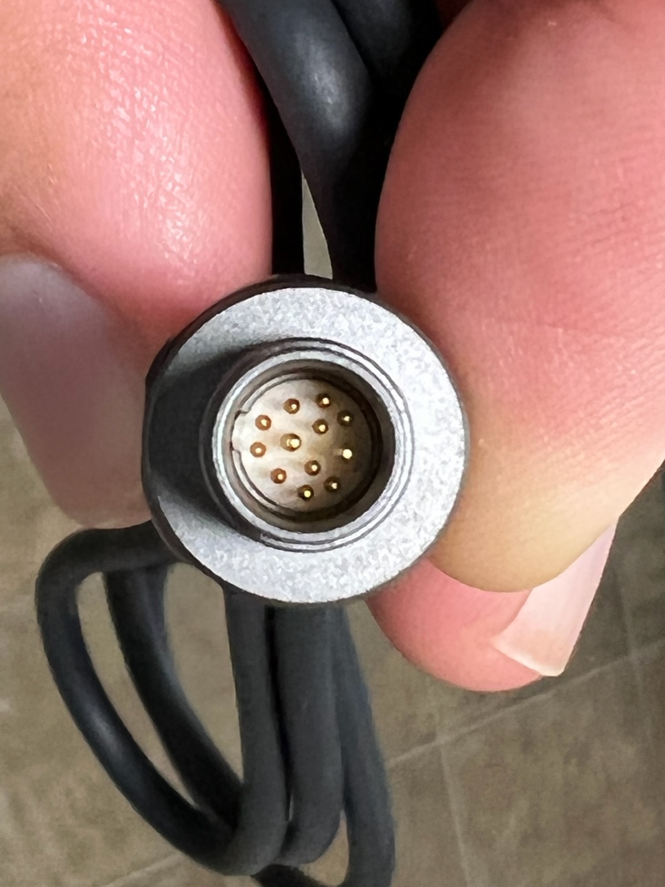

OTN sells the PoT TracIR cable for $1K. It’s nothing special and has no remote, so you’ll have to use the buttons on the Raptar, but it’s a minor inconvenience.
Works great — just like the Trij/Oasys.
Behold, a $1000 cable. :poop:
