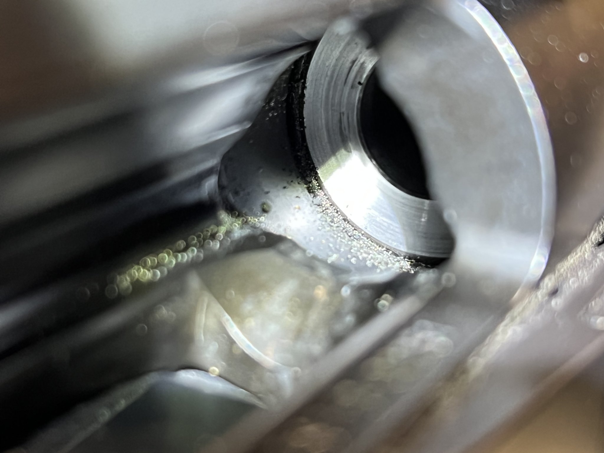

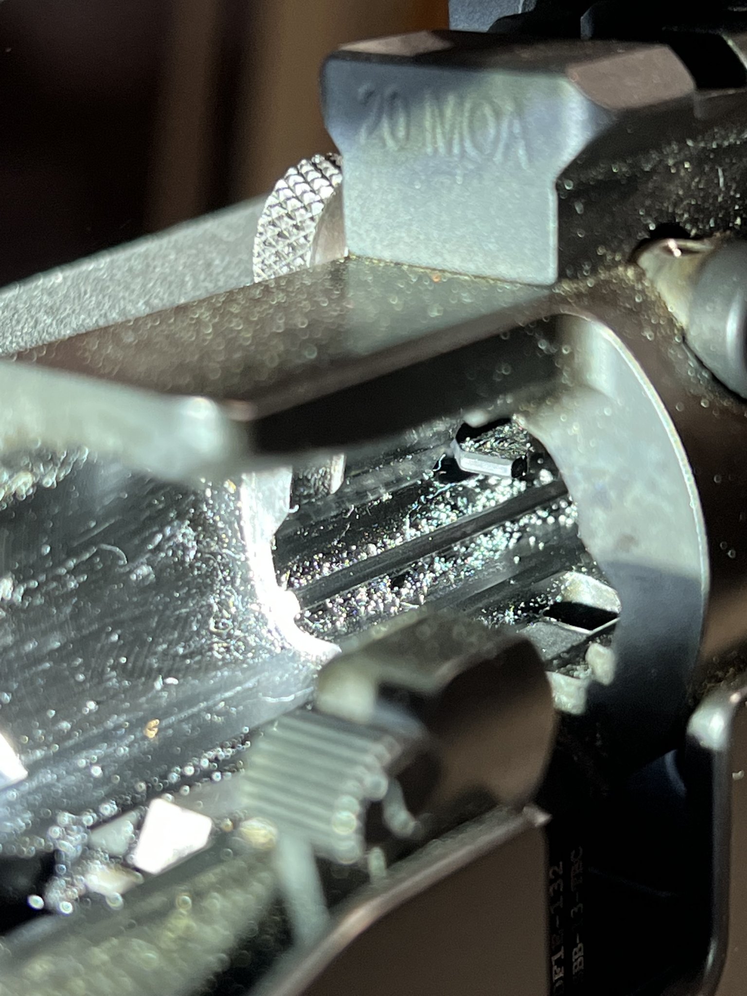

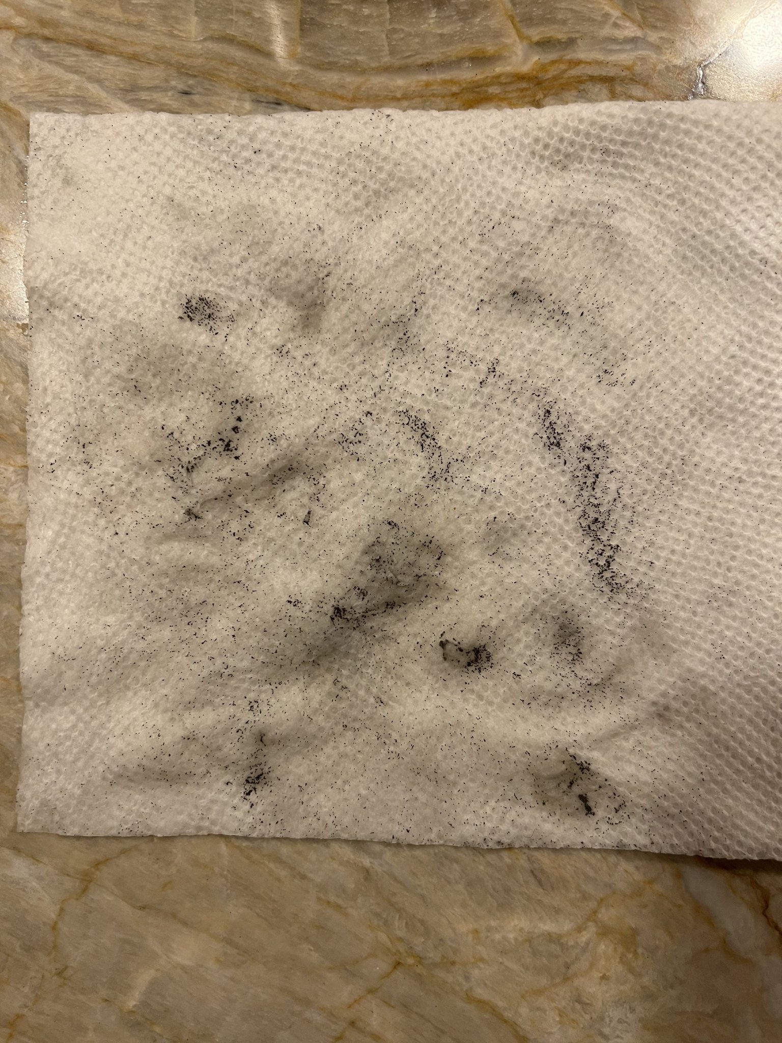

Good luck, all three of my Nomad Ti’s had a bad weld and it took more than 5 months, so longer than the fucking ATF took to approve them, for KGM to get off their lazy asses and fix them after they repeatedly used the reserved parts to ship new cans instead.
And to add insult to injury they were too fucking lazy to bother cleaning the sand blast media out so the first time I used it to check zero I ended up having to tear my entire rifle apart to get the media out of the barrel, action threads, raceway, bolt, trigger and stock then spend several hours washing the cans to get the rest of it out and scrubbing the threads repeatedly to make sure the mounts didn’t get locked into the can due to the grit in the threads.
Dead Air ended up giving me several hundred dollars worth of Xeno Mounts and adaptors for all three cans to make up for it so they did their best to make it right in the end.
So as far as I’m concerned I like Dead Air but KGM can get fucked.
View attachment 8101840View attachment 8101841View attachment 8101844
Mannnnn. There's no excuse for that. What we found from this is that they were running a separate warranty production path and they weren't following procedure by using the automated media blasting machine and instead used a manual system where they didn't plug the ends. Again, no excuse and I'm really glad we got you taken care of. You have to be the most patient customer I've ever had the pleasure of working with and I thank you for that sir.

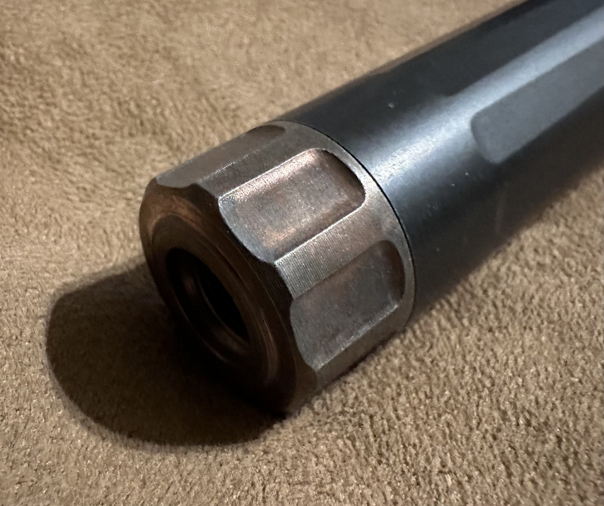

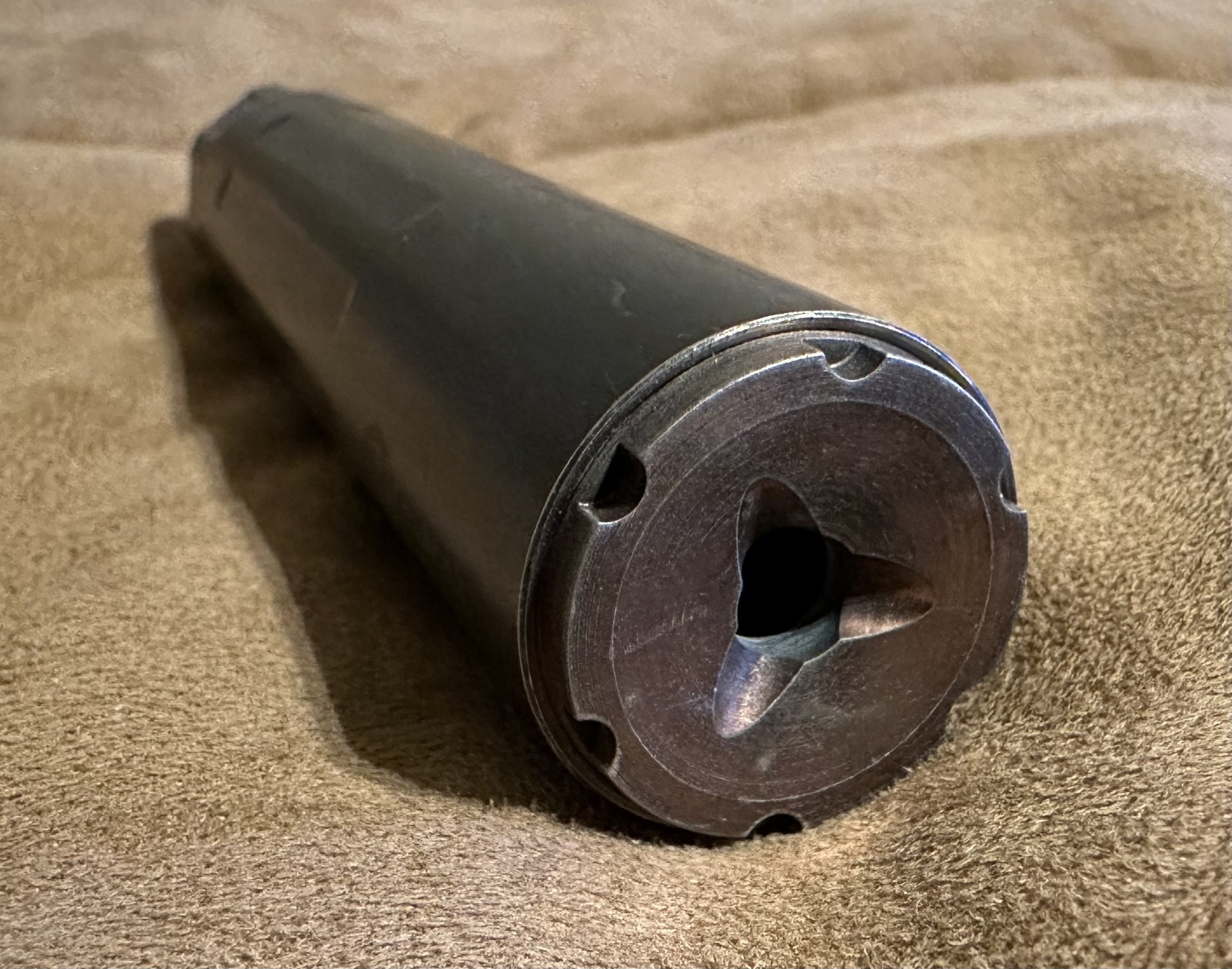

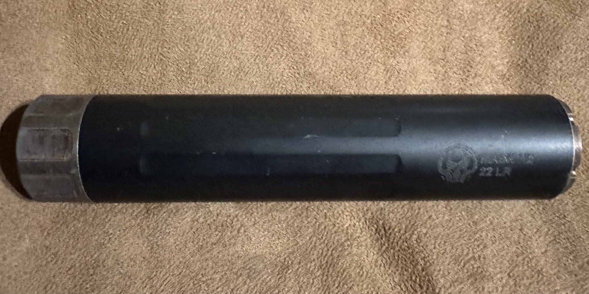

...The only issue I've had with a DA can was self-inflicted (sonic cleaner incident causing the Mask to need refinishing). 😂
This is a great time for everyone to learn not to go full FuhQ on their cerakoted or nitrided parts by throwing them in an aggressive ultrasonic cleaner and/or use crazy chemicals--which I'm guessing he did too. :p

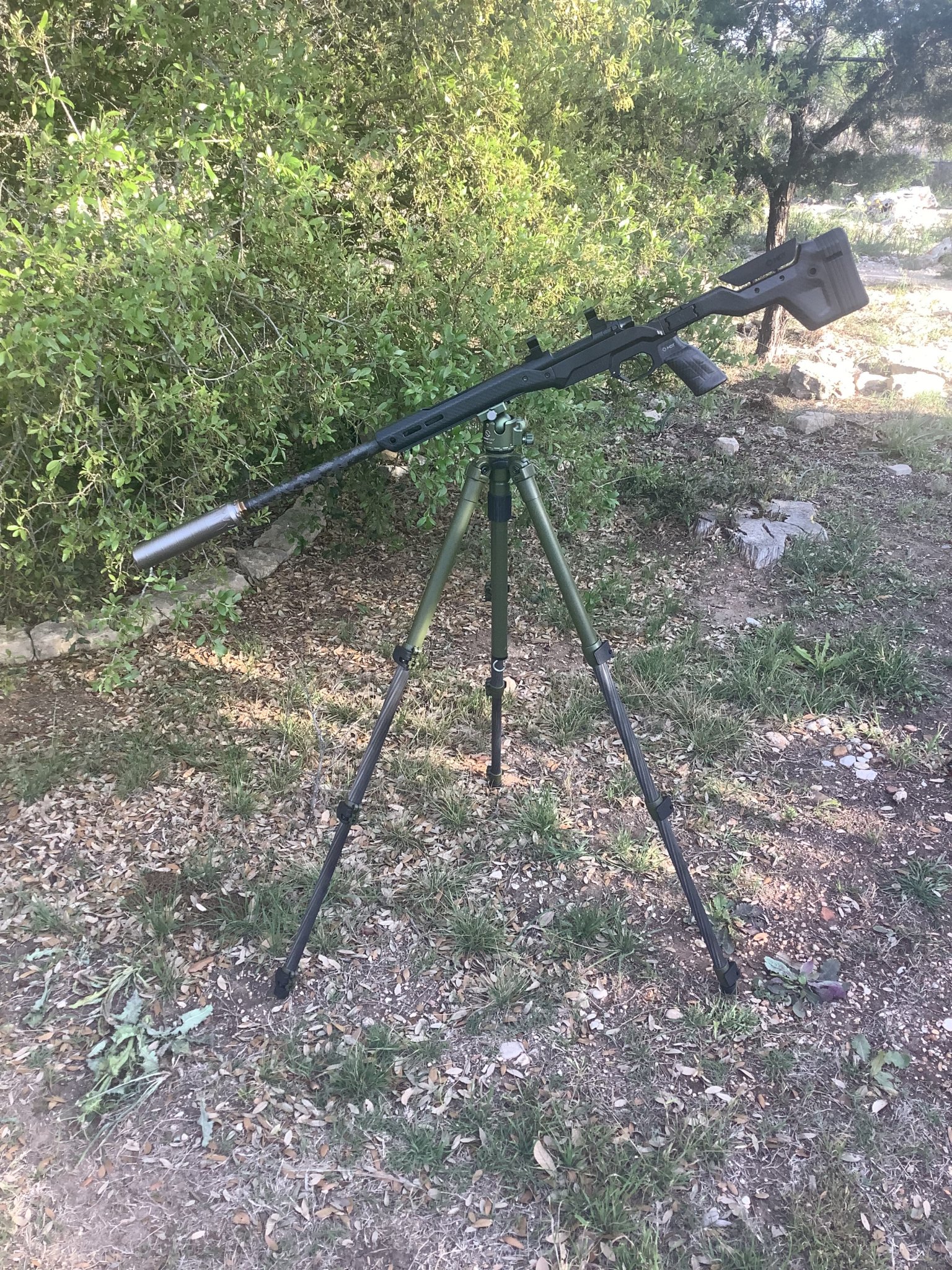

Well, I was smart enough to NOT put the titanium tube in there... Just the end cap and mount, along with the baffles. It's just easier to have them respray the whole can while they've got it's since it's been toted through the woods and shot A LOT. Plenty of scratches.
In my defense, it did look kinda cool with that aged patina of the raw stainless… 😂
Another big DA fan. Own a Sandman S and a Nomad Ti and have a Sierra in jail. Sandman sees the most use, and is switched between a number of AR15's, most with short barrels. Nomad Ti gets switched between two bolt guns and a 14.5" AR. Must have a couple of thousand rounds through the Sandman with zero issues. Probably overkill for how I shoot since I mostly run 10 round mags (thanks Colorado), don't really mag dump, and have recently been shooting in 0-10 degree weather, so I'm not exactly going to overheat the can. Still gives me some peace of mind that this the Sandman can handle anything I could conceivably throw at it, and actually balances pretty well on my SBR's. And the Nomad Ti is light as a feather and just has this great tone that makes it a pleasure to shoot.
Those actually look awesome. I'd have left it that way!

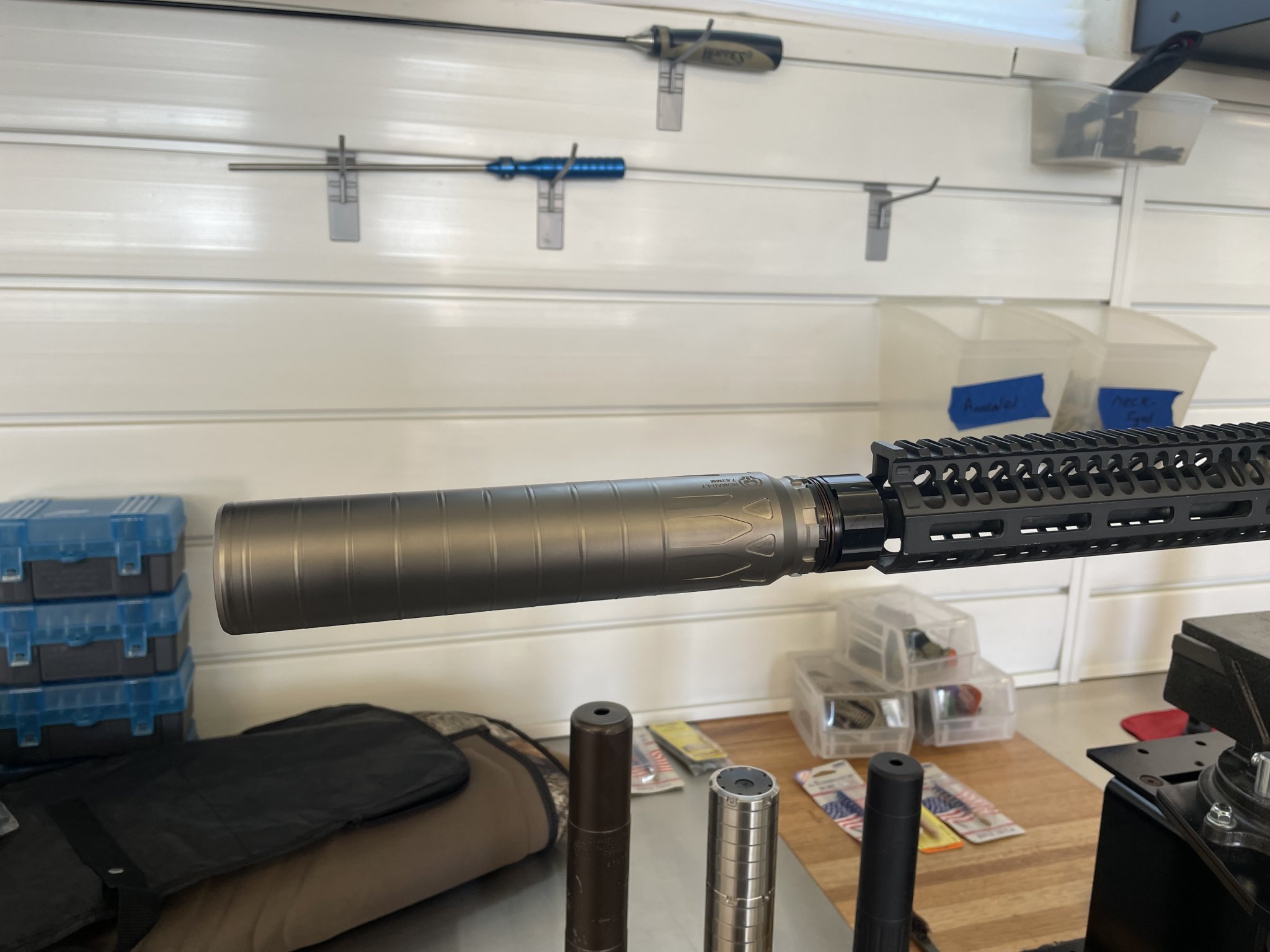

They call that "relic'd". Making things look used/worn and older than they really are. Guys in the guitar world pay big money for that! Maybe you're about to start a trend?
😂 Battle-worn suppressor finishes. Started a new trend. 👍🏼
Well, the pictures hide it well, but I've probably put 5,000 rounds through that can in the last 2 years, and it's been toted all through the woods and all over the place. So, it's earned every scratch it had on it. The odd part is, I cleaned my end cap and mount many many times in that time frame (well over a dozen), and never had any issues. I ran out of my cleaning material, so I substituted with another one that's supposed to be safe for Cerakote, and it stripped that shit right off like it had burnishing compound in it! I guess they changed up their recipe over the years, and my old bottle didn't have that compound in it. That new bottle cleans the shit out of some brass though, so I guess they did add a burnishing compound like we used to use at the machine guns range when I was working there running their processing plant. We would clean and process brass by the 5 gallon bucket at a time, and we had a huge vibratory parts washer with rubber lining adhered to the metal, and we used water, dawn, burnishing compound, and a cap full of LemiShine and that got those brass looking better than new! That burnishing compound was hellacious on carbon and anything else that contacted it.
Reactions: 30calDeath
