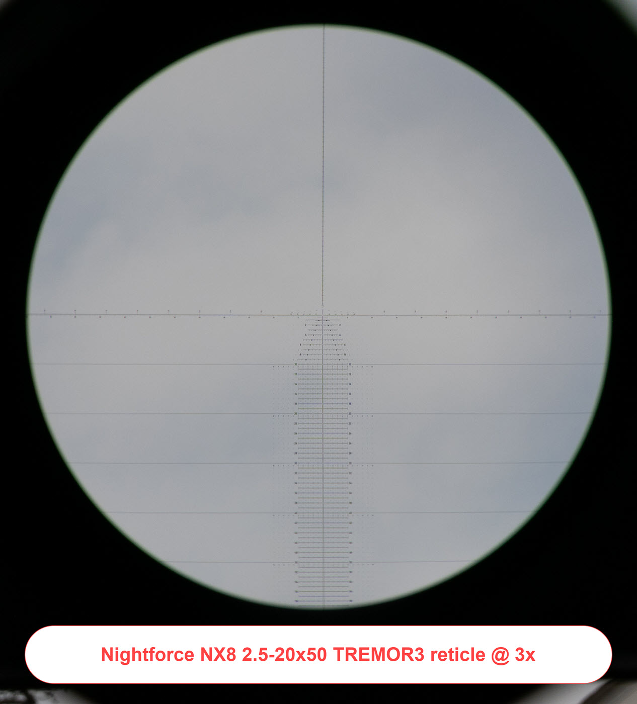

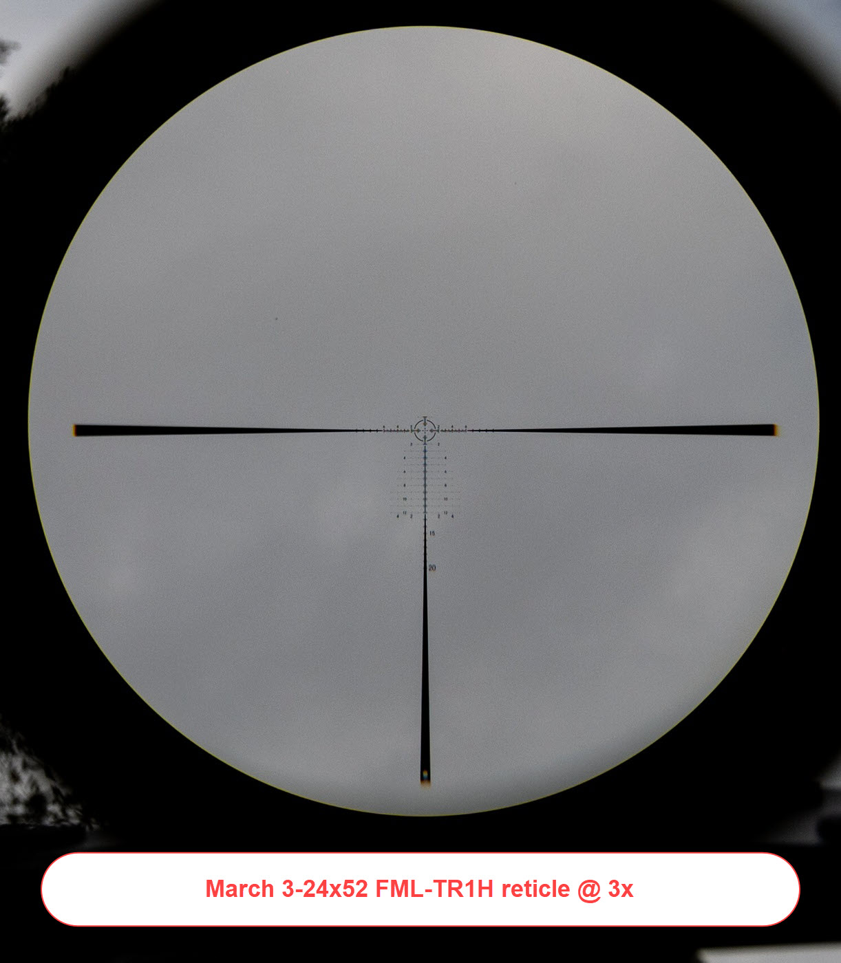

I do not think it is rocket science, I've always felt the Bushnell LRHS G2H reticle got it right for low mag/high mag use, granted this was in a 4x erector set but March also tried similar out in the 3-24x52 (8x erector) with the FML-TR1H reticle which I thought was very effective. Some are not a fan of the "circle of death" but for low mag use I find it quite effective and at higher mags it is not overly intrusive.
Hard to tell in the pics below, but that circle actually stands out pretty well even without illumination, compared to the NX8 at 3x with the TREMOR reticle that is pretty thick the difference is obvious
I agree that the LRHS previously and March currently has done a great job on reticles that are usable at both ends of the spectrum. Wish more manufacturers would replicate.

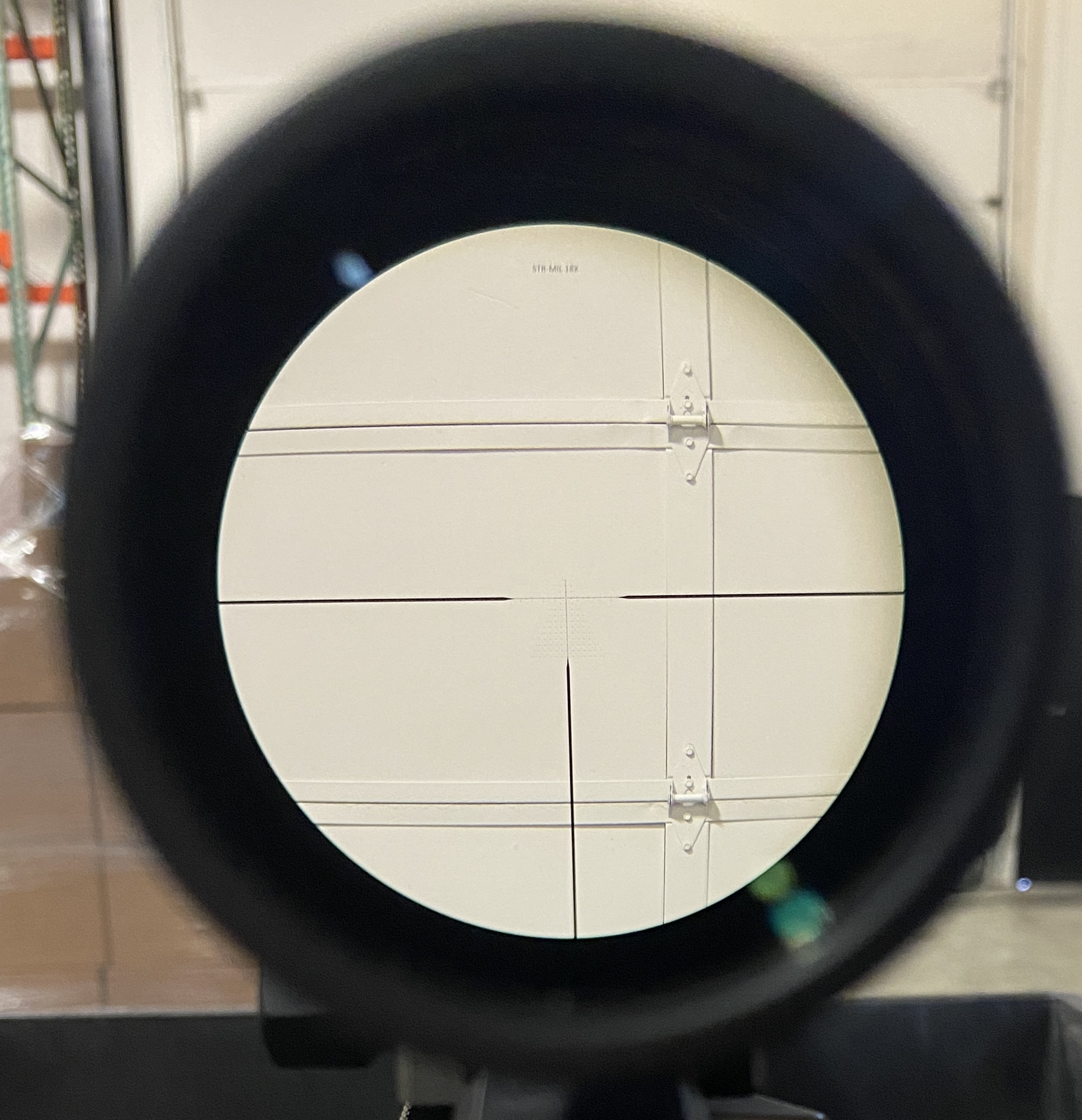

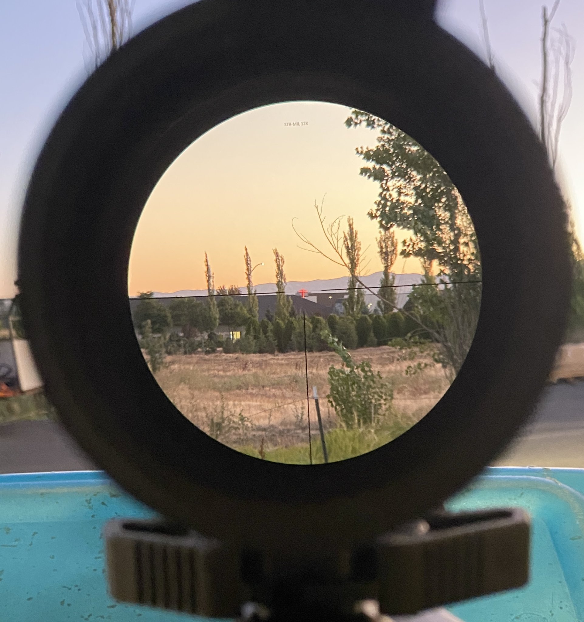

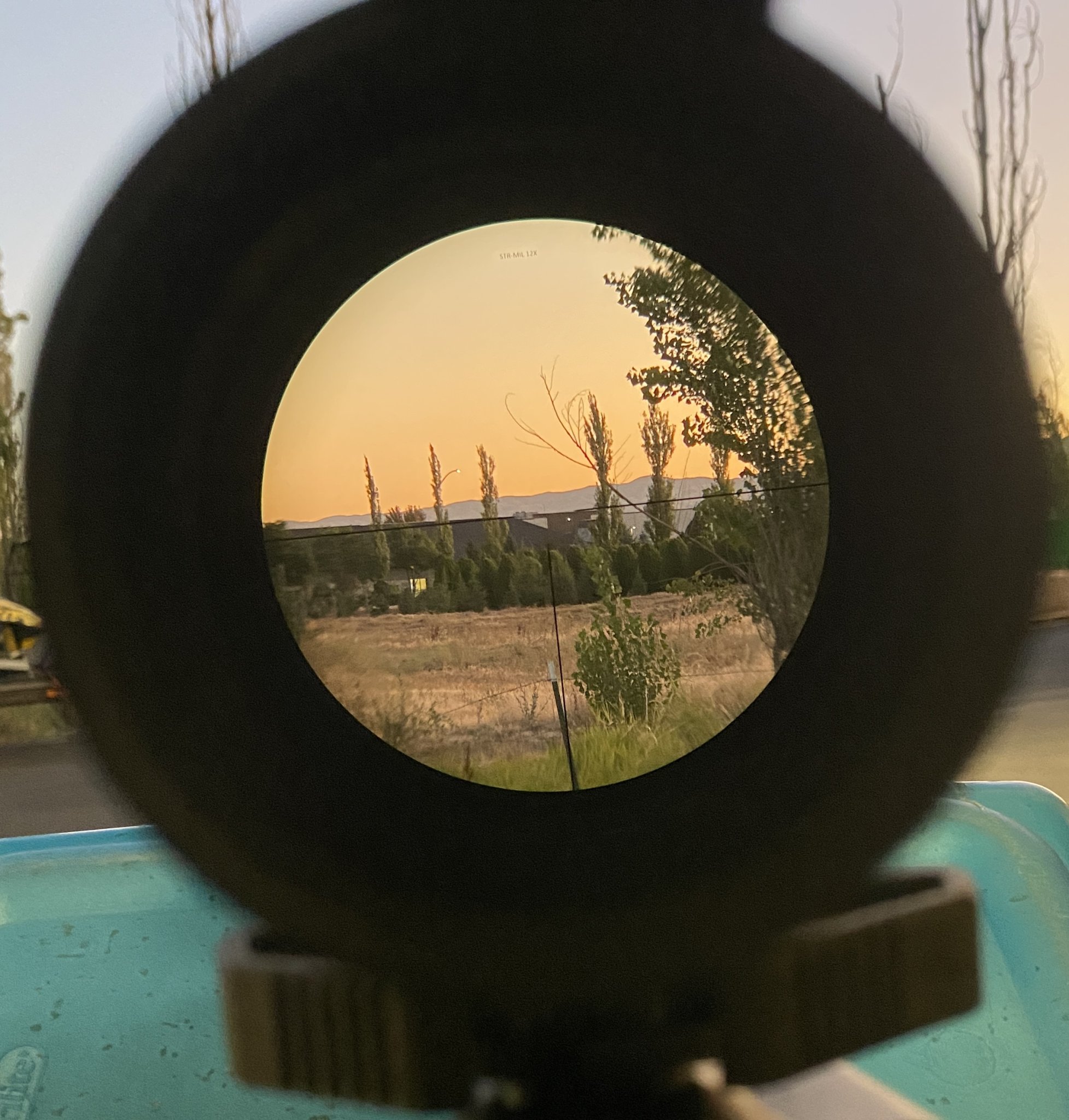

I just mounted up a 2-12 and a 3-18 for testing. Is there anything in particular you all would like to see or get feedback on as I start to evaluate them?
View attachment 8507267View attachment 8507266
Yes. Please show low mag shots with and without illumination in the open and also pointed into tree covered areas with less than perfect daylight. Thank you
Which reticle do you have in each? Steiner opted for green only illumination in 3-18 T series, is the H series also green or is it red? Does illumination look any brighter in H6Xi at 2x than T6Xi at 3x? Does H6Xi use standard CR2032 battery or did they go with the odd CR2450 battery? Through the scope image at 2x pointed at sky for H6 and at 3x for T6…
Reactions: Bravo6
I saw the reticle in another thread, looks just like scr2. Maybe thicker idk. Steiner doesn't have any subtensions available for it. Watched a video review and guy said the subtensions were pretty much useless 6x and below. But if you're making a shot to hold wind you should have time to bump the magnification up to 9-10x anyways. I just want to see what it looks like at 4-5x. It's form is nice, compact, but a guy may be better off just going with a tenmile 3-18 on a hunting rifle, as the weights basically the same and the long tube makes it very forgiving optically. I think the credo 2-10 & mark4hd 2.5-10 are more against this particular model in form/function.
