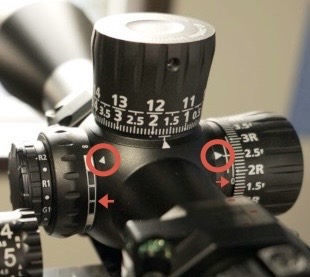

What does "offset windage" mean?
Instead of the indicator notch being 90°, they are located higher on the tube for easier line of sight.
Here is an LRP S3. Note the ⭕️ show the offset notches higher on the tube. The red arrows show the typical (normal) placement on most scopes.

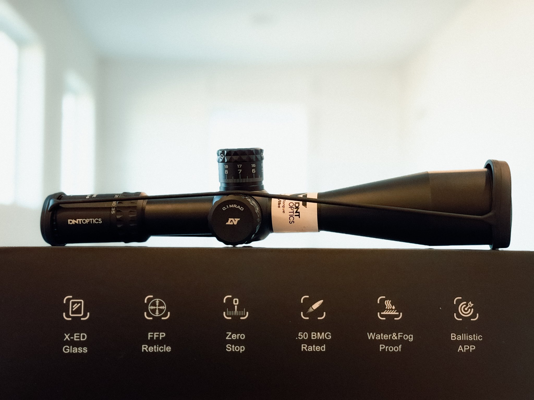

So all bullshit (snobbery) aside would you say the glass on this is usable? And at what magnification does it go to shit, or does it?
Not @Lowlight
The glass on the DNT is more than usable !! The DNT gives a lot of high end scopes a run for their money!! When you factor in the price...well its embarrassing.
From my use....up to 28x is very very good ...upper powers ( 30 -35) are OK but darken a little..
I just got mine mounted and zeroed in a couple days ago. I wear glasses but thought mine looked good until about 30 power. Still usable on 35 it just darkens some. Did a tall target and box test also and it tracked great. So far im super happy with my DNT One. Hopefully can get out in the next couple days and get it sighted in out thru 1000 yds.
@Im2bent
Same assessment with mine. From 7x to 25-28x the glass is nice, above that it starts to darken and degrade IQ somewhat, but still extremely useable up to 35x.

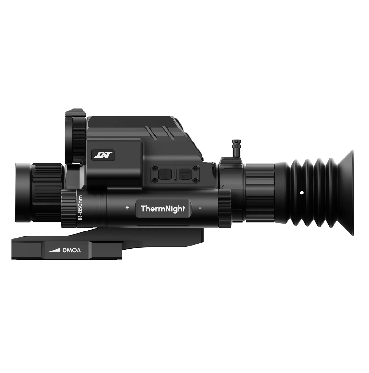

Oh, I went out too on Saturday, zeroed up the Thermal TNC635R, what a fun optic
It switches with a button to day and thermal, you can scan with thermal, find a heat source, button the digital, ID it, and whack it.
I have footage I have to get off the unit
Those are real nice! Probably my next optic purchase in the new year.
