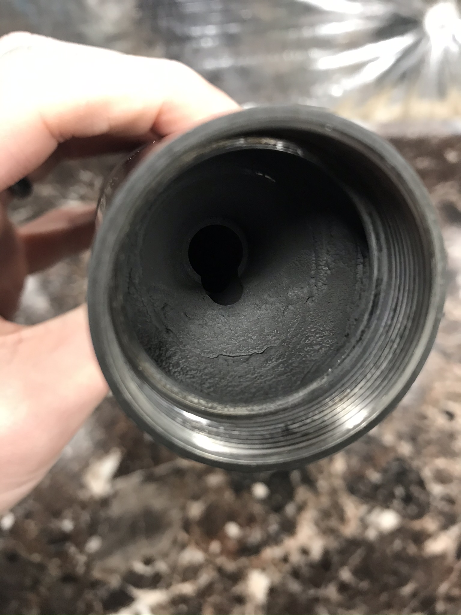

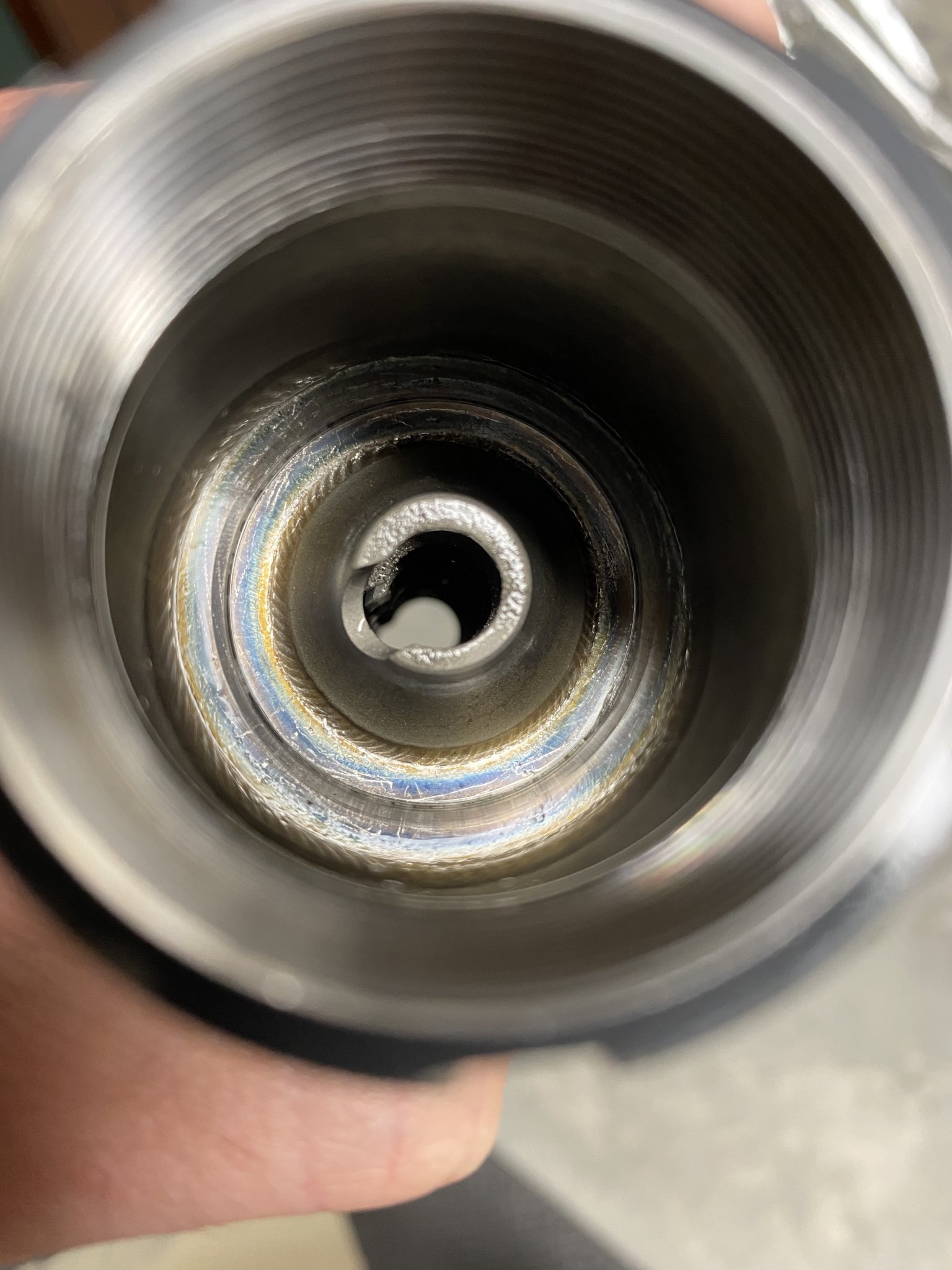

Hard to tell from that picture, but if the jar is sitting on top of the transducers, you're not going to get much ultrasonic cleaning action. Additionally, the jar itself may dampen some of the action, even if not on a transducer. Pull that out of your ultrasonic cleaner, put a piece of foil in just the water in the cleaner, and run it. It should eat through the foil (no need to let it finish, just look for little holes to form with it dipped in there). Repeat the experiment with a jar and water and foil. That's a good way to make sure you're not just spinning wheels. Normally there are little baskets with standoffs to prevent items from directly sitting on transducers, or overhead fixtures on larger units that allow suspending the item in the tank with wire.
Also, definitely used distilled, ultrasonic cleaners work through cavitation and the minerals in tap water make it less effective, in addition to all of the molecular/atomic interactions that mineral/contaminate binding prevents. Pre-warm the distilled water, and run a 10 minute cycle before cleaning something, that'll prepare you for the most efficient cleaning you can accomplish with a small/low power ultrasonic cleaner like that one appears to be. Every little bit helps!
Good info here guys! For those considering using the ultrasonic cleaners, which do work well, it helps to know how to use them in the best way possible.
Solid! Thanks! I’ll put the tray in for the next cycle. Just two cycles and the water is already pitch black. Cannot even see the can any longer.

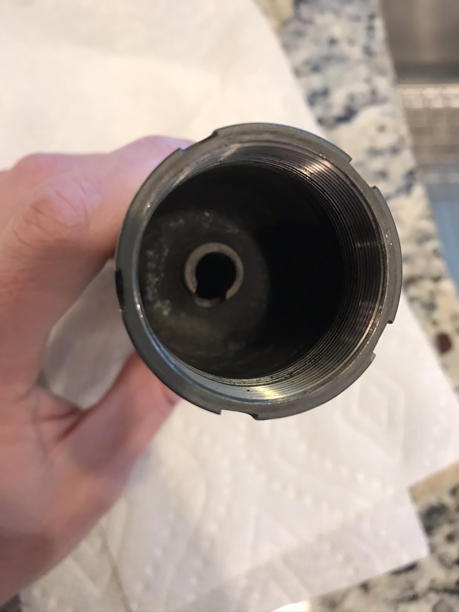

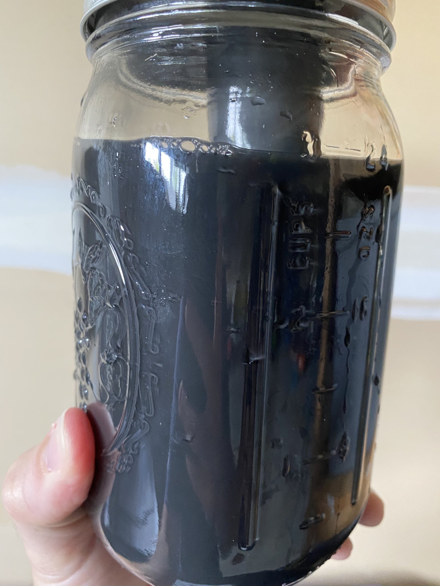

Had to pull it out of the jar and rinse/dry it to shoot it tomorrow. I was happy to see I shaved an entire oz off the weight. This is the most I have gotten out using Boretech in just 48 hours, so the ultra sonic definitely did most of the work. The blast chamber is getting better, but still has some large chunks left. I’ll throw it back in for a week after tomorrow.
The Jar
The Jar
From my experience with Boretech C4, the carbon will settle out in the jar after a day or two and is completely reusable. The way you're using it, not sure how helpful that is in trying to get the carbon out of the jar, but maybe it could be filtered through some coffee filters or something. Or maybe it doesn't matter if there's suspended carbon in it and just keep using it. Not sure on that, would love to hear some opinions.

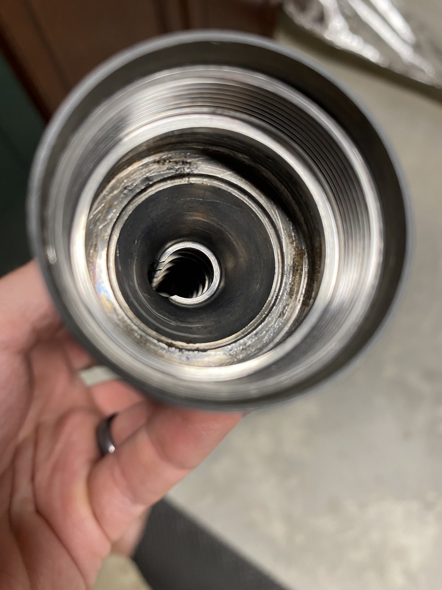

On a side note I tried both C4 and Simple Green Heavy Duty. The C4 worked like a charm but the Simple Green is awesome too and is way cheaper. I've been impressed with it.
Reactions: lash
That’s what I keep saying here. I’m not saying it to sell Simple Green, I’m saying it because it works. Plus, as mentioned, ditch the jar and just use the solution directly in the US with the can submerged on the plastic tray that cones with it. A half dozen cycles or more over a period of a couple/few days will take out a bunch of carbon. Most all of it in my experience.
Reactions: Lunchbox27
You can’t put all chemicals in your US cleaner. I used a mason jar because I heard mineral spirits was a no go. And I used mineral spirits because that is what was recommended by SiCo.
I can completely understand not putting mineral spirits directly in there. It’s a flammable solvent and ultrasonic cleaners are electric plus they heat things up. Further, it is not recommended to use Simple Green on aluminum parts, so that is a consideration too.
Aware of flash points being a thing, I also wouldn‘t run the mason jar too long. I would let it cool down before running the cleaner. You are absolutely right, it does heat up.
After seeing my own results I don't think using an ultrasonic cleaner will help most people. If you have a really dirty can of course definitely use it. I am pretty much speculating that the ultrasonic cleaner pretty much speeds up the process a lot.
For me going forward once a year or whatever I will buy a gallon of heavy duty simple green for $13 bucks and put my suppressors in a little plastic container and just fill it up. If its bad after a day or two dump it out and refill it with clean simple green.

Alright... I have finally gotten this thing cleaned. Took off 3.2oz and I’m calling it good. I’ll keep up on this once a year to hopefully reduce the amount of time it took.
So, what worked for me was soaking the can for days in Boretech C4, followed by ( at the recommendation of @ormandj ) running the can in then ultra sonic without the jar. I picked up a couple gallons of distilled water and ran the can in the ultra sonic with just distilled water. After a single cycle carbon was bleeding out.
Now, this probably took a good 50+ cycles of the US over the course of a few days, but it worked with no elbow grease. The soak in C4 and the US did all the work.
Before of the blast baffle and end baffle
After with blast baffle and end baffle

Suppressor: Sico Omega 30
Approx. # of rounds fired: 3000
Weight before start of cleaning: 16.4oz with Direct thread mount and flat front cap (Neither could be unscrewed. End cap loosened after 2 days)
My technique so far has been 1 1/2 weeks in the ultrasonic cleaner in a simple green bath. I have been able to remove 1.2oz of carbon so far. I'm working from home and run the Ultrasonic around 15 cycles per day. This is frustratingly slow. Suggestions? Boretech C4?
And I have been unable to get the direct thread coupler unscrewed on the blast chamber end. Can someone recommend a technique to help?
BTW the sleeve came loose a couple days ago. I guess I just use Rocksett on the threads when I screw it back on.
Thanks
