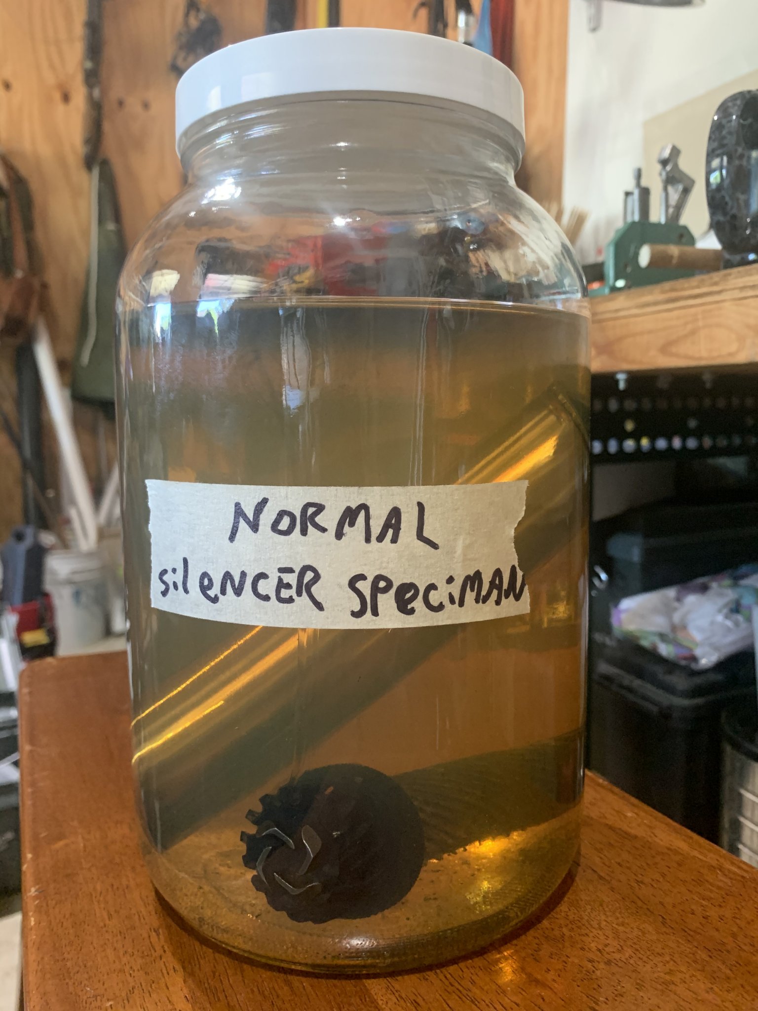

BTW, I do use the DIP solution on my Sparrow and if you pour it out in a large pan in the sun it will evaporate.

Stays in the pan. It's not like a clean a suppressor every week. I maybe clean the Sparrow 8-12 times a year. Thinking about, I need to clean it now.What do you do with the solid residue afterwards?
Thanks, I mean it works and works well with minimal mechanical cleaning. If a person doesn't feel comfortable then don't use this method. I have reduced the amount I use compared to when I first started.Good information.

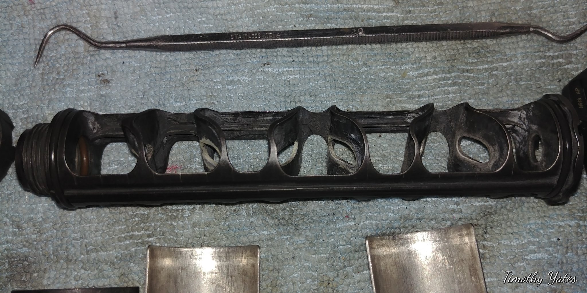

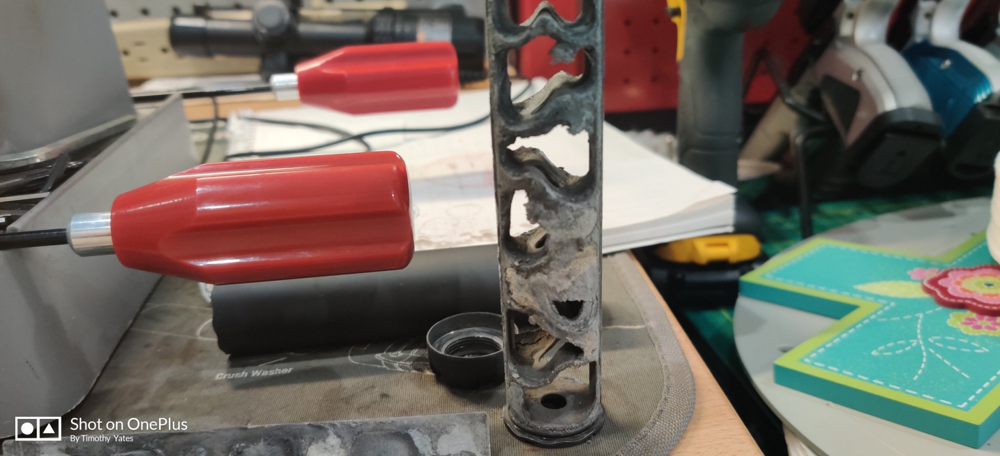

Sitting overnight it will take my Sparrow from this...
to this. Keep in mind that I did knock off all the heavy deposits from the photo above.

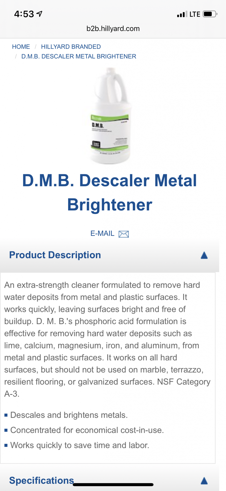

On another note lash says above that CLR is phosphoric acid. What does phosphoric acid + lead produce? Being a non-chemist, google suggests: Lead + Phosphoric Acid = Dihydrogen + Lead(II) Phosphate
Lead phosphate seems to be not good for you, especially through the air if heated.

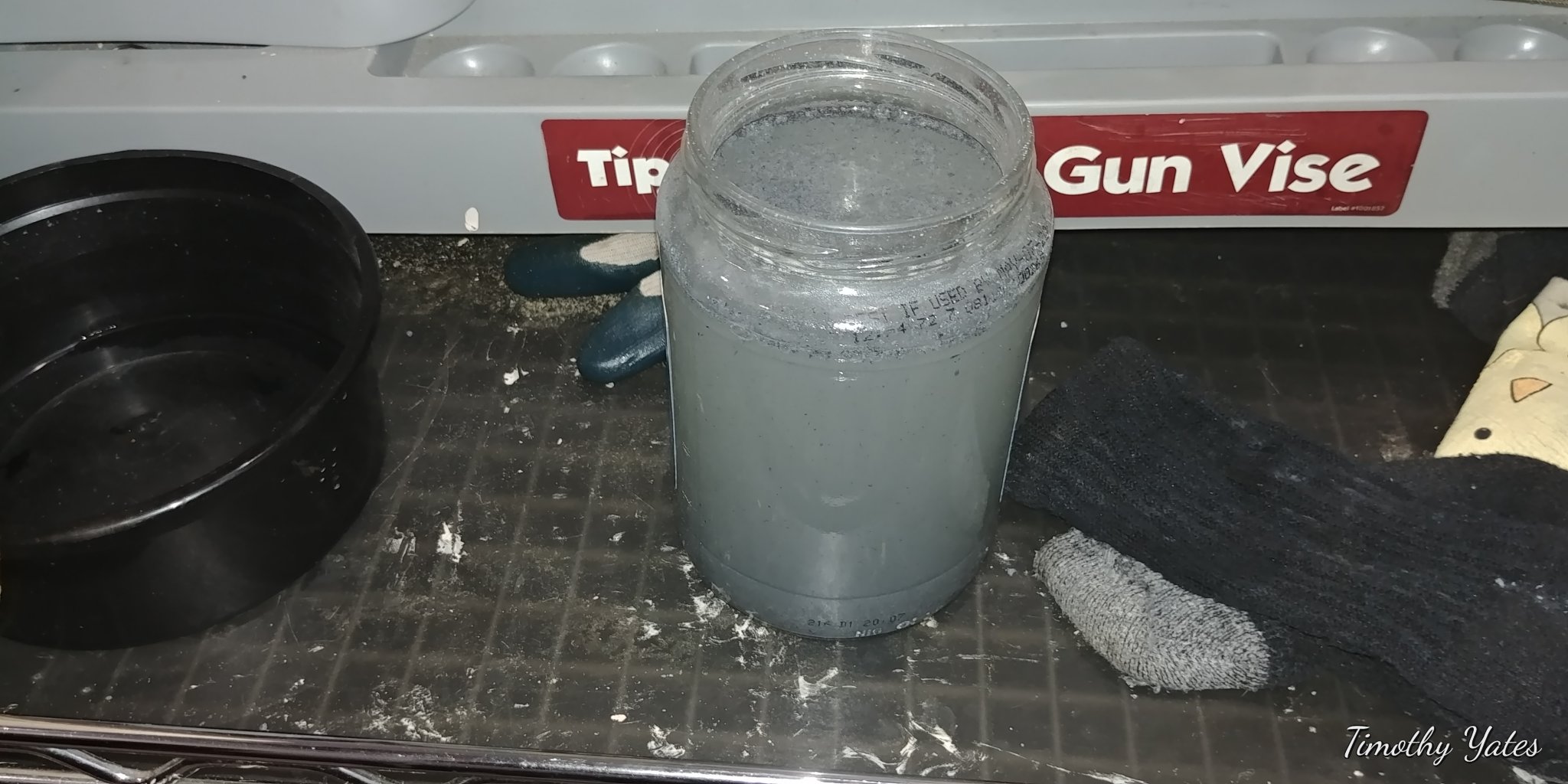

Recently I tried soaking it in CLR for about a week and it did remove roughly an ounce of carbon from the can but there's still a 6-7oz in there. I was looking into a pump setup maybe to force a continual flow of CLR through the can and just let it sit for a month in a couple gallons of the stuff.
As I posted earlier, I’ve had good success with one initial overnite soaking in CLR, followed by a few sessions of alternating ultrasonic cleaning and soaking in simple green. Using Simple green full strength in the US cleaner. The ultrasonic cleaner helps by breaking up the softened chunks and particles of carbon. About a week of this and there’s nothing left.I got on a trust with some family members and we purchased 2x SRT 9" .30 cal cans at the same time. I have used mine for over 10,000 rounds and I'd be surprised if the other one has more than 500 through it. They weigh 7.8 oz different (mine heavier). I used to take it apart (not supposed to be able to but I made a tool) every 500 rounds to clean it but around 5-6k rounds ago I let it go long enough I couldn't disassemble it (carbon locked) and decided just to leave it alone.

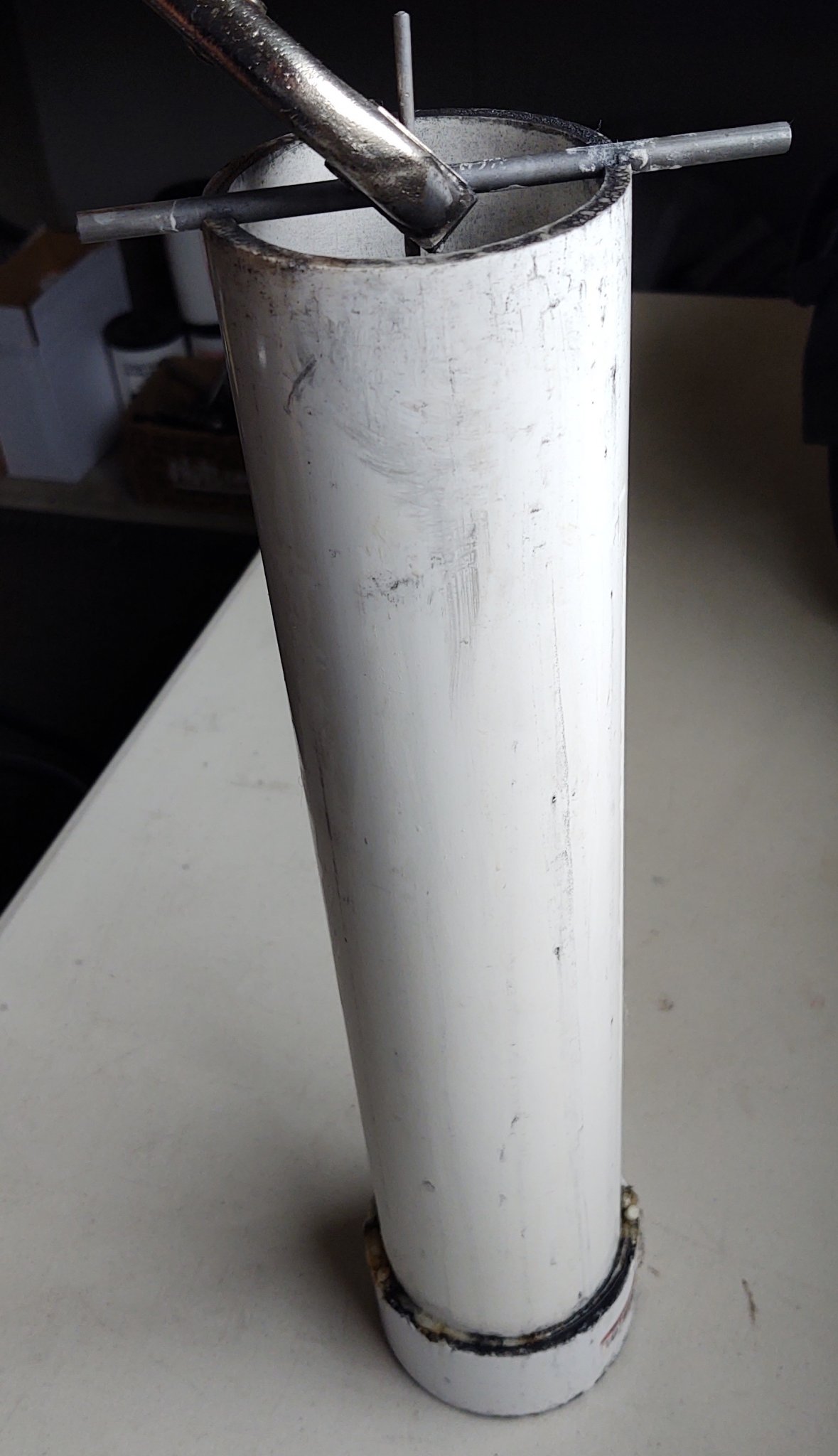

If you want to do a pump system, then I imagine a PC watercooling or fish tank pump with a very large reservoir of CLR. A Tupperware container with the lid, cut some holes in the lid, one for a tight fit to hold the can on its end as the return then another for tubing to feed the pump. A stainless fitting for the can could be an issue. Then just let it run until forever.
You could get fancy and do a whole second container that it would draw cleaner solution from while the can deposits into the first with the sediment and debris.
Not sure I would try and make a sealed system. If this creates any gasses and pops a line you could wind up with a giant mess.
