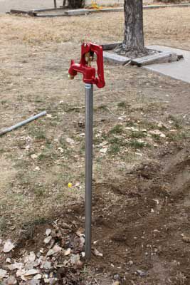

Faucets up north are all hydrant type. Where the water is turned on and off 10” inside the wall. Guessing the ones down south are simple gate valves or 1/4 turns

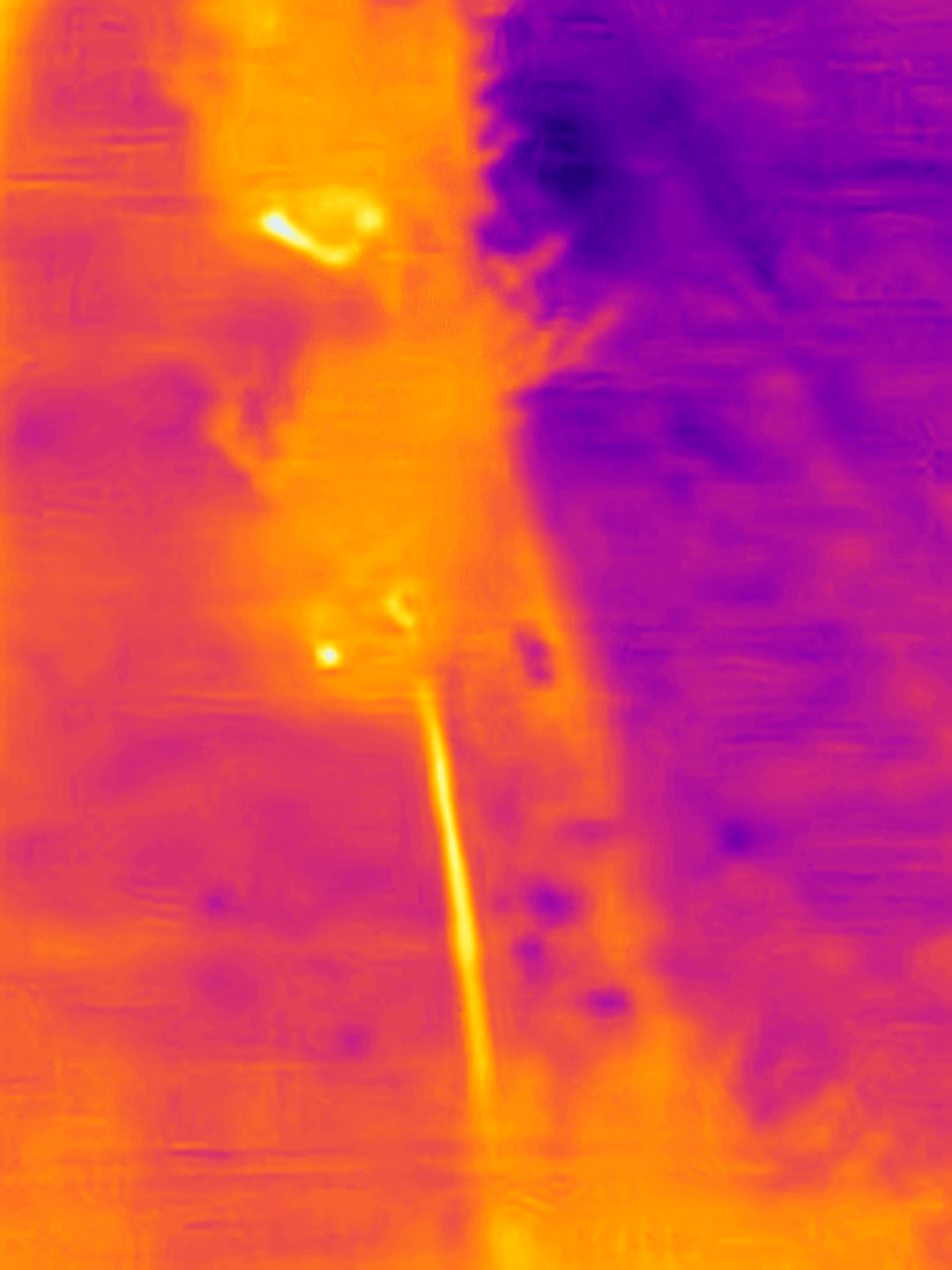

I‘m a cover and heat tape guy.
here’s a thermal image at the bottom of the page of tape I put out along an outside line. You can see the heat tape working, bright yellow line.
Here is the specific:

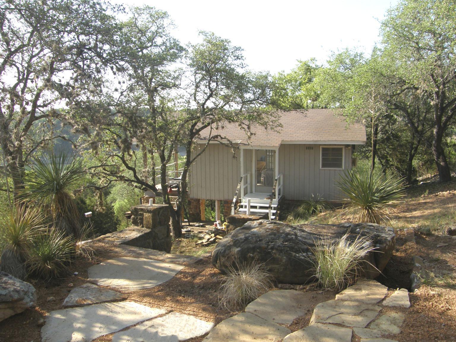

It's too late to heat tape or anything other than turn the WELL OFF and drain it and the line leading to the cabin. This was a vacation lake cabin that I turned into a fulltime bugout cabin. The well was turned off and everything drained when not in use.
Once I survive this I'm heat taping the pipes and building an insulated well house.
Again, I'm going to turn the well OFF, not just shut the water off coming out of it, and hopefully the pressure tank drains enough there is no water left in it to freeze. Then tent it and put a heat lamp under it. That Siberian front is supposed to hit at 10:00 to noon tomorrow like a freight train and I need to have everything done by then.
