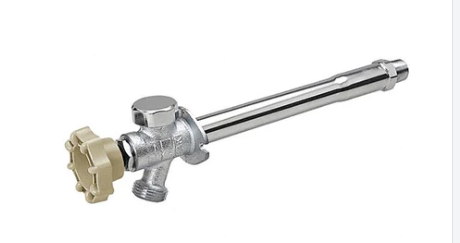

Never gave it much thought, are frost free spigots only used above a certain parts of the country? I can see people in Texas for example never thinking they'd need them and not using them.
As for insulating outside exposed pipes... it's not like your coat, it's like a cooler. If it doesn't have any warmth to keep in, it's not going to help. Learned that the hard way with the pipe from the cistern to the cabin decades ago. Insulation alone, frozen and split. Heat tape alone, frozen. Insulation over heat tape, happy down to -20 or more. (at which point the pump inside freezes up since there's no insulation on the floor or in the walls lol)

I can't explain why, but I had a frost free faucet freeze and split
I got lucky it started to show as a slow drip
I would not rely on them 100%
Those need to be installed with grade towards the outside. The other cause for failure is that hoses get left connected, which don't allow the water to drain out.
The grade was correct
I can only think the previous owner of my house left a hose connected. House is 16 years old, the faucet was original
I bought the house in June, caught the leak in September, no chance of a freeze in that time period in central VA
but that makes perfect sense. The previous owner of my house was a moron and did a lot of stupid things
Reactions: SilentStalkr
