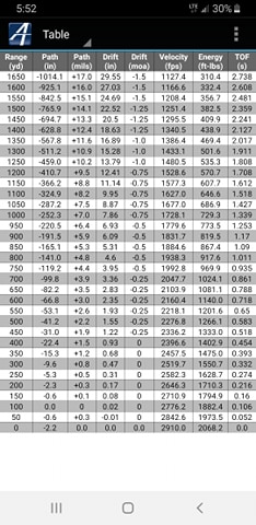

You would be well served to go to JBM and run some bullet combinations. Most 6.5's, and 6mm's we shoot extend well past 1K.
This is my Dasher at 5500 DA, which we get most sunny winter days where I live. 110 Sierra at 2920fps. I need a little nicer day to get hits at 1600, but 1450 is doable on almost any day. not saying efficient, doable.
If my math is correct, my platform stays superdoopersonic 65% past 1K
