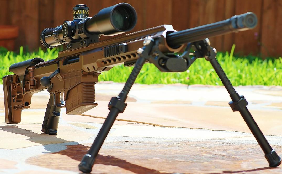

Like others that claim they have no issues and swear by the Spuhr mount, there are those like me who have had slipping. And since the manual clearly asks to use Rosin on the tube and rings, and loctite on the screws, Spuhr must have realized slipping without these materials prior to initial distribution thus clearing them of any claim of manufacturers defect when not using these materials to mount a scope. My scope as I said previously is a S&B PMII 5-25 and since Spuhr uses this model as their premier example of presenting their mount I don't believe measuring is necessary.

Pliestarcus, I'd just send it back man. At this point, what do you really have to lose? You're not going to use the mount, so might as well take a shot at getting your money back. The worst they can do is tell you no, point you to the instruction manual, make fun of you for not using it, then login to snipershide, find this thread, and chide you publicly for not using loctite and rosin!! (ha-ha) Or maybe they'll at least exchange it for a new one, and you can sell it here and recoup most of the money. Can't remember if you said this or not, but was this the first time the scope was used too? I can't imagine there would be something out of spec with a S&B, but I guess anything is possible. I know you prefer not to send things back, but you've got the best of the best in equipment you're working with there, yet you're dealing with the same things that guys like me with leupold rings on a vortex scope are subjected to on occasion. (it should be noted that I've had no issues with my leupold rings on vortex scope, and no rosin or loctite!)
Btw, that's a bad-ass rifle in your picture!

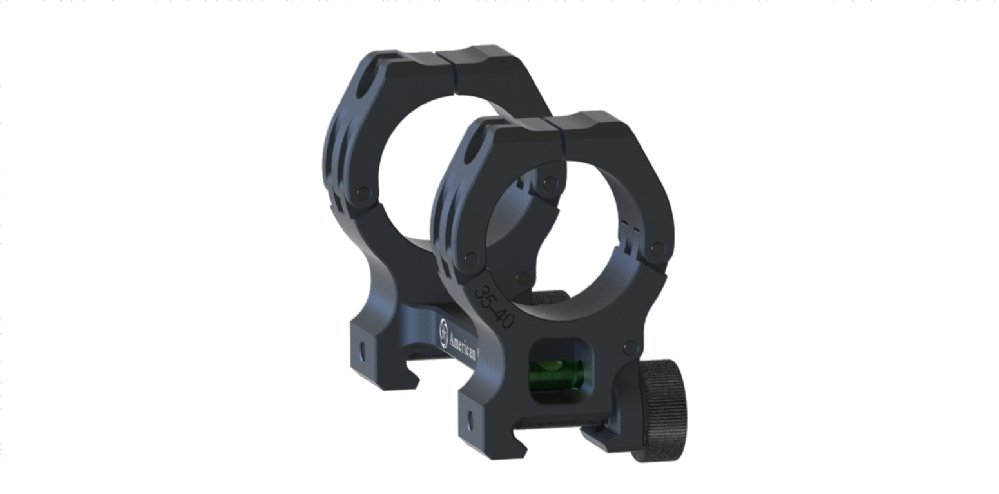

Thank you Brother! BTW I went to American Rifle Companies site last night and noticed they redesigned the M10 QD mount which now has a LEVEL.....unless they always had one and just never saw it!!!!!! Now that looks like my new mount
They look pretty nice. I'll have to check them out. Looks like ARC recommends a 50 in lbs torque on scope screws per the website, and finger tight on the rail clamp screws. That seems backwards, but I'm no engineer.
I am no engineer either but this is what was quoted by Ted from ARC when I asked him roughly the same question.
"Bigger screws require more torque to impart the same tensile load that two or more smaller screws would otherwise apply when torqued to a lower value. 50 in-lbs applied to a single 5mm screws will exert about the same force as two 4mm screws torqued to about 20 in-lbs."
