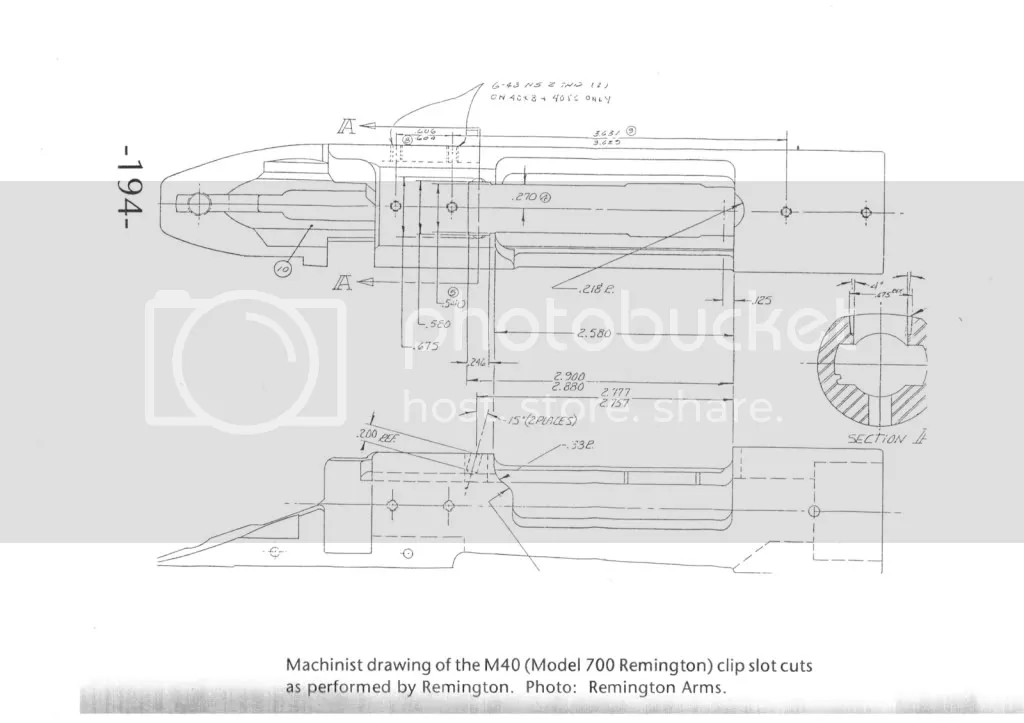

Once upon a time Remington sold their 700s with two holes drilled and tapped into the side of the action to allow customers to mount peep sights.
I'm hoping to find a print showing the locations and dimensions of these holes so that I can have them installed on other Rem 700 footprint actions.
I know it's a total shot in the dark here but nothing ventured nothing gained and all that.
I'm not a machinist or engineer so I wasn't quite sure.
I mean, one would assume there is a bit of the knowledge if asking for the dimension. From what I can tell in the image, 3.629-3.631" center line from the rear scope screw, and .604-.606" center line spacing between the two, 90 degree over. Looks to match up with rear sight pad threaded holes.
Well for a $1500 action I'd like it to be right but I suppose I'll just have to roll the dice and hope for the best.
Who’s doing the actual work, you or a gunsmith? If you were planning on doing it and cannot read a print, you’re in way over your head. Take the print and the actions to a competent gunsmith or even any competent machinist.
If you do it yourself, you truly better hope for the best.
With any luck it'll be done by the action maker before it leaves the building.
And how does that help me? I see no dimensions saying it's x amount of thousandths from this position or that positiin.
I looked at the drawing for about twelve seconds.
The side holes are along the centerline.
Front to back they are even with the rear scope mount holes on the top.
Seems pretty simple.
ETA: fixed the auto-incorrect
Front to back they are even with the rear scope mount hooked on the top.
Asks for blueprints with dimensions, gets them and doesn’t know how to read blueprints lol.
So you were asking for something that you have no concept of?

Most of my responses were not me being an asshole. They were simply me trying to understand exactly what I was seeing. I'm used to seeing exact dimensions for stuff and not having to resort to fucking guesswork.
Then you came in with your bullshit about how I was asking for something that I had no concept of. So fuck you.

I got the thread pitch size from that post but not the location of the holes.
There's a lot of room on the side of a receiver for two small holes and I want to make sure they're in the right spot.

You mean you can’t read a fucking print. Face it, that’s your problem.
Holy shit!
The dim drawing provided to you has call outs that are noted to 3 places to the right of the decimal!
What the hell world do you live in where you are used to seeing dimensions more exact than that?

So give the bases to the machinist and have him do the measurements. Whoever's doing the work will probably ask for the bases anyway to check fitment and to cut your screws to length.
I know that's a possibility but I thought if I could find the print I might could have it done in house as they're making the action. I'll do whatever I got to do though.
