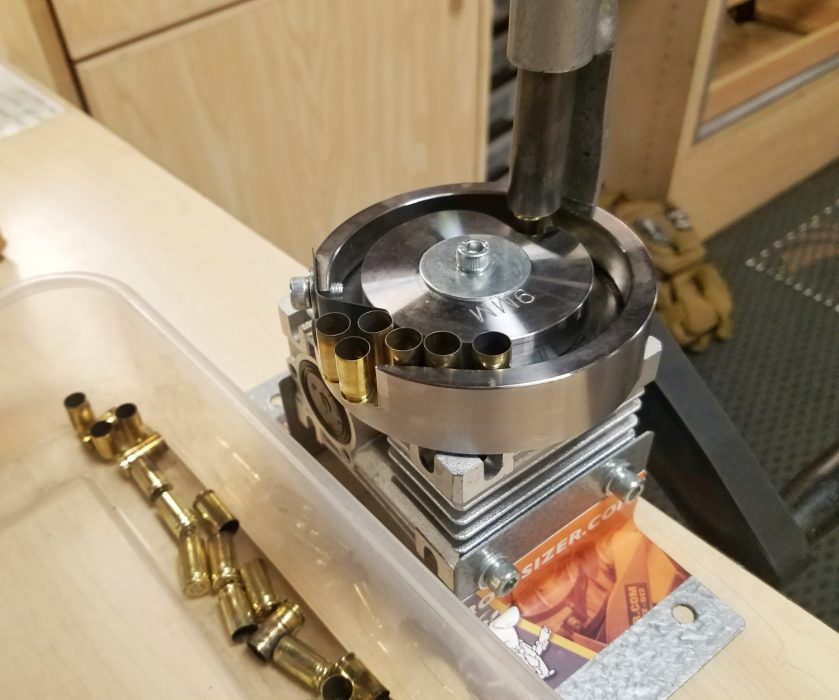

Does anyone use a role sizer? I've posted a picture of the unit.

I've seen roll sizers here and there but I have since seen one called, cleverly enough, "Rollsizer". It's relatively affordable but I'm wondering what the role of the roll sizer is because it seems that folks are still full-length resizing after they've roll-sized their cases. Is it just a super speedy way to remove the bulges and bring the bases of the brass back to factory dimensions? Does anyone here use one? There is a manual unit and a motorized unit. The motorized unit can outrun any case feeder.

I have the commercial rollsizer, I use it for bulged 9mm before I load them on a 1050. I was having trouble with bulged cases in tight chambers like Bar-Sto. It’s a godsend to save crappy “once-fired” brass bought in bulk or picked up from a range.
