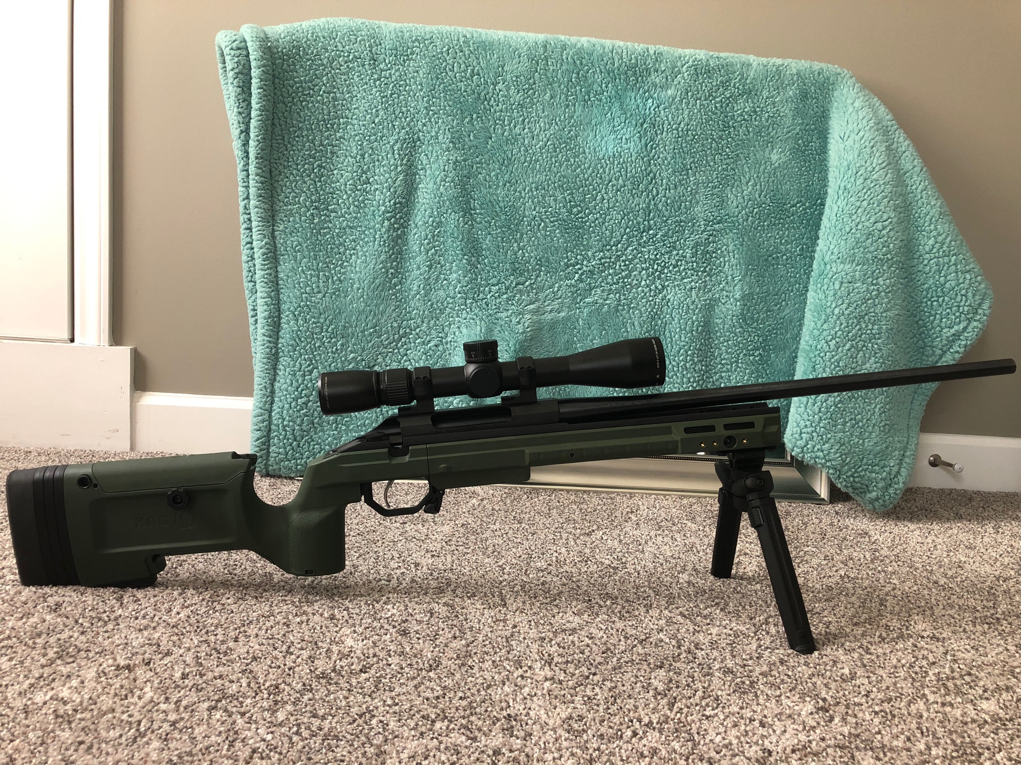

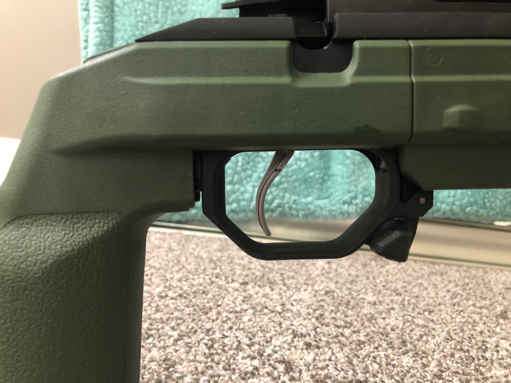

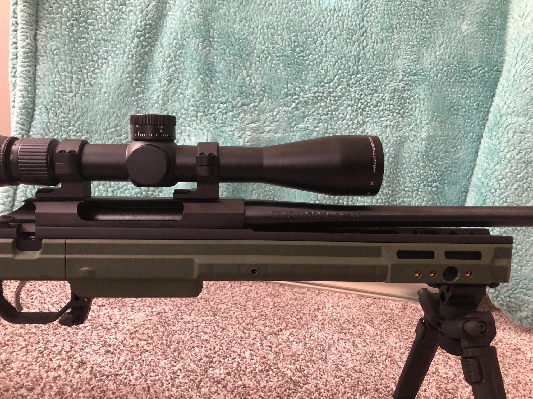

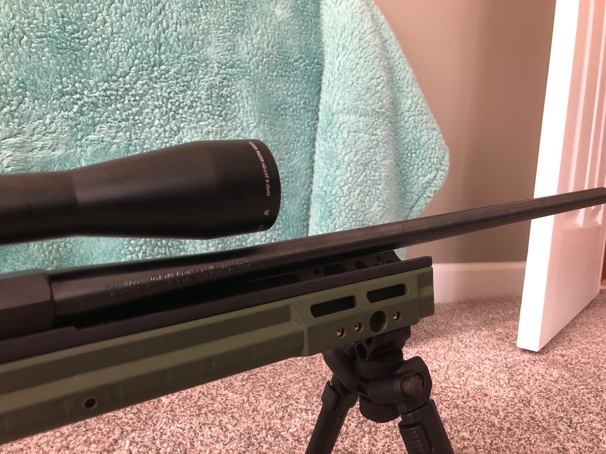

full disclosure: I'm a complete idiot, with very little natural mechanical inclinations.
I purchased a pre-owned KRG Bravo Chassis for my Tikka T3x Lite, and I am brand new to bolt guns.
Went to install today, and I can't tell if I did it correctly, despite following along with the instructions, provided.
I knew that the lite profile barrel might look a little odd sitting in the Bravo chassis, but this seems.... incorrect?
Also note the gap between the trigger guard and the chassis.
If anyone can tell me what I'm doing wrong, or if this is normal, I would greatly appreciate it!

Your action isn’t properly seated on the fixed recoil lug in the stock. I don’t know the trick to fix it, other than moving it around until it fits right.
The trigger guard is adjustable front and back to adjust the magazine fit. The screw for it is at the front of the trigger guard and screws in from the top of the chassis, under where the action fits.
Oh wow, right. Sorry, I bought the chassis secondhand, and didn't think about the fact that KRG might have a PDF on their website to download.
