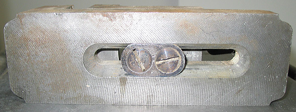

Pictures of the vise.
It's stamped:
Armstrong Bros Tool Co
Chicago USA
No. 2 V
It appears that you set the gross adjustment by loosening the two bottom screws and sliding the top portion into position. Then fine adjustment uses the threaded handle. There does not seem to be a way to readily attach it to the drill press table, which is large and solid with no slots, anyway.
