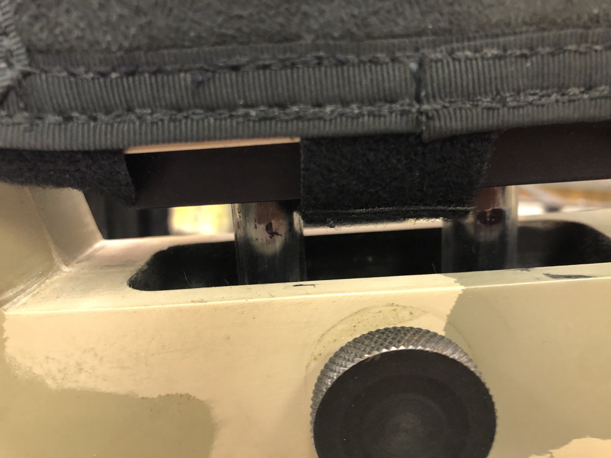

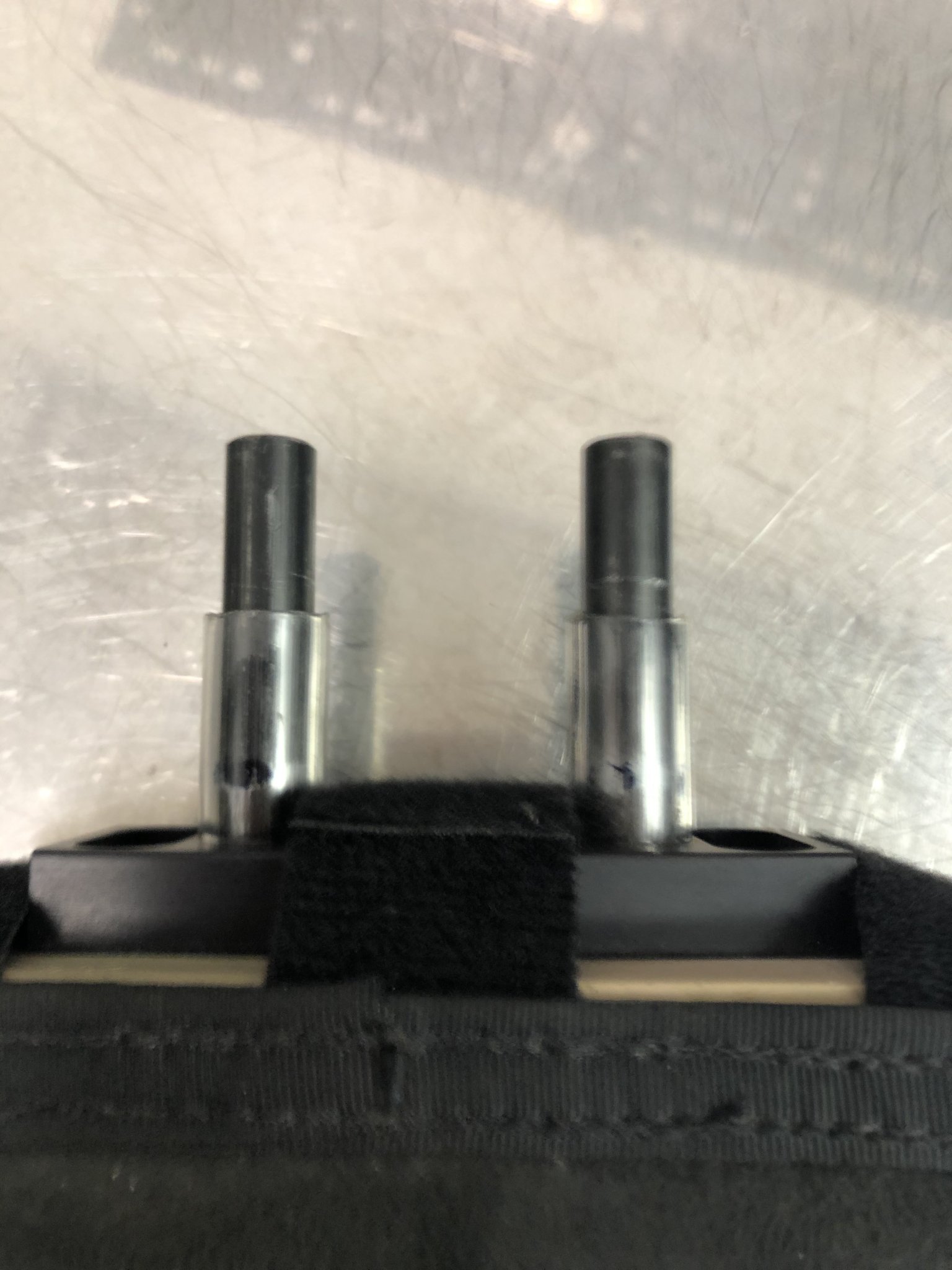

I’m using a McMillan A5 w/ adjustable comb & LOP. My way of setting the comb (cheek rest) in the same place every single time is simple. I’ve cut off a small section of plastic hose from a refrigerator water line (trim to fit individual requirements) & it fits perfectly over the studs / posts on the bottom side of the cheek rest.
The tubing is clear plastic, almost weightless & has held up for the past year w/ no issues.
ETA: Pics of my Homemade spacers. The first pic is the bottom side of the comb & the second is the adjustable comb / cheek piece mounted to the rifle. It’s as repeatable as it gets.
