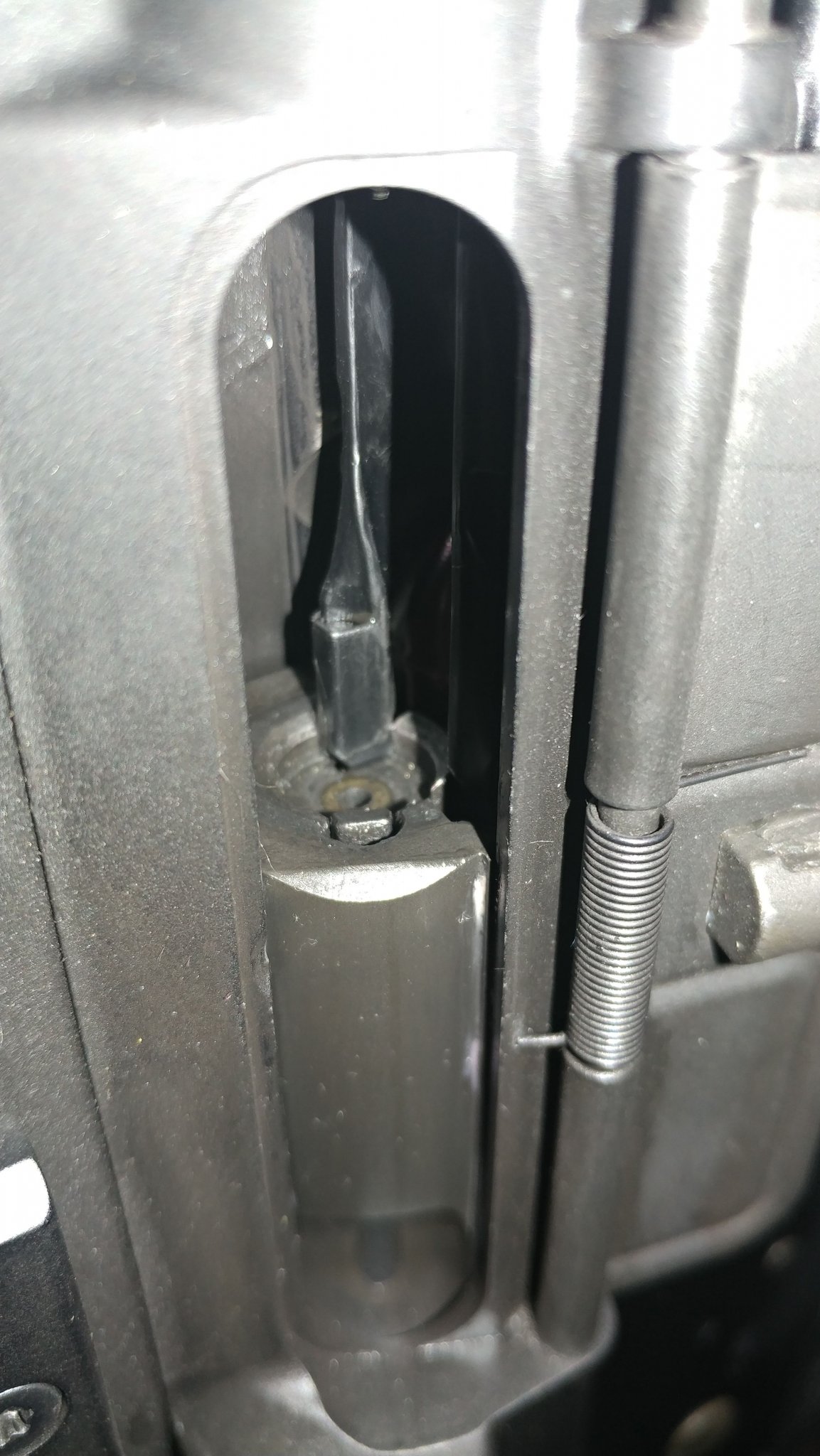

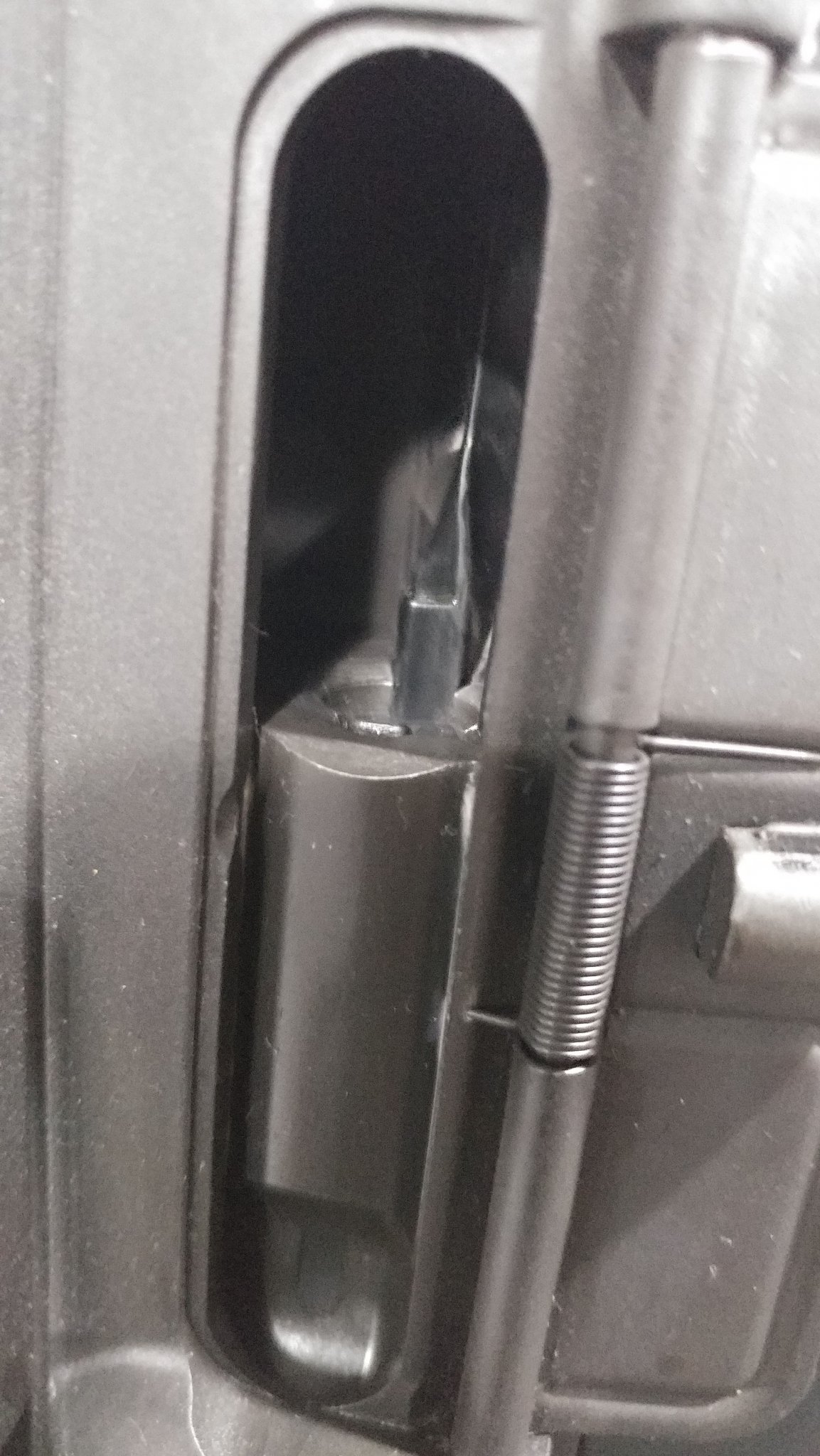

Now you have to know the Endomag comes with a huge disclaimer that the ejector is built into the mag adapter and that if the mag is dropped with a round in the chamber and then the action cycled. The round will stay with the bolt and reenter the chamber. What is actually happening is the ejector is getting caught on the bolt when you hold the mag from moving. Like the mag needs to float a little.
This may be a deal breaker for some and I get that. I have to say that I can not think of a time ever where I rested my mag on anything. So I am going to keep working with the endomag. I will say this, who ever did the chemical composition of the plastic did a great job, that ejector takes a fucking beating. I only used 1 mag, I wanted to beat the shit out of one vs 60ish rounds out if each one. Other 5 are still in their wrappers. I did the "touch the mag" thing 5 times and that is the only 5 times it stopped function of the rifle. It twisted/bent the living shit out of the ejector. All I did was drop the mag, double check gun was clear and reinstalled the mag. I never physically touched the ejector, it snapped back into place by itself every time.
I tried to take a couple pics of what was happening. One pic shows the ejector sliding under the bolt as it should, the others show the bolt just barely snagging the ejector. Small amount of trimming might help but might also cause ejection issues. also depending on how much play your mag has it may not be an issue.

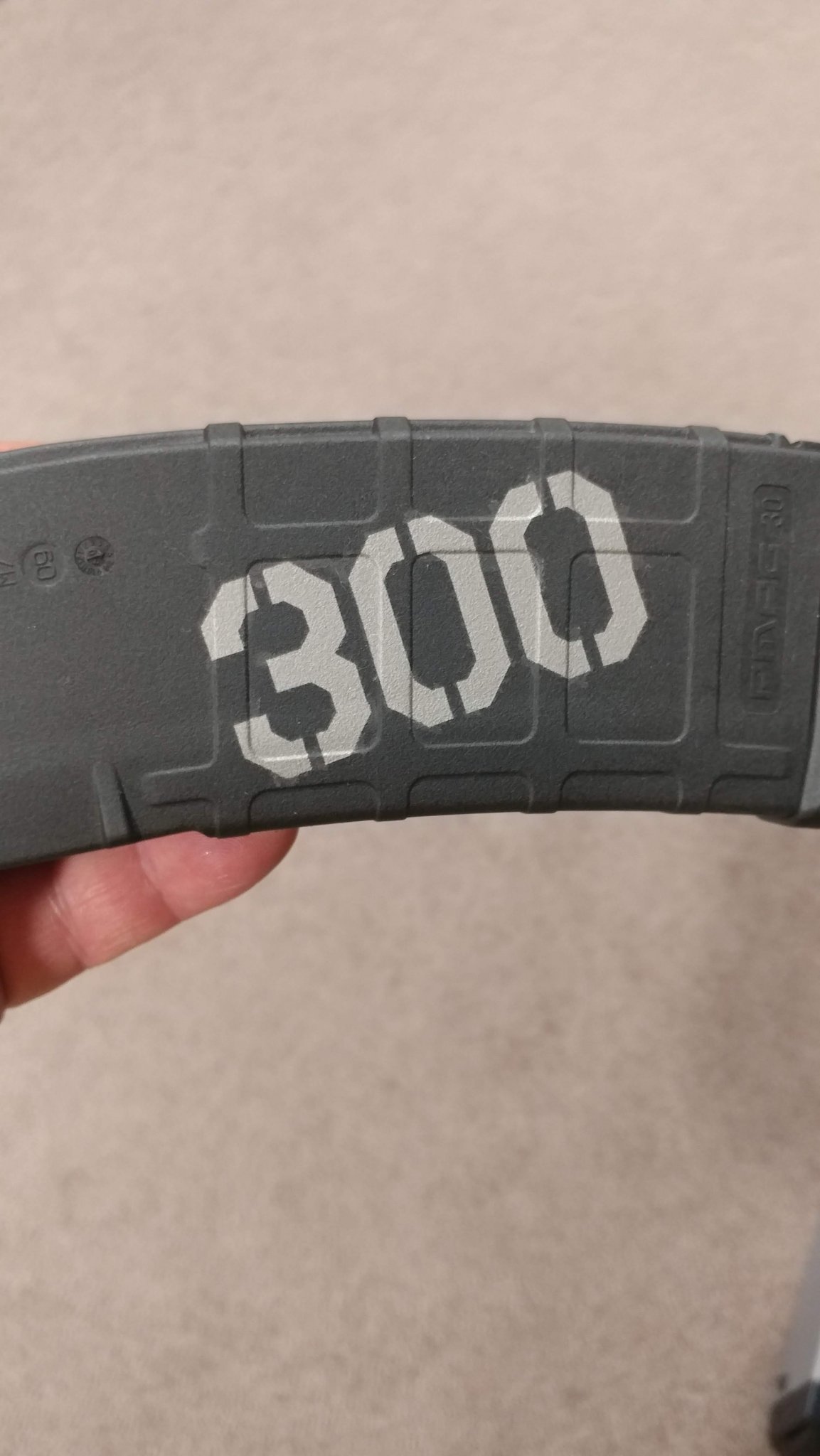

Next it was brought up that it would suck to mistake this mag for a 556 mag and put it in a 556 gun and have an accident. Here is what I did with my 300 BO with is cerakoted gray also.
For the 9mm I may do red or blue with red or blue high lights on the gun.
