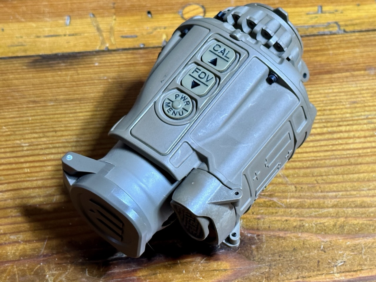

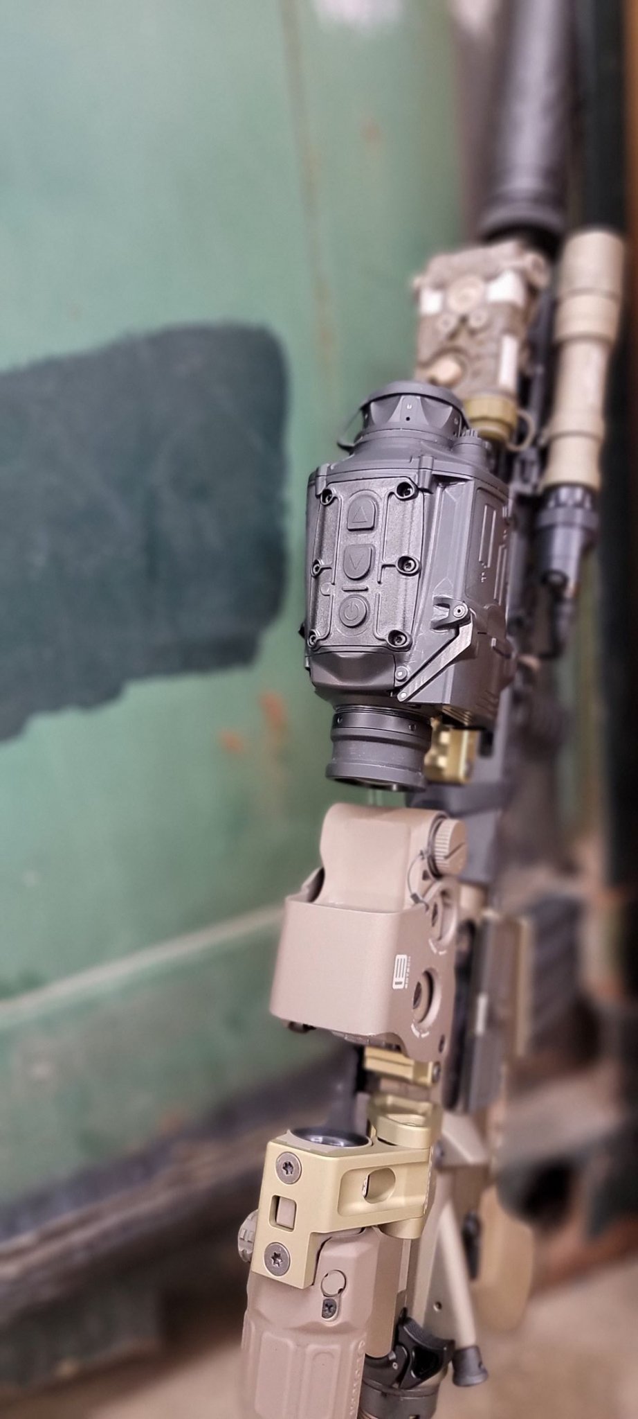

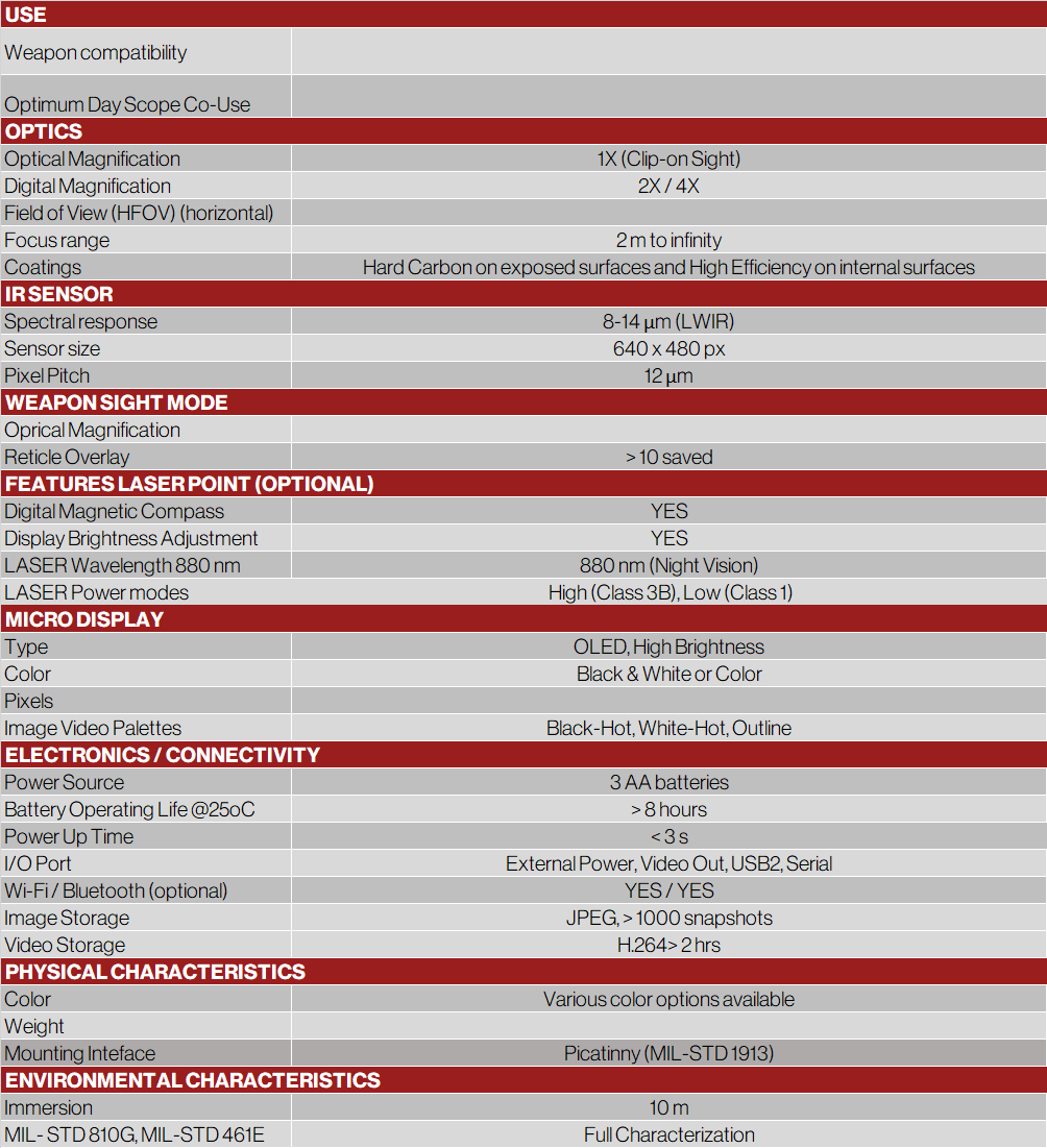

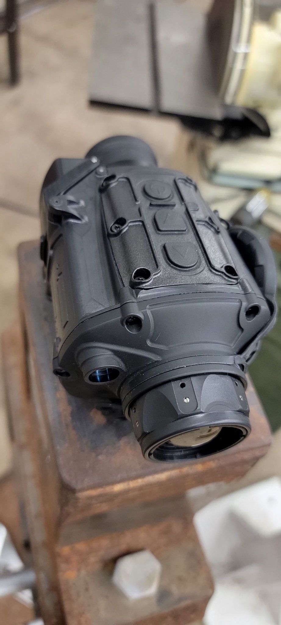

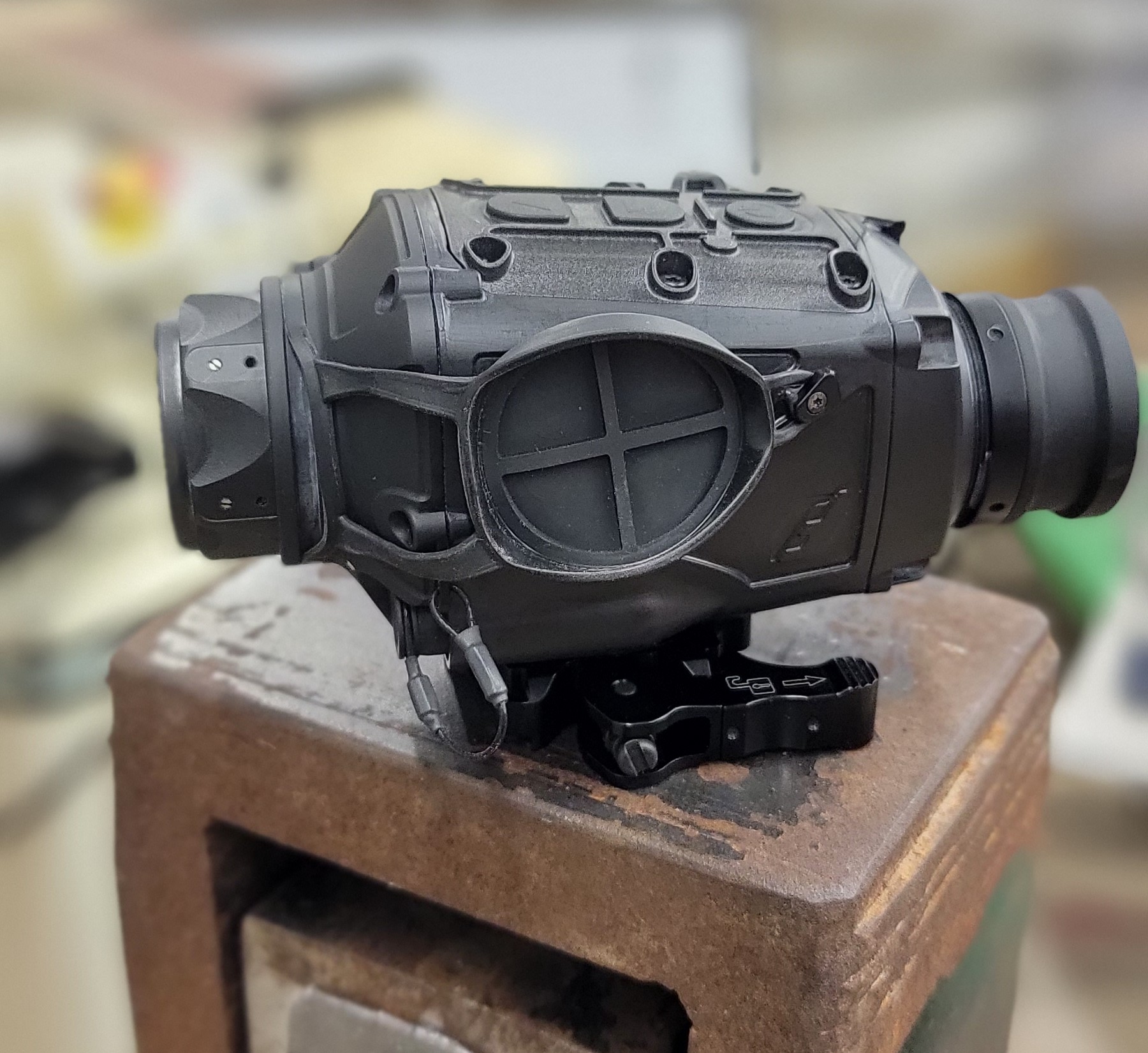

New for this yr is the MK2 SR FTS version (DRT exclusive) of the EOTECH CLIP-IR. This is the "short range" version of the new line-up of thermal optics from EOTECH. It has both stand alone and clip-on capabilities. It features an 18.5 degree FOV that is perfect for 1-6x type cqb optics. Comes on a locking Flip to Side mount that is built as well as any I have ever tested. It will have an onboard commercial IR laser for pointing out targets to NVG users. Lightweight and compact design .Price is TBD for now.. Super bright oled display with onboard video recording capabilities. 18 ounces with batteries installed. Fantastic as a stand alone or hand held as well. Expecting these late spring early summer timeframe.

I should add, if the core is 640x480 as it says in the specs, that could be the BAE core. The Chinesium cores and, I think, the Flir Boson are 640x512.
