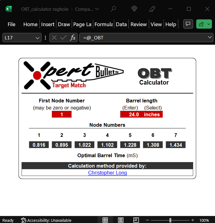

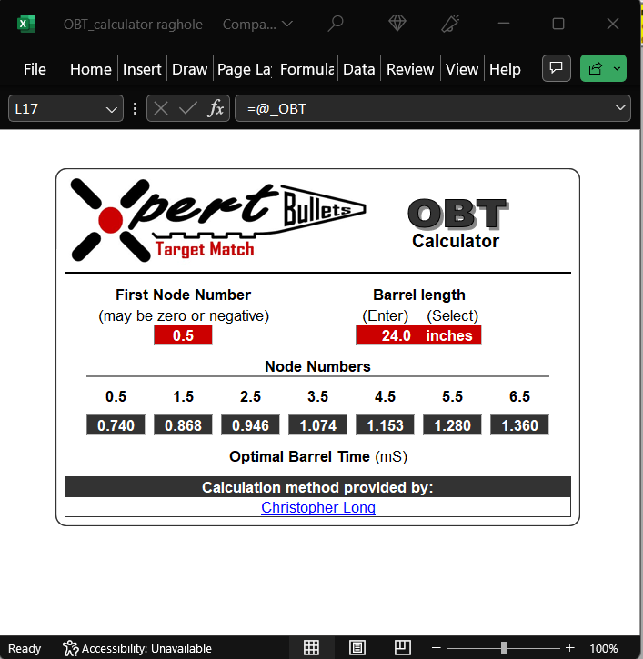

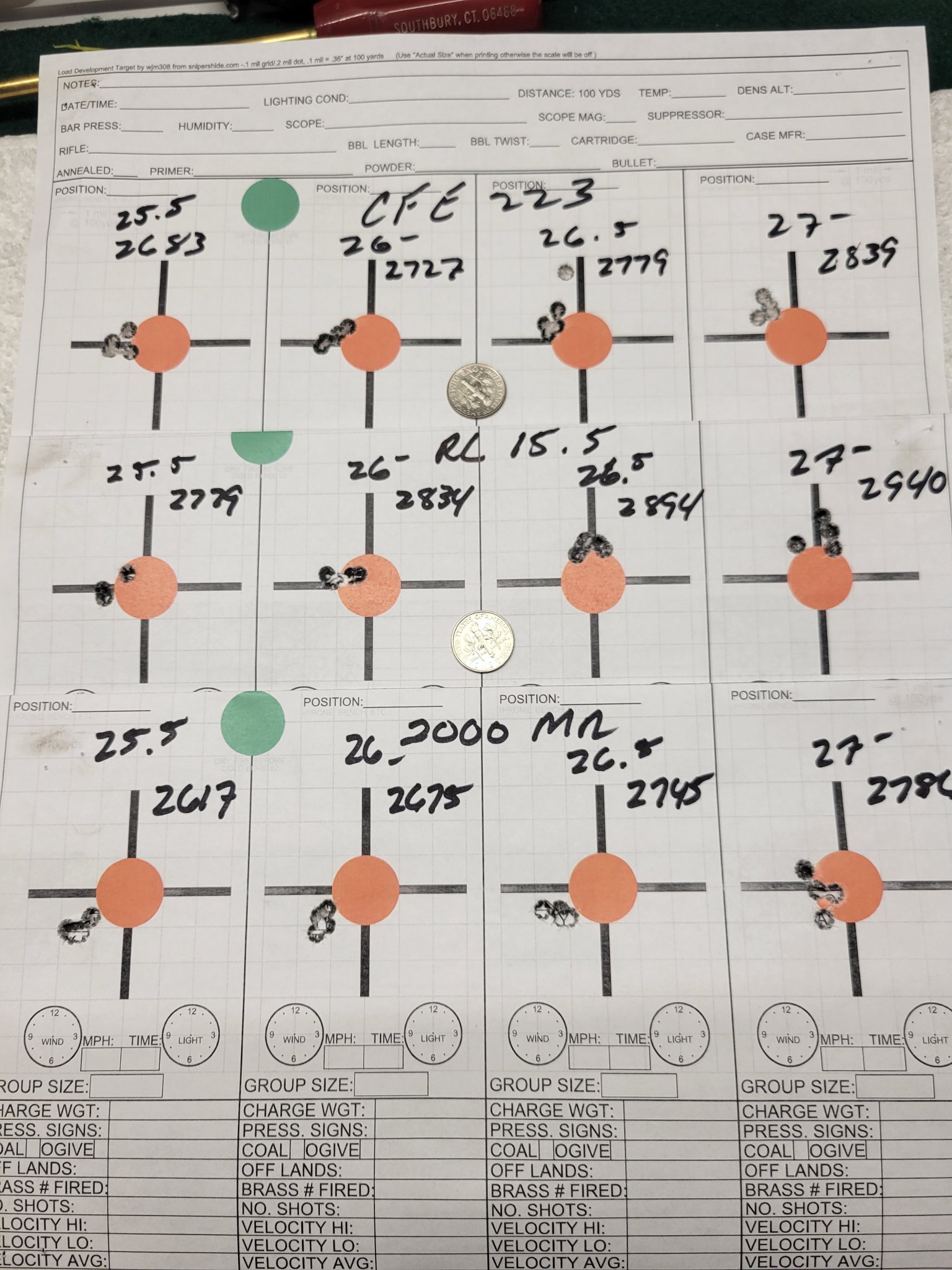

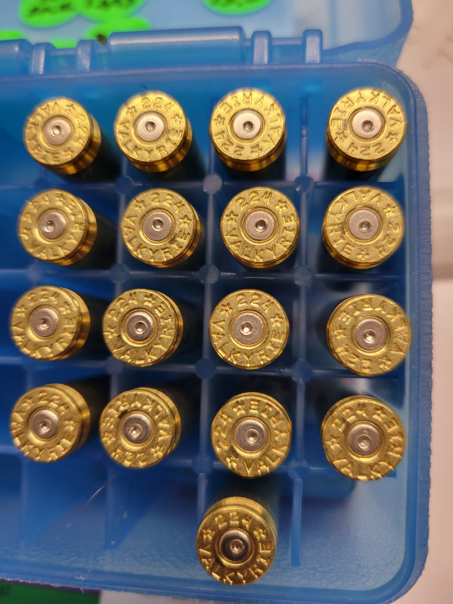

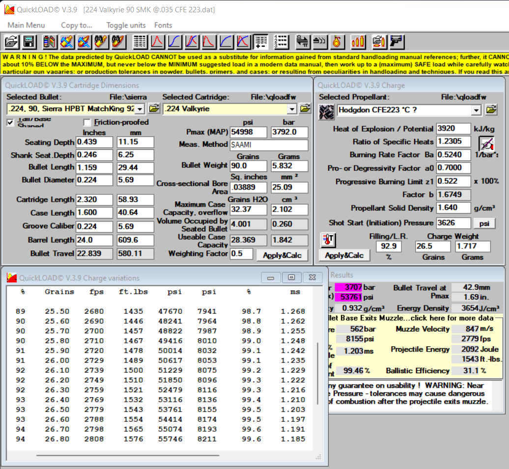

Back in November I said I was going to put a Valk together to test some stuff because what @lowlight was posting, so here it is. This is not definitive, but it does shine some light. The rig is a Big Horn Origin, bedded in a Manners PRS/TCS with a Leupold MK 5 7-35, barrel is an X-Caliber 24" 5R 7 twist. The barrel was originally on a Savage small shank running 80.5 at 2800 with N550. It was built for my youngest but he decided he did not like doing long range shooting, so the barrel was pulled at 750 rounds. Equipment I use; Whidden dies, Area 419 Zero press, V4 auto throw with AnD FX120i, Magneto speed V3 and Lab Radar. All velocities were within less than 10 fps on everything, so the numbers posted here are all V3 numbers. Brass pics are of the RL 15.5 as there are some pressure signs on it. The Big Horns are mechanical ejection so you do not see ejector marks, but you can see the ejector slot marking the brass. They go from Left to Right 25.5, 26.0, 26.5 and 27 grains. The RL 15.5 had mild bolt lift and click at top with the 27-grain load. I did not have any bolt lift or bolt clicks with anything else fired. All 3 powders were the same charge weights for a side-by-side comparison. Powders run were CFE 223, RL15.5 and 2000 MR. Primers were CCI BR4s. Bullet was a 90 SMK at .035 off the lands. I ran 10 rounds of previous load to foul barrel before testing. Testing was 4 shots each charge weight from prone with bipod and rear bag. I let the gun cool for a few min between each string and logged data, inspecting brass etc before shooting next string. Below are the pics of the results. RL 15.5 produced the best speeds. 2000 MR seemed to produce the better / more consistent groups. All viable powders. I use QL for barrel times and pressure. The barrel times I am looking at are nodes 4.5 and 5 on calculator and times are shown on far right in QL data. RL 15.5 has 2 potentials, 25.2 at 2752 and 26.4 at 2872 but that might be a bit warm and it might be a bit hard on primer pockets. I am going to test both those loads and see what happens.
