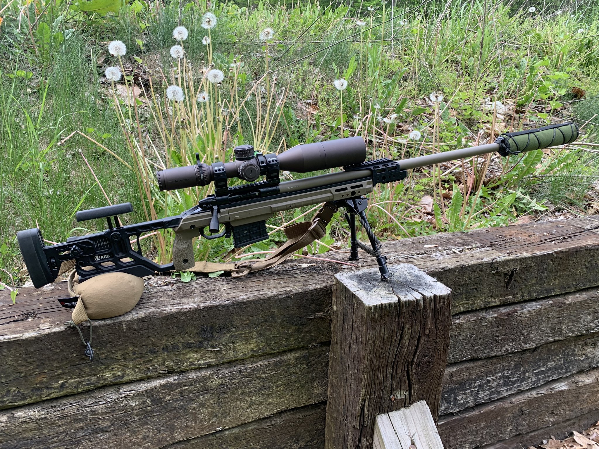

I have a bolt gun in 224V as well with a Krieger 1:6.5 twist. I also shoot factory 88 ELDs out if it. The 88 ELDs suck out of a gas gun because the tips break easily.
However, out of my bolt action rifle, they are the most fun you can shoot out to 1000 yards and a little further.
The factory 88 ELDs aren't as fast as what some reloaders are accomplishing but since I practically bought a pallet load of the Hornady ammunition when it was cheaper than Federal GMM, I have a lot that will last me a while.
The rifle with everything on it weighs about 22 pounds. It feels like an airgun when I squeeze the trigger. Only when the light is really bad do I not pick up the impacts or trace of the bullet.
If you haven't experienced it already be prepared to hold into the wind more with the 224V than with something like a .308 or 6.5 CM. That's to be expected because of the lighter bullet.
You won't regret your build with that rifle barrel.

My build is in full swing. Scored the nucleus this morning. After talking to Fritz about wanting the freebore to be optimal for case capacity loading out to mag length etc. He has me loading a dummy and comparing to sammi to come up with a custom throat length. One thing we talked about and I’ll get you alls opinion on it was should I pull out slightly all my factory ammo and then re seat back to a minor jump? Thinking was to not have the factory ammo with some giant jump. I know obviously try and see just figured I’d see what the consensus is.
