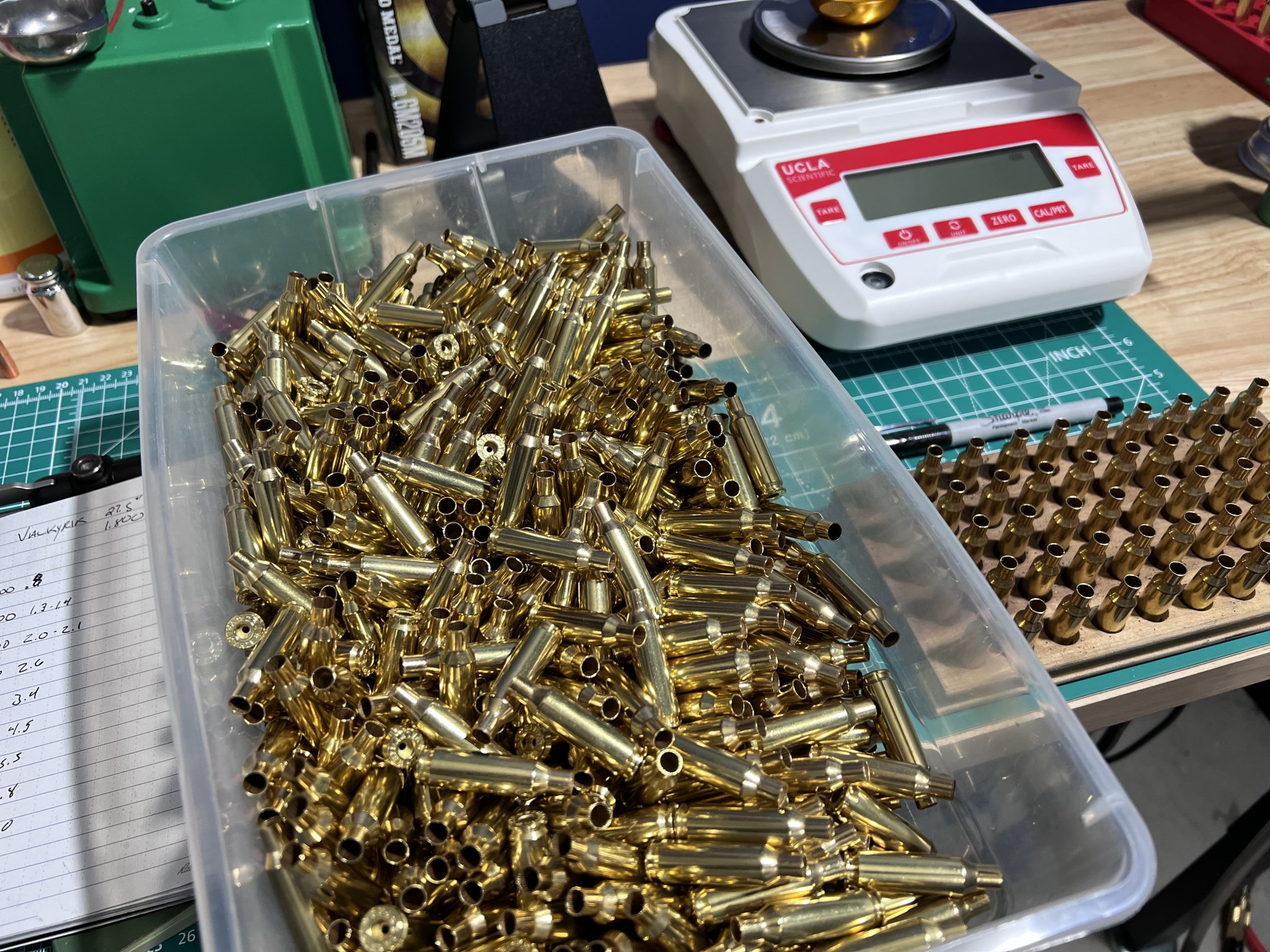

I got a TON of Starline brass from Chris Way.

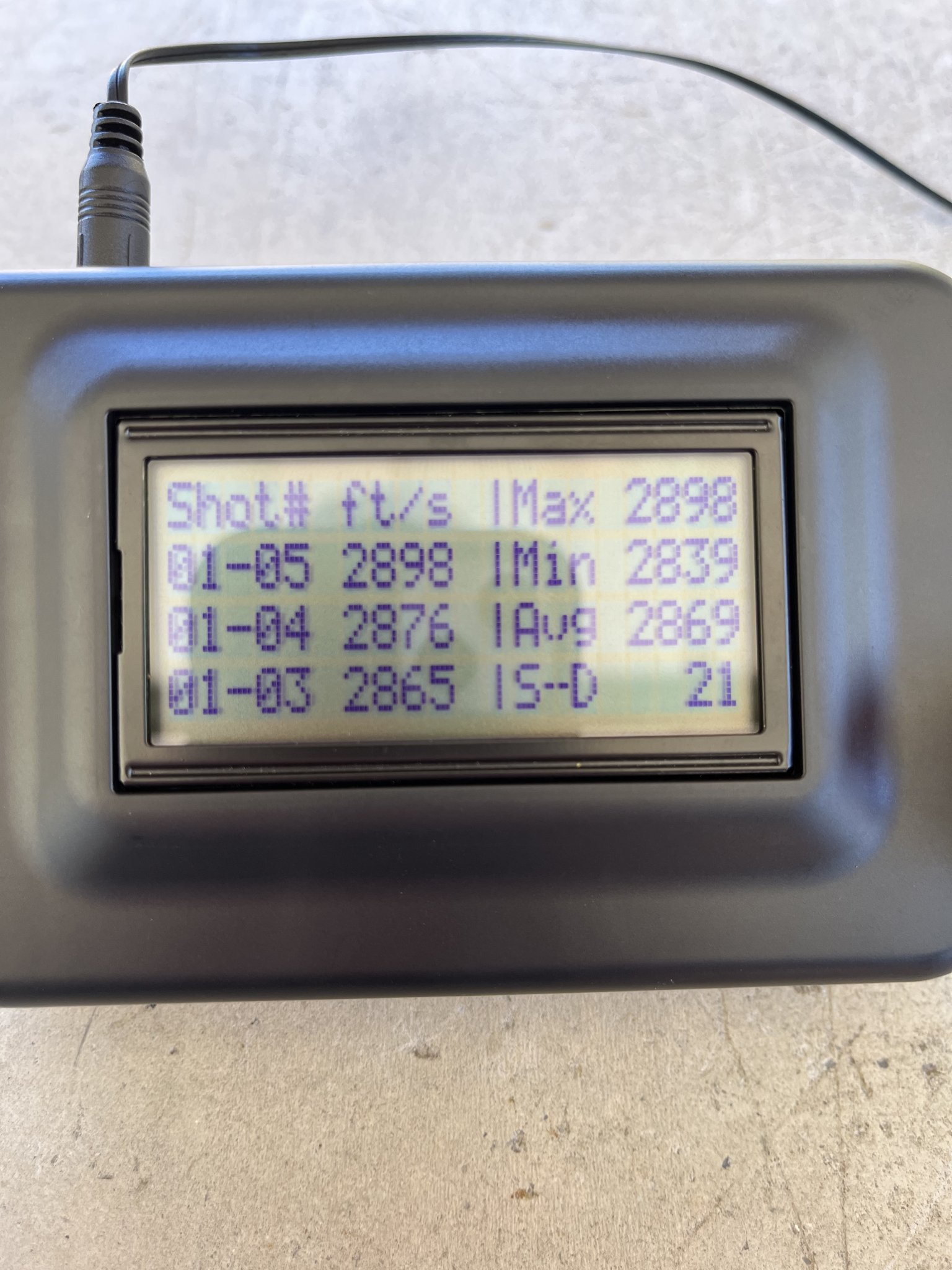

I've tried them both in the past and the result was a very accurate but "slow" (2600ish fps) round. With the 88s and the 24", 6T or 6.7T gassers that I have, 26.5 of CFE223 pushes my 88s at 2760-2785 depending on temp. After reading the load the Drumie used in @lowlights class (28 grs. CFE223 with 85.5 Bergers, I had to try it in my 6T gasser and I was up to 2930 fps, but it wasn't kind to the brass. I'm going to try it at 27.* with my 88s here shortly and see if it gets me up to 2850 and no brass issues.

When your groups are spectacular, but your ES’s are garbage….where to go next?
